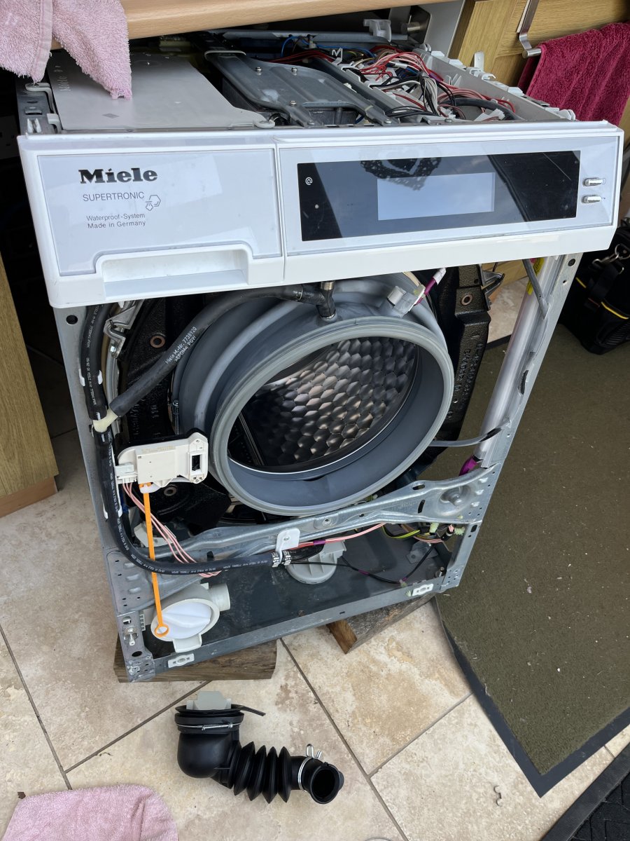

So I set about stripping it down with view to fixing whatever was wrong.....
Usual check on the drum revealed absolutely no play in bearings and/or spider. 1600rpm spin with no load, still quiet, and these machines are super quiet.

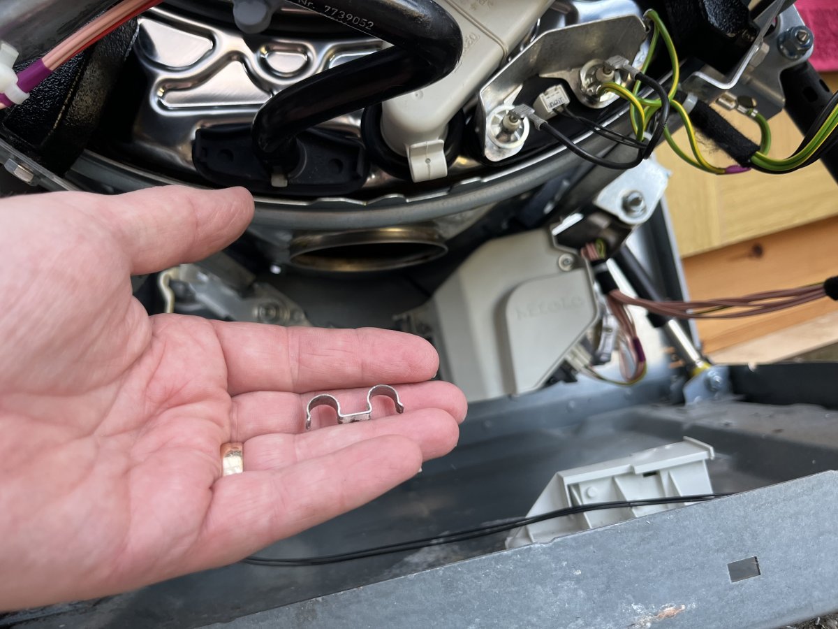

So you will see that I took the sump drain off to check for metal filings etc. And there was this little heater clip that fell out :oops:

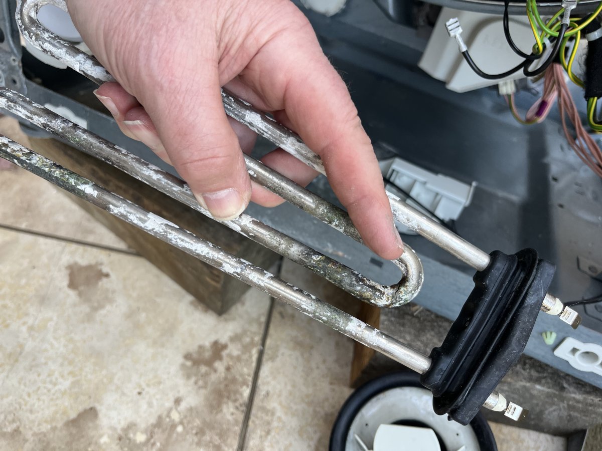

Ah ha a clue - gave the heater terminal a wiggle and it moved. Obviously flapping around and banging the drum!

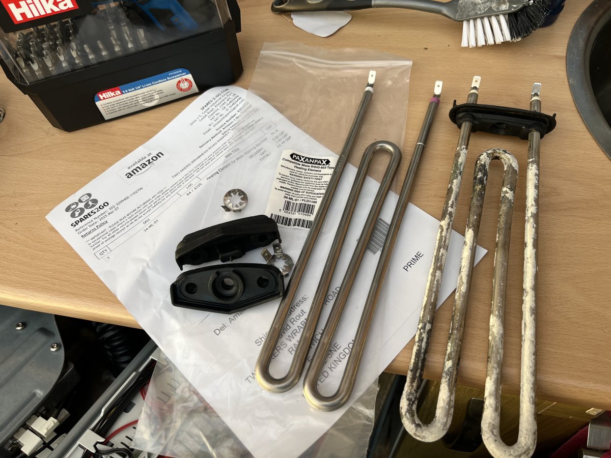

Pull the heater and found that it was cracked and which had obviously caused it to let go of the little bracket and the one inside the drum.
Quick check with the Fluke revealed that it was indeed dying :geek:
Anyway good old Amazon had a pattern heater at £21.99 v £85 for genuine Miele.
Delivered the next day and now back up and running.

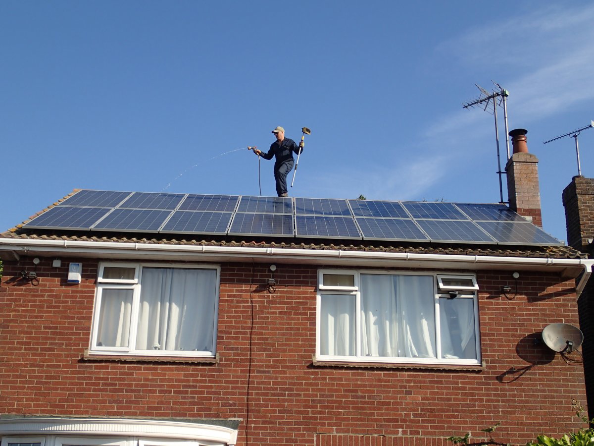

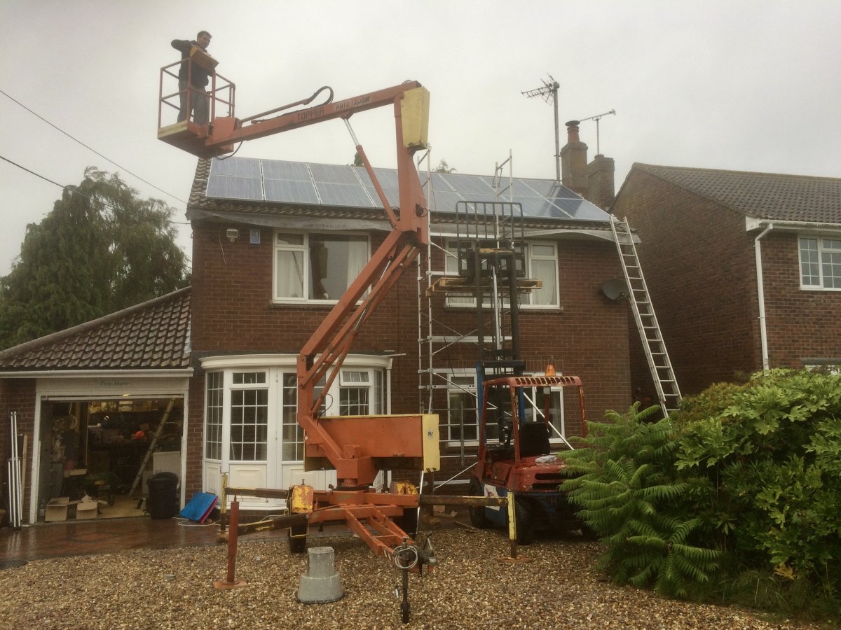

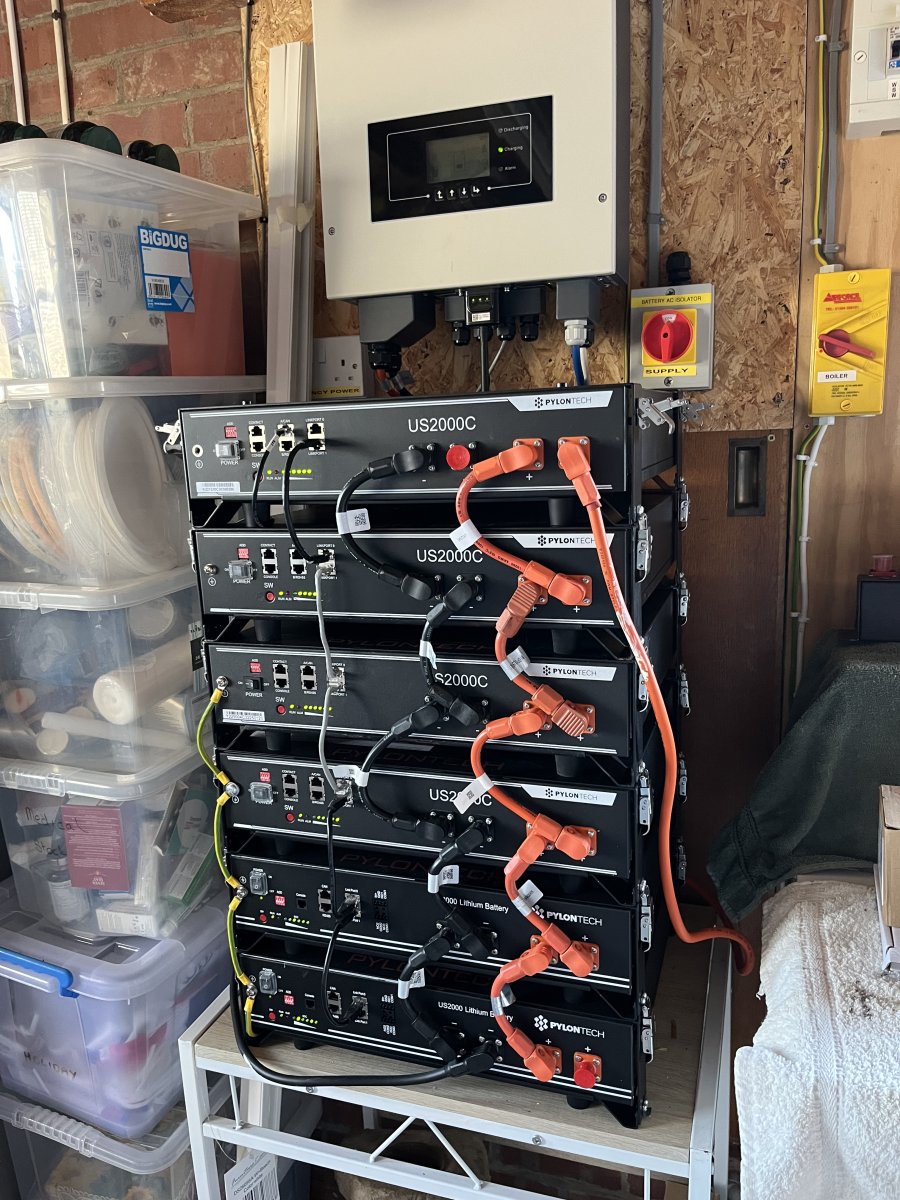

And in other good news - my upgrade on my Solar PV system is performing excellently now we have daily sunshine :cool:
To re-cap, back in September 2015 we installed 4kW 16 panels on the roof. They alone paid for themselves within 5 years :)
This is how I keep 'em clean :p
So being a bit of a techie, I wonder what about adding a solar battery system to capture the surplus that we send to the grid for pennies.....
So since October 2024, have been buying up 'nearly new' PylonTech US2000C batteries.
And running them through a SOFAR ME3000SP charger/inverter.
Have now got 14.4kWhr of storage. The house uses on average about 9-10kW/day.
The Solar array is now making 20kW/day
The daily bill on our Smart meter for the last week or so is 44-50 odd pence :cool:

Very curious to here how much that stack cost you??

Yep they look impressive don't they. But some in the Solar industry hate them because of reliability issues. But looked after they are specified at lasting for about 15 years. So the cost during the period that I have collected them.....
And it's very much like buying second hand plant - "Buyer Beware" especially as I sourced them from eBay and Facebook Marketplace. You get a feel when you meet people and them check the goods ;)
My total cost for all 6 x PylonTechs AND the inverter was £2150
The last 2 x PylonTechs that I bought were £550 for the pair (£275 each) - that's a bargain IMHO. Many are selling used one of these at about £400. New they are about £600.
Hopefully my install is cost effective compared with he likes of the big expensive Solar Batteries such as Tesla Powerwall etc :geek:

really really interesting.
great to see this first hand and in operation.
I'm eyeing up my flat garage roof and using trays, wholesaler had some good rates on panels etc but batteries always seemed a bit out of reach.
