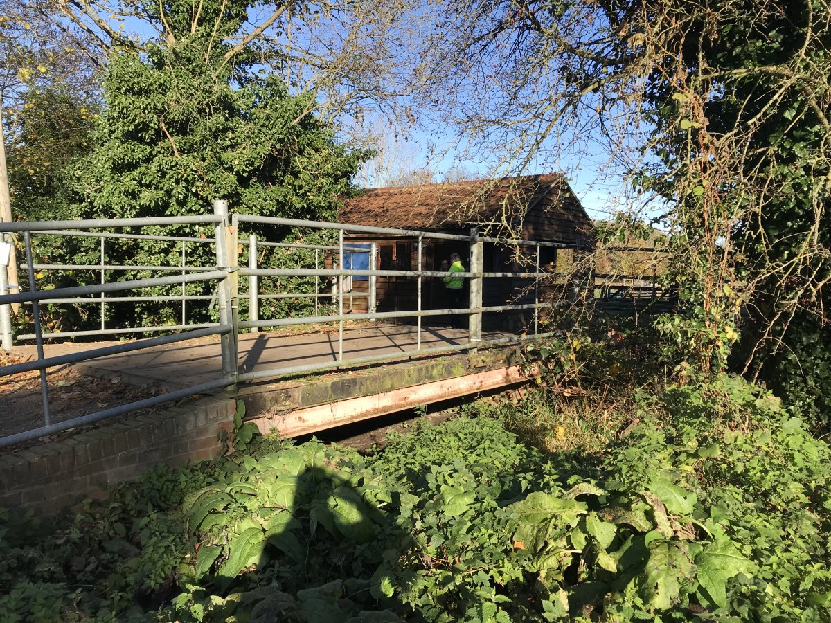

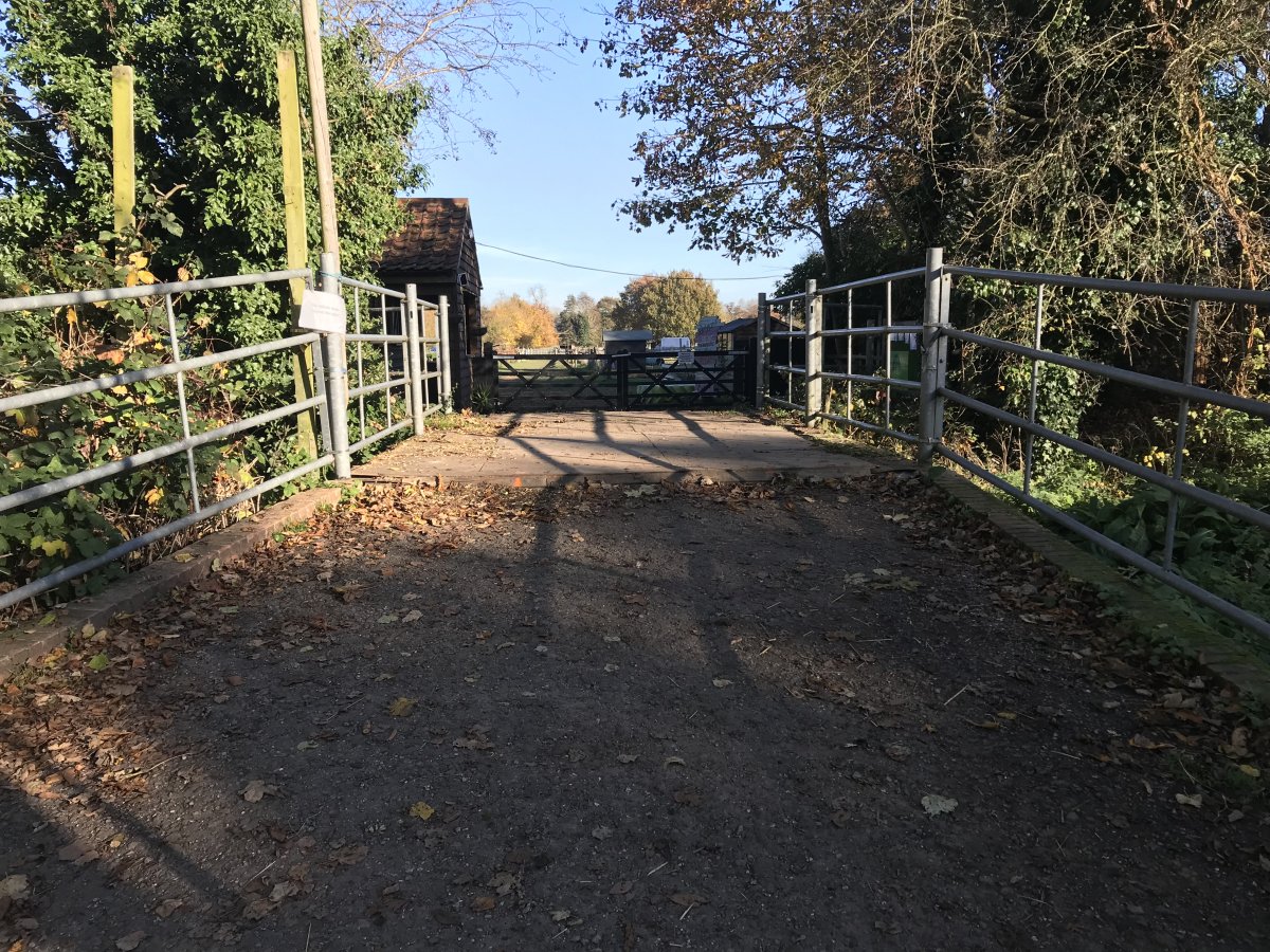

.........remember that Bridge. Turns out that the parish Council are now keen to get it sorted.
AND they want little old me to 'quote' for the job :oops:

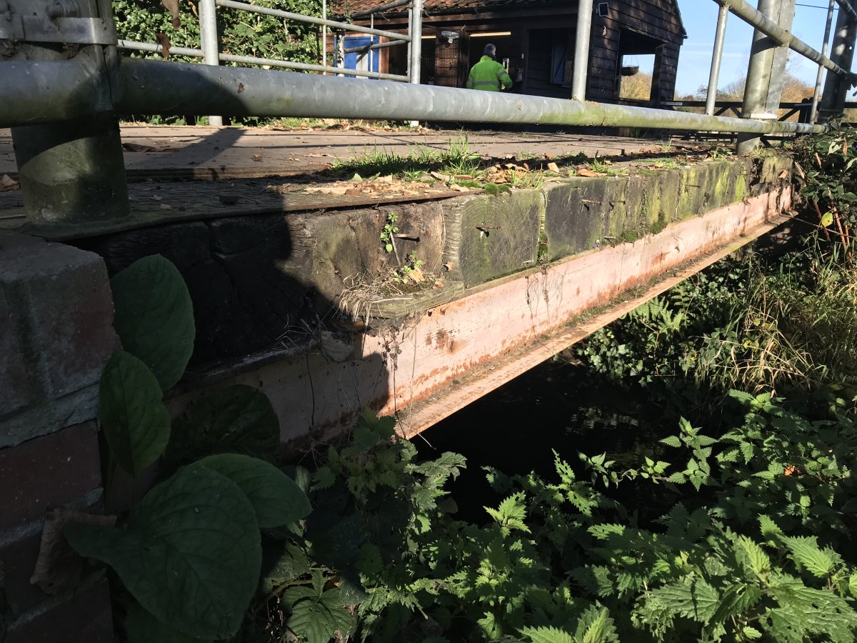

4 x RSJ Steels between brick piers which seem sound enough

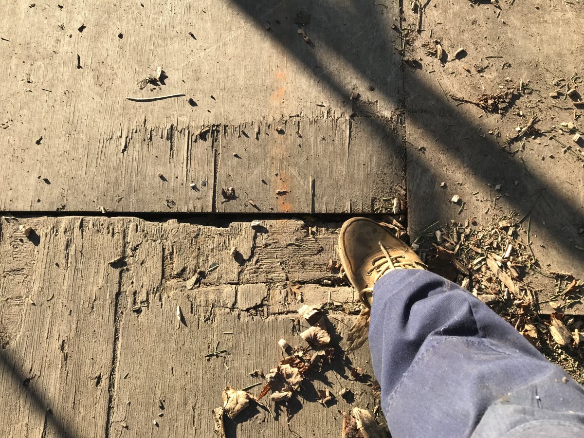

12 foot long reclaimed sleepers - 18 of the big 12" ones
Sleeper ends all going rotten. Covered with plywood!
The plywood covering is now going rotten. Revealing the completely rotted out sleepers below.
You can see the water flowing below this one
Have written to the Parish Council with estimates (don't do quotes) and various options.
My favoured option is to replace all the 12 foot sleepers with 'new' grade A reclaimed ones
And IF I get involved, will be using a business partner with experience of civil and stuff like this ;)
At the moment struggling to find a supplier for these...
So there you have it guys - suggestions on a postcard please :ROFLMAO:

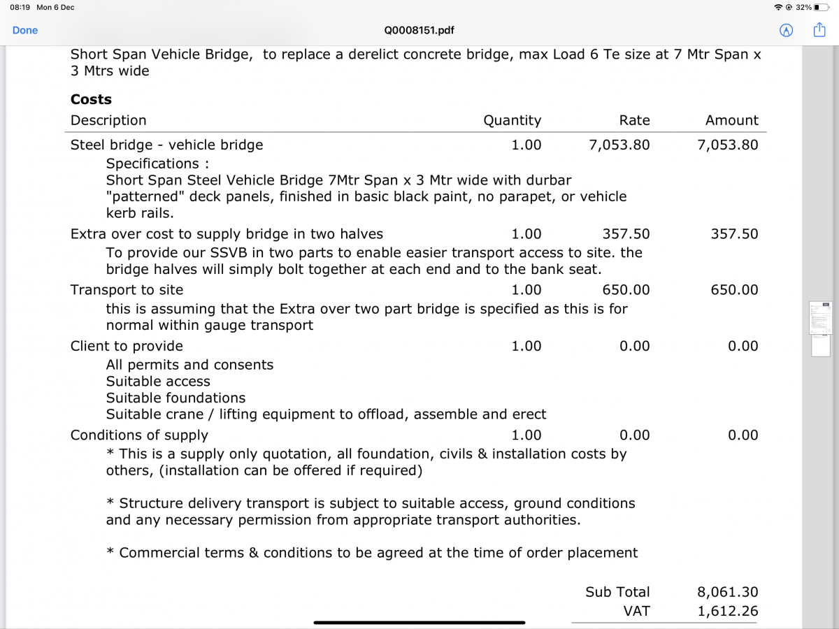

Speak to beaver bridges they‘ll prefab you one then just lift in to 2 concrete head walls
i priced one doing it myself etc But they were cheaper and better
They had second hand ones (red )as well or new custom build they’ve even got hiab artic to lift them in (metals gone up a lot since this price but at the time my make it your self one was almost double what they wanted)
just check you insurance as well some public liability get funny about bridges etc

Thanks for your information and advice. So useful from someone who has done it before :cool:
I think that the expectation was that I would simply rock up with a trailer loads of old sleepers and sort it out ;)
And even then it was suggested that a quick fix for under £1000 would get immediate approval.
So I have written back, suggesting that even the supply of replacement sleepers (like for like) would be far in excess of this.
Funny how it's all gone quiet with no reply to date.....
I am a simple sole trader with a mini digger, dumper, trailers and assorted plant.
And no my insurance does NOT cover me for this work, but I have a business partner who does ;)
BUT like anything that we get involved with using machines, it's interested and something different 🤠
That is a great recommendation - thanks (y)

could well be a sensible idea ... have built a few over the years and there's a lot to fabbing 'em .... the least of which is getting 'em calc.ed properly .... like for like would be the only sensible route to avoid comebacks, without involving SEs and then the costs'll rise ... a 'turnkey' solution from Beavers'd be the most sensible for sure (y) and possibly the cheapest option, after a like for like replacement of the deck

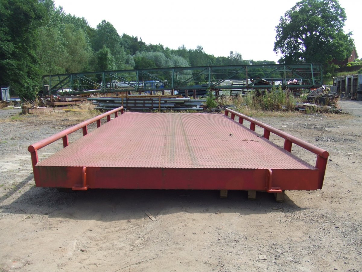

if you can achieve a like for like solution at a sensible cost, it might be worth their investing in some s/h ali track mat, rather than ply-ing it over ... would breathe and drain way better, add structural integrity to the job and last a whole lot longer - at a price - depends on how far sighted they are ;)

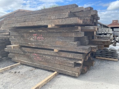

Grade A sleepers are about £25 +vat here.
Just a thought but aren't reclaimed sleepers usually shorter than 12 foot. There was a bridge near me washed away in storm desmond (2015) and the sleepers on it were longer than the norm (could easy have been 12 foot) and I'm sure they were Russian origin and v rare.
Pam's vegie boxes are made out of 12' crossing sleepers .. came from America (long story) and most of them are hardwood and 15" wide
this bloke has them up to 5.5m .... reckon you'd need to go there and sort exactly what you need though Dave @Routy56 to be sure of getting some decent usable specimens :rolleyes:
..... but not gonna be cheap at £12.50/m ..... be worth investigating the cost of new TBH
Only thing with the new sleepers you get, they seem to be rubbish and don`t last anything like the old ones. Modern nice and kind treatment vs old carcinogenic treatments I suppose :unsure:
Treated with water these days i think
