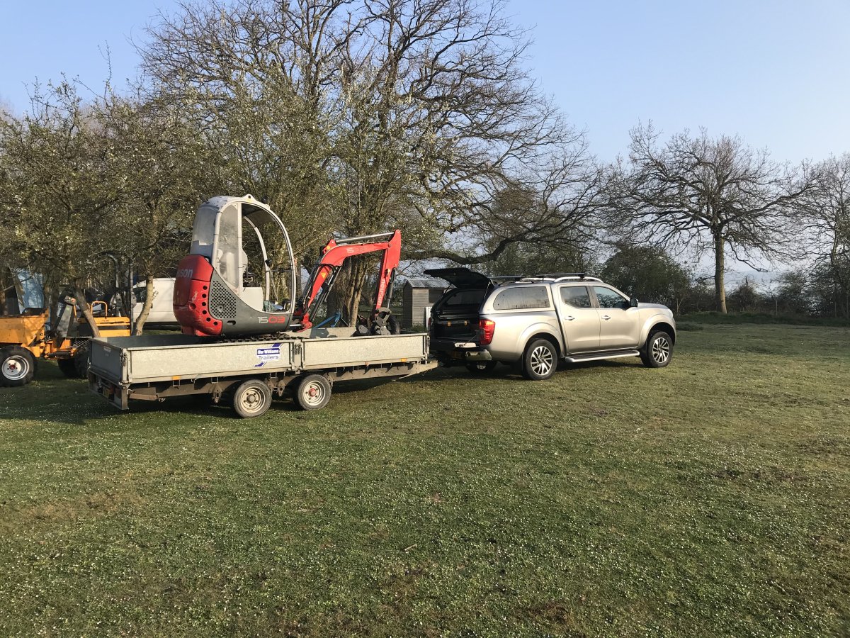

Just taken the machine off it drops the rear tub by an inch over the wheels with the machine on. Probably not that bad really and the right amount of hitch weight but never the less...

So first time towing with the Navara. As you can see weight is as far back on the trailer as I can get it couldn't get a sheet of paper between the counterweight and the tailgate and its still on its arse, so thought to add these bolts to the tail gate clamp to allow more clearance and shunted the machine back another inch. It's still on its arse and only got about 100kg of tools in the back!!
Yep. with rear cointerwieght machines your limited to positioning. It towed and traveled fine and didn't feel heavy on the hitch but definitely looks like an invitation to be pulled over.

Its the Ifor trailer that's the problem. My Indespension used to be a lot better for sitting level, my Ifor it feels like the wheels are further back on the bed of the trailer so no matter how far back you put the machine its still nose heavy.
they're overly nose heavy empty - end of -- that one I had from you with Lil' Jake ... insanely nose heavy :rolleyes:
Your absolutely right hadn't considered it was the trailer at fault but comparing it to a bateson plant trailer the batesons axles do seem to be further forward.
