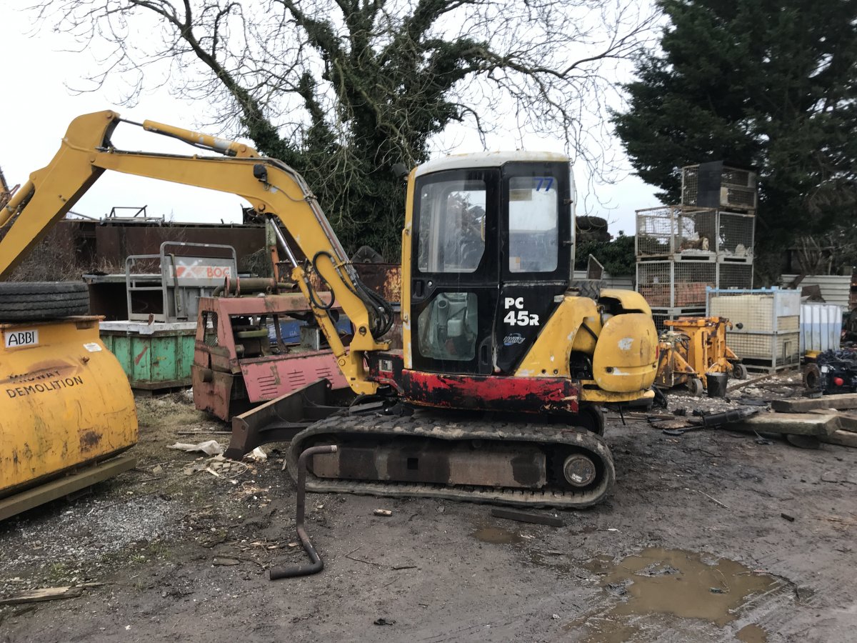

The alternator is connected directly to the fan in a cowling so not as simple🤔 but not had a proper look if another one can be fitted🤔

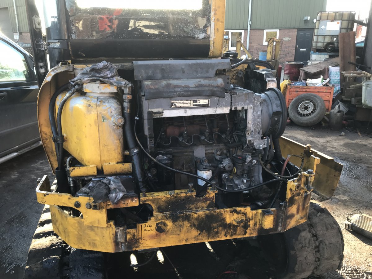

this is what the engine looks like only a 4 cylinder

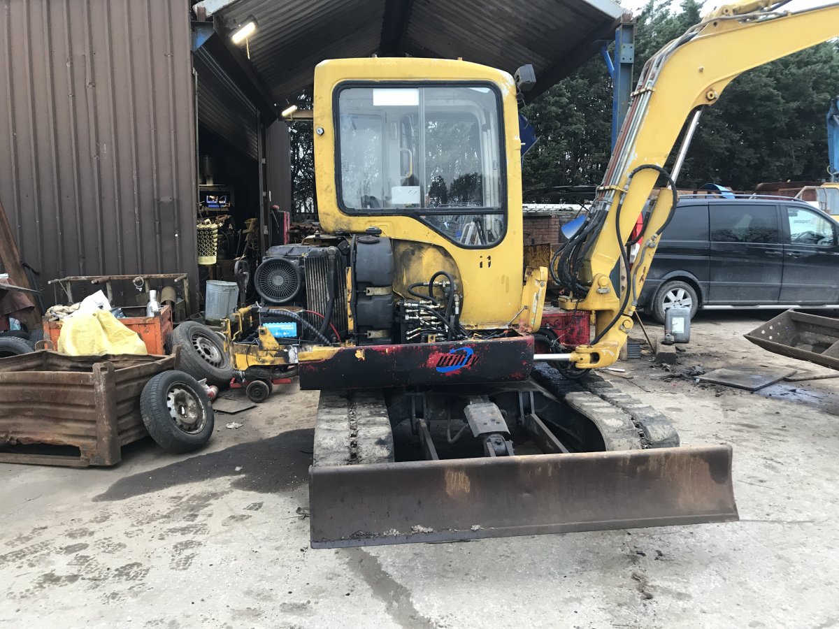

Longer belt and a bracket to fit alternator. Just need to move bonnet back a further 6 inch again 🤣🤣 or cut a hole in it for alternator to poke through 😜
tha's the fuel pump you can see, I think ...... alternator's in the fan hub is it @Mogman
Yes you can just see the back of the alternator if you remove the side cowling may have a proper delve tomorrow if I get time

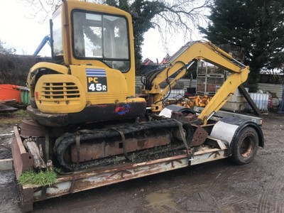

as for spending money on it I have a very tight budget basically the trailer it came on is going to fund it so stuck it on the bay to see what happens

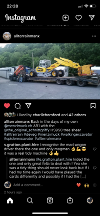

You appeared on insta tonight mate
That’s a long time ago😳 Sean’s machine I think, never did have a play on it though😢

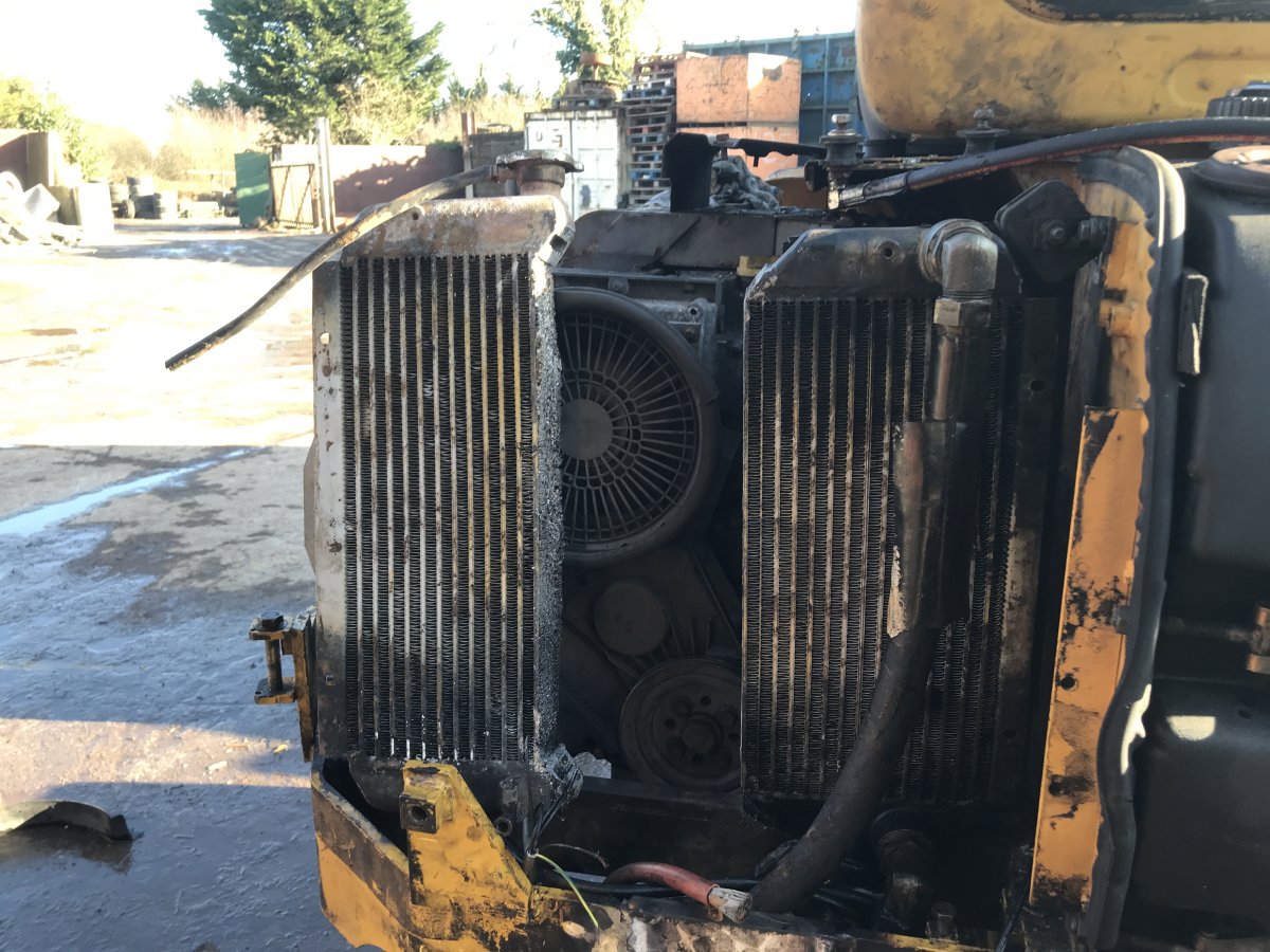

but back to the job in hand🤔 now I thought the Perkins was a tight fit😳 this fecking think is massive compared to it🤪, had to leave 2 bolts out of the bell housing (still 8 left though😉) to clear the hydraulic oil tank🤫
but made a bit of room the other end by cutting the radiator in half😳 only need the oil cooler part👍
hope the starter doesnt let me down as their is no way that’s coming out without a fight
I’ve had to leave this full 2” gap😯 so the engine can be inserted and removed (hope it’s not coming out again😳)
Now I removed this engine about 3 years ago (nearly sold it a couple of weeks ago) and hasn’t been started since then but stuck my booster pack on and it went first touch (thank gawd 👍) so well pleased with it so far😉
just need to wire it up to the dash and fit a new battery tray, the exhaust and air filter will need a bit of adapting again but in the main 👍

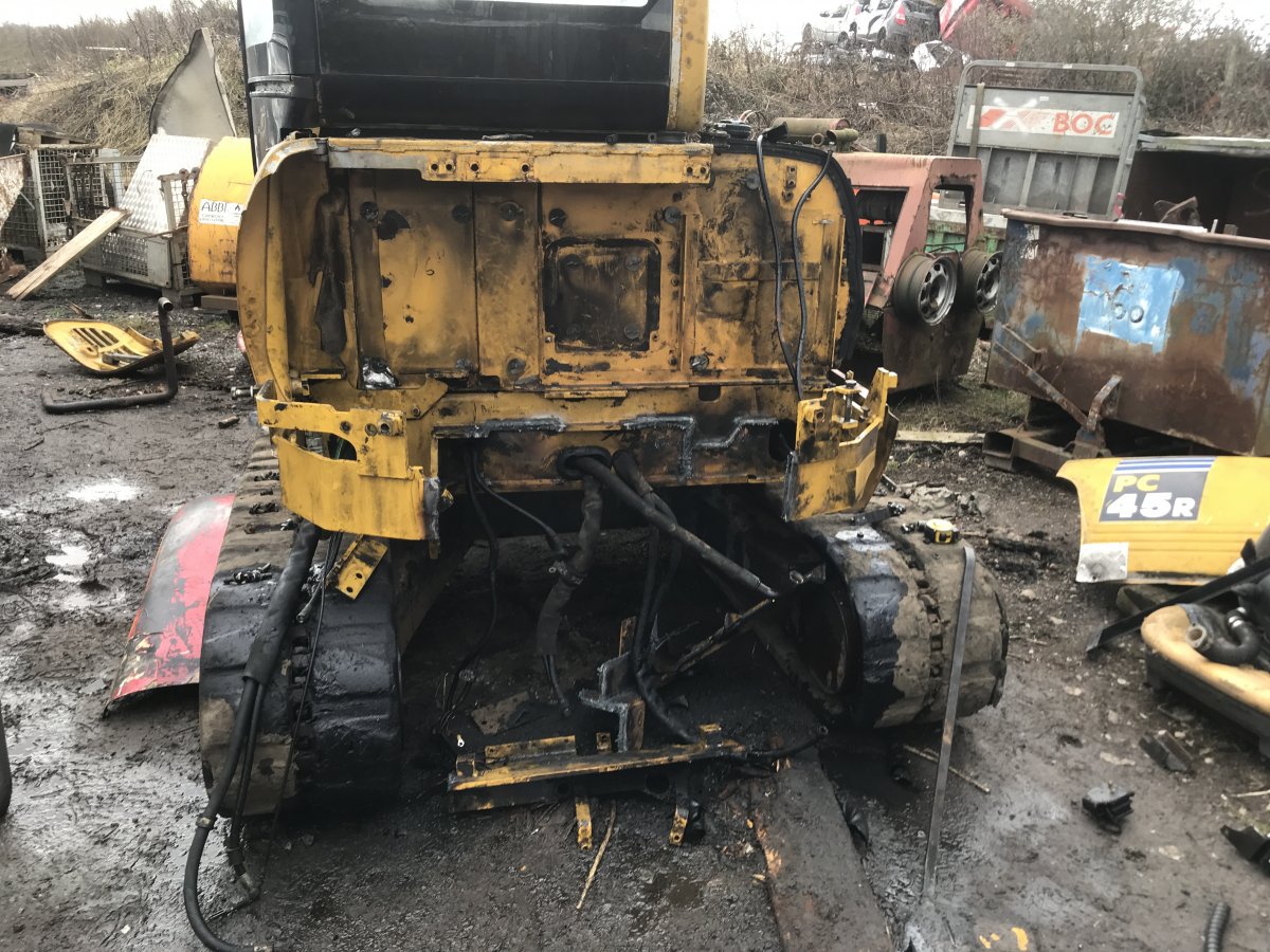

I’ve had to do this today
yes cut the whole back end off😩

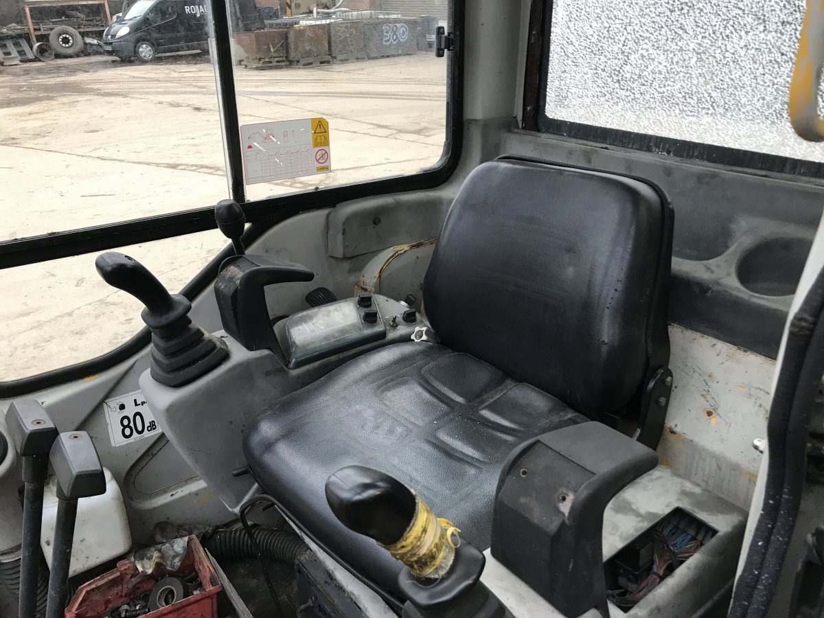

thought I’d show an interior shot😉 quite tidy inside🤔 shame it’s going to get covered in broken glass soon😢😢
and finally it’s alive again👍👍 tracked it out from under me shed on tick over result😉 (the Perkins needed to be flat out to move and would still pull the engine down to a stall) and without a whiff of smoke👍
Just stuck the corner weights on to see what I’m up against to ’fill the gap’

Is it sold. What budget have you got to spend on the glass?😁
Yes sold it today👍 It’s going to need retracking soon as one of the steel inserts is escaping so keeping an eye out for some steel tracks the wider the better👍 would like 5-600 wide
Slacken the tracks off a bit you'll get a bit longer out of them 🤣
