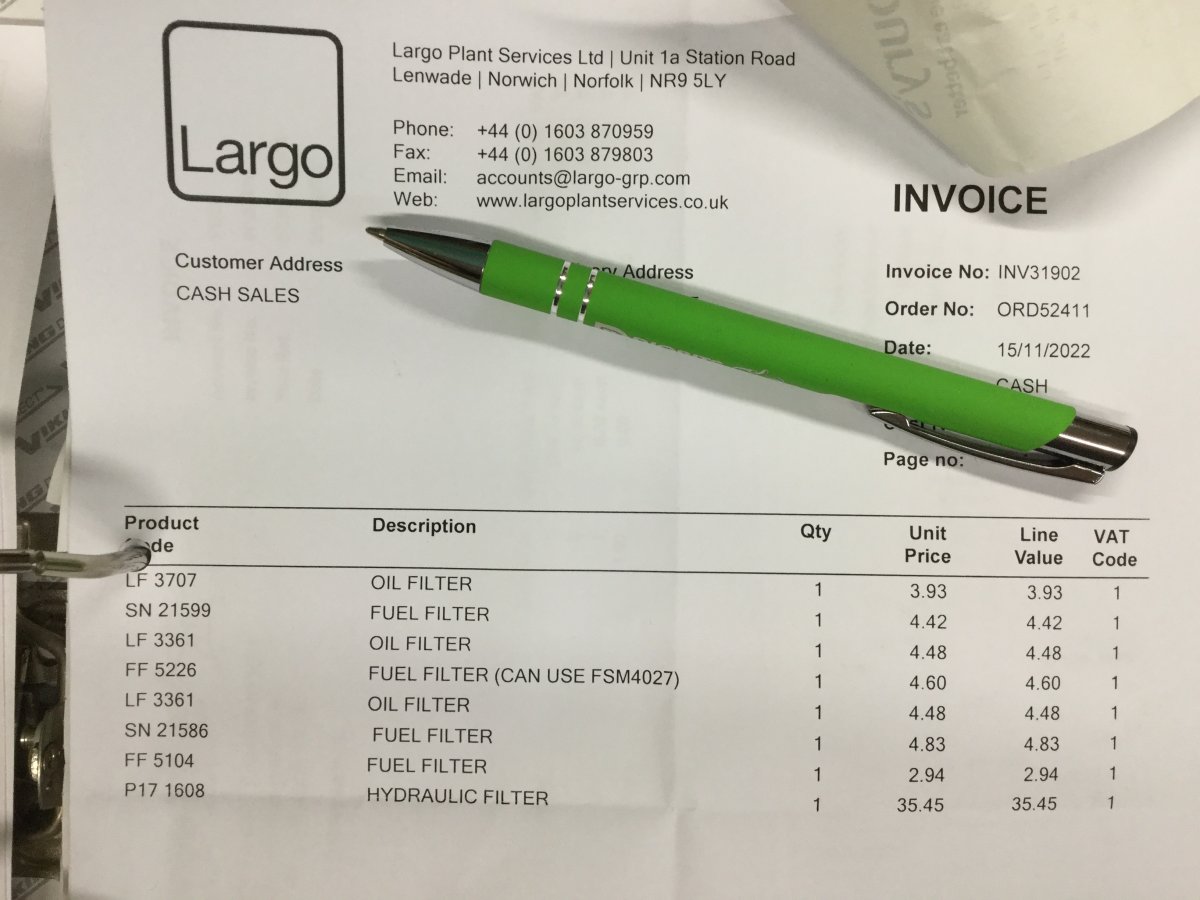

Sorry can't remember what i payed for the genuine Volvo filters as i got a stock of maybe 10 so was some time ago. I certainly wouldn't pay £35 for the filter in the sediment trap as its just a gauze element and easy to clean.What are using paying for the filters ?
Just ordered through SMTGB and feel been shafted
VOE17266182 has superseded to VOE15714572@ £14.52 each and VOE17266226 @ £35.37 each.

BALDWIN PF872 about £3.89What are using paying for the filters ?
Any idea if the superseded Volvo part no. replacement could be a more water tolerant filter, or am i just clutching at straws?BALDWIN PF872 about £3.89
BALDWIN PF46077 about £7.20
