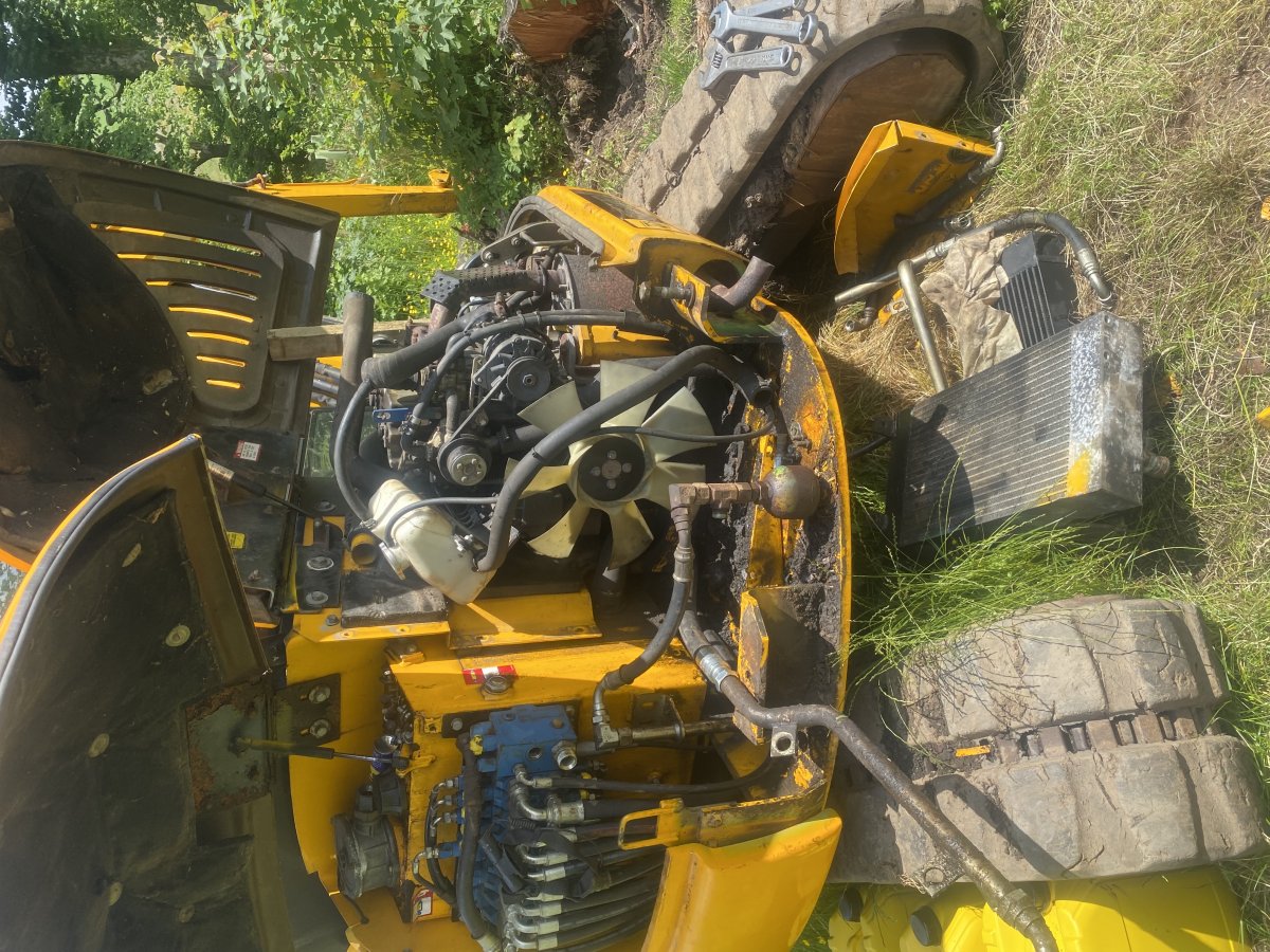

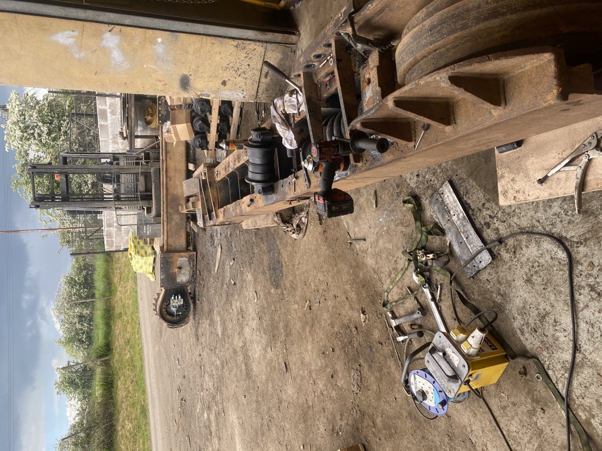

Cat D3G undercarriage conversion, supposed to be first in UK, no photos of actual machine on customer’s request

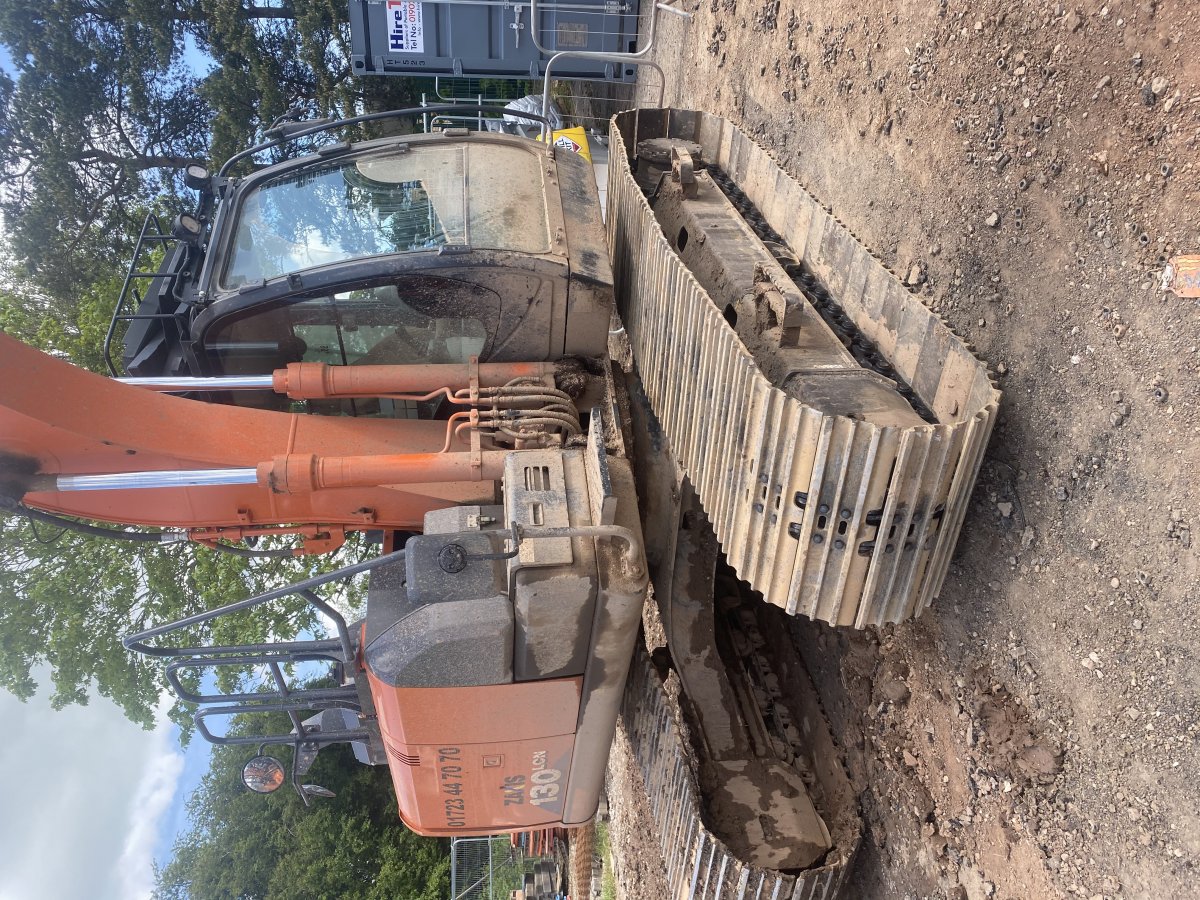

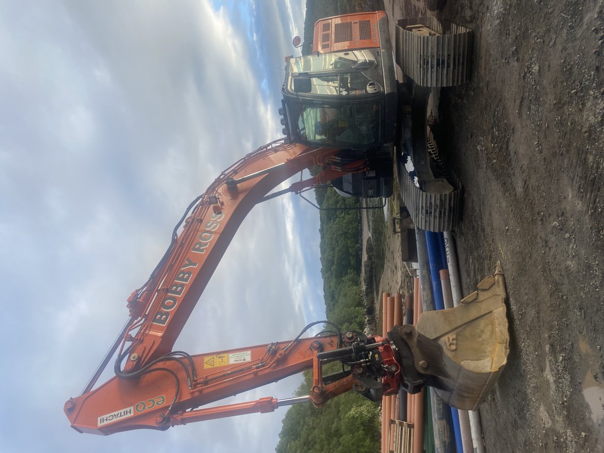

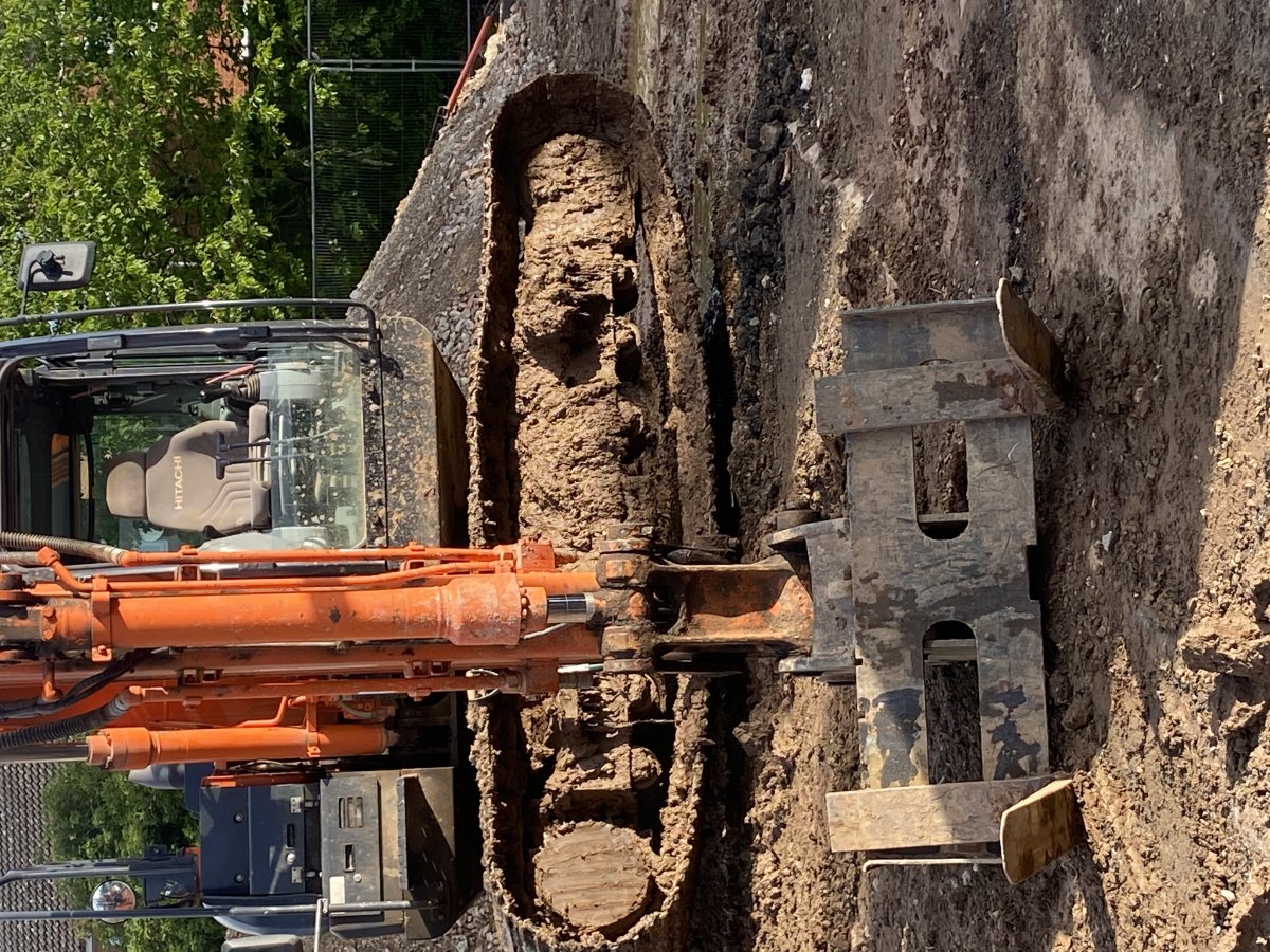

Full hit on this Hitachi 130 in Telford, usual groundworker machine, as much slop in the tracks as inside the cab.

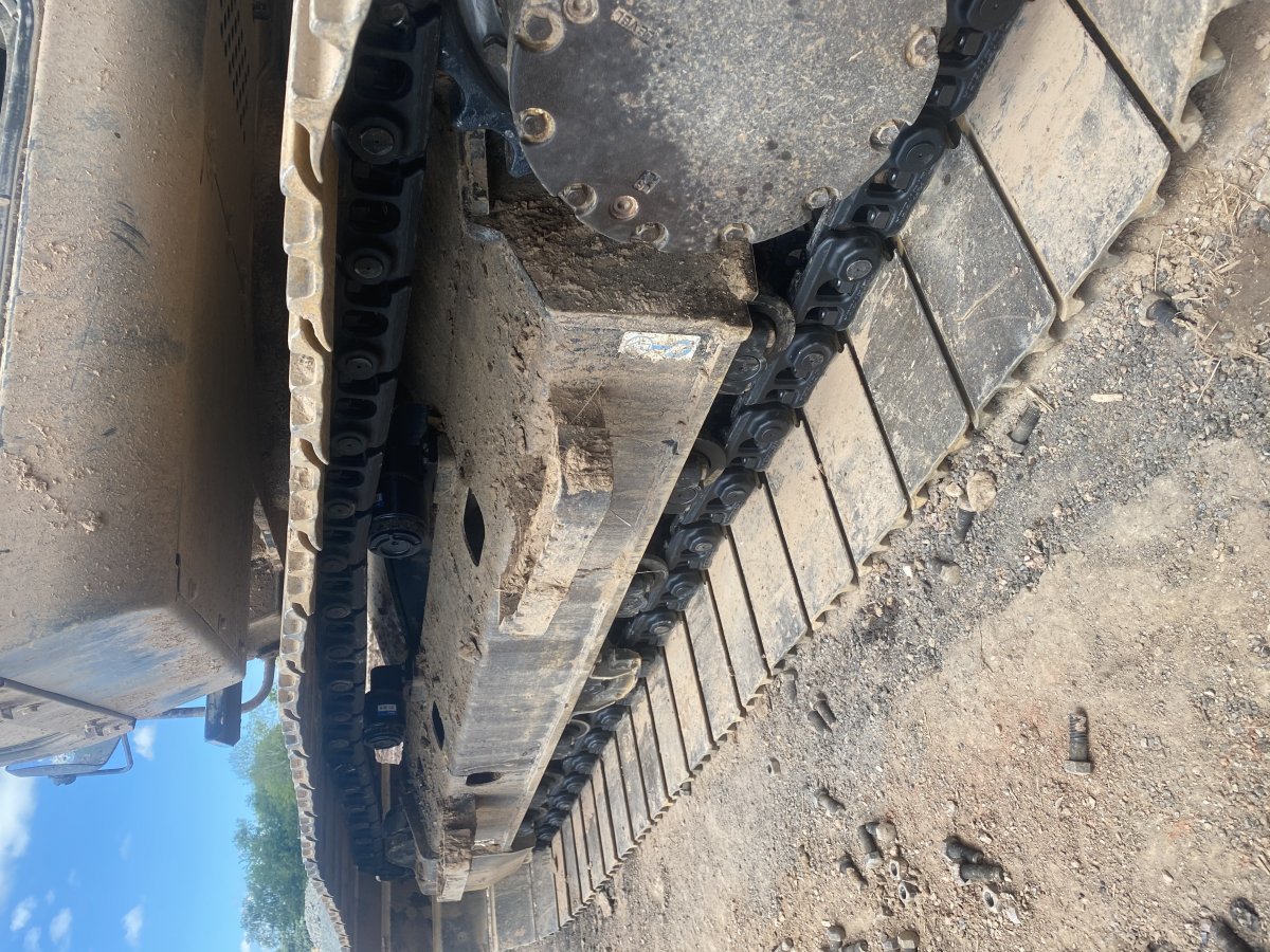

Terex J1480 undercarriage overhauled for National aggregate company.
New track chains and bottom rollers and sprockets
multiple cracks in both frames and main crusher welded

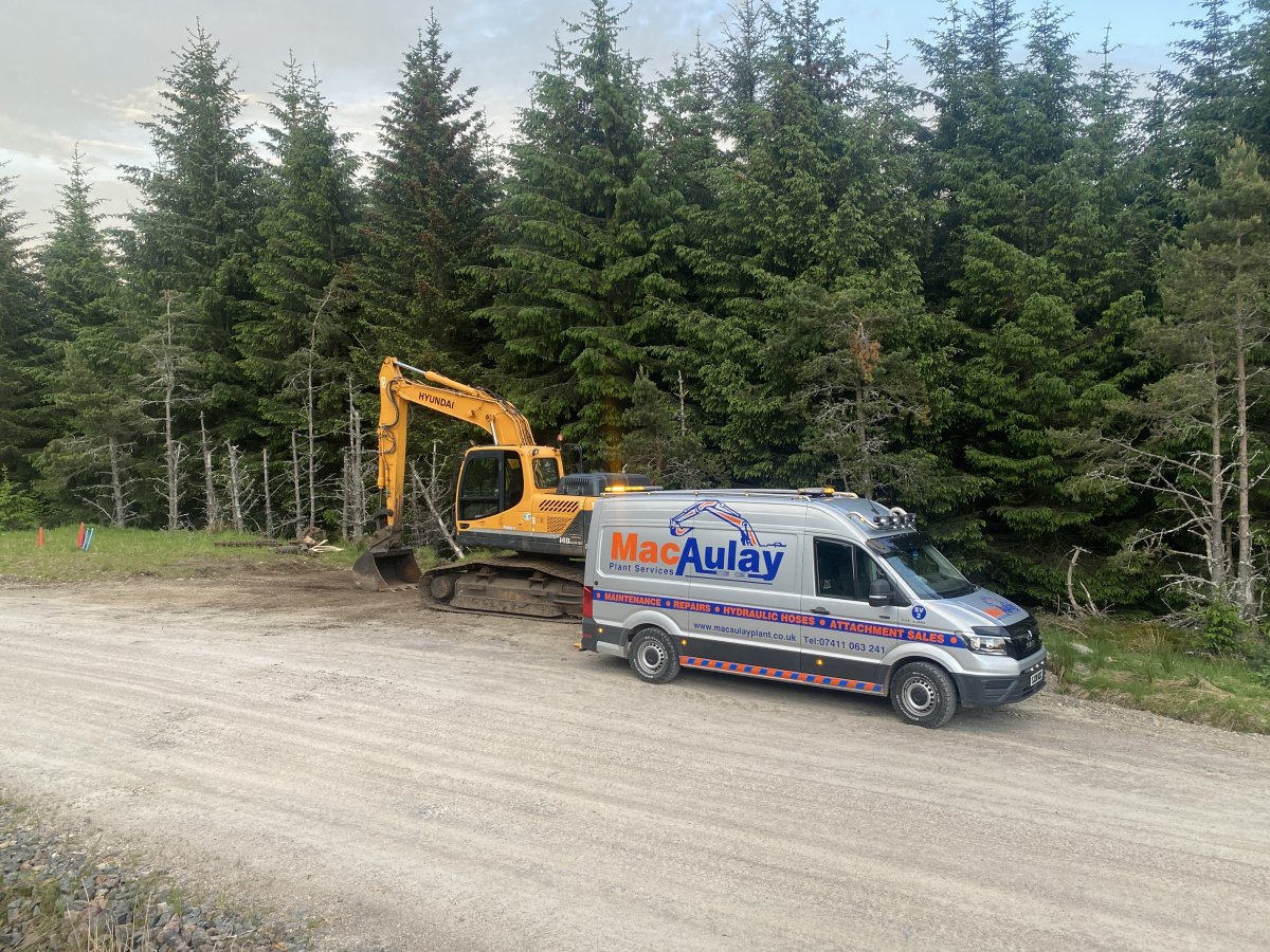

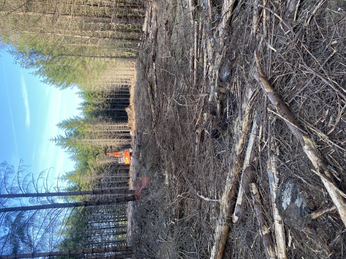

Bonnie weather tha past few weeks working up in the highlands at dornell wind farm for the highwalker Hyundai then upto gairloch for repairs on on hitachi

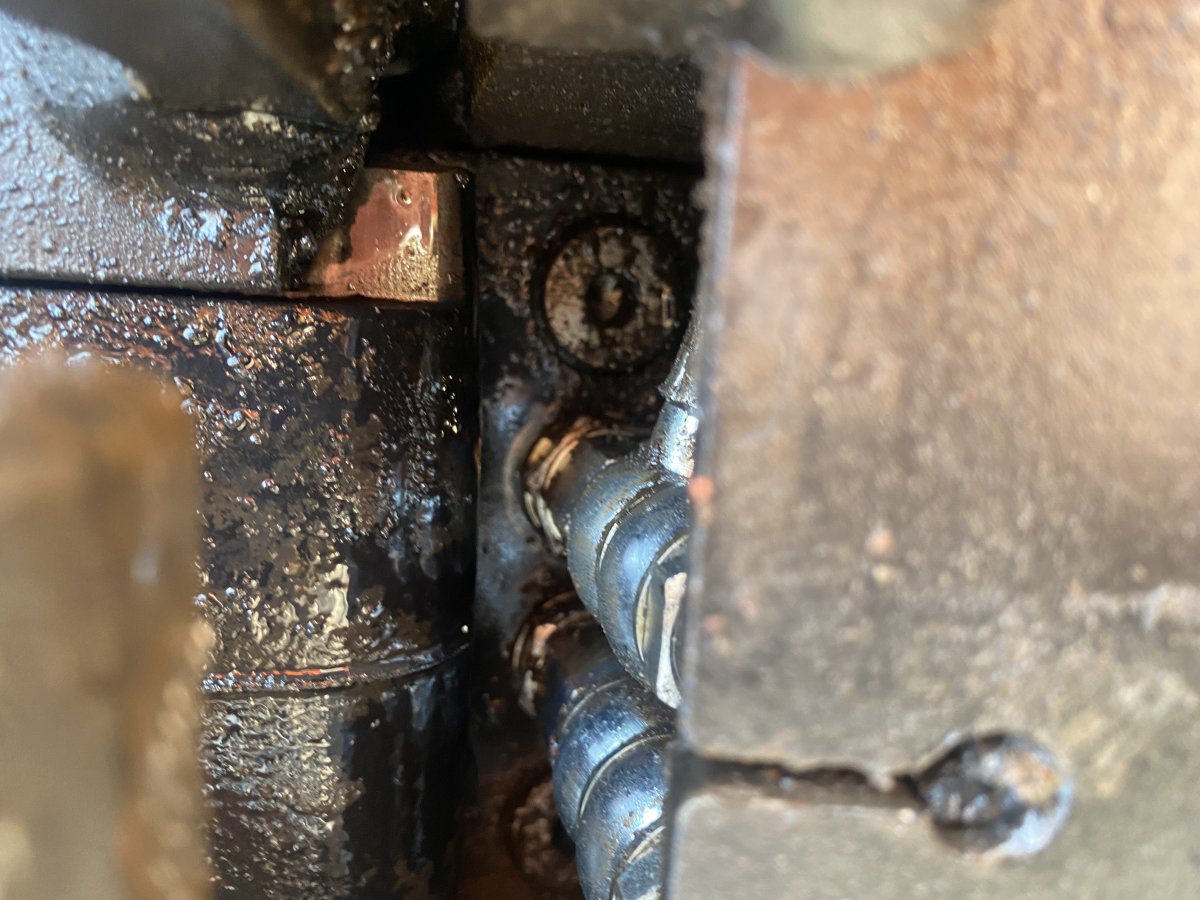

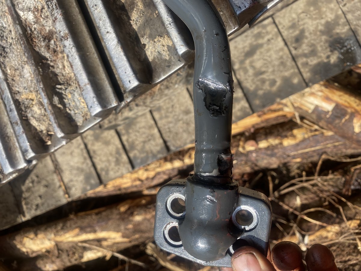

Main pump feed hose burst, the joint was behind the engine

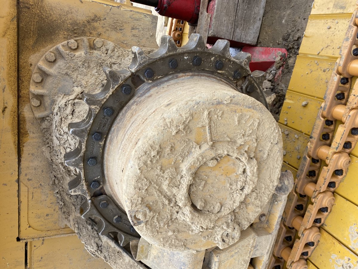

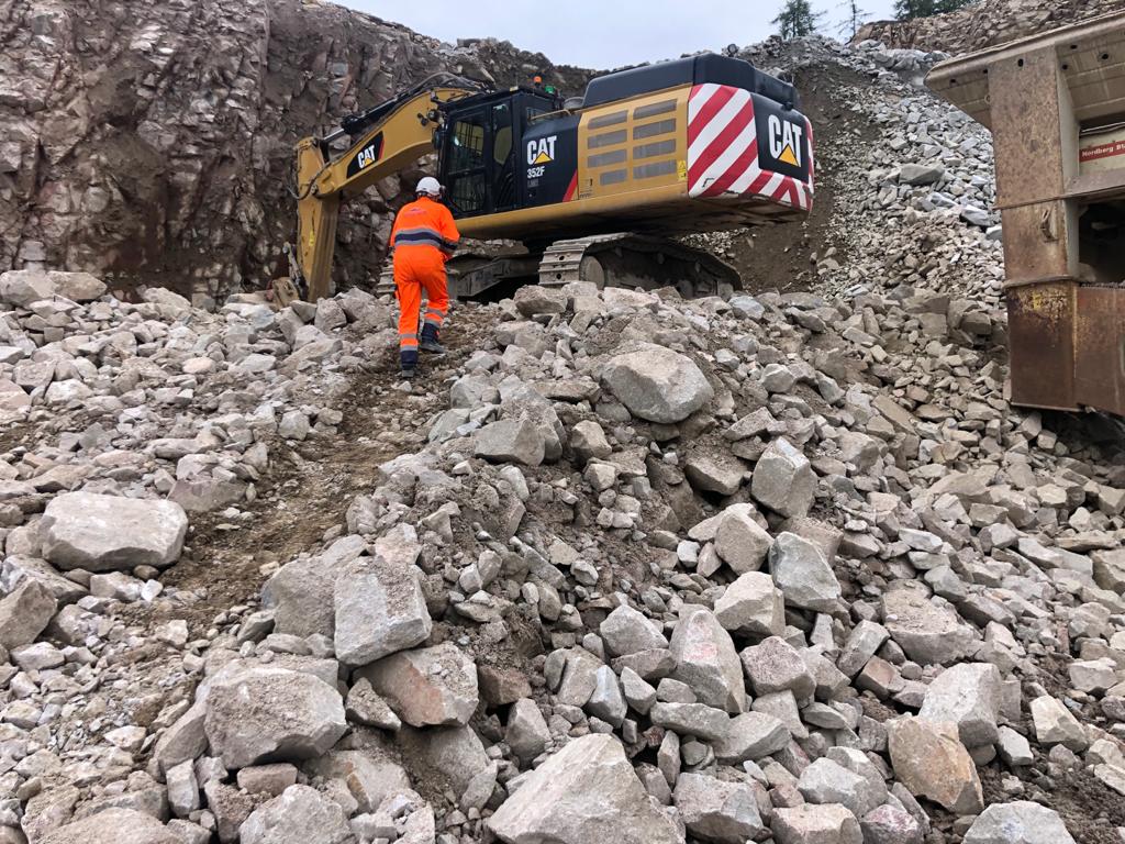

Cat 352 with sprocket and drive issues, both final drives pulled and sent to machine shop to put in radial drill.
Strip and rebuild tracking motor and counterbalance valve
Sprocket bolts come slack and damage the final drive casing?
No, bolts had stretched

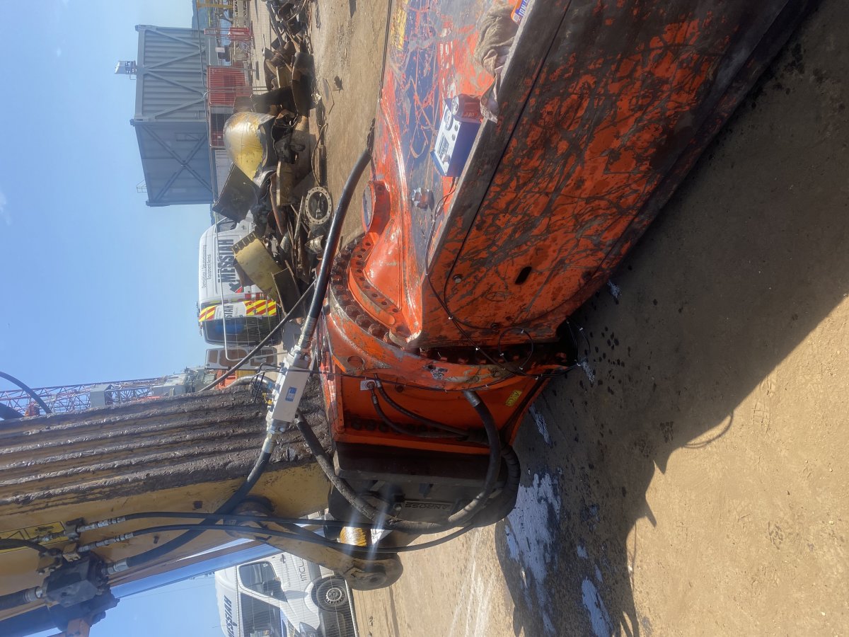

Few jobs out an about last couple of months.

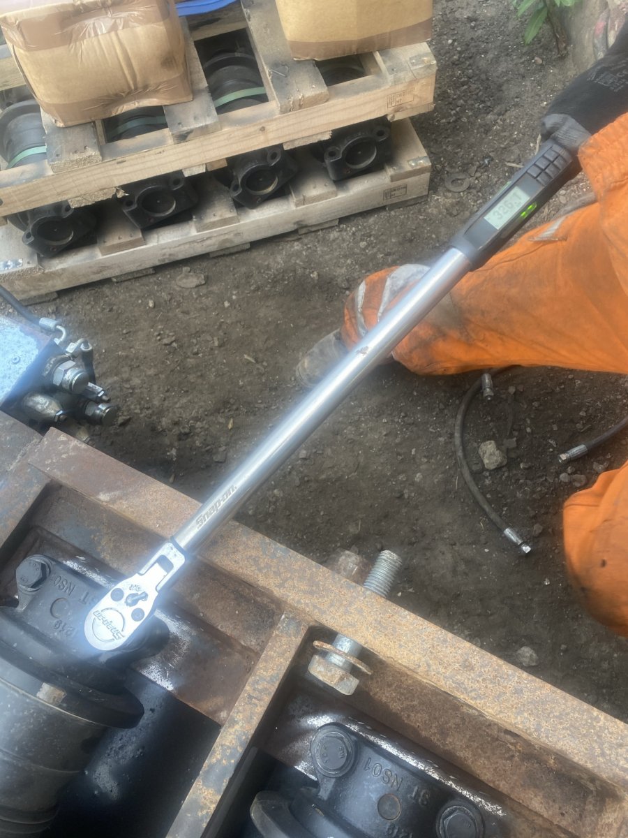

Hitachi 480 ram seals, 17000nm the nut was torqued too.

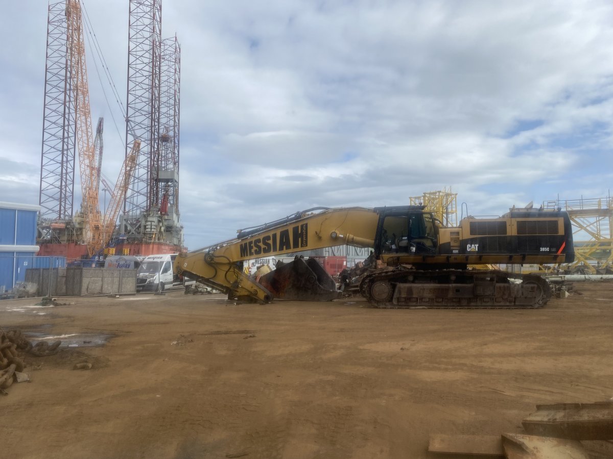

Cat 352 repairs in Aberdeen

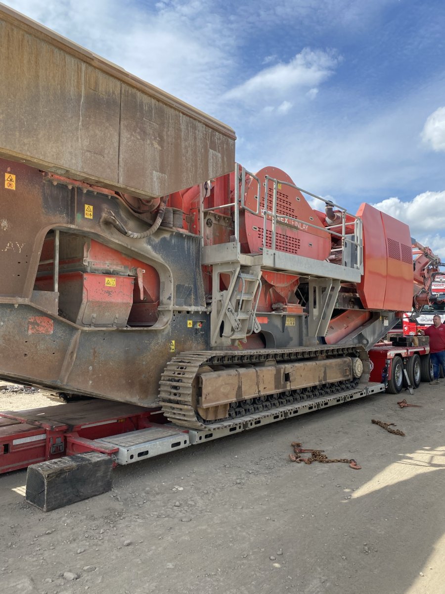

Crushing squad repairs

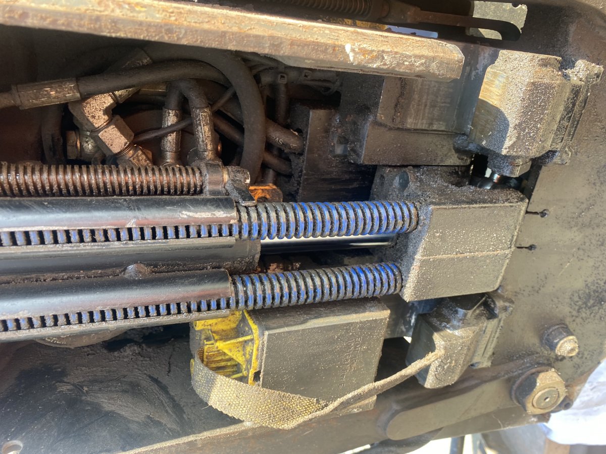

lively little cat that we Carried out an undercarriage conversion on

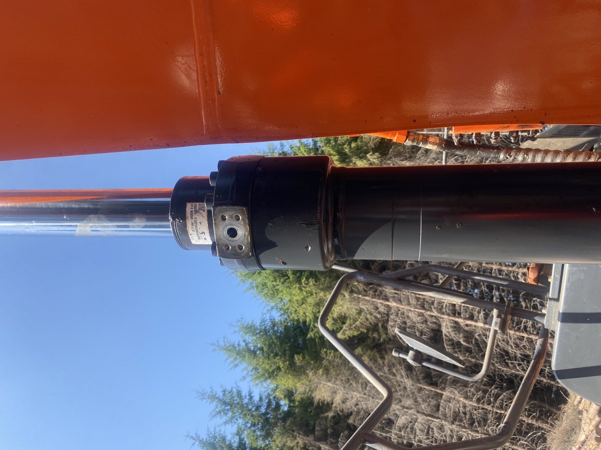

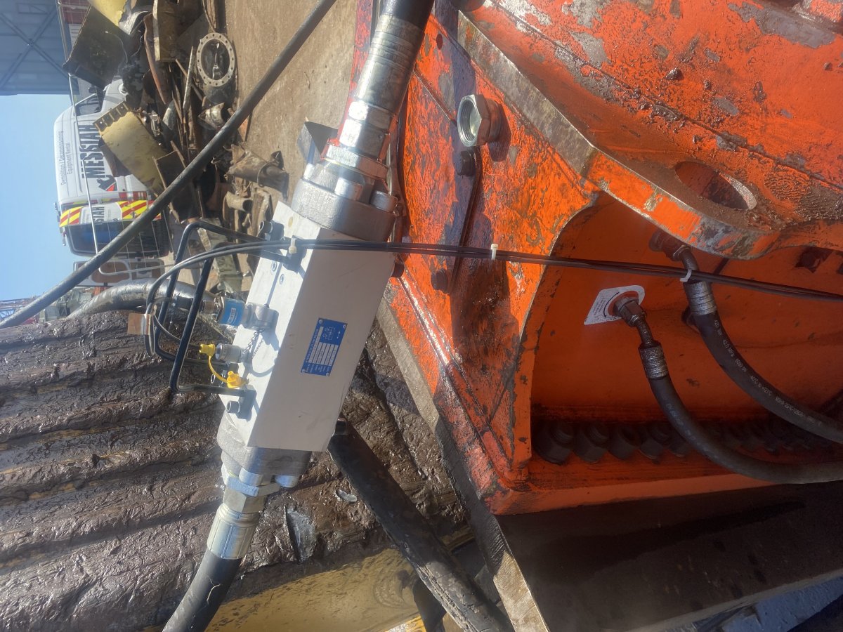

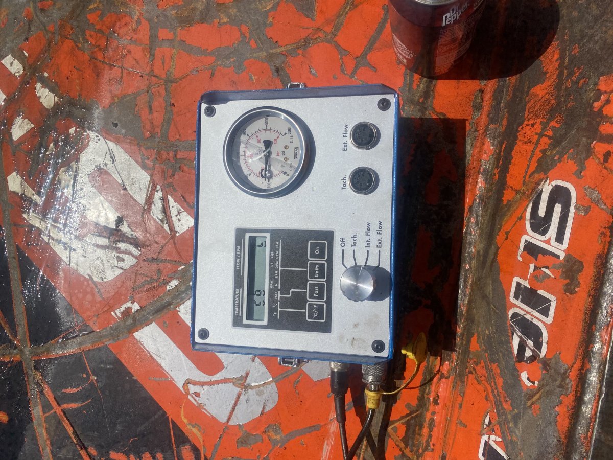

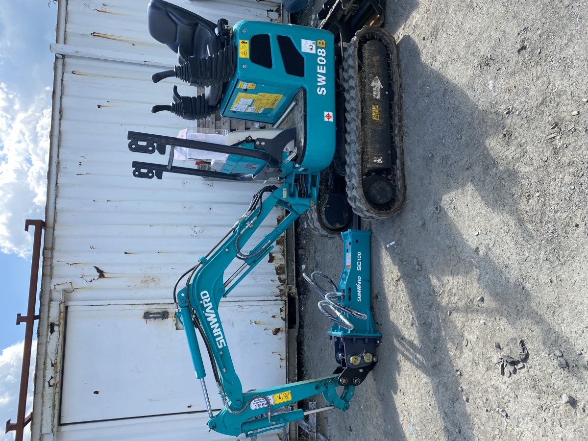

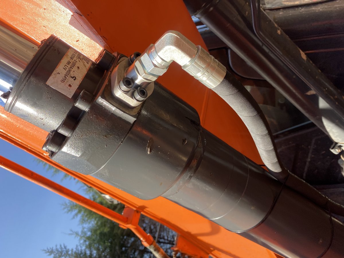

Installing and commissioning a new sunward breaker into a sunward micro.
cat 385 with hydraulic issues in Inverness.
Check computer side with CAT ET then flow and pressure test machine.
Shear at fault
Remove dipper ram as suspect gland coming apart
