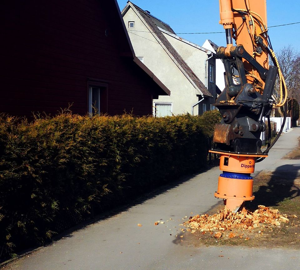

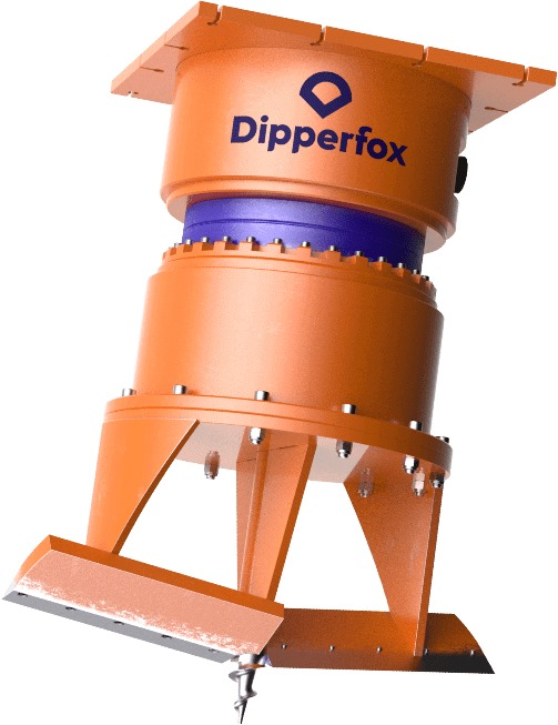

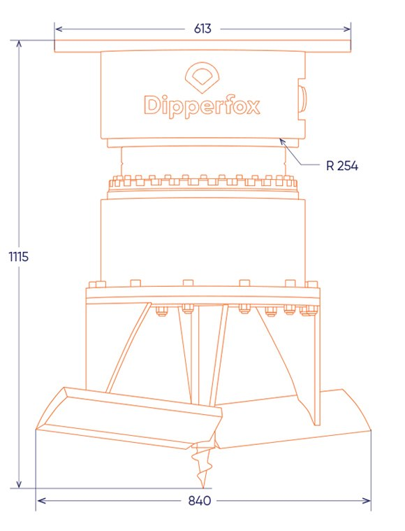

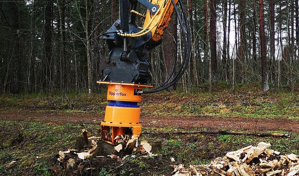

take a look at this for wood destruction :oops:
(20+) Marketplace – Dipperfox Stubbhyvel | Facebook
" A new effective way to get rid of costly stumps! 20 seconds / stump!
This is a rational way for companies that handle a lot of stumps (1000+)
The stubble planer drills through the stump and their roots and pushes all remnants into the ground. In this way, further handling at the felling site after the work has been carried out or transporting away stumps is avoided.
Rec. Machine weight: 12-30 tons
Oil pressure: 180-350bar
Oil flow: 100-220L
Only at the Equipment Store
Read more at: www.eqs.se."
