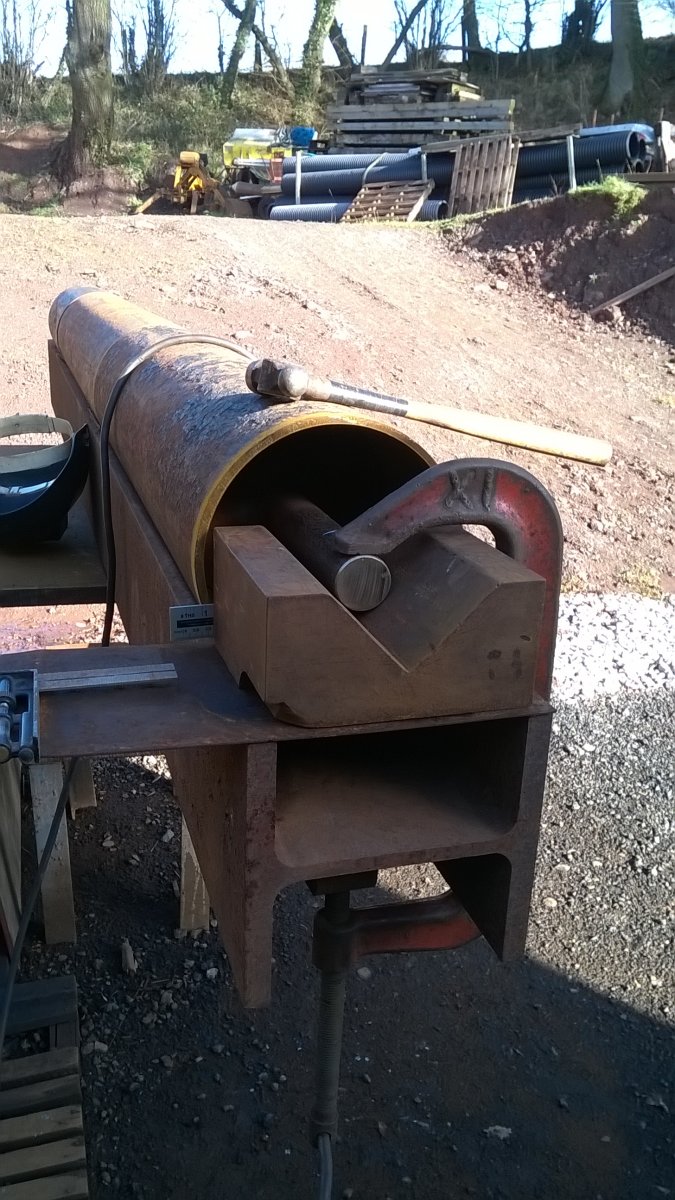

Is yer big vee block steel or cast iron?
I have heard of cast iron ones shattering when used under a press.

't is machined from a large block of mild steel @Rob65 ...... used to use it in work with my 60t press :giggle: ... bent 100 x 20 sweet (y).... splitter won't though :LOL:

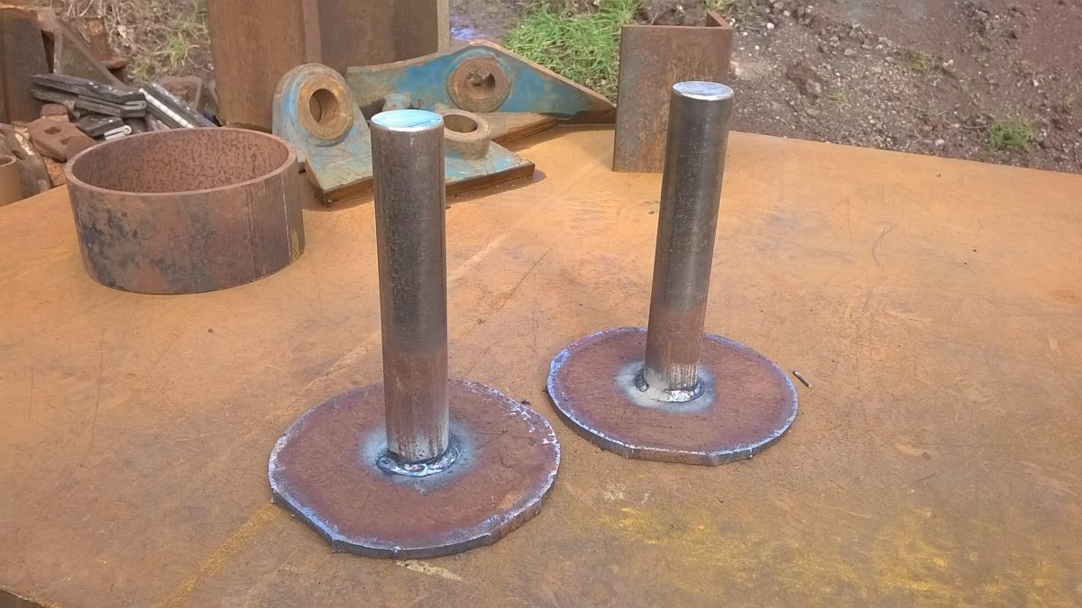

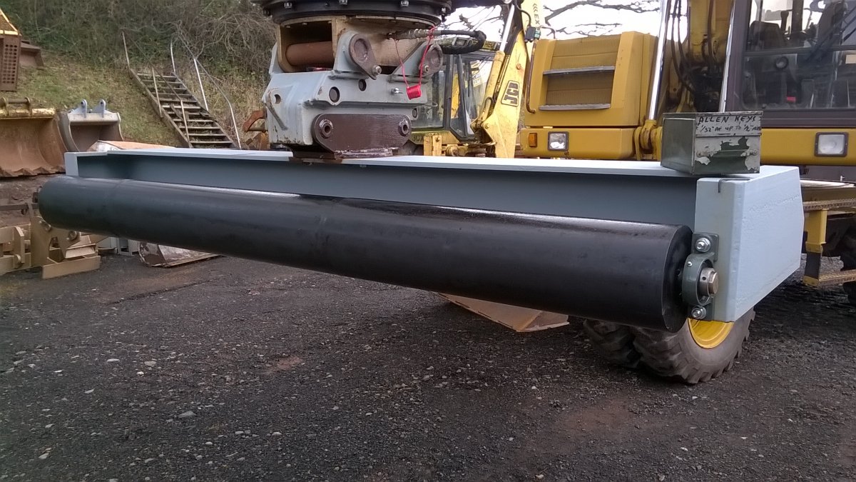

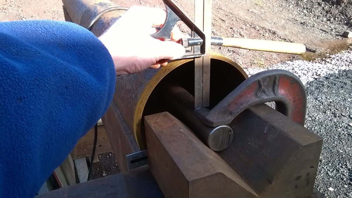

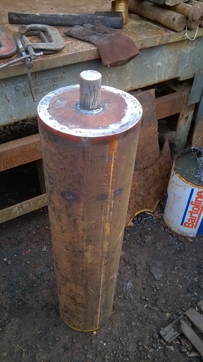

centring an axle for the roller on me grading beam
these got stitched inside the tube,
welded up and then a disc on the outer end
both ends ..... etc.

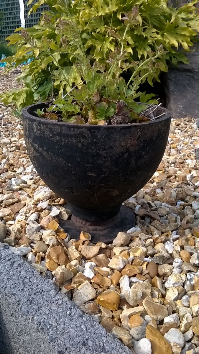

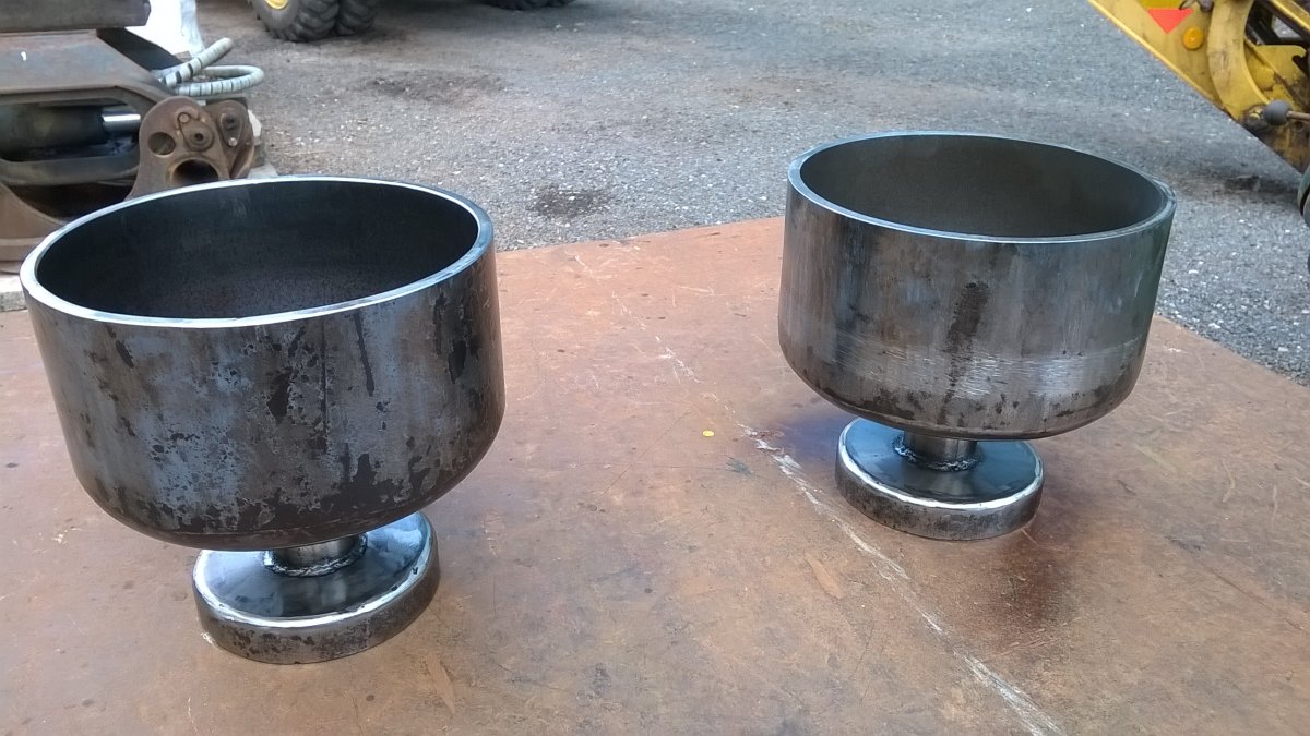

oxy bottles don't come in 10ft lengths, so had to join a few ..
tops and bottoms make good flower pots for Pam
WP_20200513_16_38_05_Pro.jpg WP_20200513_16_38_45_Pro.jpgWP_20200513_17_53_52_Pro.jpg she likes the 'industrial look':giggle:
