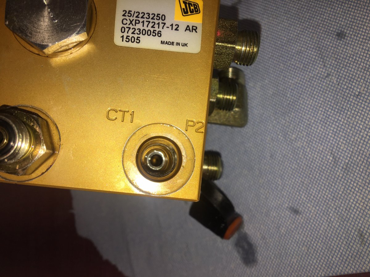

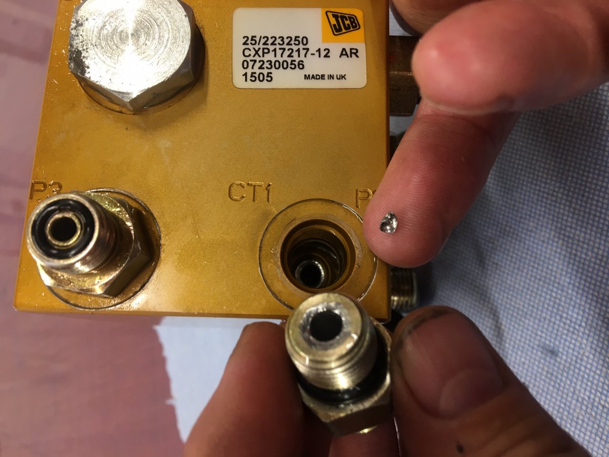

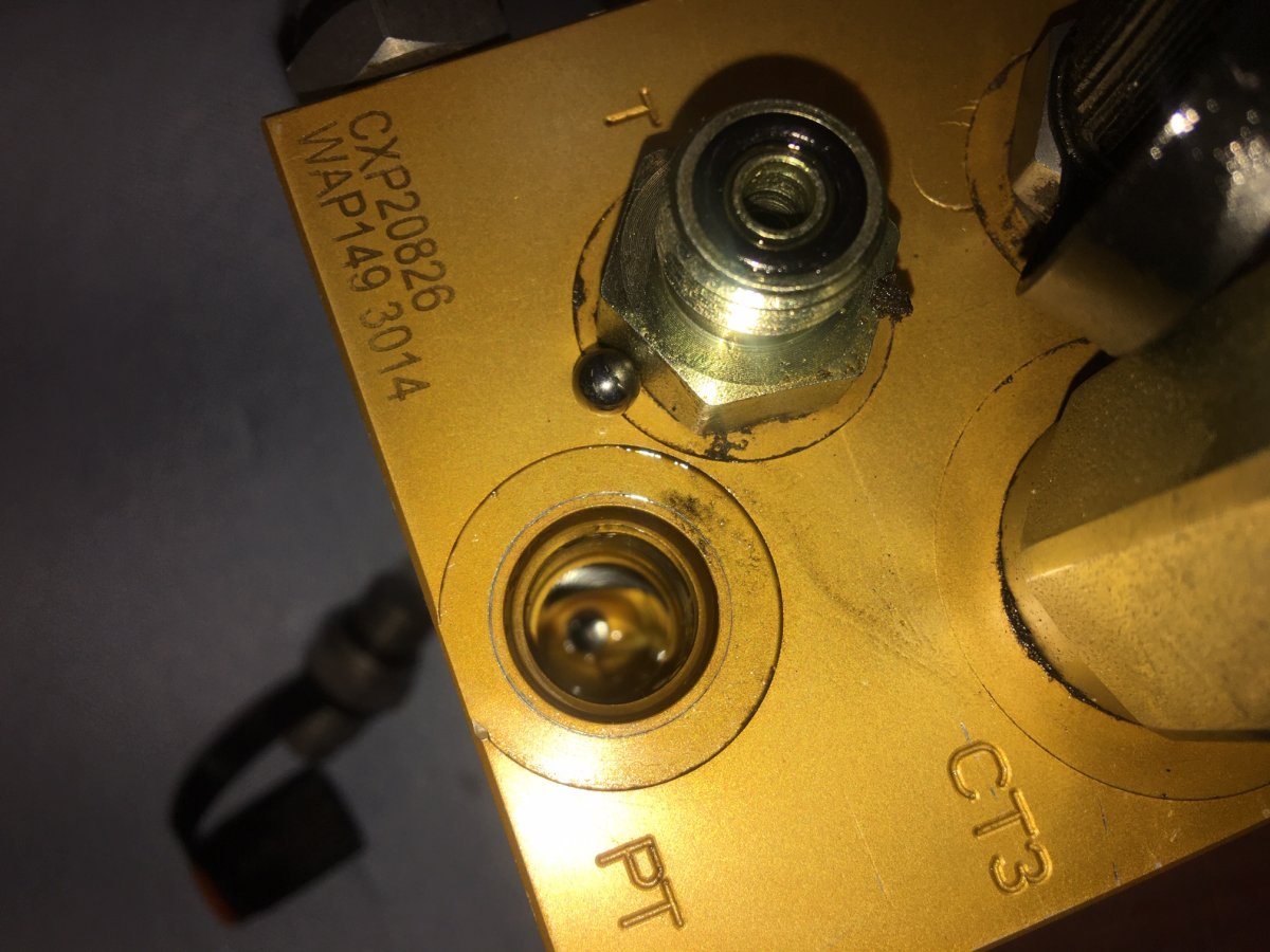

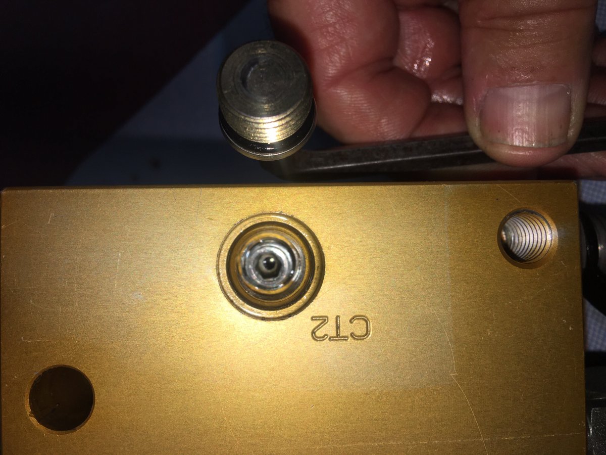

Did you get anywhere with this? Whilst I was looking for some info for another job I found someone having a similar issue to yours. Have you checked servo pressure? There is a block that regulates pump pressure down to Servo pressure located near the main pump. Usually a gold coloured block, there are shuttle valves inside that can pop apart and cause the symptoms you describe. Worth a look I reckon? They are located behind the Allen bungs.
So I've eventually got back onto the 'bain' of my life this JCB!!
Very helpful @jd6820 suggested i take a look at the shuttle valves on the gold test block, along with someone else (in the know 'wink wink'!) suggesting if all is well with the shuttle valves and the block in general to cap P2 & P3 off (hoses and the block) and see if that makes any difference.
So today i took the block off to have a look at primarily the valves first before capping P2 & P3, however what i have found does not look right!!
1 - CT1_P2 - When the fitting is removed there is nothing behind it, I expected to see some form of shuttle valve, however there is the ‘pitted’ fitting and what looks like a damaged ‘seat’ within the valve block, I also retrieved a small piece of metal which I suspect is the remainder of a ball bearing.
2 – CT2 - When the Allen bung is removed there is again nothing of any substance beneath with the exception of another Allen head screw/valve deeper inside, when I attempt to extract the valve it just ‘wobbles’ inside the block and doesn’t come out.
3 - PT - I removed Pt to see if I could get a better look at the Allen head screw/valve deeper inside CT2, as it is you can see it very slightly but not nearly enough to make head nor tail of what’s going on, however what was of more concern when I removed PT was a small ball bearing lurking within.
It all doesn’t seem right!, again especially on a machine that has done 1700 hrs!
This might seem a silly question but is the general diagnosis one of it's fooked......!!
This might seem a silly question but is the general diagnosis one of it's fooked......!!View attachment 17639View attachment 17640View attachment 17641View attachment 17642
PT shouldn’t have a ball bearing behind. Within that block, CT1 is a pressure regulating or ‘maintenance’ valve as jcb describe it. That has springs and I think part of the valve/seat has broken. The ball bearing I would possibly say is part of CT1 but actually say that CT2 is a check valve with a ball bearing and is linked via a passage to CT1 and therefore PT so it wouldn’t surprise me if the ball bearing is actually from CT2 and not CT1.
Im thinking you can’t get individual parts for this block so a whole assembly is required...

So just for an update got the new pressure maintenance valve block today (thank you JCB for helping us out, cannot fault your customer service) fitted it and hey presto everything works as it should.....😁😁😁😁😁
@jd6820 you clearly know your onions😁, and it resulted in the problem being sorted.
Having said that I can’t thank you all enough for your input, utterly invaluable......
To a certain hydraulic pump repair company in Redditch that rocked up in a BMW, fag on the go, took one look and said ’its the pump mate, don’t need to even look at it.....’, well pal you need to do one, I feel sorry to everyone that’s been conned by you.......😡😡😡😡
So hopefully now once I’ve put it throgh its paces, I can get it put completely back together and I’ll have a decent machine😁😁😁
One happy bunny tonight, thank you all........👍👍👍😁😁😁😉😉😉😉
