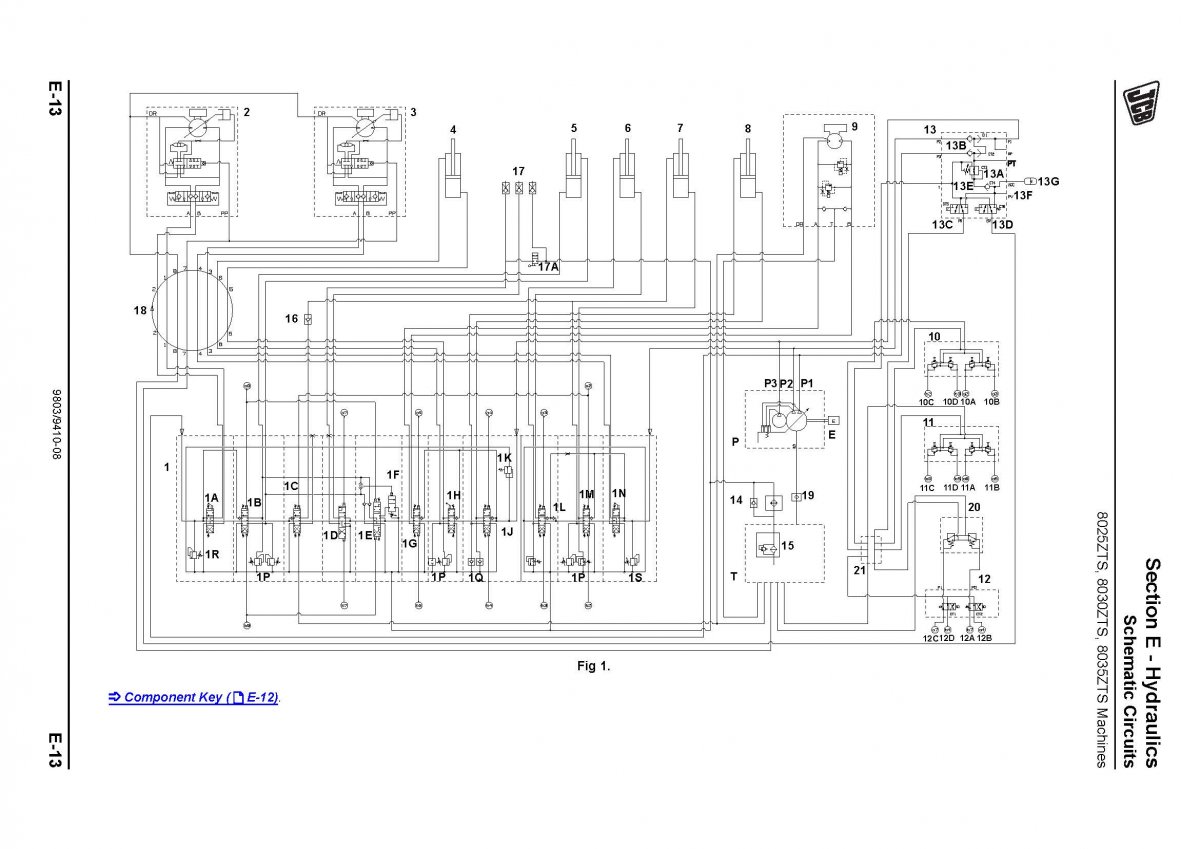

I think it point to P3 yes, Aux must be getting feed from ether P1 or P2 also! How many inlets are there to the valve block?
Cheneyjawa
Cheneyjawa
Three inlets into the valve block, P1, P2 & P3 looking at the schematic....

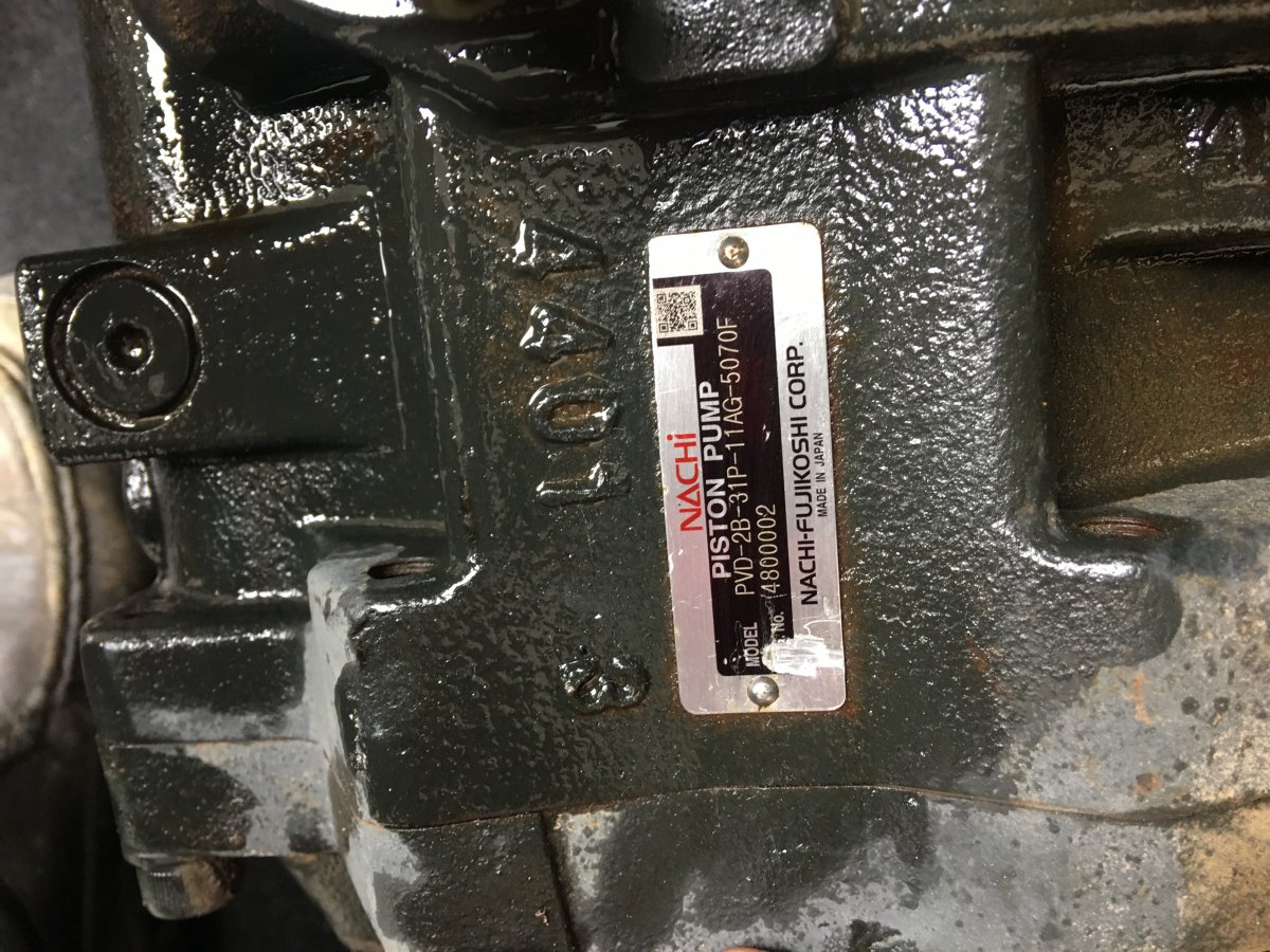

So i had a guy come out this morning in the hope he was going to test my hydraulics!, well quite how you stand there in 10 seconds and declare 'its the pump mate'!! i'm not too sure, however i'm sure he knows more than i do! o_O
Anyway I've resigned myself that it is the pump so I've whipped it off and need a replacement....
Can anyone recommend where to go, of course as cheap as possible!! :):unsure:

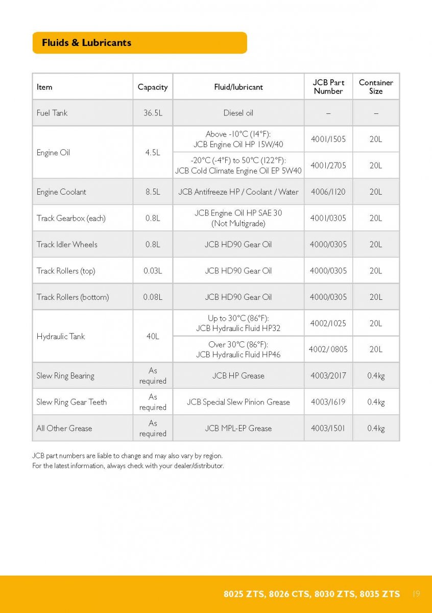

.......also this guy was horrified i'd put 32 grade hydraulic oil in (as stated in the quick start manual) instead of 46, anyone have any views on this?
Shovelhands
Shovelhands
46 is better, especially with a variable pump. But 32 isn’t going to kill it! As you’ve shown it says it’s ok in the manual. What does he think went in machines before 46 was introduced?
You could try First Plant Sales, they sell a lot on eBay, but the buy lots of stock out of the JCB auctions, so you might get lucky? If not then I think it might be worth getting it looked at by a hydraulic pump specialist, it might be repairable?
So what checks did the guy do to confirm it was the pump?
Yea id be trying a hydraulic specialist for a repair as it might not be as costly as you think.
Cheers, i'll give them a shout...(y)
I was hoping he was going to come laden with test kit in a nice shiny field service van so i could have a definitive (or as near as) idea what the problem is, as it was he rocked up in his car, i gave him coffee, he had a fag and didn't do any checks!:unsure::oops:, so......
I think this is the dilemma (and to be fair i don't blame them) but the repair quote is currently £750-00 - £1300-00, they won't commit until they have stripped it....
Quite why it would be £750 if it was a very minor internal problem is anyone's guess!
