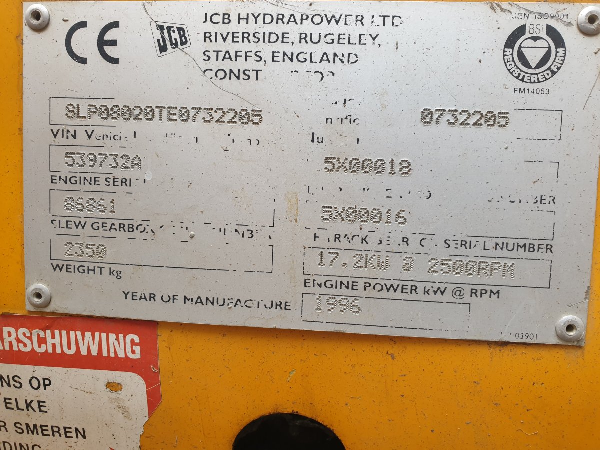

Do you have a serial no? I will see what case drain fittings there should be!

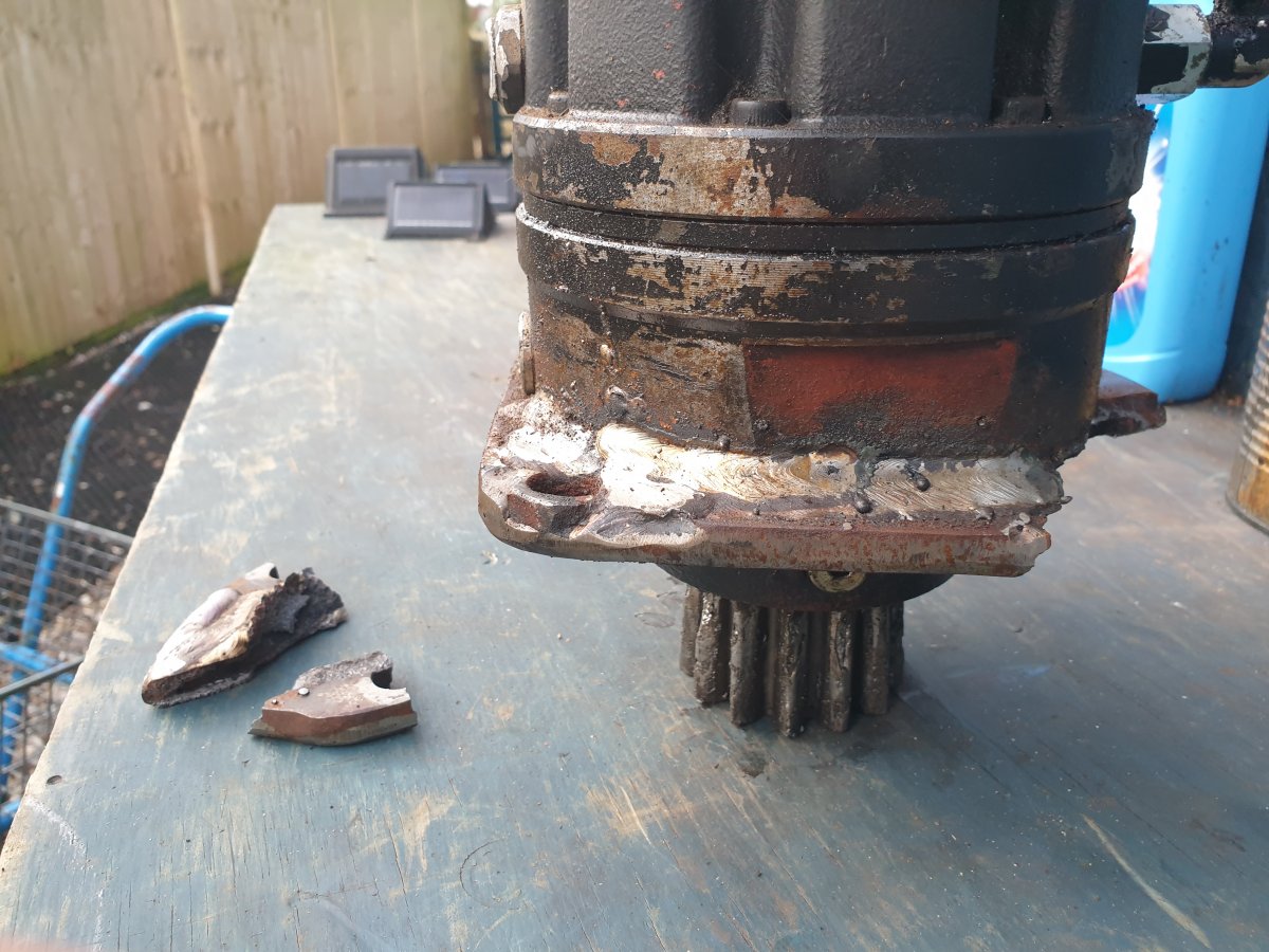

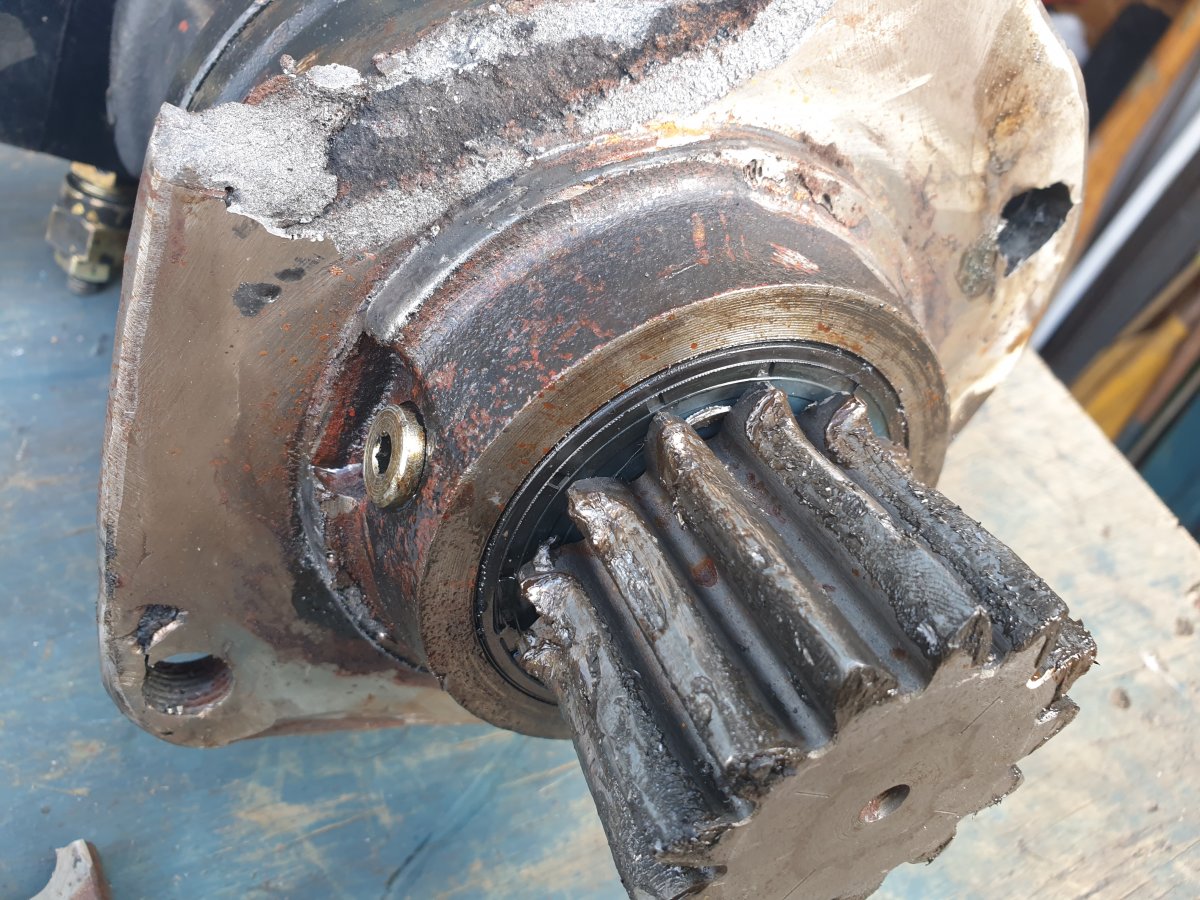

Hi people I have just had the same problem with my old 1996 802. The slew motor in the machine has had the bottom part welded together and now it has broken up and mashed the teeth of the drive. £3500.00 for a new one from JCB and a wait until mid August!!! I only bought a JCB thinking they were made in the UK and would be easy to find parts for. Anyone got any advice (apart from buying a Kubota)???

I believe on the jcb parts website you can search for part numbers from machine serial number etc

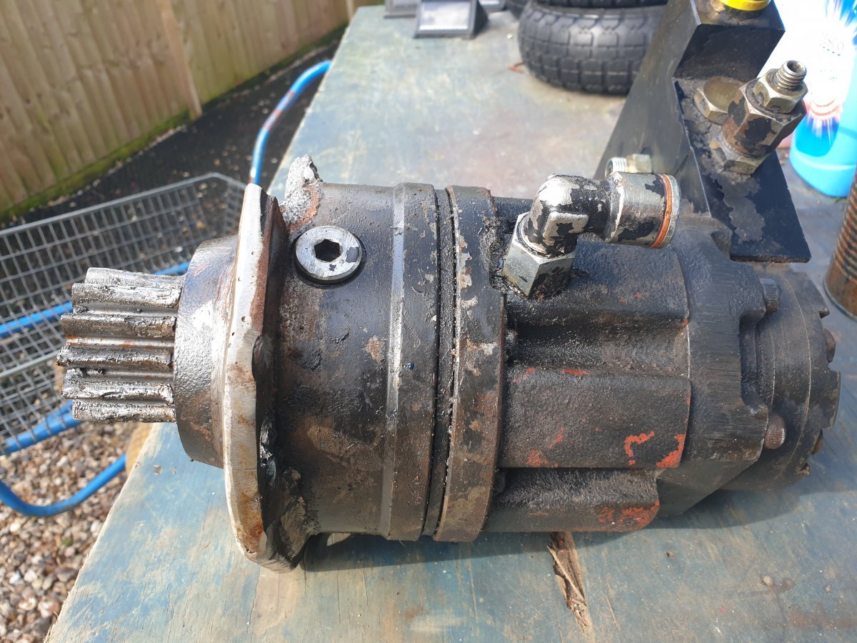

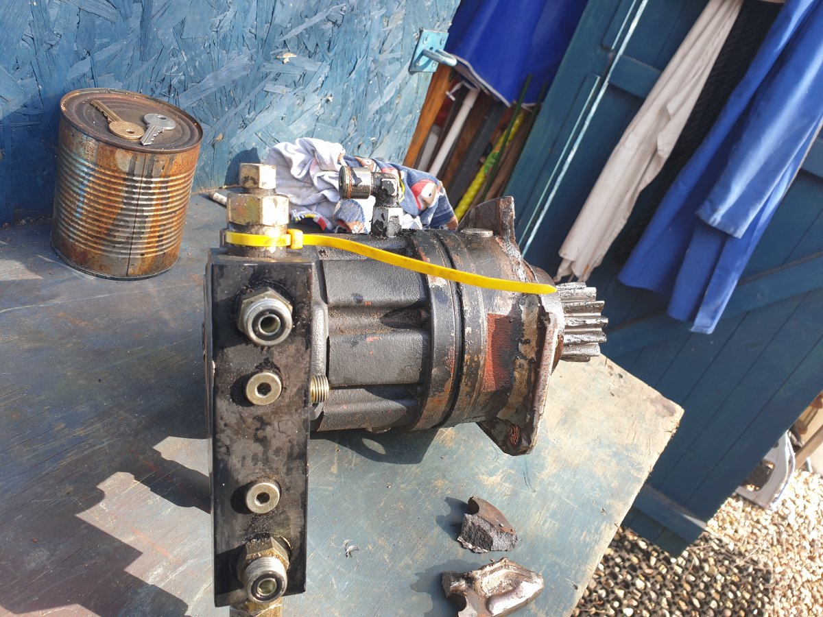

You can, give a few more views of the motor, it looks like the motor is top, into a reduction box(oil filled) from this view it doesn’t look like it has case drain, cross line relief or shock valves unless it’s external!

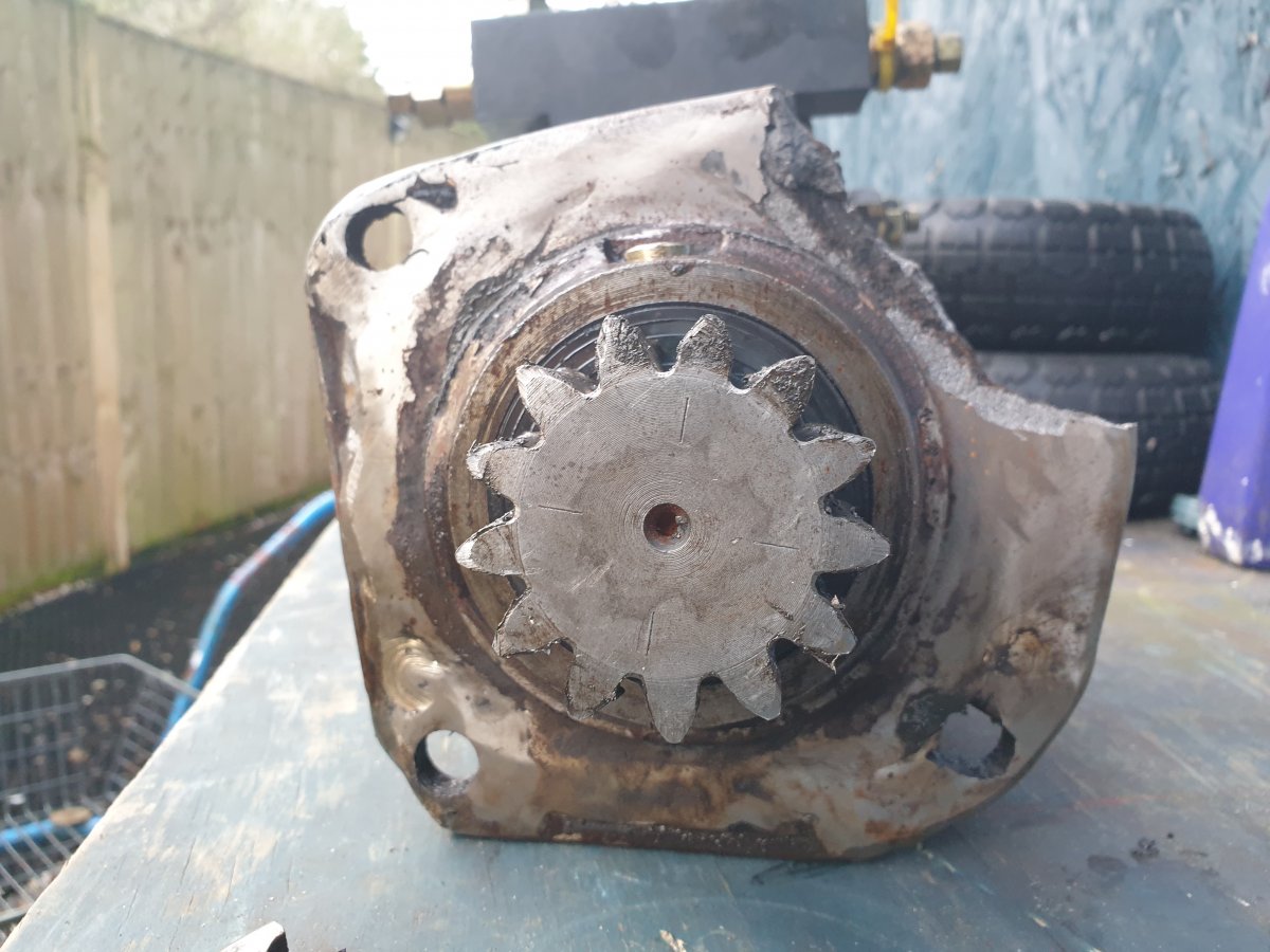

As you can see someone welded the casing up and stuck it together to sell it on.
I think you are looking at the original post of another slew motor. I wish mine was this good...
how long have you had it and where did you buy it from ? .... blatant bodgery :rolleyes: ..... hopefully a case and a pinion'd sort it if the guts're ok?

The motor part works as it should it's the bottom cast case that is f***** and now the pinion that has broken teeth.

The only thing that I worry about now is buying the wrong part that I get stuck with! Can I trust that the part number on the machine will be the part I have or has someone already used a different part etc etc....

Does anyone think I could get a machine shop to turn up a steel base & weld and regrind the pinion or am I dreaming?

Definitely bodged, firstly does it leak? looking at what is left, if it were mine I would firstly make sure there is no damage to the ring gear, the motor pinion has all its teeth although damaged, the problem looks like the repair has made the motor work off centre, wearing the teeth more at the top than the bottom, get a base plate made from 10mm plate, drill the holes to match, making sure it’s vertically and horizontally level, weld the plate in place, bolt it back in, the difference would be >10mm of the pinion (the worn part wouldn’t mesh with the ring) a bit of a task but probably cheaper than a motor!
sounds like a reasonable plan Mick ... as you say, it looks to have not been perfectly perpendicular to its mate face and thus worn the pinion like it has .... presumably by "weld the plate in place" you mean to the g/box body ... some 299,s would do that fine, stitched quietly , but'd need to remove the existing flange or it'd sit cock eyed again ...... 's do-able but would need a shop to do it in ideally

It’s possible to repair but, only if the motor works and doesn’t leak, the remainder of the pinion that is good when cleaned up would work fine.
