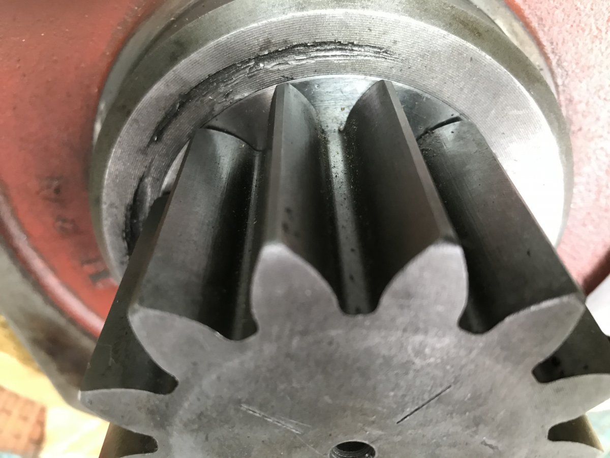

Gentlemen how are we keeping? I hope we have all dodged the covid bullet :eek:. I've been on the trail of the slew motor since we last discussed it. With everywhere closed things have been delayed and now seals for the hydraulic motor will take 10 weeks :cry:. In my quest to get sorted it seems this particulal combination of motor and gearbox is troublesome and JCB changed it, possibly even in 1996. Seals are taking an age to come and I'm not putting another motor into her after what she did with the last one. Maybe it is time to upgrade. As we bought her privately off the local JCB dealer 14 years ago I might see what they'll do me on a trade in. Any thoughts or knowledge on the 8030 models? 2006 onwards?

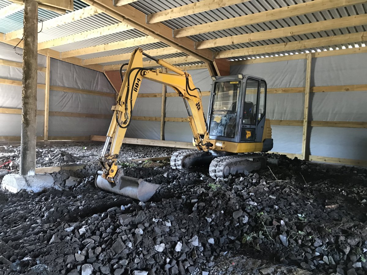

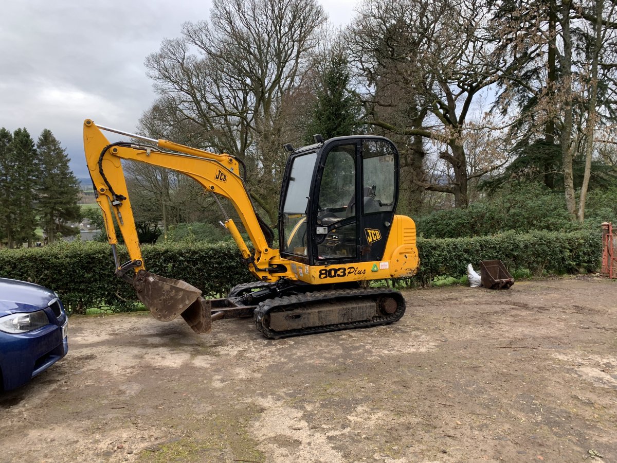

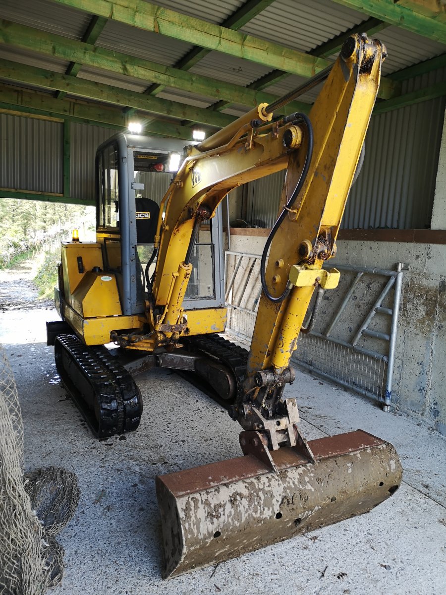

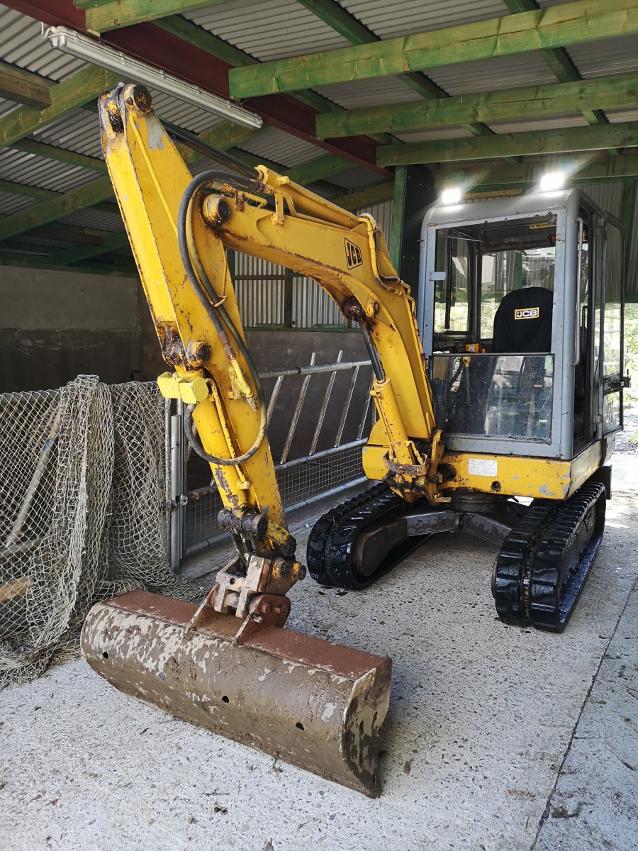

Got any piccys of the 803... I Like 803's :)
maz
maz
Heres mine to keep you going until he replies :ROFLMAO:

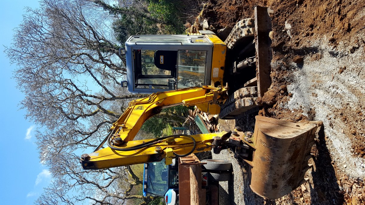

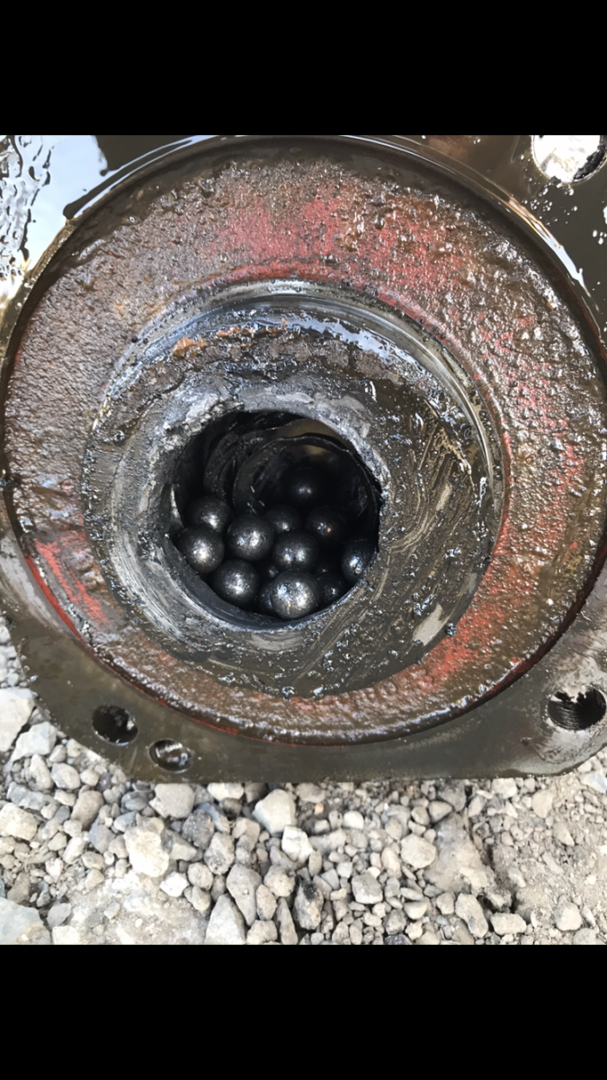

Same problem with our early 1995 jcb 804
it’s only number 17 made

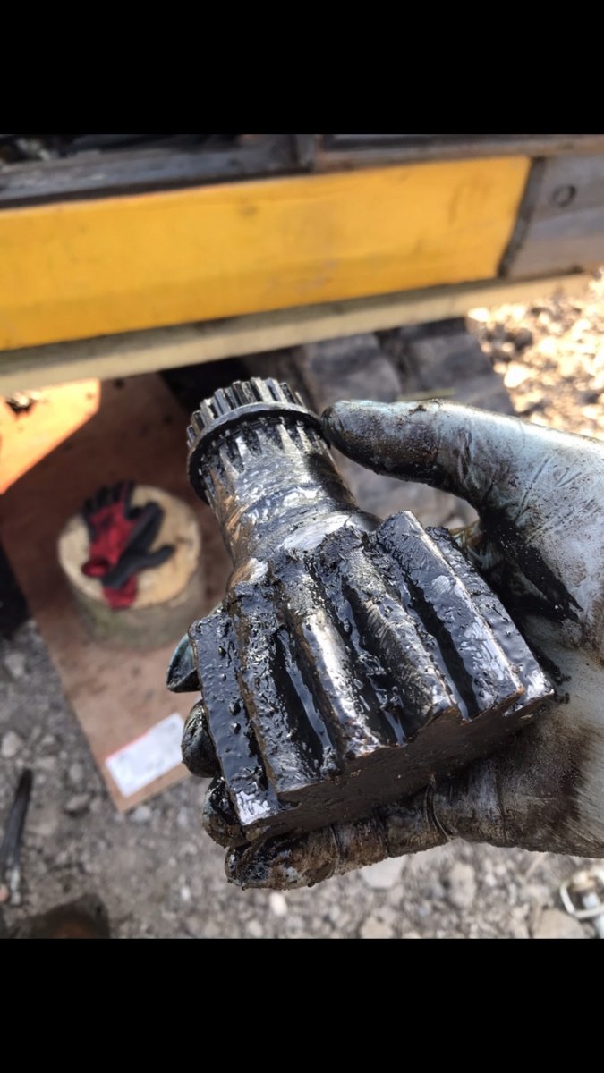

SOM slew gearbox totally s**t itself in march
couldn’t get parts, got it fixed by an engineering company
2 months later it’s just started dripping again

I'd be pretty PO-ed with only two months out of that repair .... bet it wasn't cheap !! :oops::cry:
hell of a long dipper on that, isn't it ? shame about the issue, looks a tidy tool .
Cost nearly £2,500 to fix

Yes
It’s a hell of a long dipper
digger is actually too big for what I need
looking for a 2 tonne digger and sell this one next year, but there is nothing about...

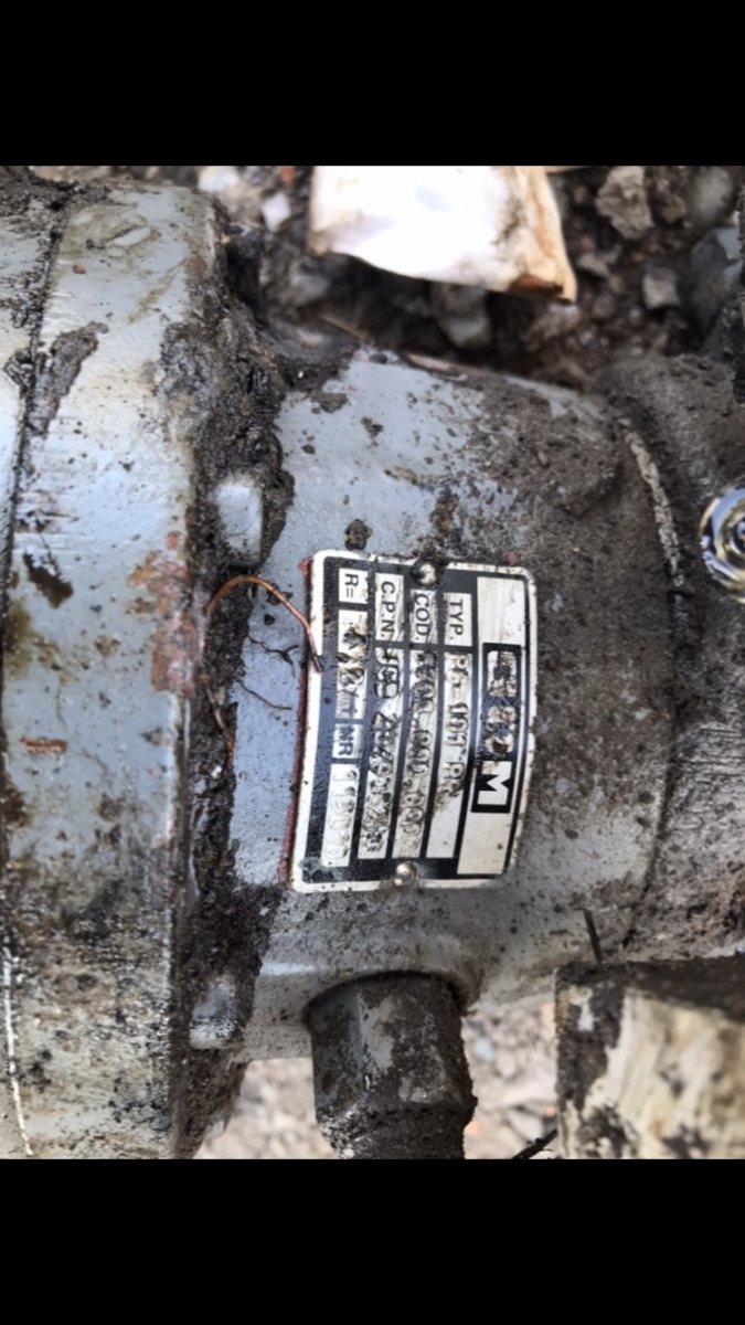

Oh man 🙈 I've waited 10 weeks for seals for the hydraulic motor, which the company "thinks" are the correct ones. Zero help from our local JCB dealer. Quoted the cost of the seals but not in stock with them or with JCB. Asked him what my options are then and he didn't reply. Asked him if any second hand machines in stock and salesman rang me that evening! Going to rip it out again. Dismantle motor nd gearbox and replace all seals. Check case drain and pressure test it. If it goes after that I'll be on the lookout for semtex🙈!!!
where did you get the seals?
I had to order parts off hydraulic plant services in Sussex last time.
it was a hell of a job just getting the part numbers, luckily my brother in law works in research and development at jcb so emailed me the drawings....

I've used 777parts.net to get parts numbers and drawings. Pay like $10 for 24hoirs access where you can print off and save drawings. From there I go to urparts (Google) and you put in make, model, part description and number and serial number. Suppliers from across Europe come back with quotations if they have the part. I bought a motor from White House Products in 2017 and got seals from them then. Our JCB dealer was near €1000 for the motor and it had already s**t itself. A vicious circle 🙈
