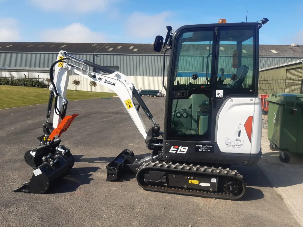

E19 is a single pin. To my mind it makes more sense- less cost overall than two small ones surely?
Id have thought so too. Suppose it makes it easier to route all the hoses centrally through the kingpost- less rubbing etc but who knows why they've gone that way.
The kingpost isn't though- that's what I'm referring. The old TB016 used to have a single pin to fit the kingpost to the digger but now everything seems to have gone split pin
as said, as a split pin they really need to be a press/interference fit and have a couple of good size grub screws to keep them as stationary as possible ... a single locator/retainer bolt will do absolutely sod all to prevent the pin jiggling about in a slide fit hole - installing a couple of good size grubs at say 90-120 deg.s spacing would reduce the issues dramatically
basically a pretty crap idea -- unless you're the poor sod trying to route all the plumbing :LOL:
Hmm so little details like this should be the kind of quality acknowledged when buying a new digger. I wonder if any manufacturers do as you describe🤔
the other way of locking those pins would be a tapered cotter pin as you'd find in an old skool bicycle crank or the king pins on many steering axles (3CX 2WD for instance) ;)
Ah, I see.
Most kingposts are
