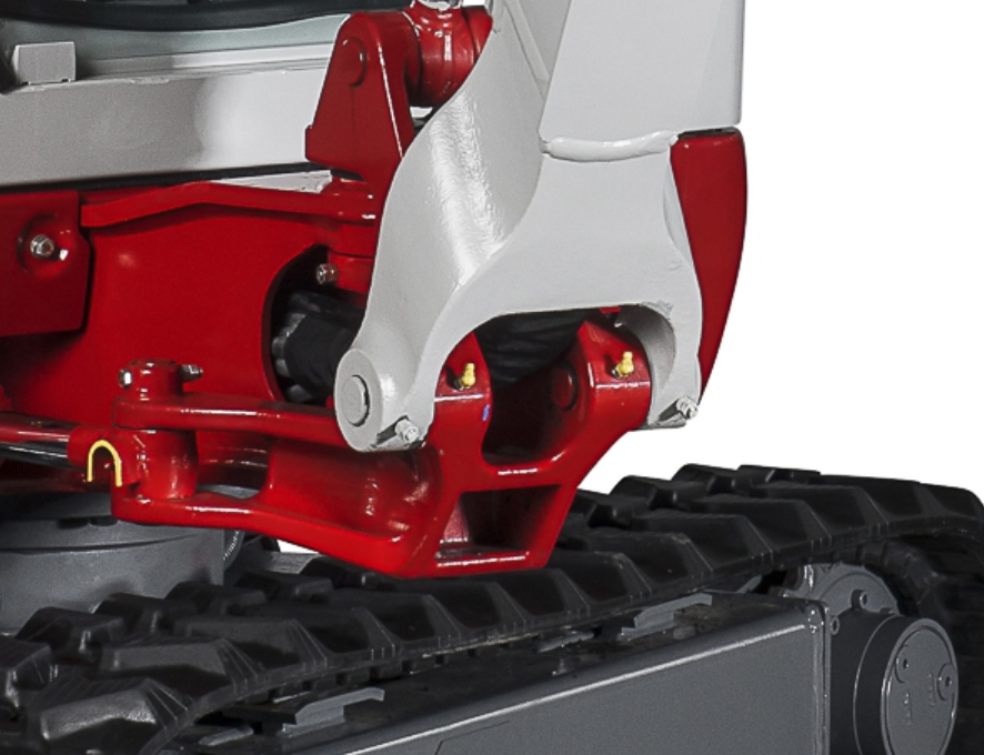

What annoys me is the TB216 which I've had from new is approaching 1800 hrs and almost NO detectable play in any of the greasable bushes. However where a pin is fixed to move with the parent metal (like each side of the kingpost) its starting to wear a little and there's nothing I can do about it. Shame the whole length of the pin can't be greased.
Is it really two seperate pins?
A singe pin would obviously provide a lot more support, but presumably something travels through that space.
Yeah the main verticle king post pin is 2 seperate pins. The old 016 was a single pin but most seem to use the 2 split pins now. But to illustrate the problem is not the blue part of the pin and bush but the green one where the pin is fixed- wear still develops here and its ungreasable.

That's a bit ugly.
I don't think grease is the solution to this problem though.
If the pins were a heavy press fit into the boom, I can see that lasting well, but being a sliding (clearence) fit, it's starting with a minute amout of play and will just pean the hole larger.
I presume you couldn't fit a single pin?
That's a bit ugly.
Fairly sure all the minis do it like that now. On my 2.8t 4500hrs it looks like there about 6mm in the kingpost untill you realise it's not in the greasable moving part but the fixed side
E19 is a single pin. To my mind it makes more sense- less cost overall than two small ones surely?

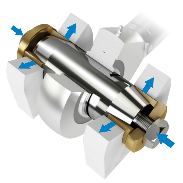

If you could fit a pin all the way through Expander would be the answer, not cheep though !E1C206F4-334B-4F62-A582-E3C1F6D1F2F6.jpeg
