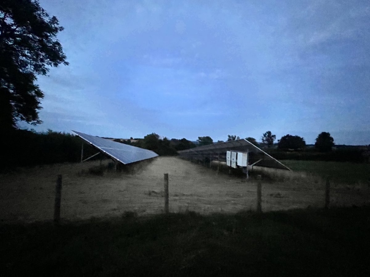

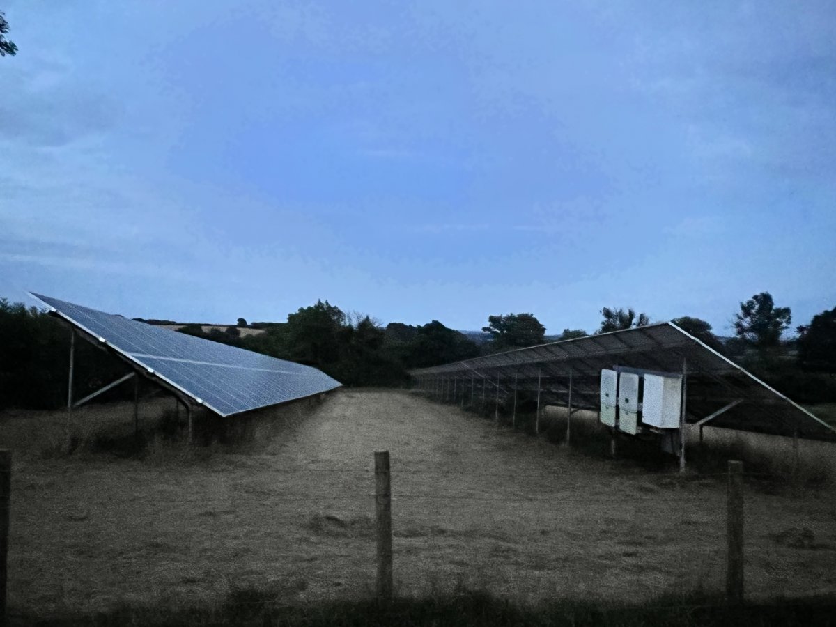

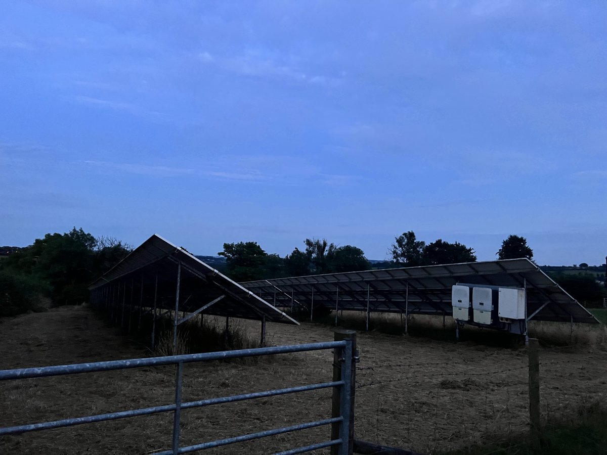

Just stayed in a farm in Devon they were like we’ve got solar, thought nothing of it till I walked bast their huge array
