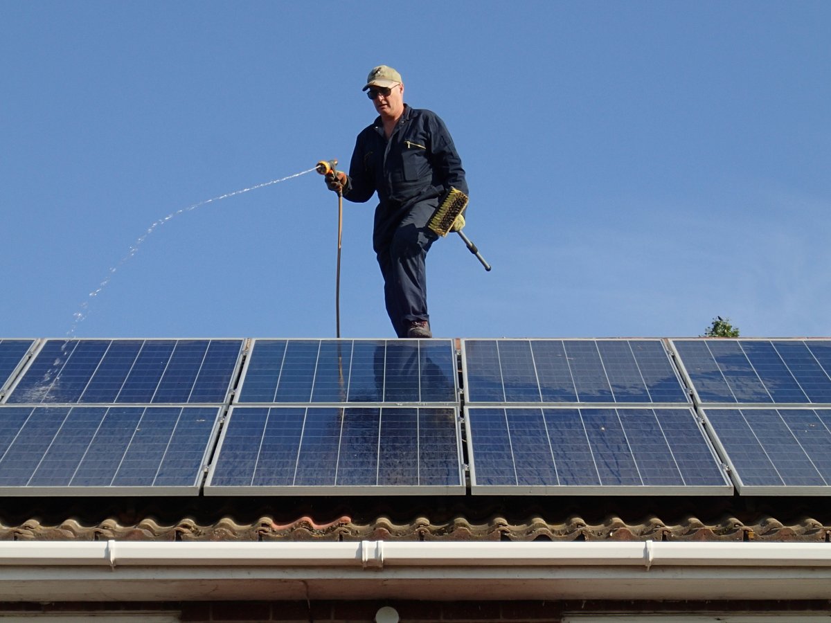

We have had 4kW of Solar on our roof facing South since 2015 with FIT :cool:
Here I am trying to encourage them to grow :ROFLMAO:
Even with a reduced FIT, it's the best thing that we did for reducing bills and doing our bit for the planet.
They have paid for themselves over and over again.
SWMBO usually put on high consumption stuff when we are generating surplus.
Usually, dishwasher, washing machine and tumble dryer etc - Sharon is well trained :love:
