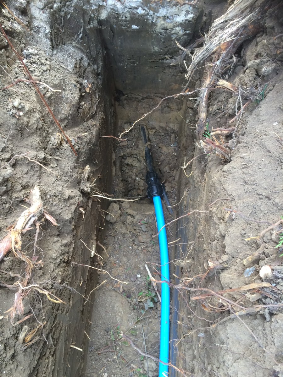

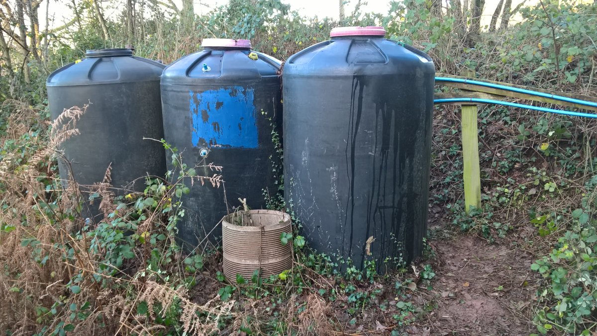

been up to the tanks today and dug out enough pipe work to be able to disconnect a joint and check for flow ... went equipped to install a stop cock in the line exiting our tank and damn me I'd already installed one when we moved them all in Aug./Sept. '16 ... started with a wilderness with pipes running all over the place .. cleared it and graded it all out .. dug a new stand for the original two tanks and I added a third for our supply's storage, pensioning off our original and creating an additional storage capacity for the neighbours.
WP_20160826_18_41_05_Pro.jpg WP_20160826_18_37_33_Pro.jpg WP_20160826_18_38_25_Pro.jpg

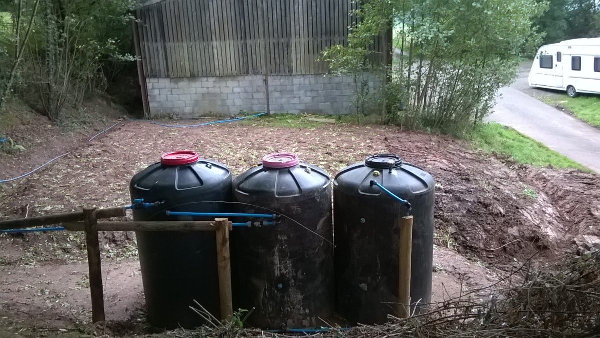

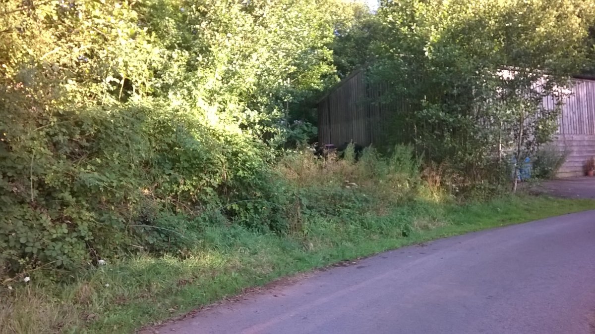

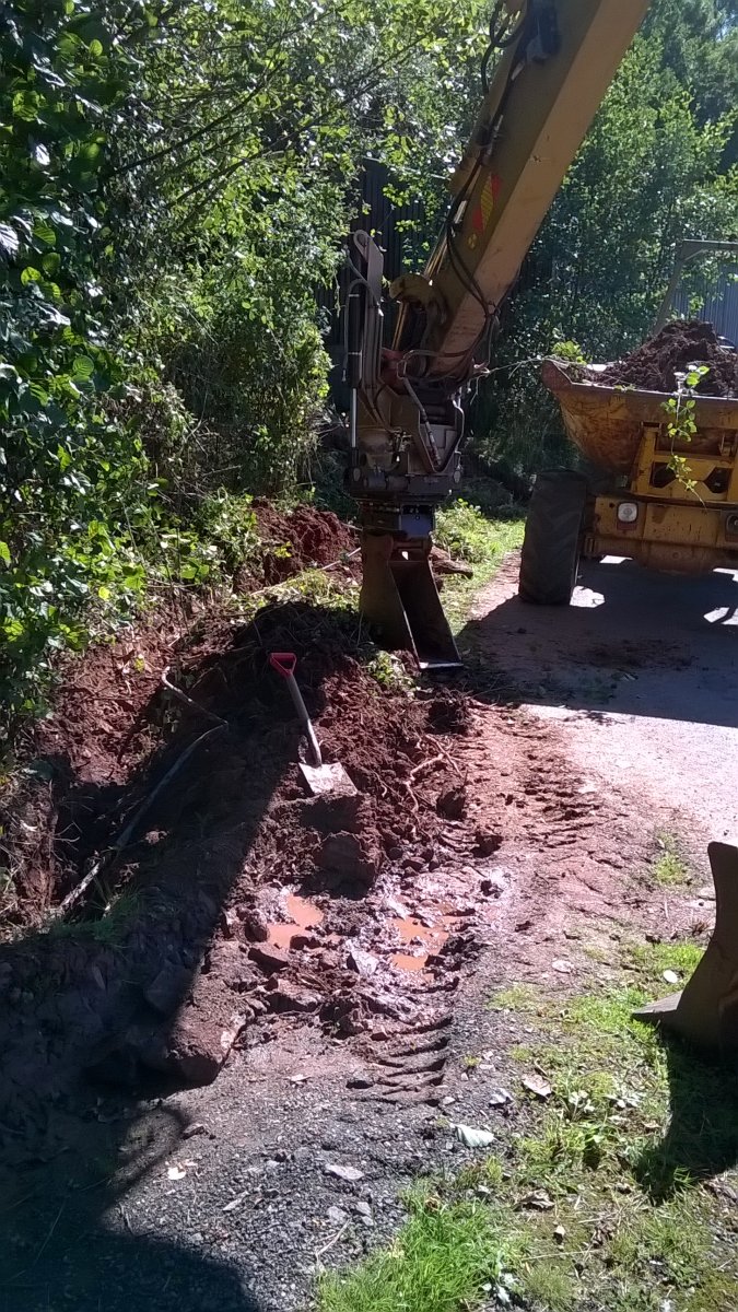

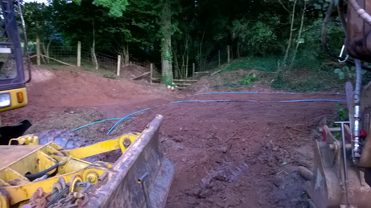

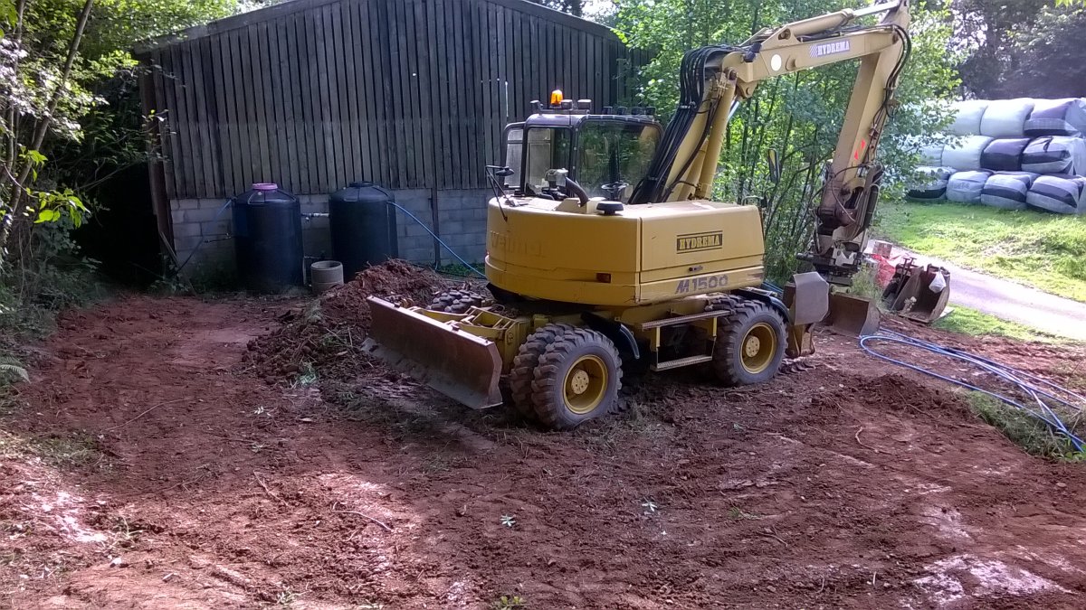

re routed the plumbing at the exit point of 'the wilderness' which was a 'fixed point' and worked back from there

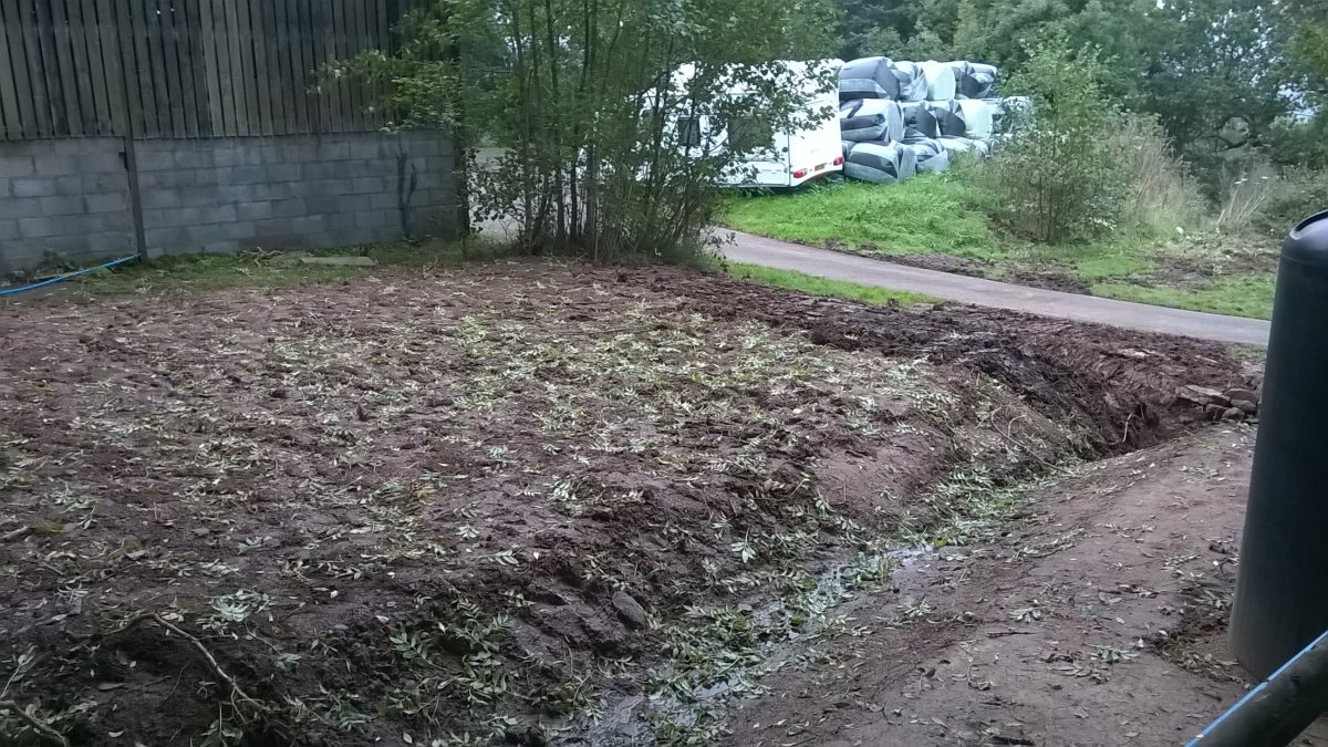

tidied that bit up a bit and then the wilderness area
had to hop the 'Drema over loads of pipes regularly doing the clear up
filled in a few drainage channels to get it all squared up and then recut them afterwards

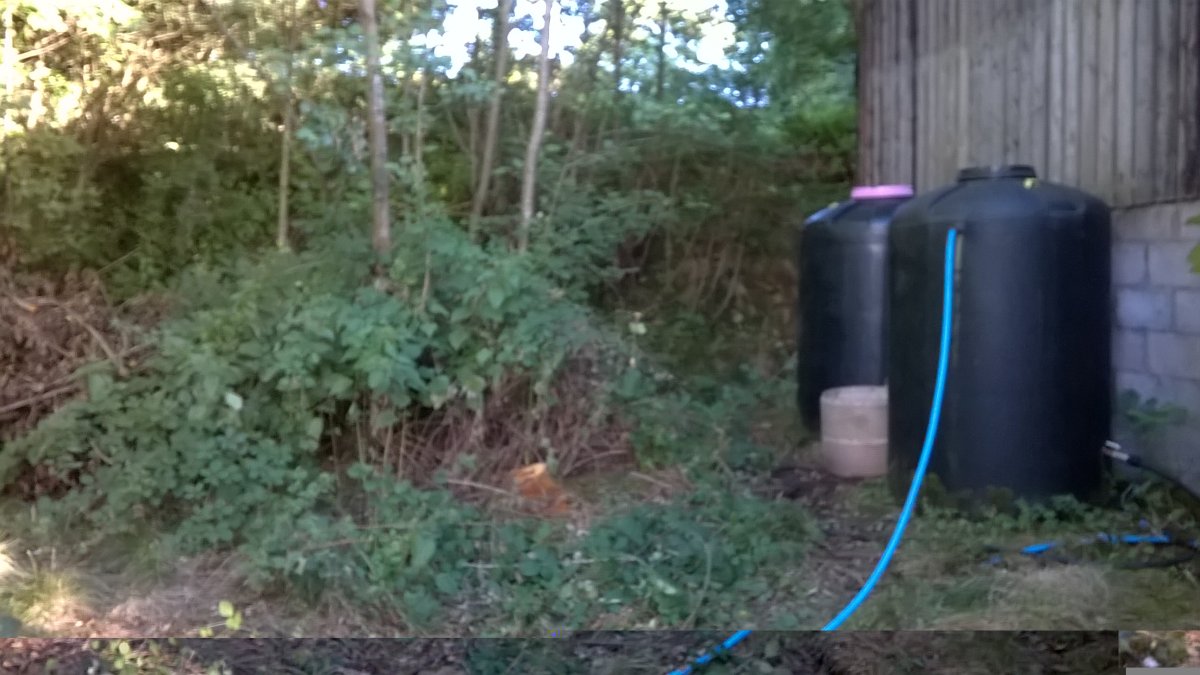

dug a stand out for the tanks and re-orientated the spring feed lines to their new location
and then it rained - big time and it all turned to shite
left it as tidy as I could as i worked my way back out of there
freshly installed and plumbed in

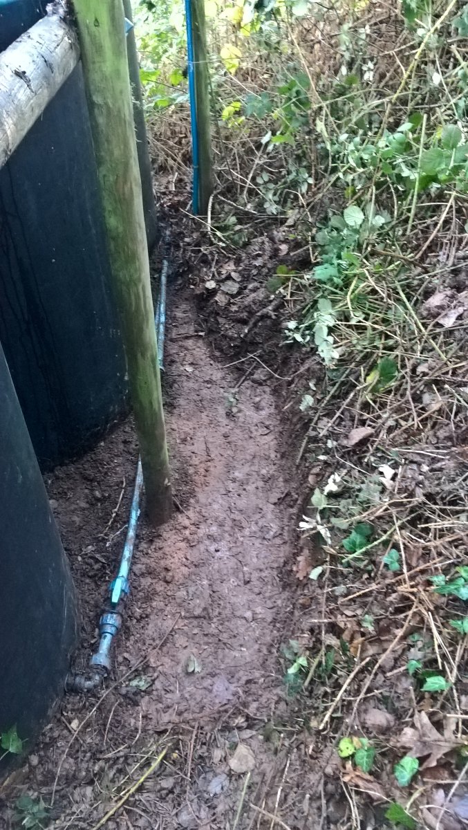

and the back of those tanks is looking like a jungle again now ... 's where I've been digging out about 6" of leaf mould formed soil :( to get to the tank outlets
real claggy tish - but as said, found a tap I'd forgotten I'd installed - each tank/outlet has one
the wet down the side of our tank is where i tipped it out the lid, when I took it off to confirm it was full
the bits of MDPE 'poking' out the sides of t'others are covers over M12 nuts/bolts, inserted to fill holes from their previous lives with some gaskets and sili.
gonna get up there sometime soon and massacre all those bloody brambles - maybe clear the area up a bit with 'Lil Jake too .. 's a bloody mess again and the channels all want re-digging, but 'spose it is 9 years ago they got done
anyway ... isolated our tank and managed to split the connection without too much effort ... tap on and plenty of flow from the full to the brim tank :mad: ... so I at least know there is no shortage of water where it begins it journey to us. that is something :rolleyes:
have had all the plumbing apart at this end late this afters and it's dry - nada H2O o_O:censored::unsure::unsure::unsure: .. and to confuse me further, as I think I said previously, the leak beside the drive has ceased/left the chat o_O .... the tarmac is gonna have to have it :(
the only bloke I'd've stood any chance of getting some sense from, re. the pipe routing and who did the conversion here is dead .. sadly departed last year .. Alistair was always very helpful, when ever I rang/went and saw him. :rolleyes::cool:

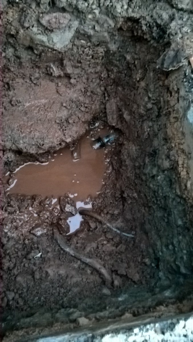

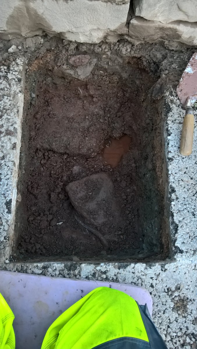

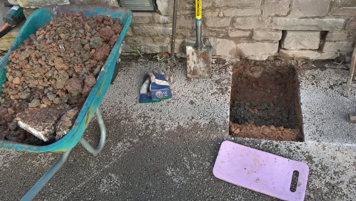

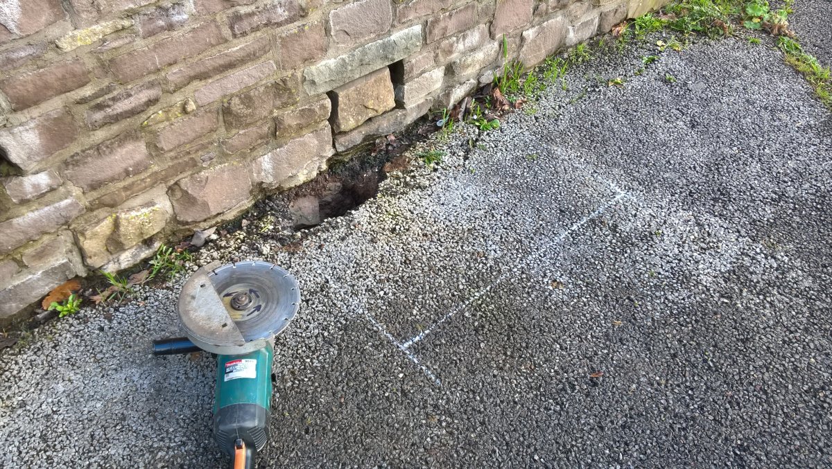

tooled up and set out a hole to suit the size of the 8mm plate O/cut, left over from the sump lid/cover ... ;) ... plan ahead:giggle: for the remediation works :rolleyes:
the small hole is roughly where the 'spring' has been emanating from which I attacked a few days before our water vanished:unsure:

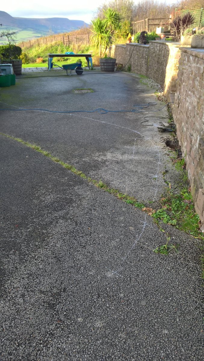

got me 'rods' out and sussed the route - AGAIN - to double triple check where my 'sposed route is :unsure:
so gave it some 9" treatment ... decided to lop half the hole first, to give me some alternative direction to go once I'd found yon pipe

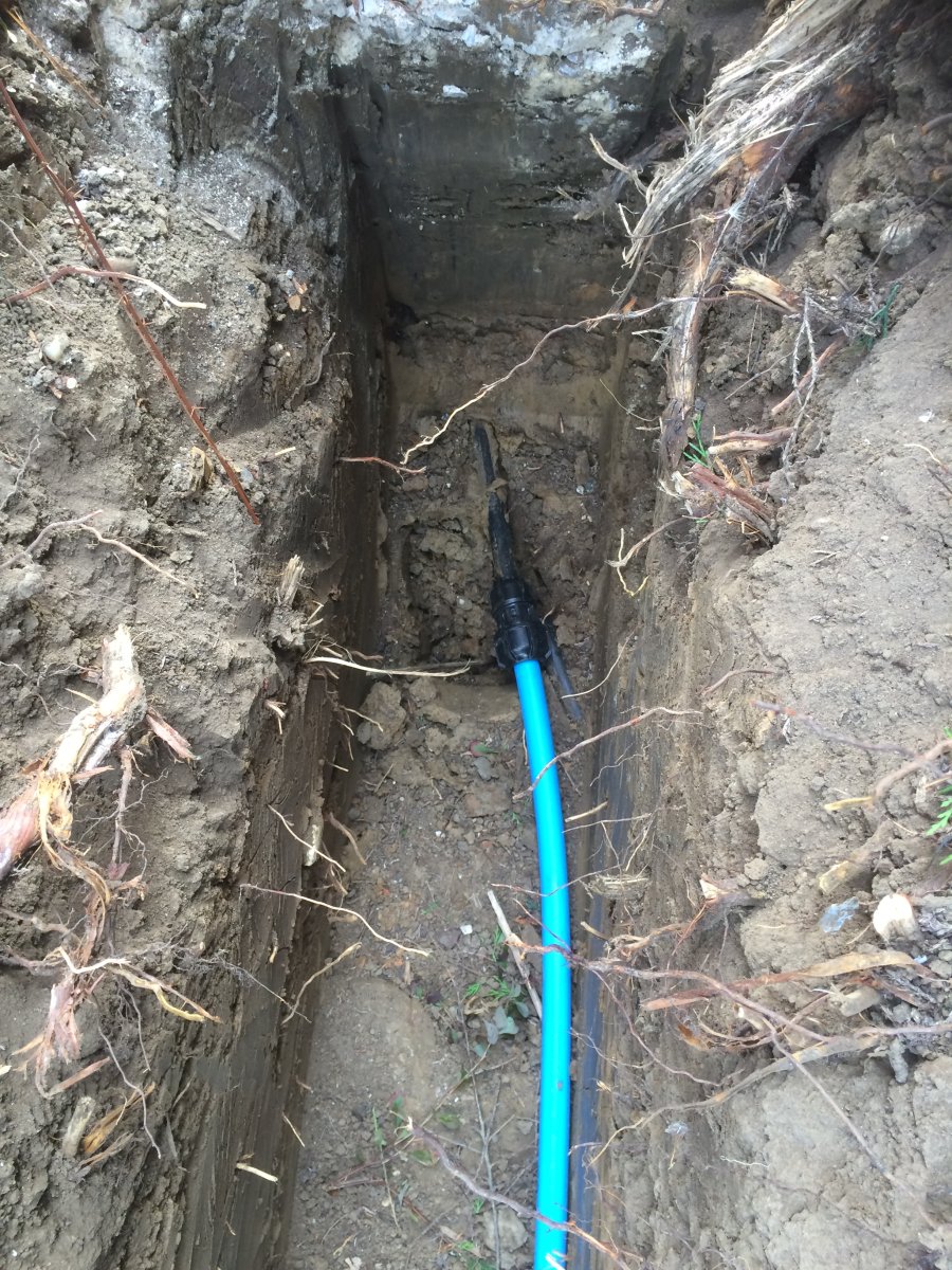

dug down looking for some signs of disturbed ground ... bloody hard going - was like dry mix under the 2" of 1-1/4 to dust on the top, but went very gently/slowly with a bar to break it up .. not knowing WTF I was gonna find?
so got down to the bottom of that and quietly 'expanded' me dig out to the edges of my 'black top' cut and found a SWA cable :rolleyes::oops:buried under/wrapped around a gert rock
where the pipe enters the house there are 3 SWA cables disappearing into the floor ...... I used one of them (who's end I found when doing the footings for the wall - buried) for the outside lights, built into the wall.
I know for a very truncated tail of a second one, poking out the tar mac, just in front of the wall, which is uselessly short, but have never found the third one.
So guessed I was somewhere near on the right track as they're bound to have been stuck in the same trench as the water pipe - they all come out the ground in the house, virtually together :rolleyes::)

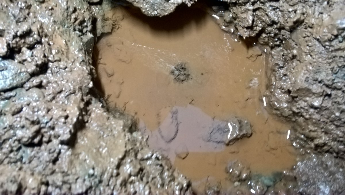

I was now also finding some water (y):cool:
and had resorted to my pointing trowel for poking about in't hole and found a second cable t'other side of that rock, which'd obviously been lobbed back in the trench - really want to meet the **** who back filled this with enough rocks to start a small quarry ... good job I'd parked the bar and taken to the trowel or I'd've had the second cable for sure

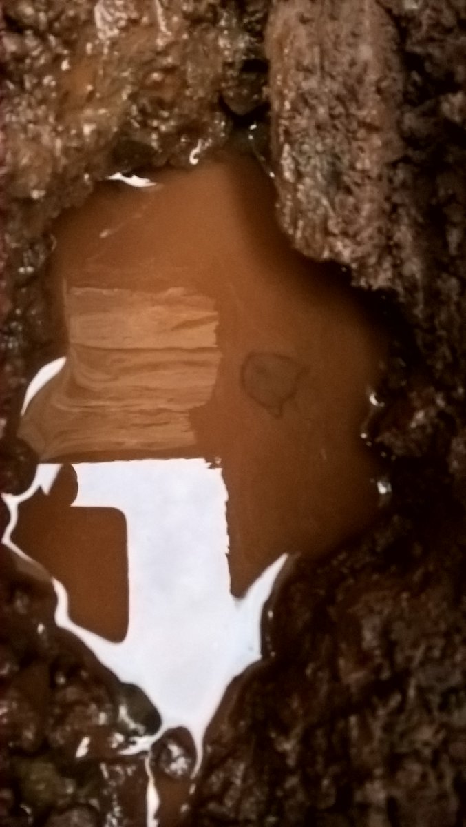

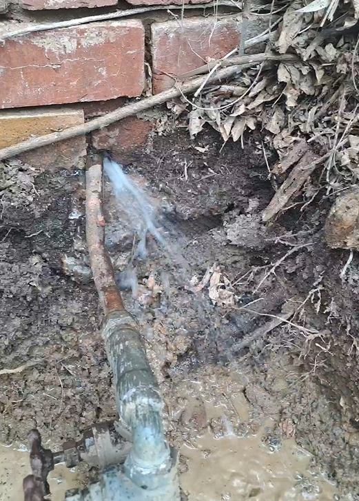

dug further back towards the wall, where the water appeared to be coming from and sure enough
left it for five to settle while I had the cuppa, that'd arrived and it'd settle nicely ... deeper excavation required

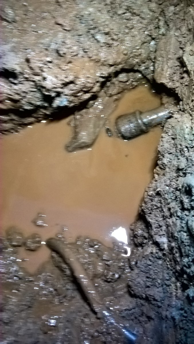

and lo and behold :):giggle::love::cool: ......................................................................................................................................................... and theres the second cable which showed itself when I extracted the bloody boulder sat on them both :mad:
I hate those push fit couplings with a passion .... and this un had a rock sat on it -- a fair lump of a rock forcing it out of line with the MDPE and leaking all round - 'specially the back -- said rock below

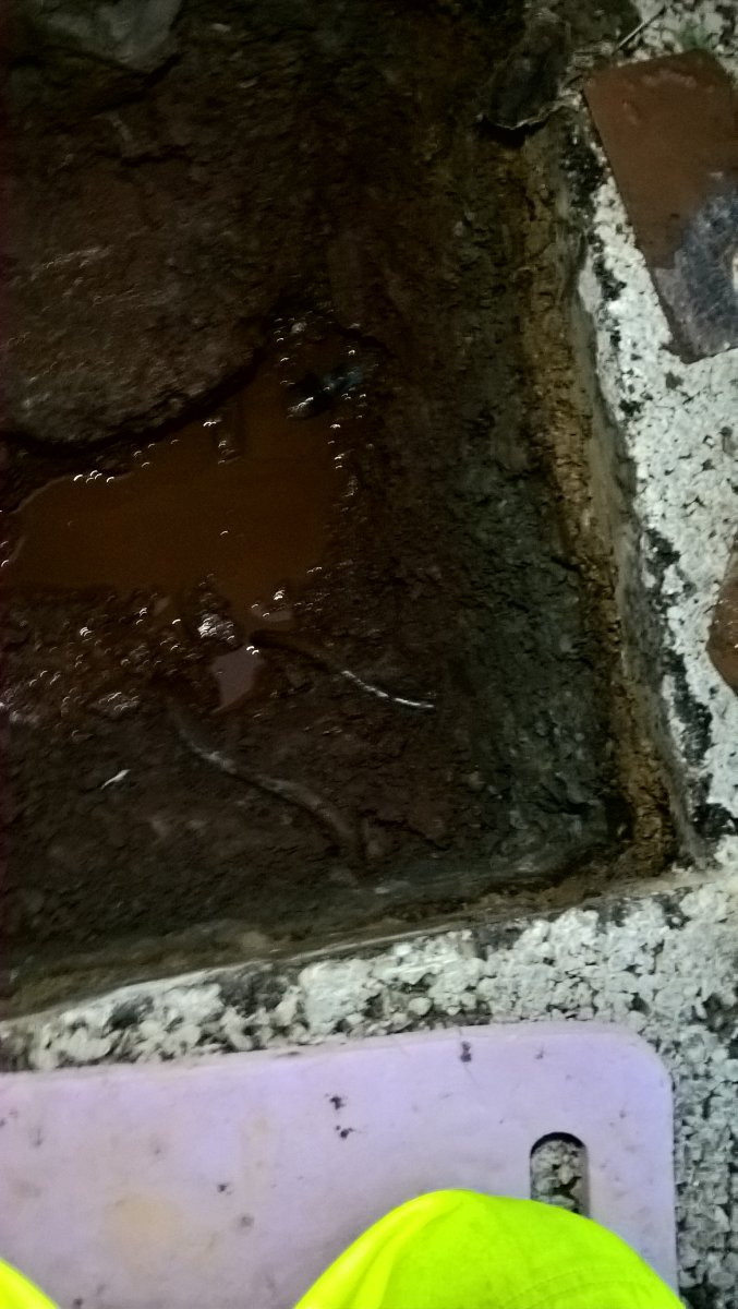

was running out of light - quick - last hour was torch light, slowly clearing out bit by bit ... pipe is heading downwards, from that joint, as are the cables - 'sposed to be dry tomorrow, so'll have to continue in the morning clearing out the hole properly, to find t'other ends of the pipe and cables, emerging from what I presume is the trench leading to the house about 15 feet away .. then I am going to have to go for the originally sized hole (this is only half of the set out hole - in the right direction too) to get at the uphill/upstream end of that pipe, to give me enough room to 'perform surgery' on it to cure the problem ... might even find the third cable if I can get down to the trench level, where the pipe dives down to
and this is what's been coming out of said hole - sand? - WTF is that - fill is as quarried :mad::mad:🤬🤬 .. twa*s
that's the second barrow full .. remarkable how it bulks out of a little hole
I also have a theory as to why the line in the house is dry .... reckon it's probably blocked with shite that's managed to get in round that joint ... once I have the hole enlarged and more pipe accessible, so I know I can sort the repair as planned, I'll disconnect it and back pressure the line from the house, as there obviously appears to be water at the joint as it's coming out of it, upstream of it - either back flush with water through the pump, with a bit of plumbing juggling, or give it 150 PSI of air or both to flush it out
main thing is I have found the source of the problem/issue :giggle::love: will hopefully be down hill from here (y) ... could really do with a small pump to contend with the watter ... got a subby, but a bit big for this - have got an air powered vac gun, that might do the job, but hopefully when I sever that line yon hole is going to fill PDQ ... 'til I cap it, but want to see it gushing to put a smile on my face :rolleyes::giggle::LOL:
don't you just hate cowboy builders - although I shouldn't be surprised, based on previous 'stetson' jobs I've dealt with here :rolleyes:
