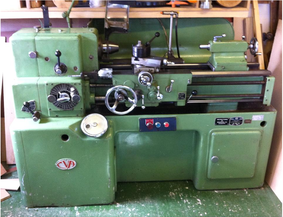

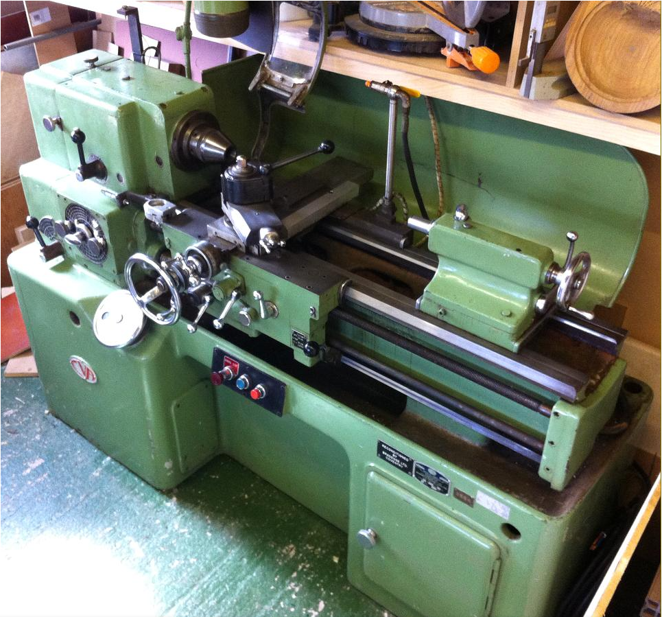

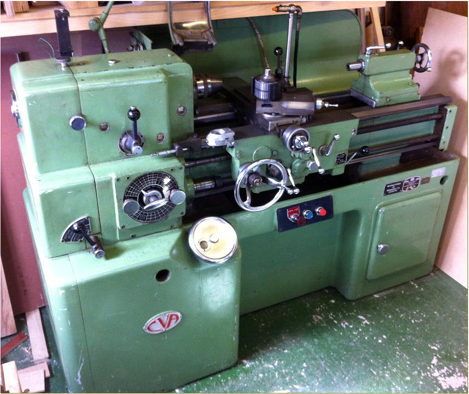

as said elsewhere last night - was researching one of these, that I've tripped over reeeeeeeeeeally bloody cheap and local-ish ....
last iteration of these in the early '80s were £28,000 and change - £30k with taper turning, new .. :oops:o_O
Kearney & Trekker/CVA toolroom machines - much sought after and impressively accurate, with some very nice features.
yes I know I have the Harrison, but these are at the DS&G / Holbrook level of good and are only going up in value. :giggle:
and it was my birthday yesterday :rolleyes::giggle:
might be a road trip on the cards :whistle::whistle:

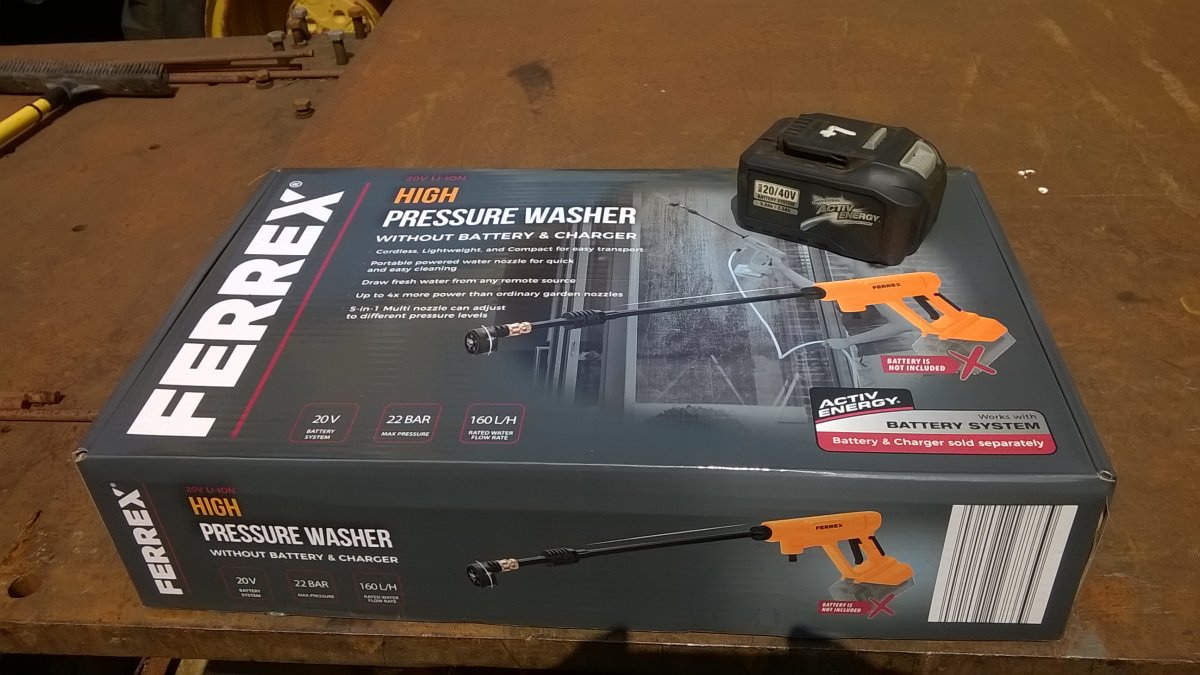

picked this up in Aldi earlier in the week ... thought I'd give it a try and have to say, 'tis very effective at getting the bird sh1t off the Kia, crud out o' the arches and moss off the patio slabs ('bout all I tried it on) :rolleyes:

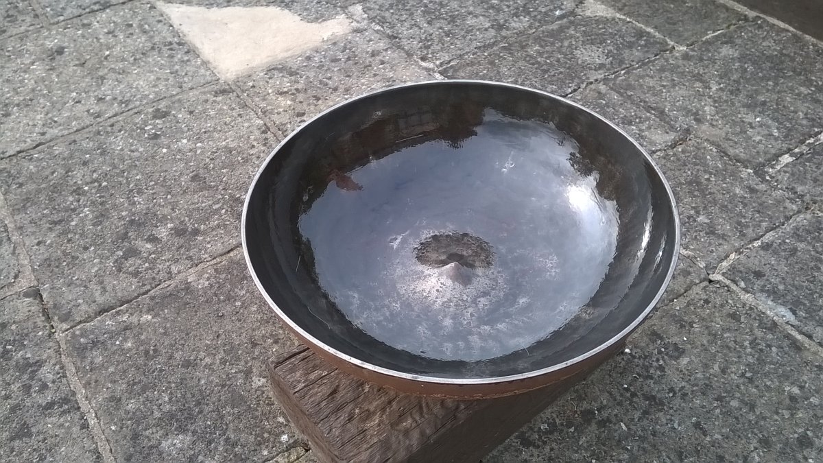

got a 5" out earlier in the week too and gave the birdbath it's annual clean up, as it was nice and dry, followed by a good coat of yacht varnish (with a.n.other to follow tomorrow) ... came up nice as usual (y):giggle:

That's a belter 👌🏻👌🏻
That Holbrook last weekend really drew my eye...something to behold the build quality and style of them...proper bits of kit from a different era 😊
yeh the Holbrook is a superb piece of engineering - these little CVA,s were built on the same sorts of scale, massively over engineered for rigidity -- got to go have a look at this one it is sooooooooo cheap - don't think the seller knows what he has/the pedigree, TBH :rolleyes:

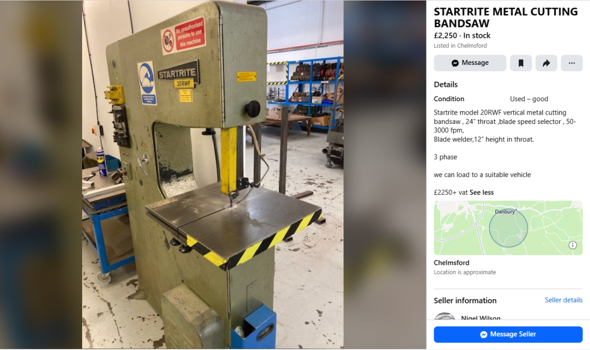

this made my night, last night :giggle::giggle:
obviously a dealer and he is hoping ... but yer never know :rolleyes: ... never seen a deep throat Startrite make less than a grand :unsure:
gave 500 quid for the pair of 'em :giggle: plus collection round trip of 80 miles .... think mine's in better nick :rolleyes: and it has the fence still :) (y) ... showed it to Pam this morning and got a " Wow!! .. you had a bargain then " :giggle:

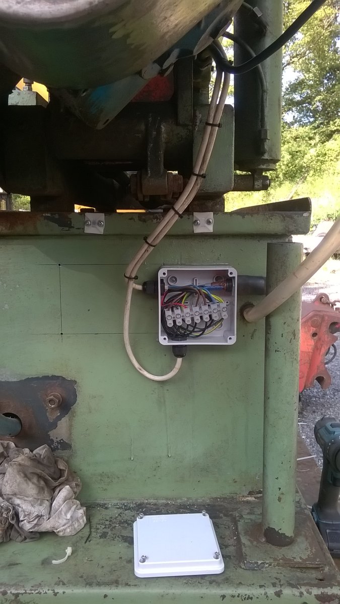

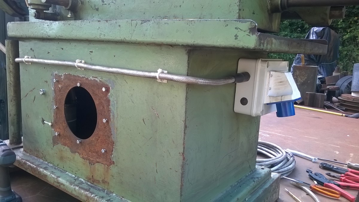

I hate working on things twice ... but I had to alter the wiring on the horizontal band saw ... the suds tray on the back end just isn't tall enough and was running the risk of what i'd put there getting a regular bath .. so
pulled off what I fitted and came up with an alternate scheme ..
needed some 7 core to relocate the original box to somewhere safer/drier ... happened to have a nice roll of 6+earth SY - ideal (y)
got a new waterproof enclosure fitted and sealed to the body with plenty of sili and set about re-routing it all
noted it all down on the bench ... and confused myself - with the numbering on the choc block - had meself going for a minute or two when it came to re-connecting the front end - 'til I realised what I'd done (the 6+earth are numbered 1 to 6, plus the usual green/yellow) ...
so gave meself a good bollocking and re-numbered my choc block notes - then everything made a lot more sense :ROFLMAO:
then ran the new cabling up to the front
and got it all connected up - eventually, after my cock up on the numbering
happy I had it right, I gave it some voltage and everything worked as it should:giggle:

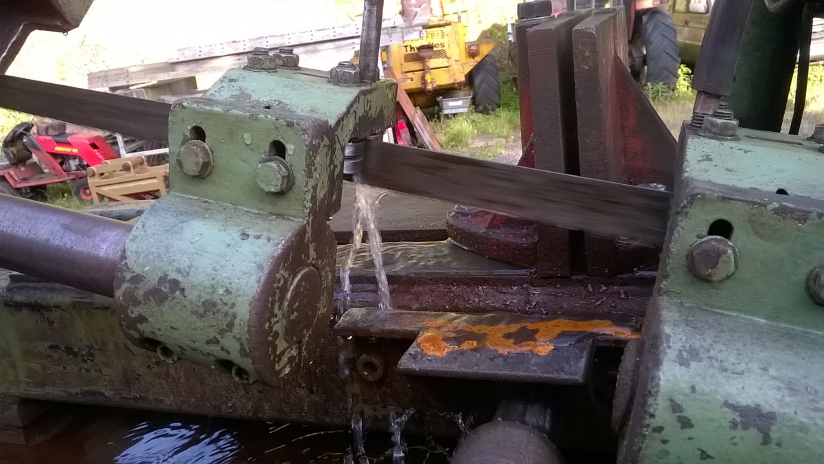

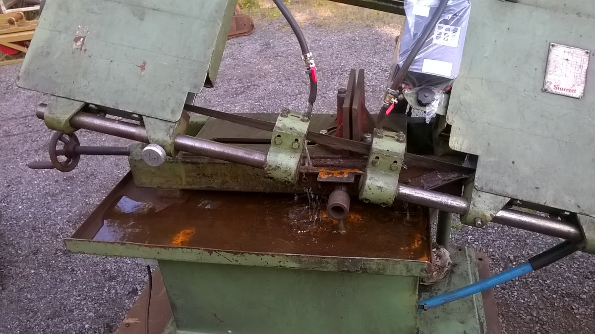

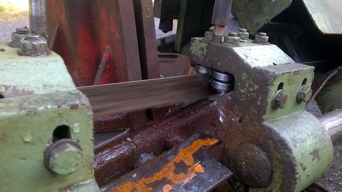

picked up some nice little brass in line taps off Fleabay last week, to get some control over the blades coolant nozzles, so stuck those in
and gave it a try....
front one getting plenty of coolant now that I could 'attenuate' the back nozzle, which was the first in the flow and taking 90% of what was available
couple of covers to make for the coolant tank apertures and might put a flexy extension onto the back of the tray, to try and keep as much in there as poss. -- then it's all sorted - new blade required and it's good to go to work :giggle: - better get a couple ordered up with Selmach in Hereford ;):)

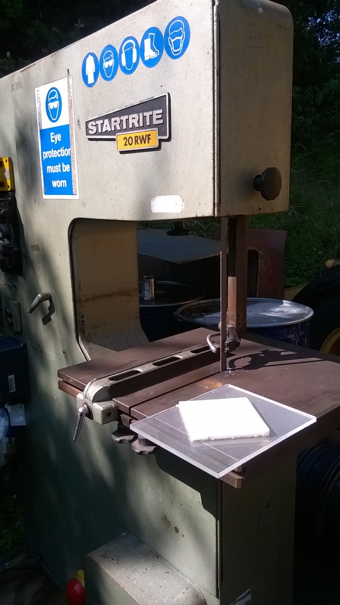

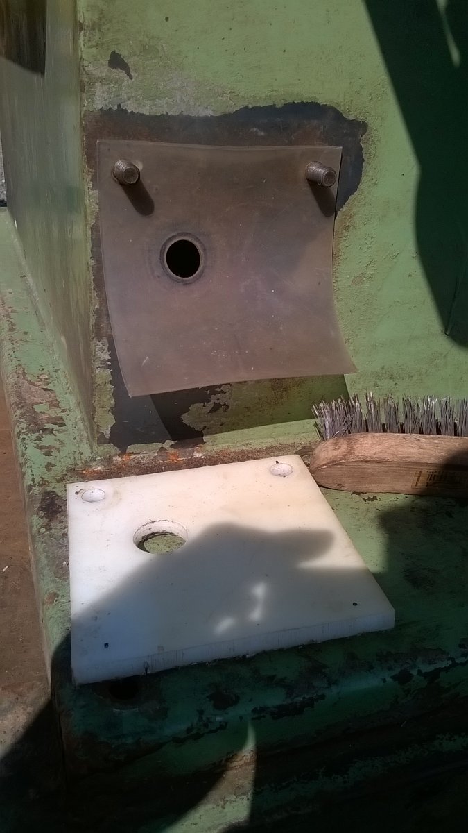

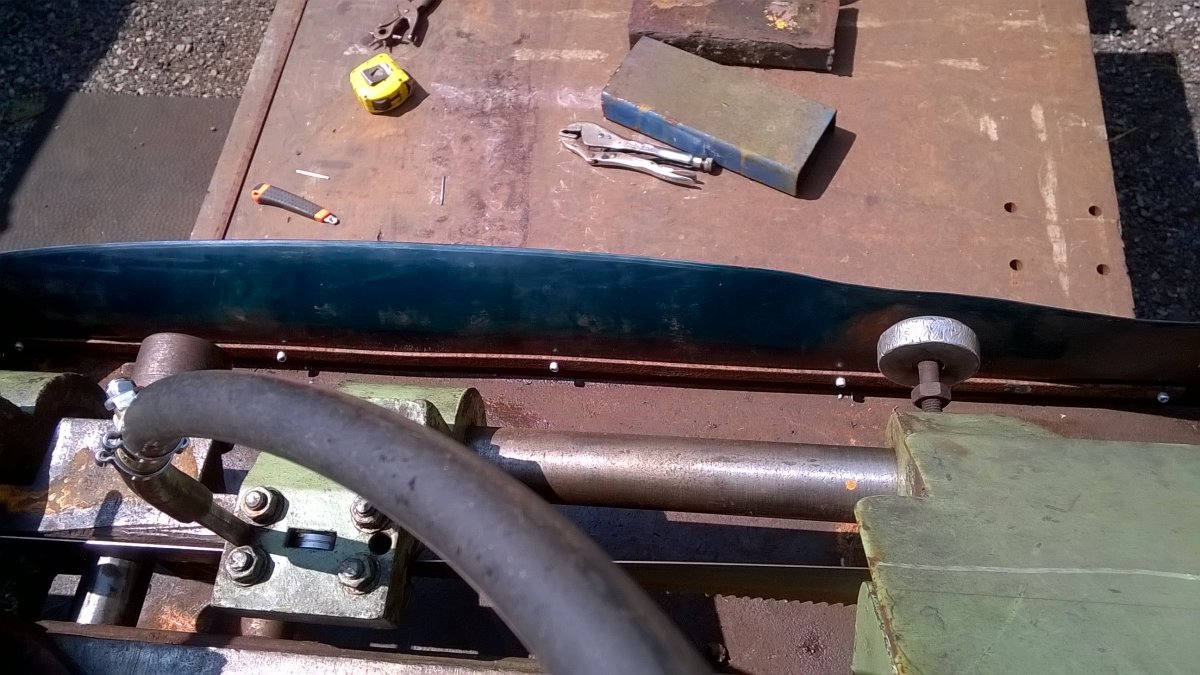

Got a bit more done to the horizontal yesterday, towards sealing off the suds/coolant tank and keeping the wet stuff where it belongs ...
uncovered the vertical and cut meself some bits .....

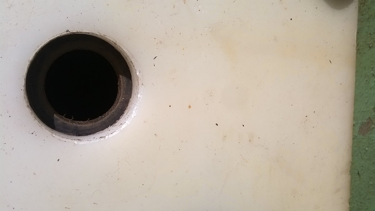

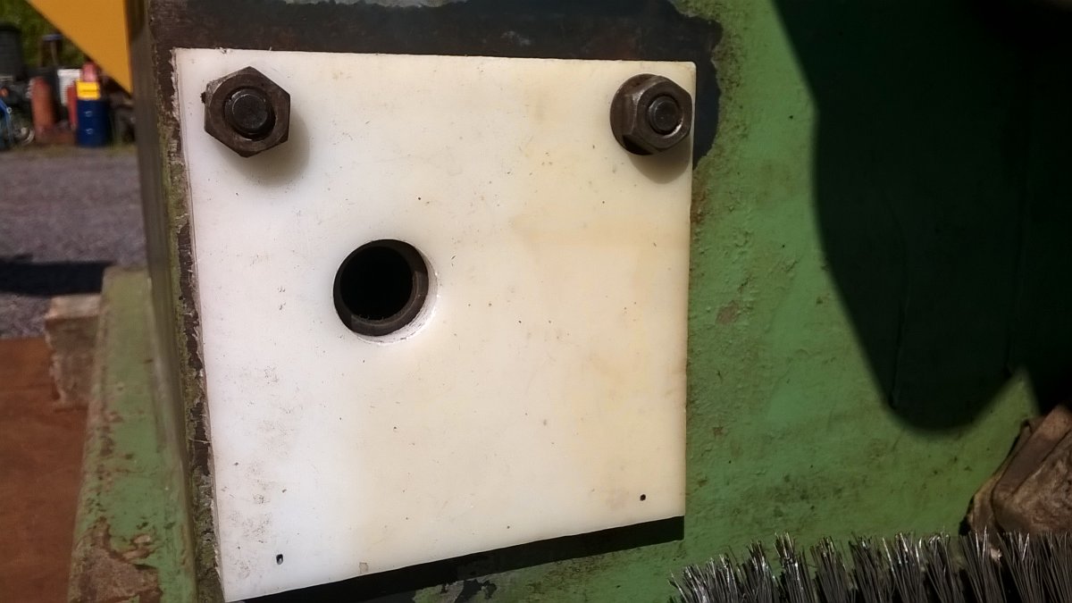

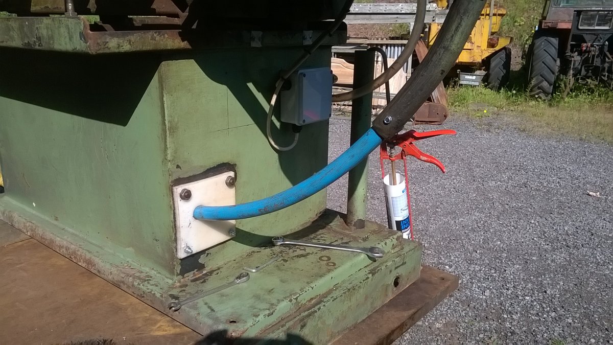

needed to create a waterproof sliding joint for the return pipe from the rear drive wheel housing ...
nice bit of 3mm flexi curtain with a 7/8" hole punched through
two existing 10mm captive bolts
and needed a couple more lower fixings
one tight as .. slider sleeve / gasket
the hole in the nylon is a perfect fit on the 1" MDPE (which was a perfect fit in the outflow from the wheel housing)

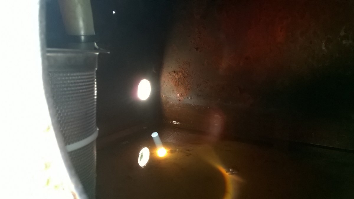

and from the inside looking out :giggle: after i'd pumped the sump out as low as the pump'd allow - which was low enough to get two lower fixings installed without drowning the drill when it went through
and installed ... with plenty of sili ... sili-ed the MDPE into the wheel housing outlet, as although it was a good fit the sliding seal had a good grip on the MDPE .... so couple of teks in to keep it put worked well
there's never a huge flow from / through this return, but has to slide as the tube moves as the bow rises and falls

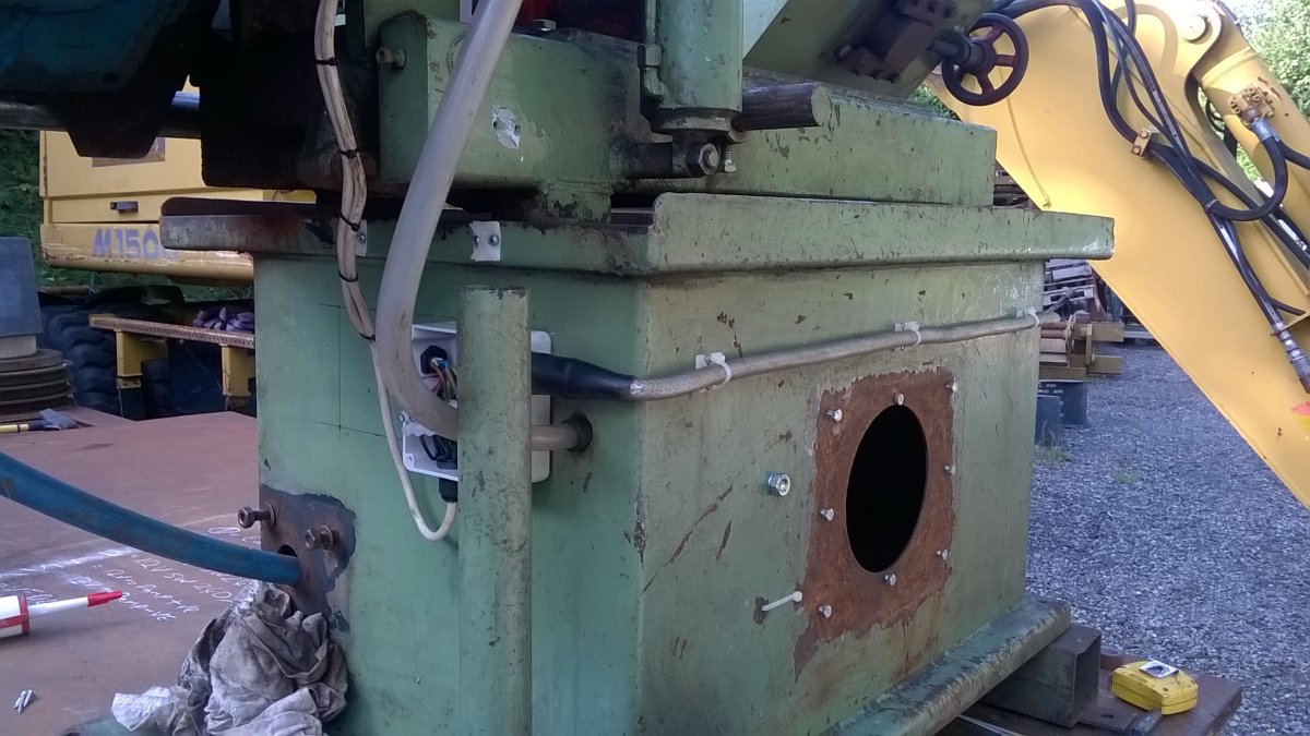

then it was seal off the gert circular access hole in the side of the tank/sump
nice bit of 8mm polycarb did the job a treat, with plenty of sili and 8 original tapped 6mm holes - also enable me to see the level in the sump (y):)
the two 6mils beside it previously had had a cable tie fed through to keep the filter housing for the pump secured in place, hanging on it 10mm mount bolt, so replaced that with a couple of small angle brackets to feed the cable tie through inside the tank, to keep the filter housing stationary and sealed up those two with yet more sili -- job did ...

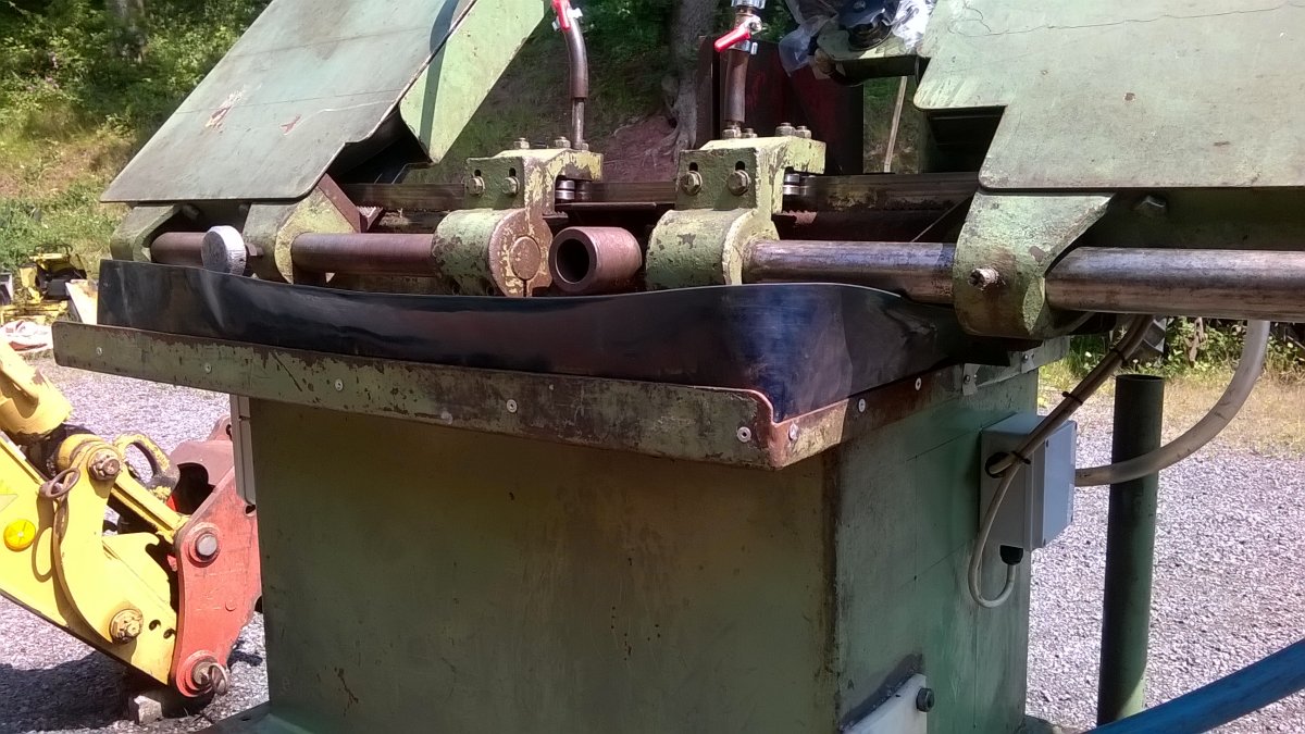

ran the saw and pump up and all was performing fine at all bow angles - everything going where it should and flowing nicely ...
it did however create quite a droplet splash out the side of the tray, so today ......
bit more flexi curtain and was going to bolt it on but thought sod it - pop rivets're nice and quick and easy :giggle:
with a backing strip to keep it all in place
should hopefully keep me trousers dry(er) and contain the splashes from the coolant nozzles as it hits the catch tray
I may well replace the pop rivets with some 6mil bolts - don't really like the look of those rivets :ROFLMAO::ROFLMAO:
anyway ....
ran the 'Drema up and it's down off the bench tonight .... new blade and "we're cooking on gas"(y):giggle: ..... might give the Meba a similar going over - could do with a little TLC :rolleyes: (and a new coolant pump set up - what's on there is bollo-ed - easier to replace than re-con what's on there!! )

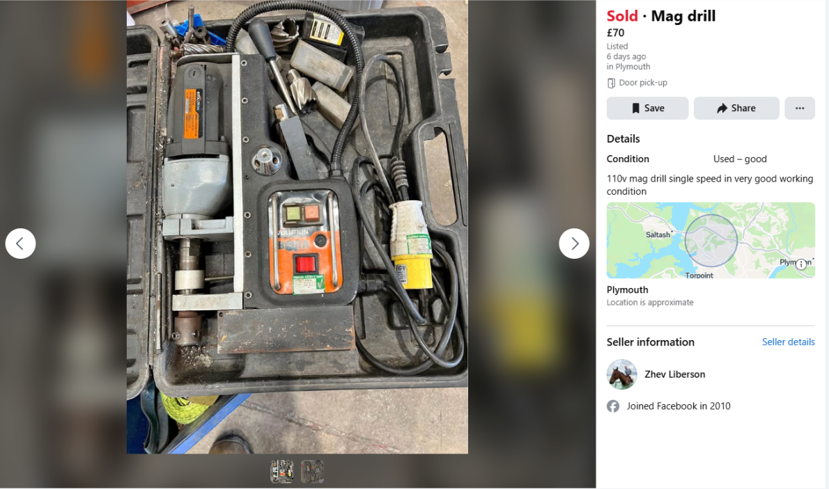

sent Josh shopping for me yesterday ---- the two large broaches are worth the asking on their own :rolleyes::giggle: will be a handy addition - save lumping the big Magtron about for up to 38mils (probably squeeze bigger into it TBH)
Zhev had a lot of other stuff of interest - equally cheap - sadly Josh doesn't have the facility or capacity to handle some of it -- and talking to the guy tonight - what's left goes in the skip in the morning :cry::cry: and he flies to Thailand on Saturday morning on a one way ticket - retired, premises sold - "Hasta la vista" UK :rolleyes::oops:

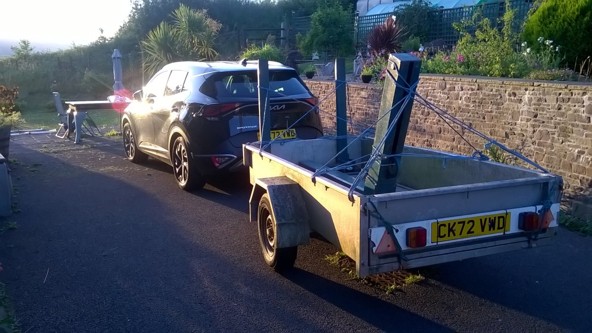

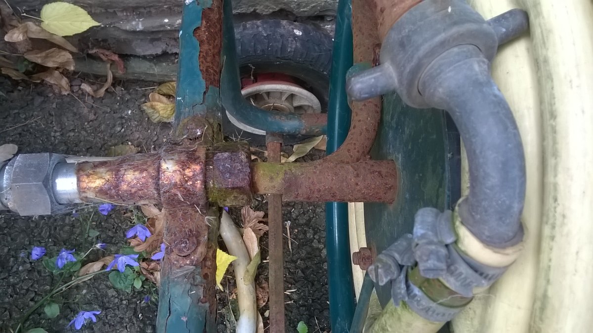

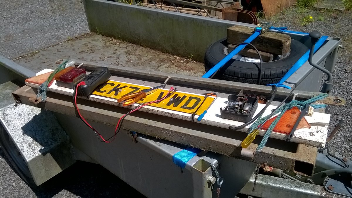

got a collection planned at the weekend, so thought i'd better give the lights a check on the little 8x4 trailer - usual story when it's been stood about - there's always one that doesn't want to co-operate - corroded terminals usually :rolleyes: - must be pushing 12 months since I last used this one - (just looked and it was last September to pick up that 6ft fork carriage and a few other odds an' sods)
this board has been around a long time too - probably mid '80s :oops::oops: - got two about the same sort of age - this 'un used to get strapped to my 320 SWM Gori trials bike when it was sat on a rack on the back of one of my SD1s and covering the tail lights on the motor. Was easier than dragging a trailer to some of the events I used to get to, round Bristol, on a Sunday morning - bad enough trying to turn just a car around at some of the locations we ended up at :rolleyes::oops:. Belonged to quite a few trials clubs over there.
think I've had my moneys-worth -they've done well :ROFLMAO::ROFLMAO: - especially as they've also been attached to quite a few trailers in their long lives, too
anyway - sorted - couple of spares strapped down and both hub caps re-filled with grease, hitch spindle/slider greased and she's ready for a run out ;):)

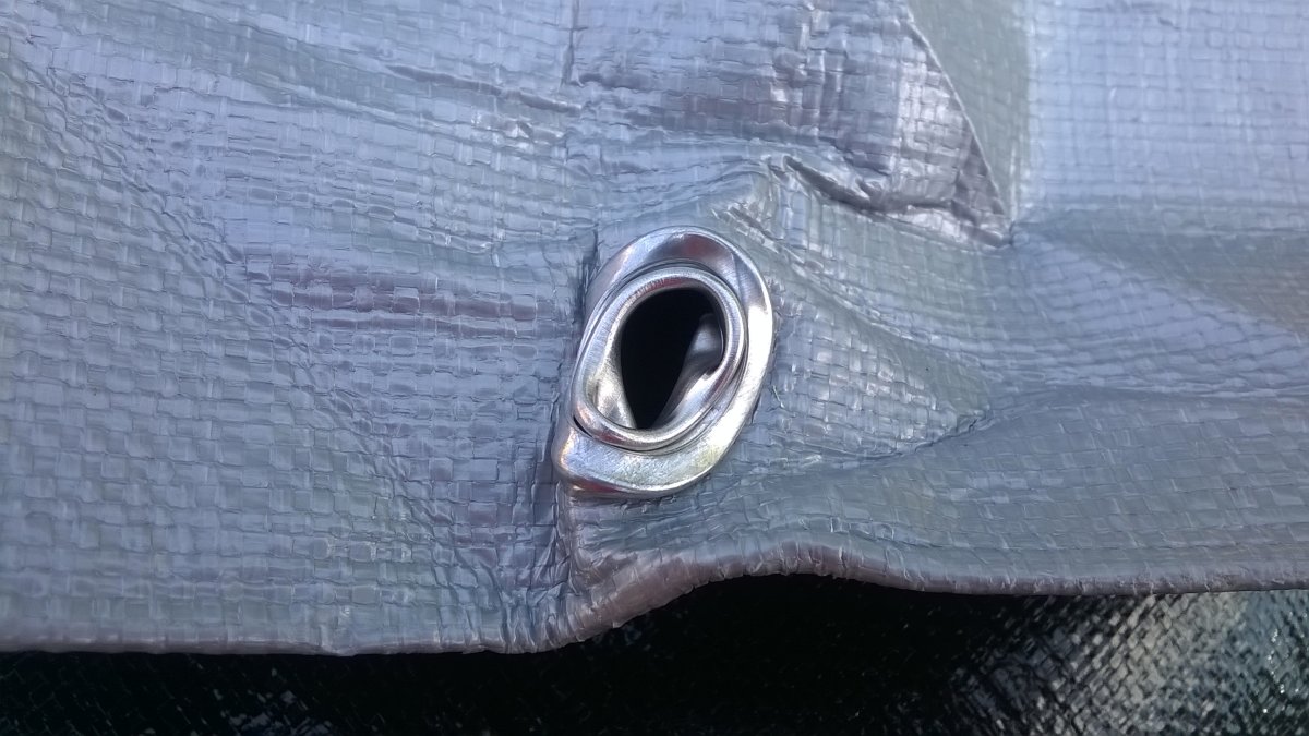

had a 4m x 2m x 320g/m2 tarp arrive earlier in the week which I'd had an idea in mind for -- 'fraid I didn't take many pix of the process - too hot at the bench in the sun, but got it together and worked well.
nice tarp, fair play, aside from one extremely nadgered eyelet, which fortunately didn't have too many consequences ...
the end product after some creative use of some additional batten -- was a decent cover for the vertical, which doesn't need bungee-ing down and should do an excellent job of keeping all of it dry
big 'envelope'/carrier bag (without handles) .... worked a treat and the 4 x 2 was an ideal size for a snug enough fit to stop it taking off, but still be reasonably easy to drop on ;) (y):giggle:

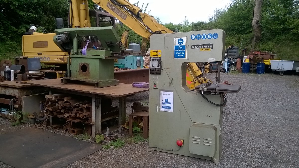

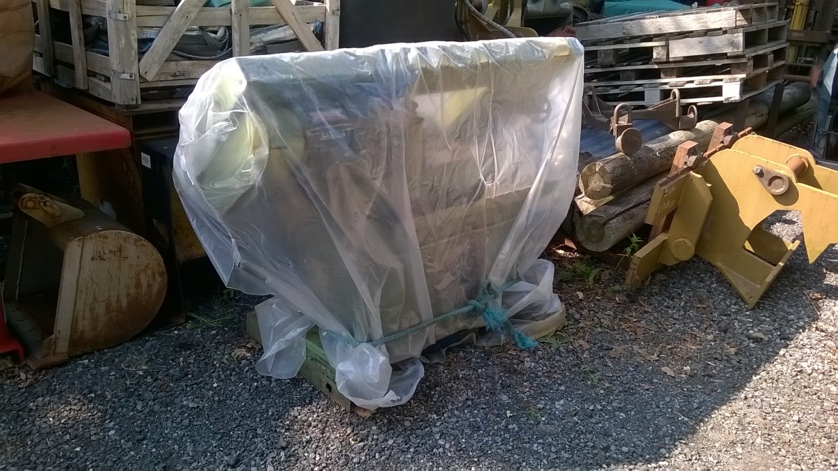

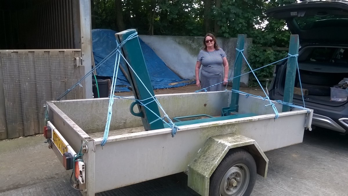

well the planned collection was this ..... :giggle:
bought and paid for months ago ... One of Stroppy monkey's mates who lives not far from him - in Devon - round trip planned - Holsworthy, then Plymouth and Pam's boy's place for the weekend ... added 44 miles to the overall round trip, so not
bad ...
Martin and his wife were lovely and had kindly sat on this for me 'til I could get down for it - originally planned for first weekend in May, - covid for us both ended that plan - then the end of May - still hadn't recovered enough for that, so was determined to make it this time ..
Martin popped it onto the trailer with his little frame steer loader - one of a kind apparently (can't recall the name), but the makers recalled them all at the time and he didn't send his back - then the makers went bust :mad: so he reckons his is the only one in existence :oops: ... looked a good tool to me
he was a bit surprised i didn't want to transport it stood up :oops: - er no - on its back please
and we were away - and Martin went back to his baling -- would not however, EVER recommend negotiating Launceston on a Friday afternoon :(:( - pretty little traffic jam. Can't recall ever having been there before and have been round most of Cornwall several times on the Kawi.
Sat nav kept telling me to dive off left down these tiny country lanes, 'fore we hit the place - next time I might just listen to it! :rolleyes::oops:
Tamar bridge ripped me off for having the trailer - same price as the car o_O and we eventually arrived at Josh's place. Spent the weekend with them and the 4 kids :oops: How the hell they continue to function with the level of sleep deprivation they suffer I really DO NOT know ... if it wasn't one screaming it was another - all night - Friday and Saturday - I was wrecked by Sunday morning. Pam just sleeps through it all, snoring!!
Josh let the cat out the bag with his little shopping trip for me, to Zhev's place - would've snuck it into the boot and she'd have been none the wiser :rolleyes::rolleyes: - doesn't seem to grasp the concept of an utter bargain :(:ROFLMAO::ROFLMAO:

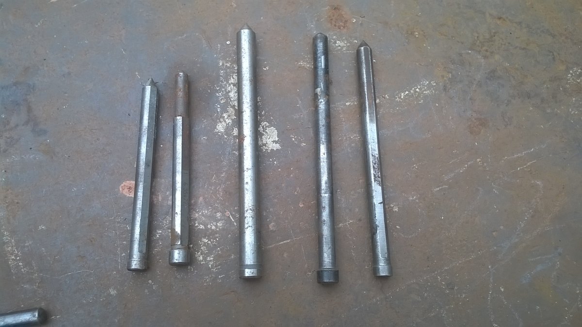

18 broaches, all sharp, several pins, one of which I am short of for me big broaches (most in the cases had pins in too):giggle: didn't pay for two of the bigger short broaches :giggle:
will save me lumping the big boy about :)(y)
haven't plugged it in yet :rolleyes:

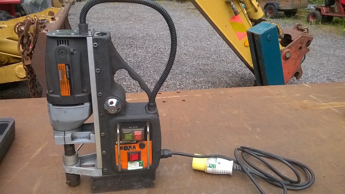

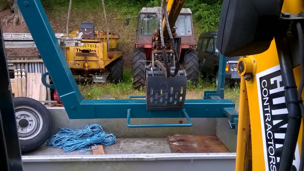

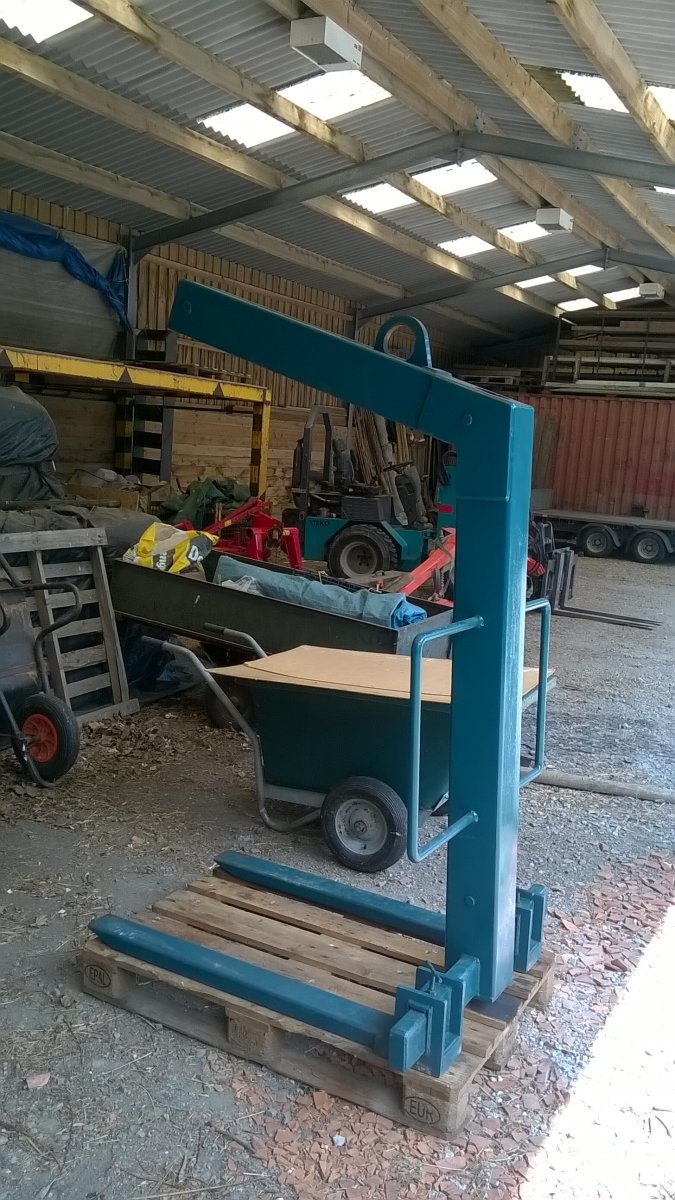

Had to deal wit this today though .. Pam wanted taking/dropping off to her mates for their Wed.s walk and I also need the car to take Clara to school in the morning - so

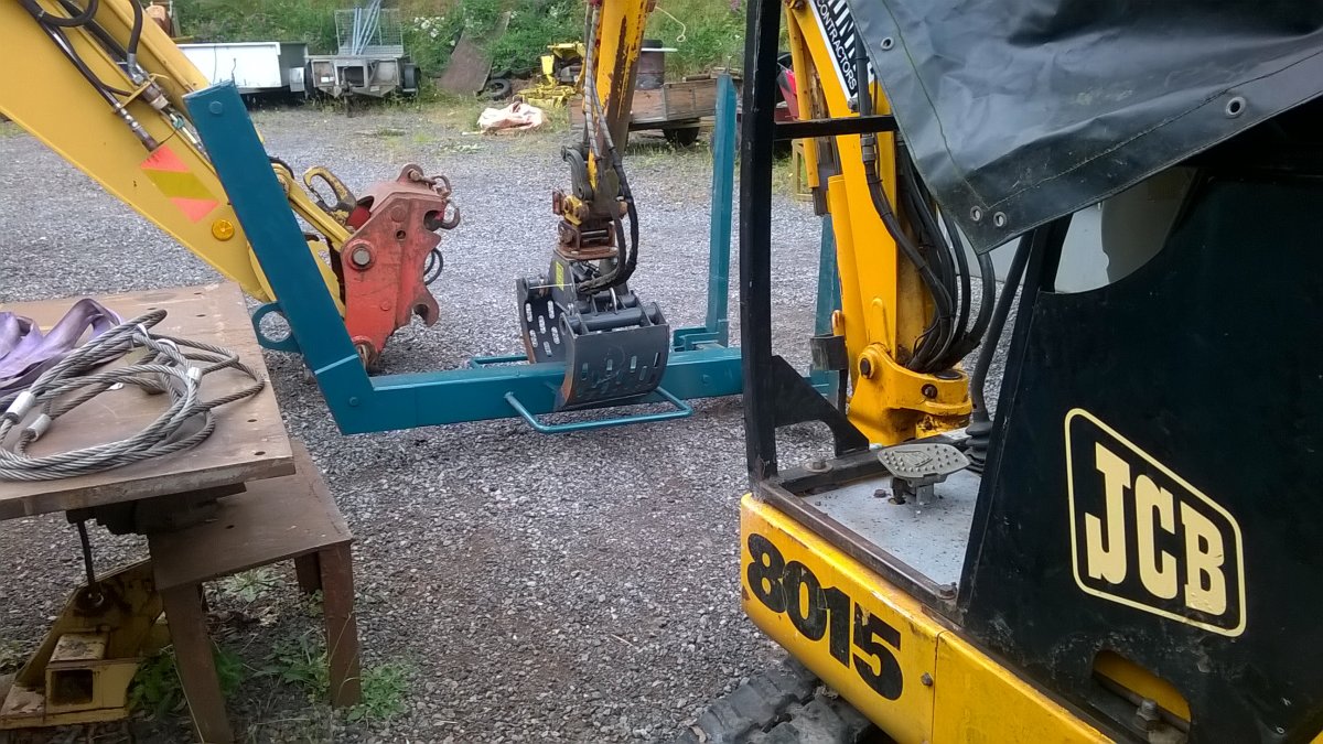

moved Lil' Jakie from his sentry post, securing my boxes for the weekend ...
to a suitable position to get a hold of what was in the trailer ..... ;)

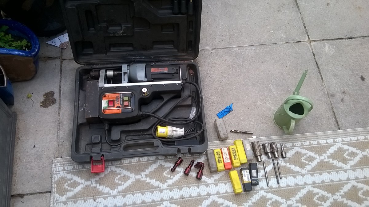

which he handled admirably :giggle: ... and popped it on the floor, whilst I dealt with the rest of the stuff :rolleyes: - two spare wheels, the mag drill and a tray full of tools, slings, ropes, straps, shackles, my wire security slings/locks, jack, etc., in the boot of the Kia and popped the trailer back in its parking slot :)

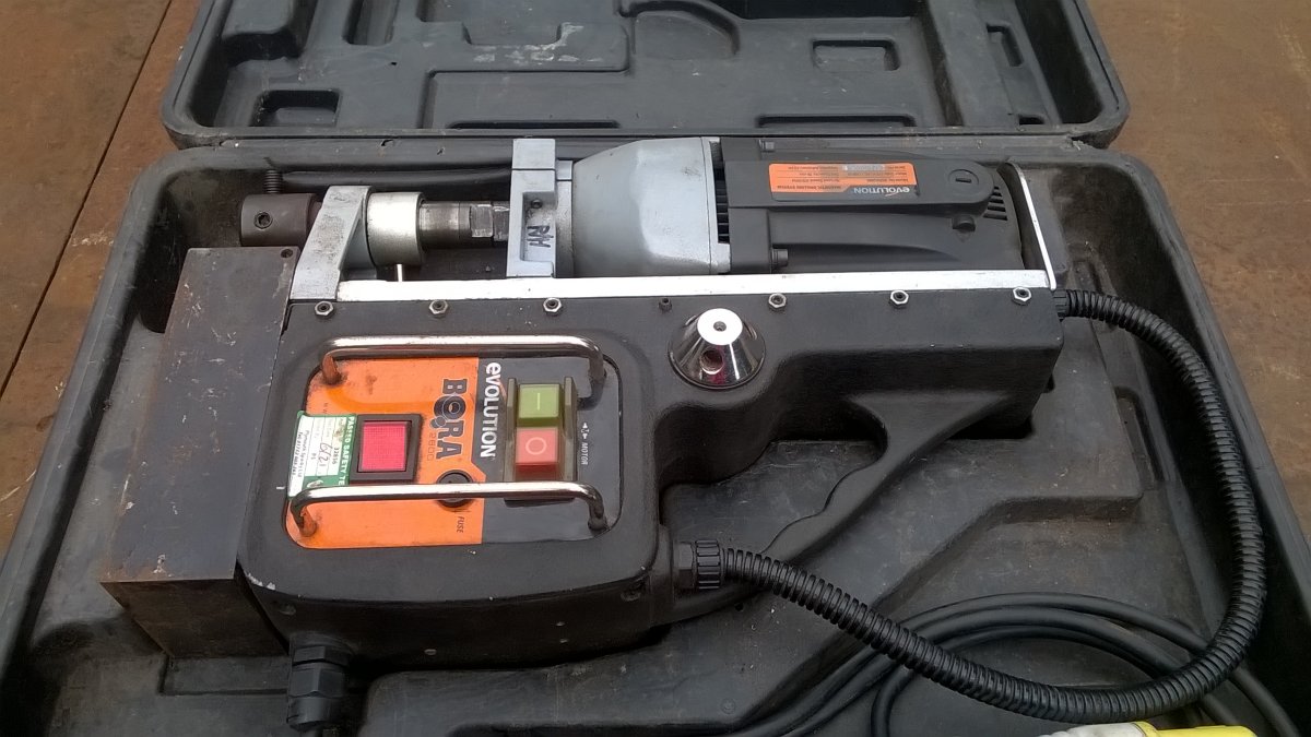

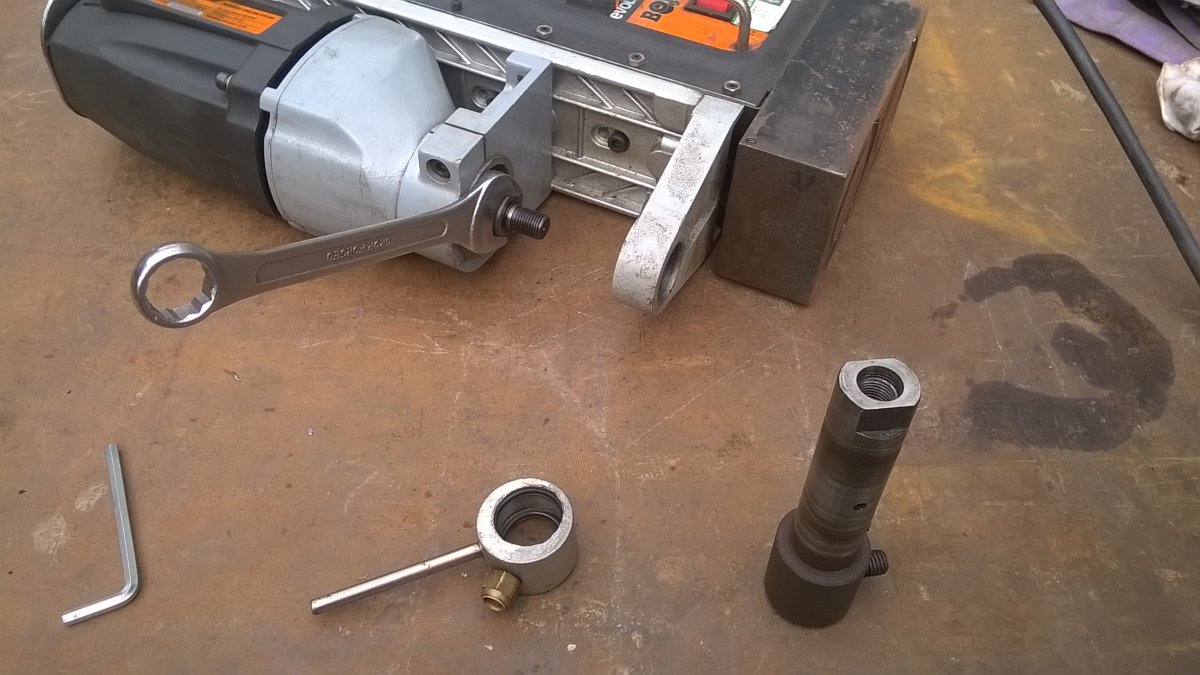

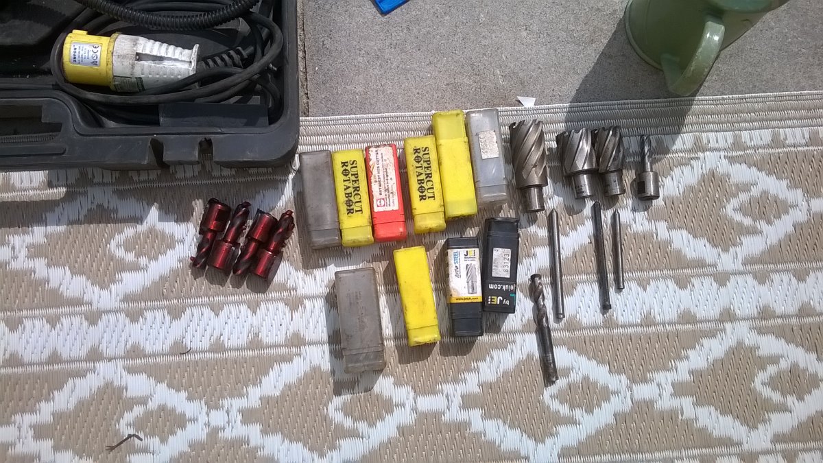

got a transformer out and plugged ' the acquisition' in - ran like a watch - no untoward noises or arcy/brush noises :cool:
the coolant ring was a 'tad floppy' on the arbor, so pulled that apart and fitted a couple of new O rings ... it's a bit worn, so may have to make it a new one - we'll see how it handle some suds when i come to use it :unsure::rolleyes:

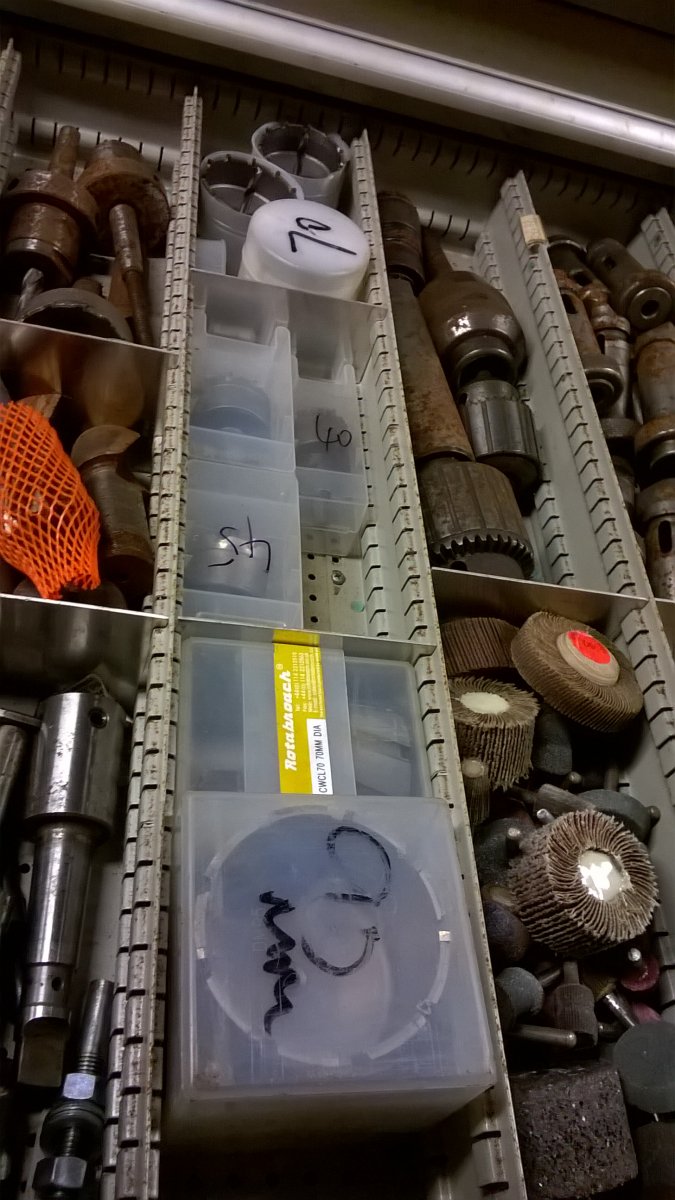

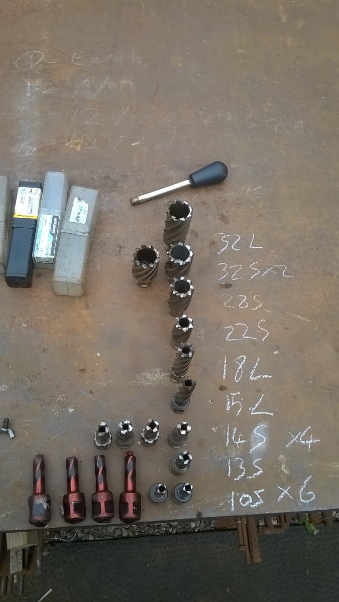

then had a bit of an inspection and count up after I'd reassembled the arbor with the new O rings
the two 32mil shorts're 34quid each, the long is 48 :giggle: and 20 odd quids-worth of pins, without looking at the rest of 'em :rolleyes: and none of 'em have been abused - all nice and sharp :cool:

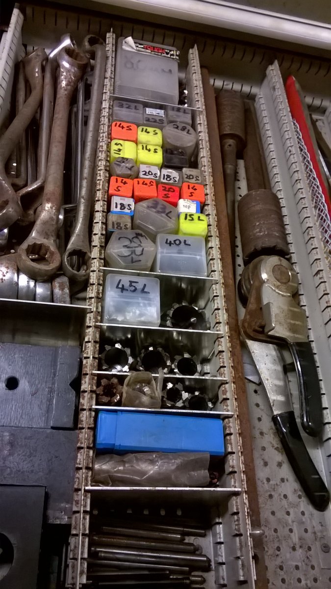

Gave the box a good brush out and the drill a bit of clean (will both get a better one when I have the air line out next ;)) and stuck it away (made a note of the arbor's thread type/direction on it for future ref. ;))
then slotted all the cutters away after labelling 'em all up -- had to have a bit of a re-organise to fit 'em all in :rolleyes:
could do with a few more tubes for some of 'em :rolleyes:

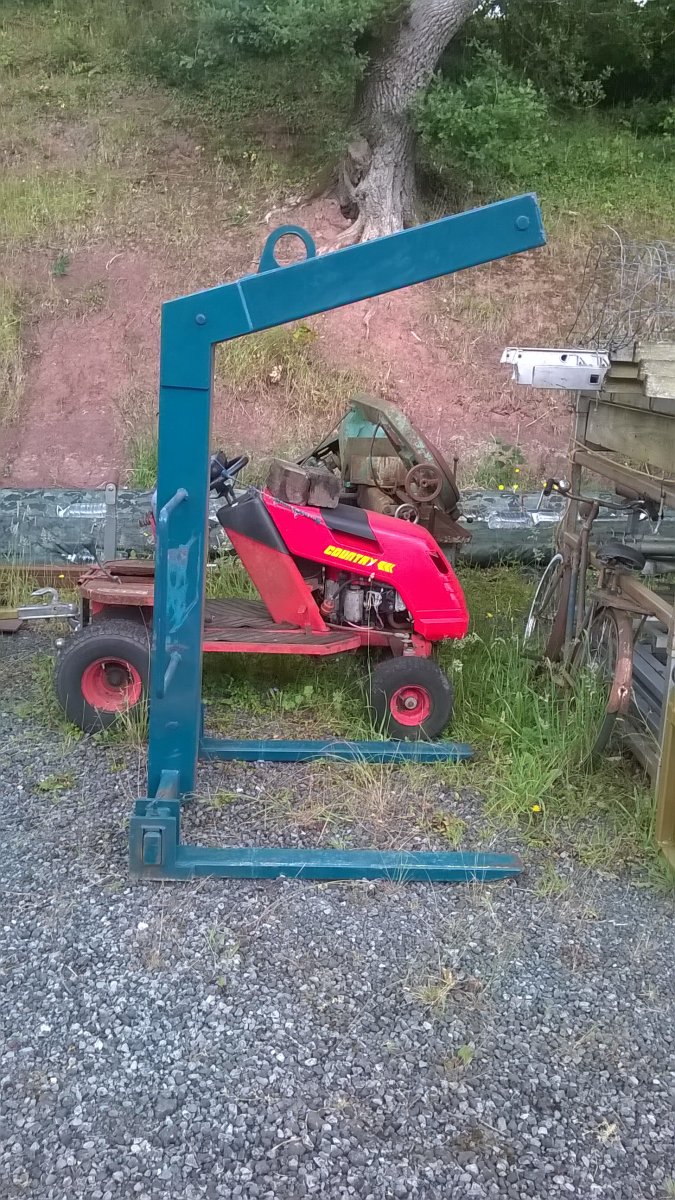

Just managed to park the crane forks away for the night, 'fore tea time -- 'fraid I scratched the paint a bit, rushing :unsure::( -- 's gonna need a fresh coat anyway :rolleyes::giggle:

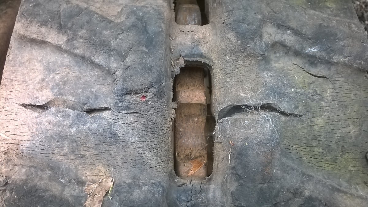

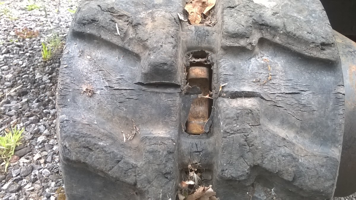

Now then, question for the experts on here :giggle: - I've never owned a rubber tracked machine before and am of the opinion that I may be wise to consider some new ones, 'fore these possibly let go :oops: - they're in decent nick/not worn, but IIRC from what Ollie said they're getting on for 12 yr old and may just be on their lifespan limit?? :unsure:
there are others like these 👇👇👇
everyone's wisdom would be appreciated (y)(y)

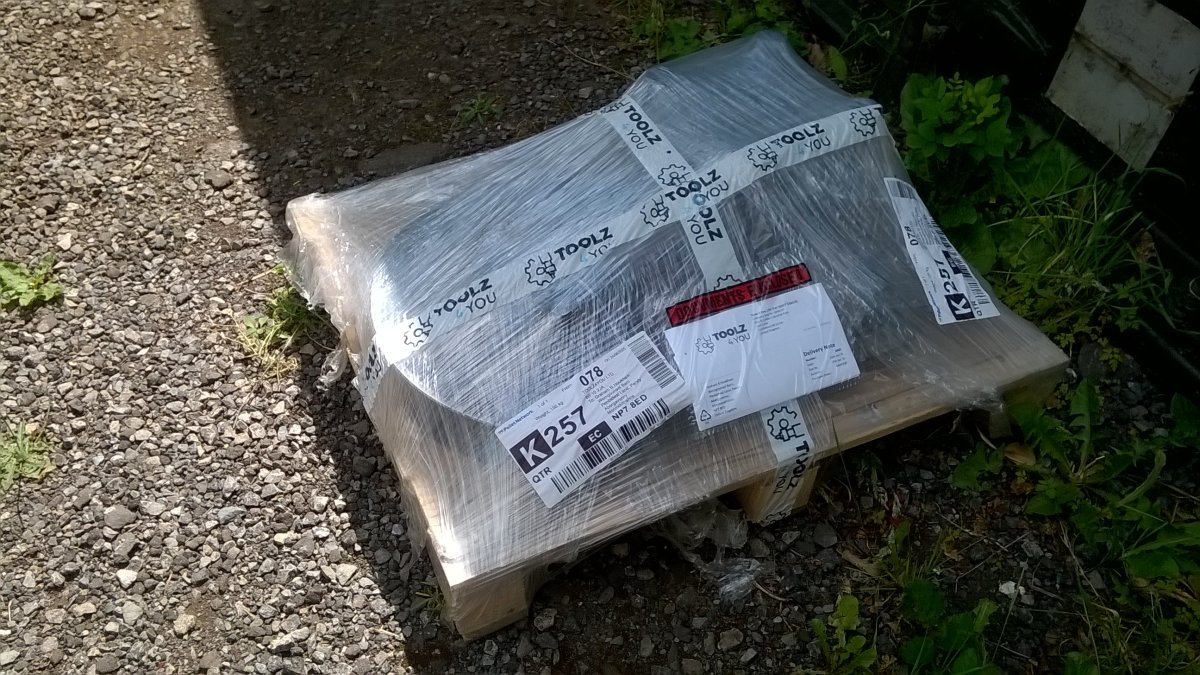

this arrived today ... bought last week, but deferred delivery 'til this week - didn't want it turning up on Friday when I wasn't here :(
gonna have to wait 'til tomorrow for pix of the contents .. started spitting rain as I was just unwrapping it after tea, to get it indoors and did not wanna get it all wet.
Been looking for one for some time and bought a couple of other items with it to get a good deal. They are not cheap and very hard to find on a D1-8 fitting - this was the best I've found, condition and price, in some time, so had to bite the bullet and cough up!! Got a couple of jobs I want to use it on.
