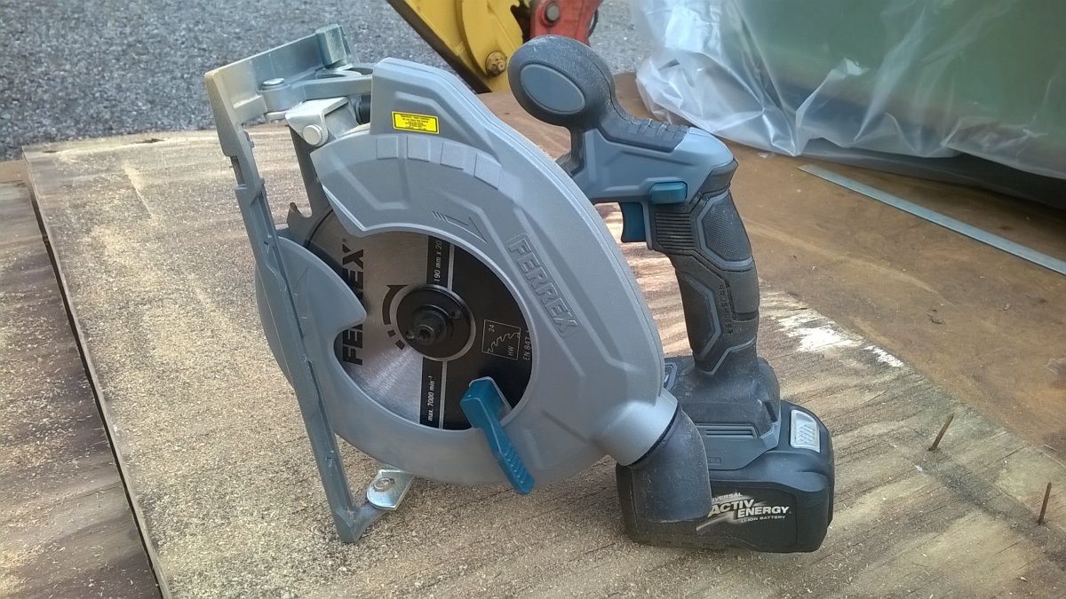

The trick with cordless saws is keeping the blades is good fettle (or replacing them as we do nowawaday). Corded will carry on cutting with a dull blade but cordless not so much
's like a hot knife through butter, fair play .... TBH all the Ferrex stuff I've had has been very good for the level of use it gets from me ... the recip. saw especially - use that a lot and goes on forever on a battery - their 20/40v batteries are really good, especially if running 20v stuff ... that little jigsaw I had out the other day is equally as good ... for the money and applications you can't go far wrong and is decently made - the 40v - 5" grinders have had a real caning (y)

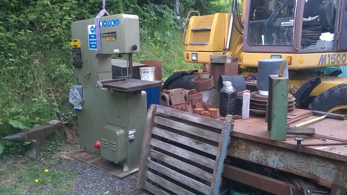

wanted the above chunk of ply to bolt to the bottom of the upright bandsaw, to, (a) keep the bloody wildlife out of the guts and (b) give it a bit more of a stable, side to side footprint ....

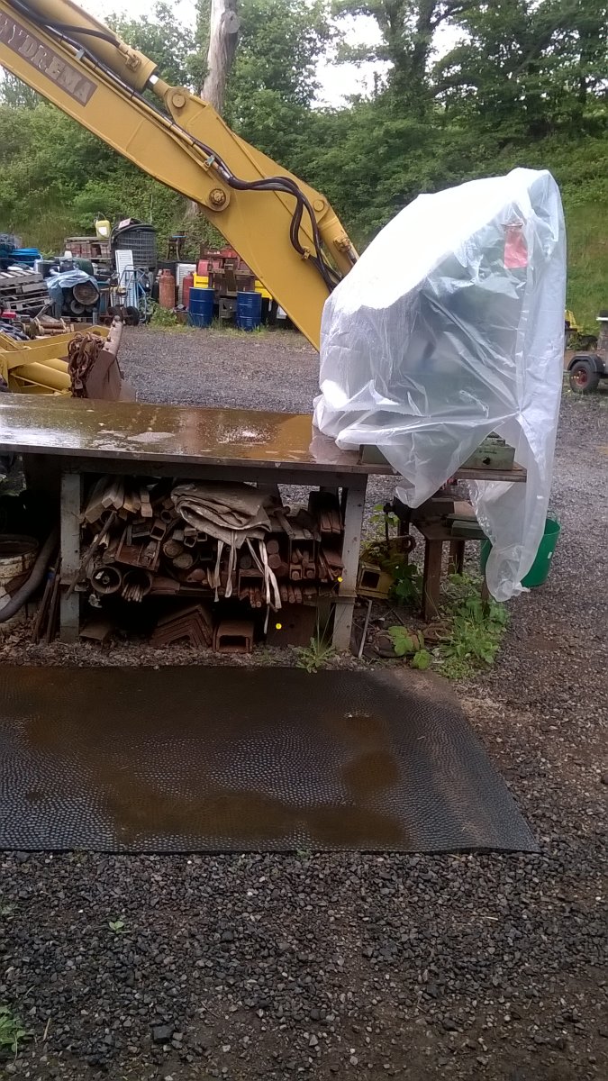

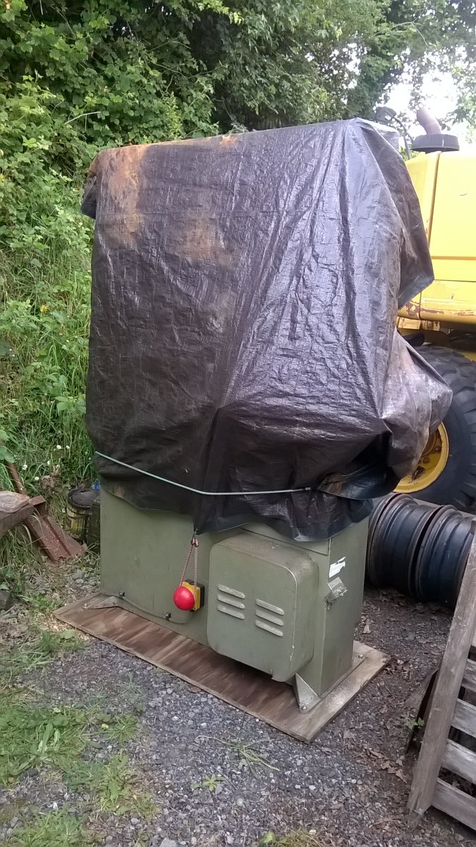

so wound up the 'Drema yesterday and plonked it on the bench
beauty of having such a small bum to her, is I rarely have to move it far for doing stuff on the bench .....
having gotten the ply bolted on - went and got Pam to eyeball the landing for me ....... will be very handy for me by there and easy enough to plug in the VFD -- all me boxes have light and power sockets down their length

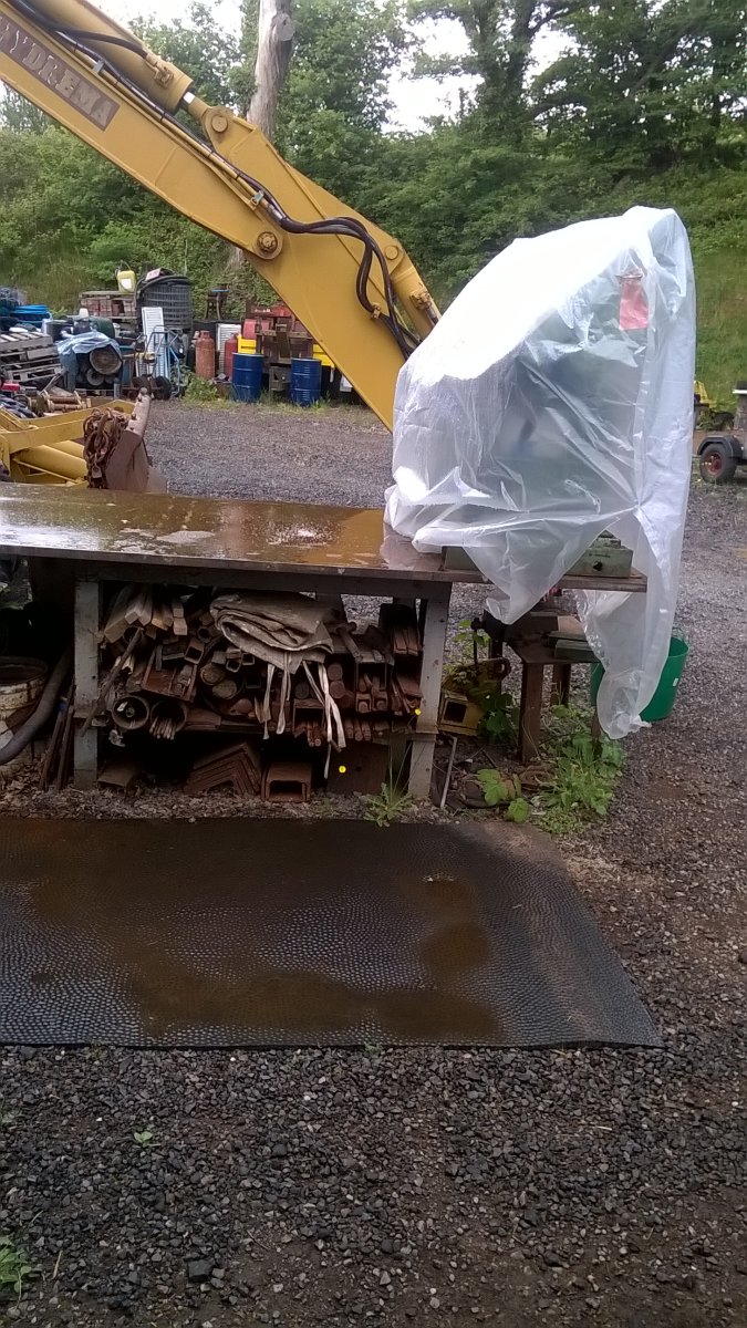

and within 10 minutes of moving it it was spitting the threatened rain :mad:
so .. chucked a cover back on
must get a bigger tarp. -- 4m x 2m should completely cover it - might even get a pucka cover made for it ... wouldn't be a difficult thing to get done and sussed the measurements not long after it arrived ... summat along these lines'd do a great job -- where did you say you got a cover made recently @6feetdown
Would match Lil' Jakie then :LOL:

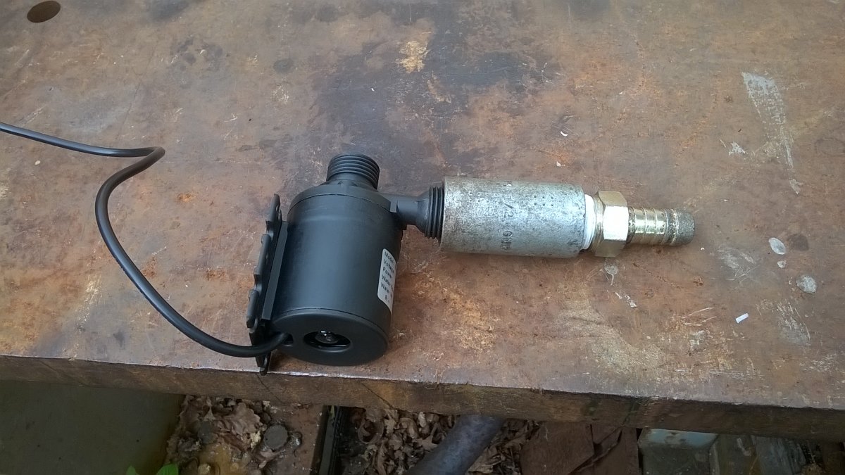

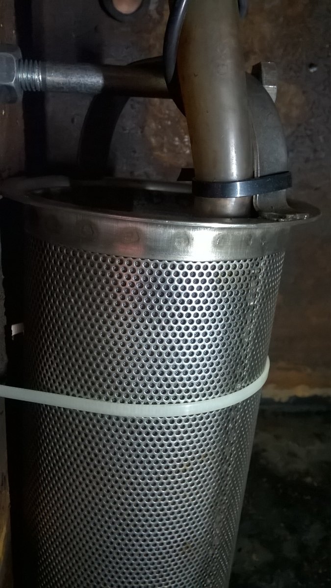

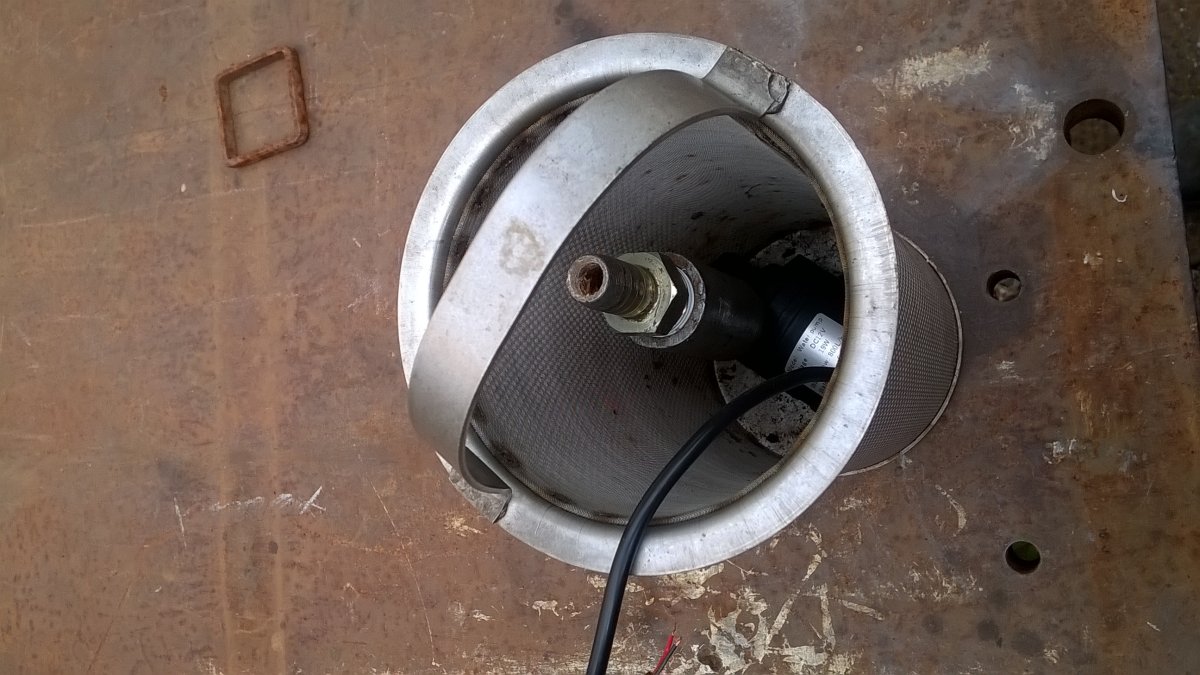

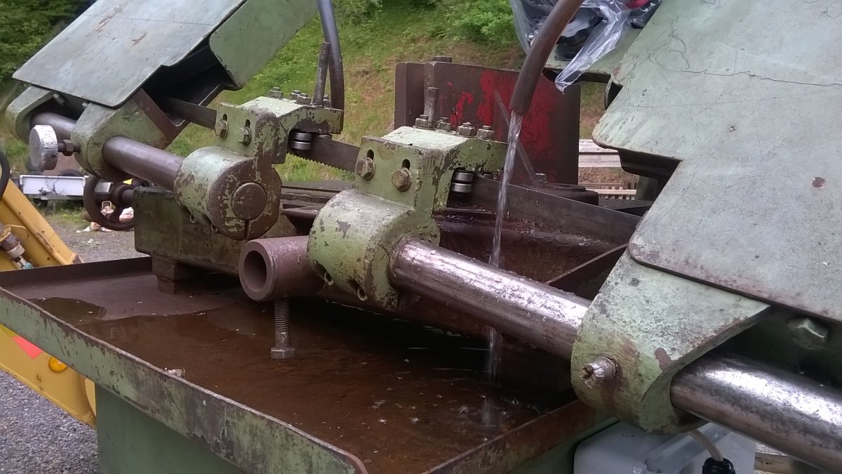

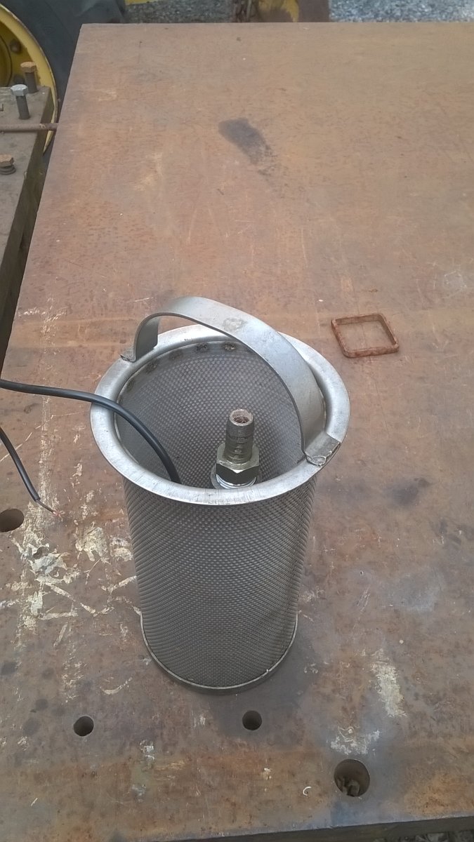

then I had a look at the suds for the horizontal
remembered that I had a couple of these - can't for the life of me recall where I picked them up, but thought they'd make an ideal filtered sump for a pump

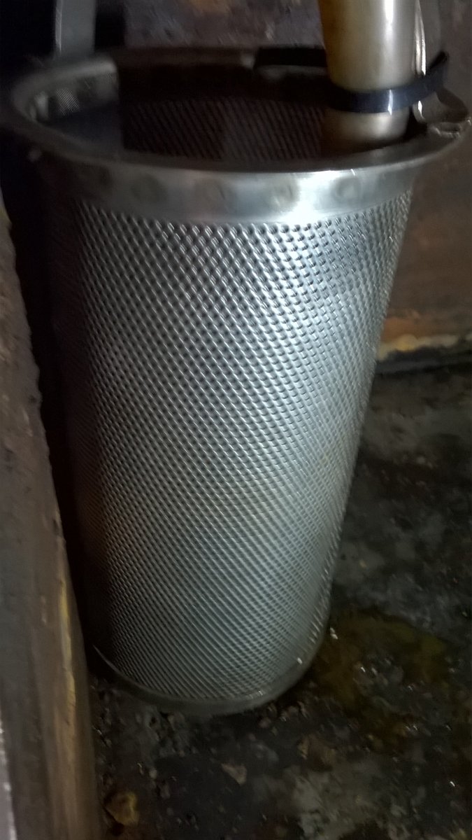

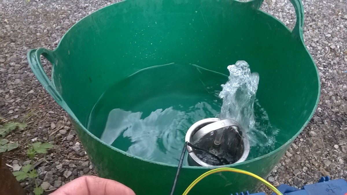

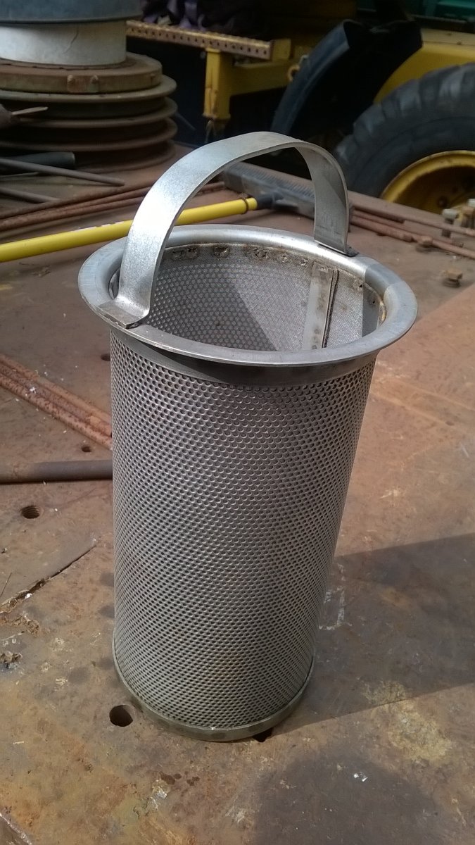

found meself some fittings to 'add' to the new little pump(s) that'd arrived
and they were a perfect fit in the filter baskets
gave the pump a test out in a bucket of water with a 12v battery and seemed to be pretty good ... supposedly a 5m head and 800L/hr.

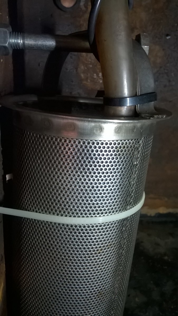

wanted to keep said basket off the bottom of the saw's suds tank, so fixed a long 10 mil. bolt in the side of the tank, to hang it on and give clearance under it --
getting some decent pix was difficult with only a hand sized hole to get the phone into
should keep the bottom and the pick up out of the inevitable tish build up at the bottom of the tank.

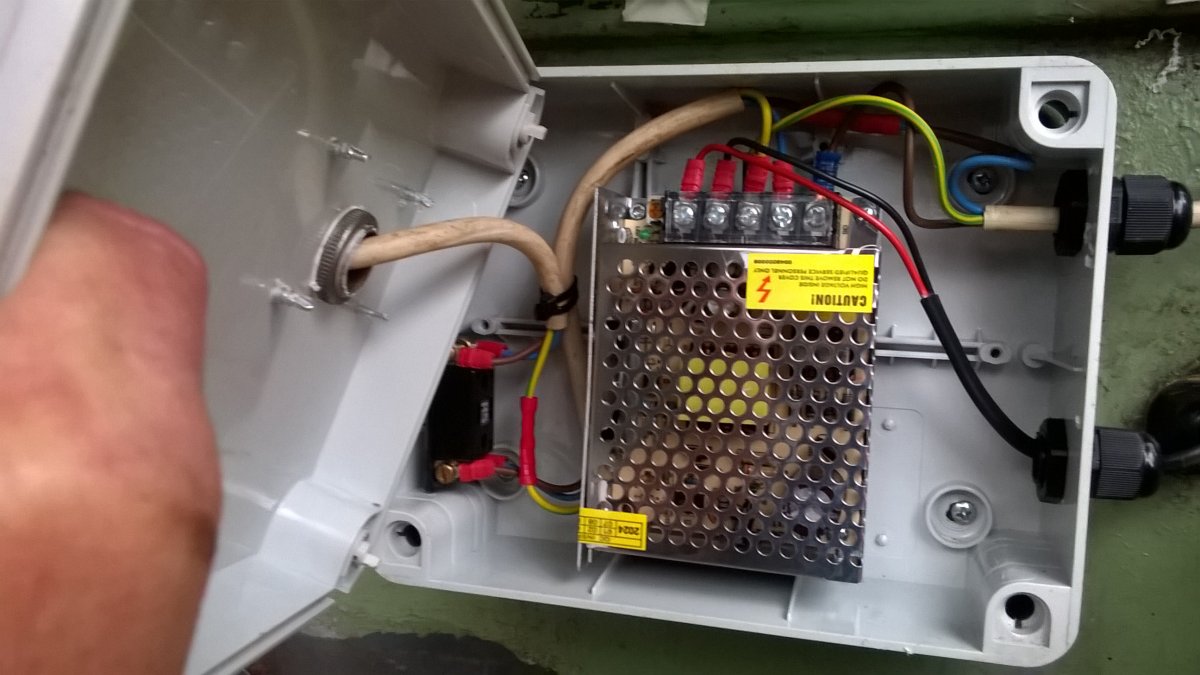

and then it lashed it down :( for best part of an hour :mad:

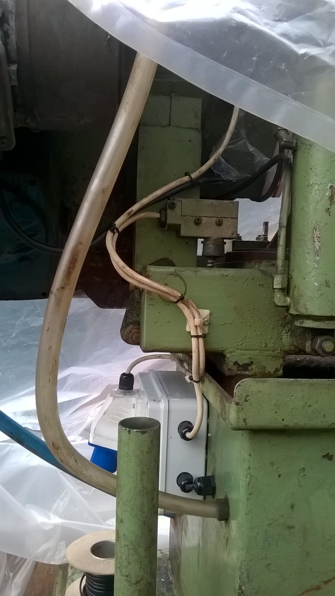

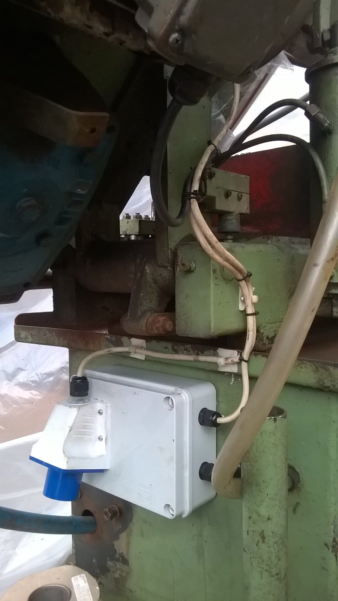

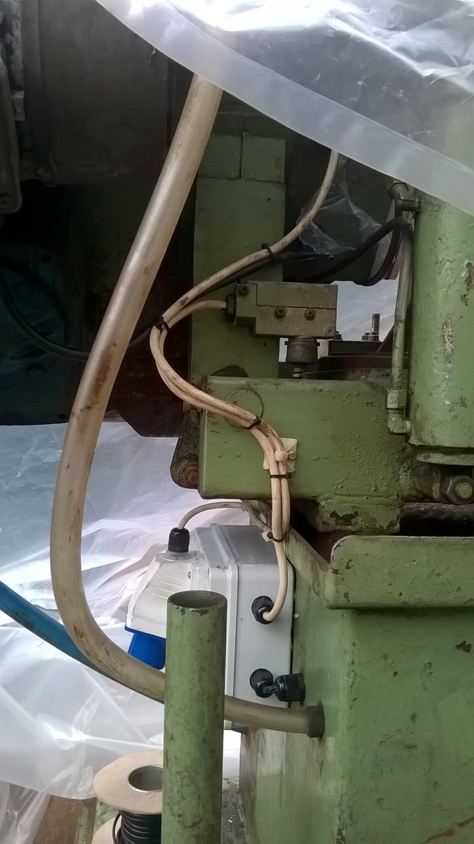

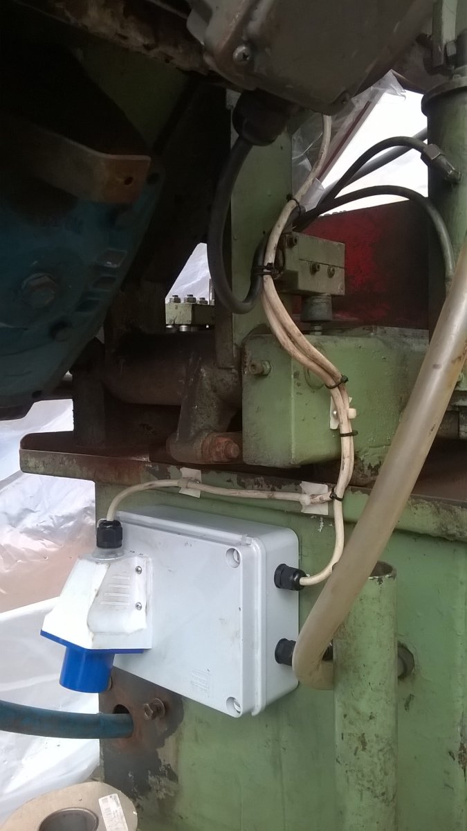

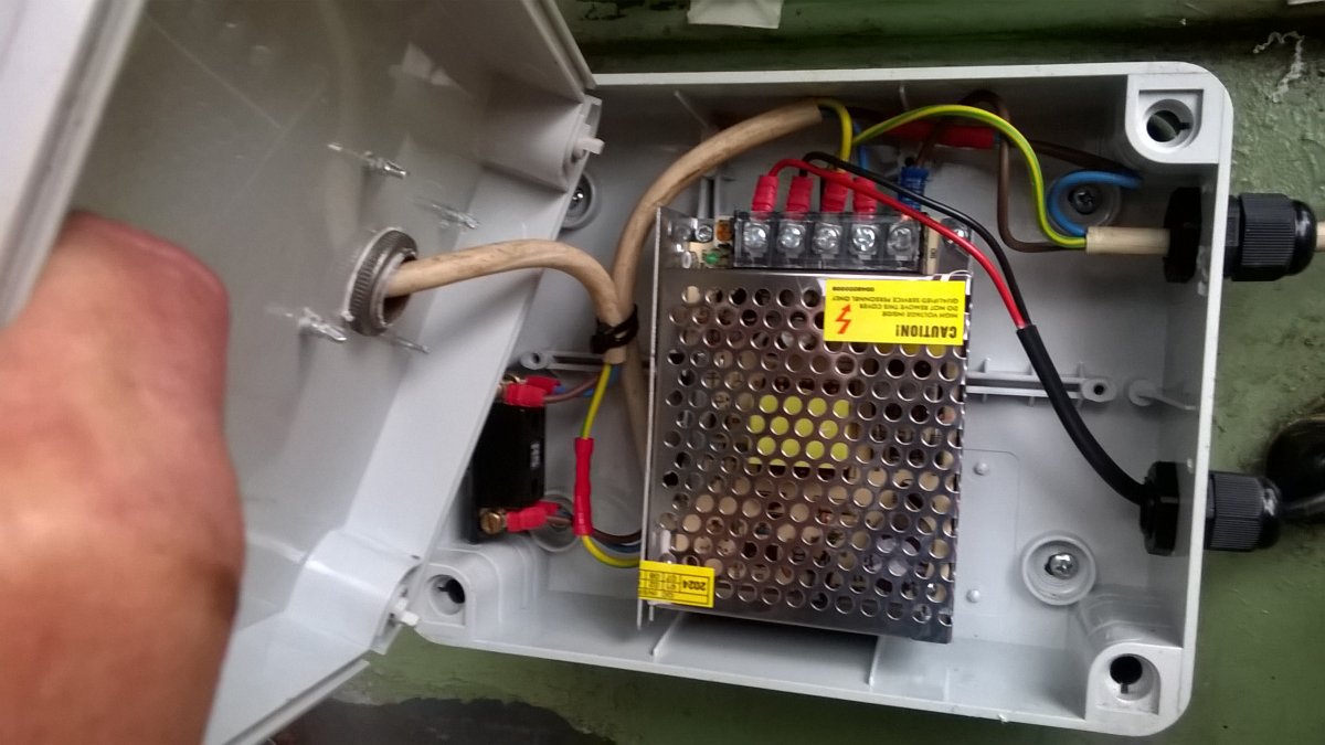

hid under the placcy cover when it eased off a bit and re-wired the 'bottom of cut' micro-switch with a longer lead, to incorporate it into the suds operation - to shut off at bottom of cut and routed it . ... extended the rather short lead the pump arrived with and routed that out of the tank and went and found a suitable lump of pipe to connect to the pump and suds feed in the saw's bow -- once it'd stopped persisting I could get the cover off - get some pix and route/connect the extra wiring into to connection/power supply box ..
added a cable tie for stability
got it all connected up (nice little power supplies these - available in all sorts of sizes/outputs)
and gave it a try out in situ ..
after I'd adjusted the voltage out of the power pack to the full 12v (produces 5 to 12v) and put sufficient water in the saw's tank to cater for covering the pick up - pus a bit ;)
works beautifully , but need some control to each guide's nozzle -
they share a tee-ed supply and the one gets priority, so need to fit some taps to the lines or nozzles to equalise their respective supplies - other wise flood coolant aplenty -
will add some soluble once I've finished all the details ..
prefer to just get wet ATM, messing with it, without getting oily too ...
may have to fit some splash guarding to the guide heads too --
unlike the Meba's guides which're enclosed and keep the coolant under control, these tend to throw it out of the guide rollers in all directions, when the blade is running ...
some strategically placed/fitted door curtain'd do the job nicely and could keep it tight to the blade, making the coolant simply drop downwards (y)

View attachment 72514 hid under the placcy cover when it eased off a bit and re-wired the 'bottom of cut' micro-switch with a longer lead, to incorporate it into the suds operation - to shut off at bottom of cut and routed it . ... extended the rather short lead the pump arrived with and routed that out of the tank and went and found a suitable lump of pipe to connect to the pump and suds feed in the saw's bow -- once it'd stopped persisting I could get the cover off - get some pix and route/connect the extra wiring into to connection/power supply box ..
View attachment 72512 View attachment 72511
View attachment 72510 added a cable tie for stability View attachment 72509
