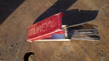

selection of torches - NM250 omitted - CNBA to drag it out with 10m of hoses attached :rolleyes: or the little AFN with cut head and 7m of 1/4 hose attached
AFN cut head, type 3 and swaged nozzle adadptor, type 5 with cut head and full size nozzles, and a heating torch (IIRC a Livermore jobbie) and a DA pepper pot heating nozzle which replaces a conventional full size cutting nozzle

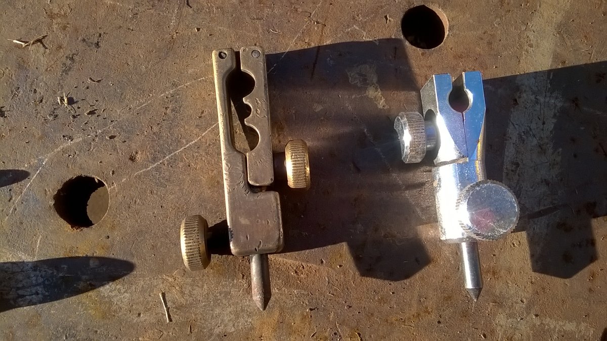

these are a handy addition to yer kit .. attached to the gauges, saves swapping bags and torches ..................... or can always use these adaptors to take a 3/8 hose down to a 1/4 to fit on an AFN, but makes the torch unwieldy for fiddly work

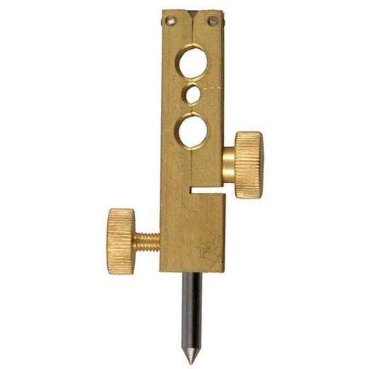

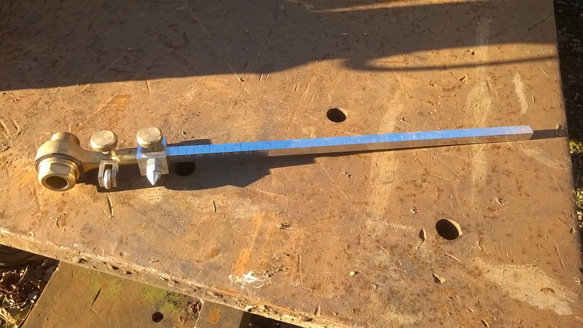

circle cutters ... a must have, either clamped to the torch and rotate the torch like a trammel ........................................... or this replaces the nozzle retaining nut and use it like a trammel with the torch free, to hold in any position - good for big radii

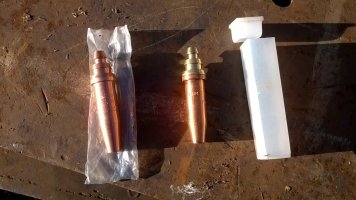

nozzle varieties -- std full size DA and an AFN mini DA type - great for fine work -- Full size DA and a two piece full size propane

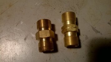

these are also handy items .... hose joiners for those 'bigger' jobs - the notched
fittings are LH thread=fuel gas - no notch is RH thread=O2 /argo/non fuel .. ...... these are a must have - nozzle files for keeping yer jets clean (and circular)

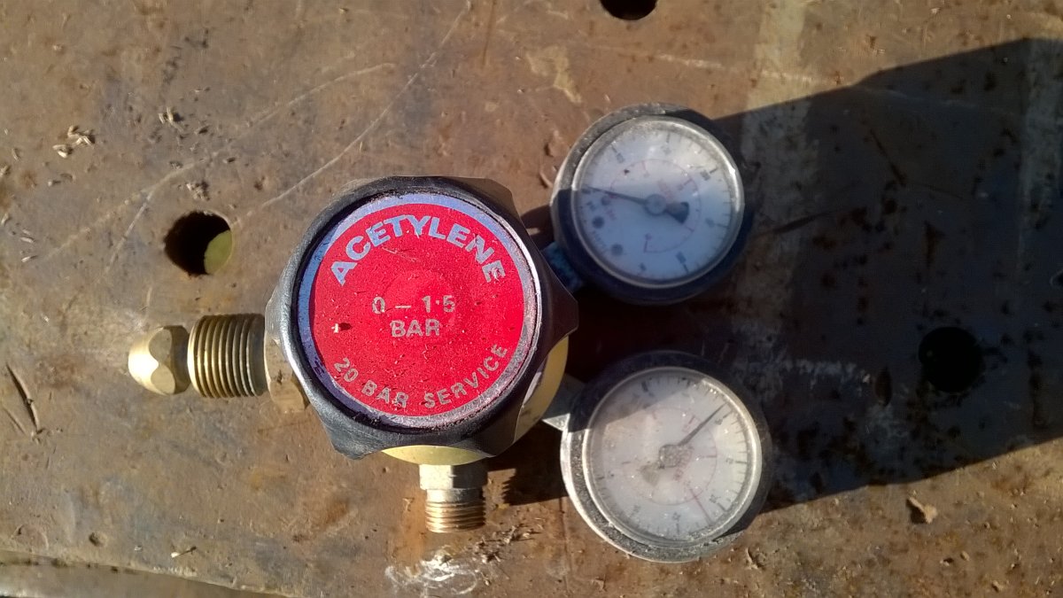

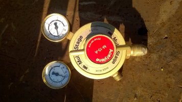

gauges .. two clock, multi stage -very controllable - gives contents and output pressure -- ditto - single stage, two clock, less accurate regulation of gas ............. single stage - no clocks - great if on site and don't wanna get yer clocks damaged
WP_20250102_13_33_49_Pro.jpg WP_20250102_13_33_57_Pro.jpg WP_20250102_13_35_15_Pro.jpg
can also get single clock, single stage, which only gives bottle contents and the body stem has approx. graduations for output pressure - pretty inaccurate but ok for rough cutting, etc.

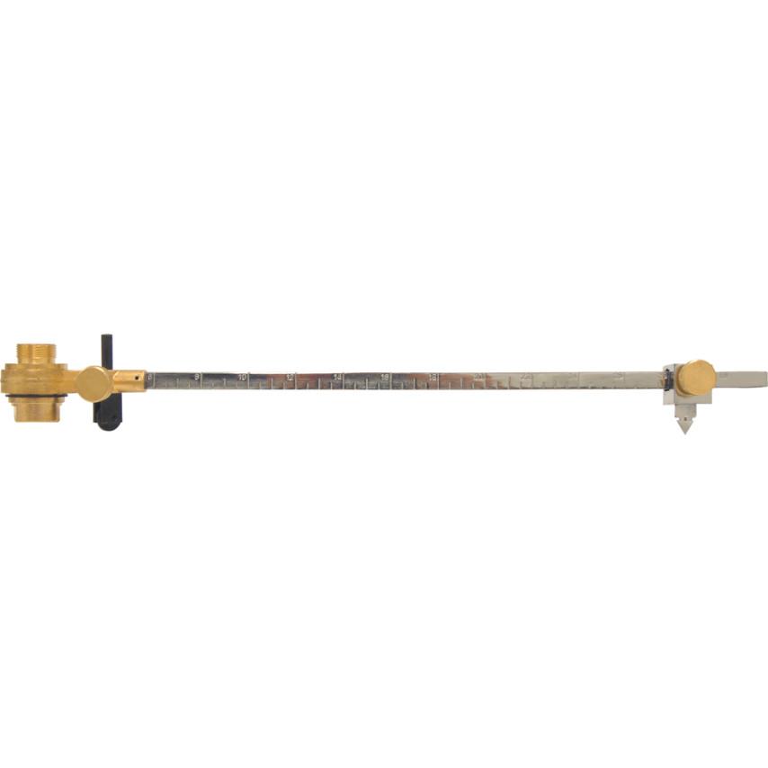

Do you have a good place to get a nice circle cutter (both little and the larger radius one) like you've got here?
thanks
