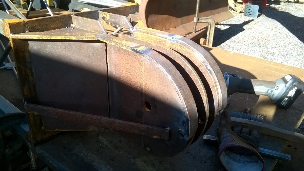

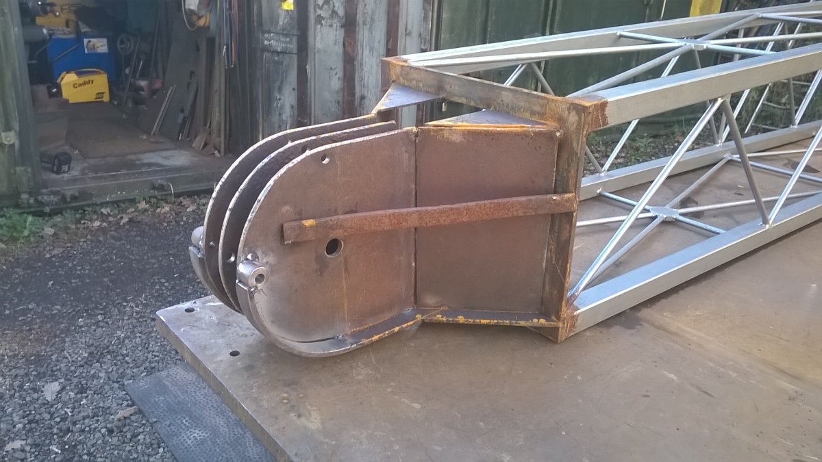

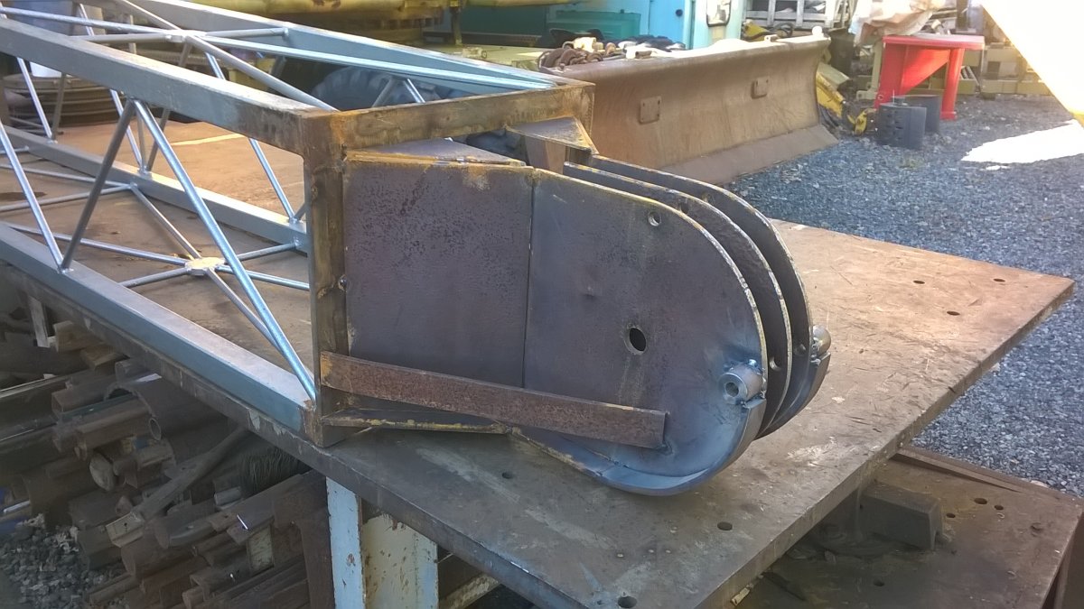

I'd gotten the cat head attached last week after some careful setting up (which I don't seem to have piccies of :unsure::confused:)
and stitched in place
then got some gussets into it
and some ribbing to stiffen things up some more

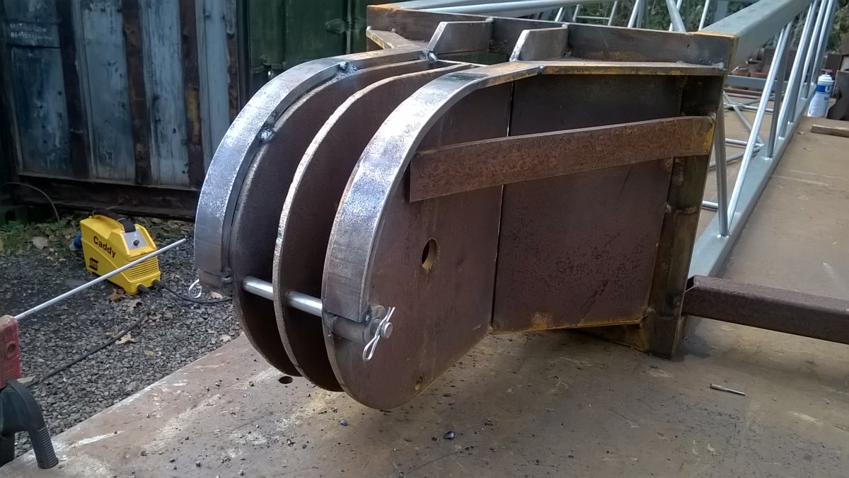

was in the middle of creatingsome curved bits Monday, when Pam decided she was unwell and needed to go to the quack's .. had had the block splitter and a Vee block set up to curve them with (makes a good little press brake) and'd had to wrap up PDQ ...
got them tacked on this afters and had made some pin guide bosses and tacked on too
then cut a few S/steel pins to suit
but progress was slow :(

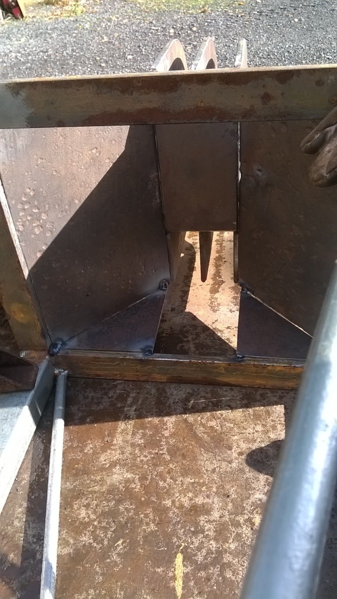

View attachment 65552 View attachment 65551 View attachment 65550
View attachment 65547 View attachment 65546

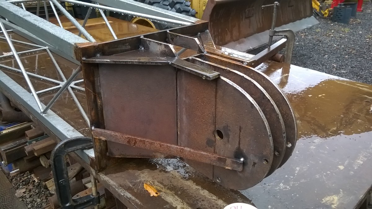

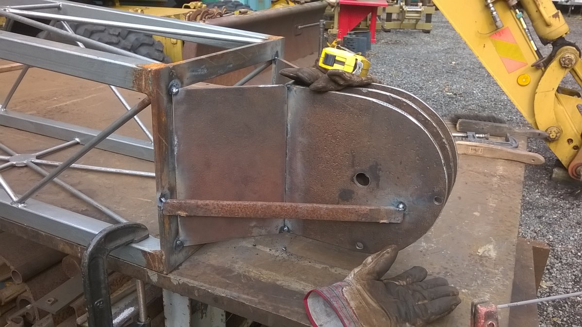

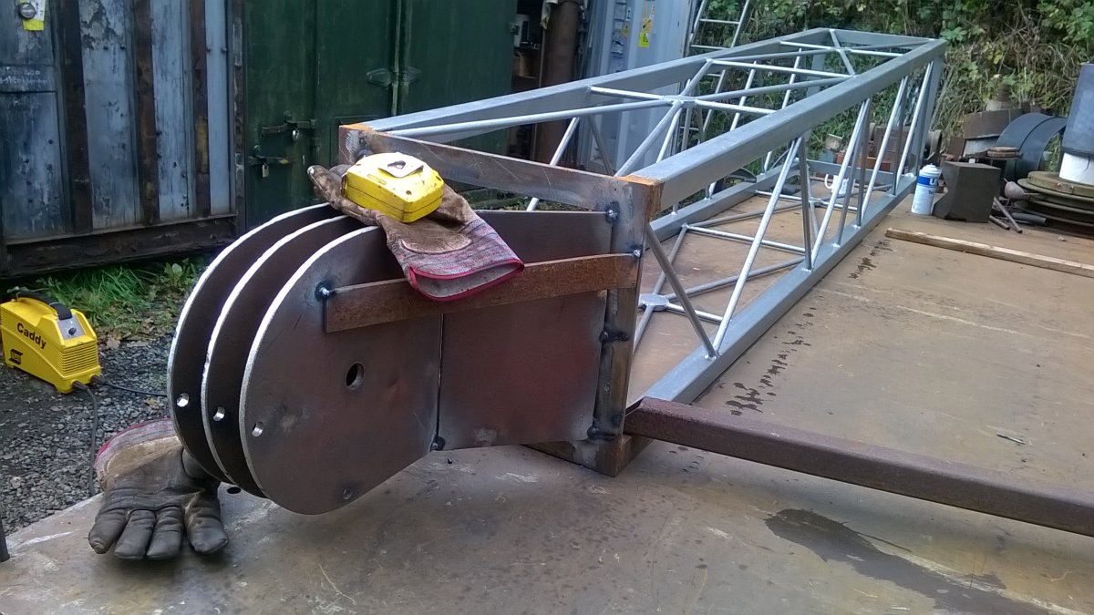

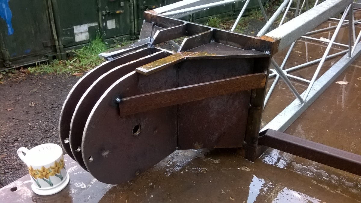

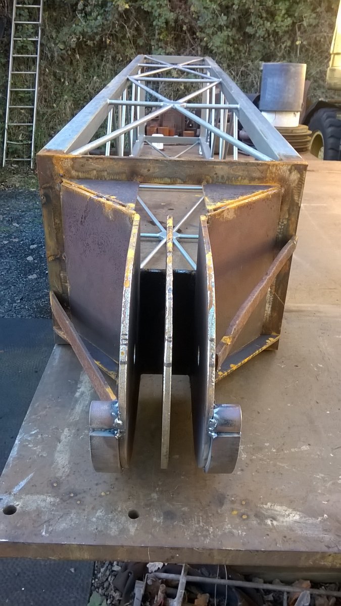

View attachment 65545 View attachment 65544

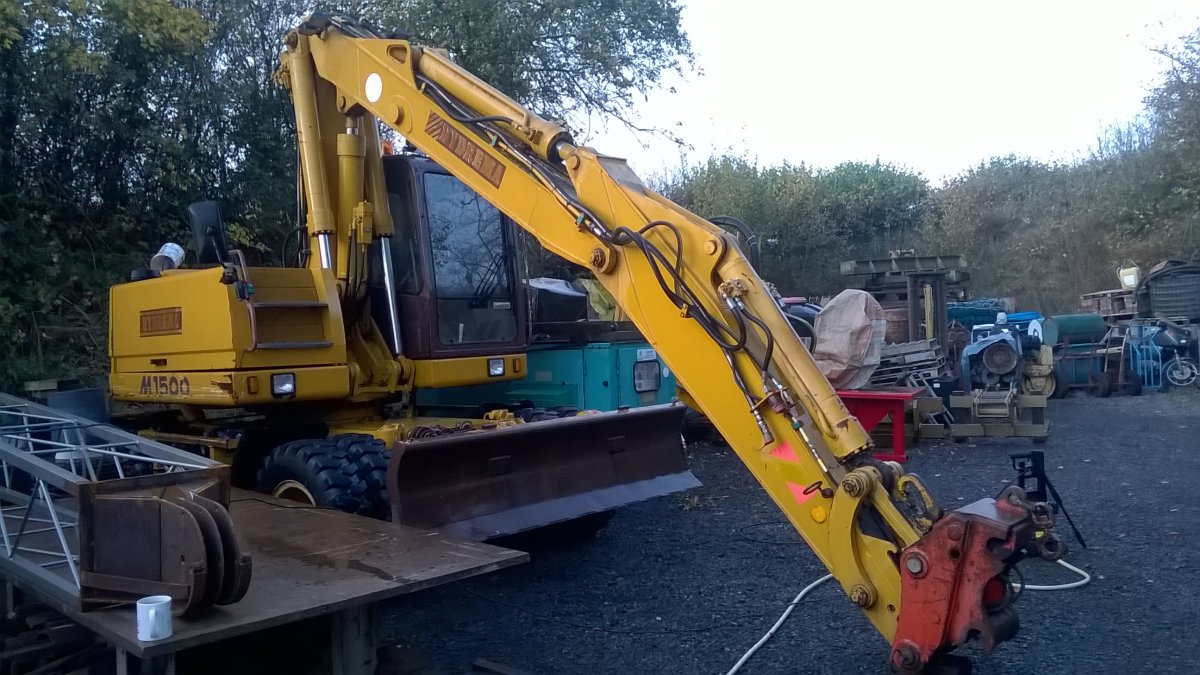

had just rolled it all over and was contemplating the next bits, when it started to spit ...
View attachment 65542 View attachment 65541 View attachment 65540
and then lash it down :(:(:censored:

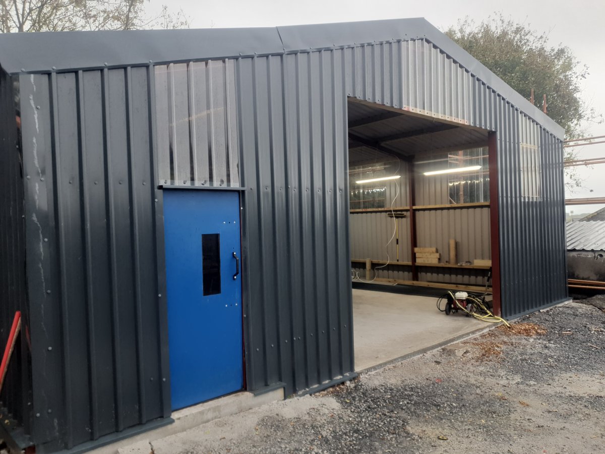

Our new workshop project 8m x 8m, still needs to be wired but the electrician has no word ..........................................................................................................................................................................................................................

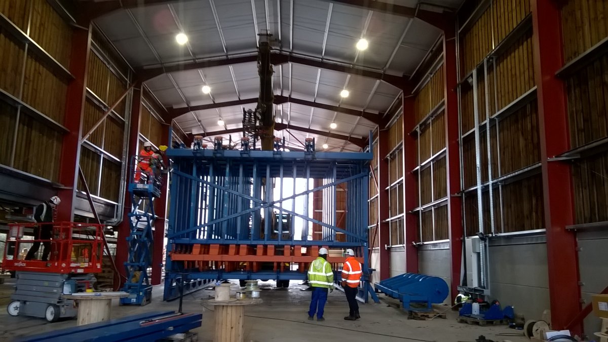

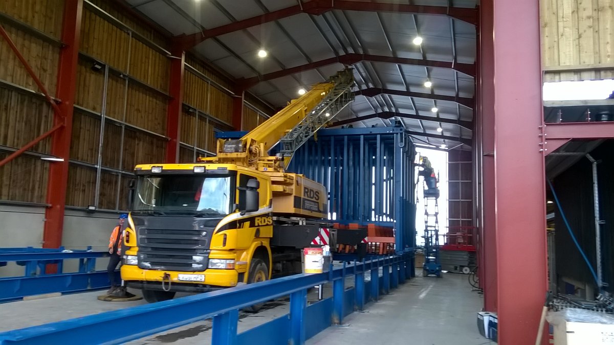

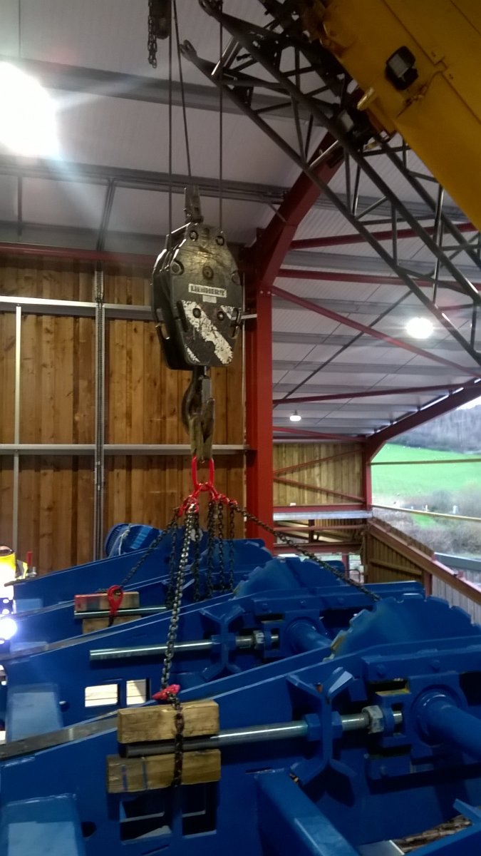

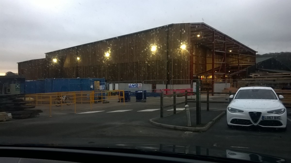

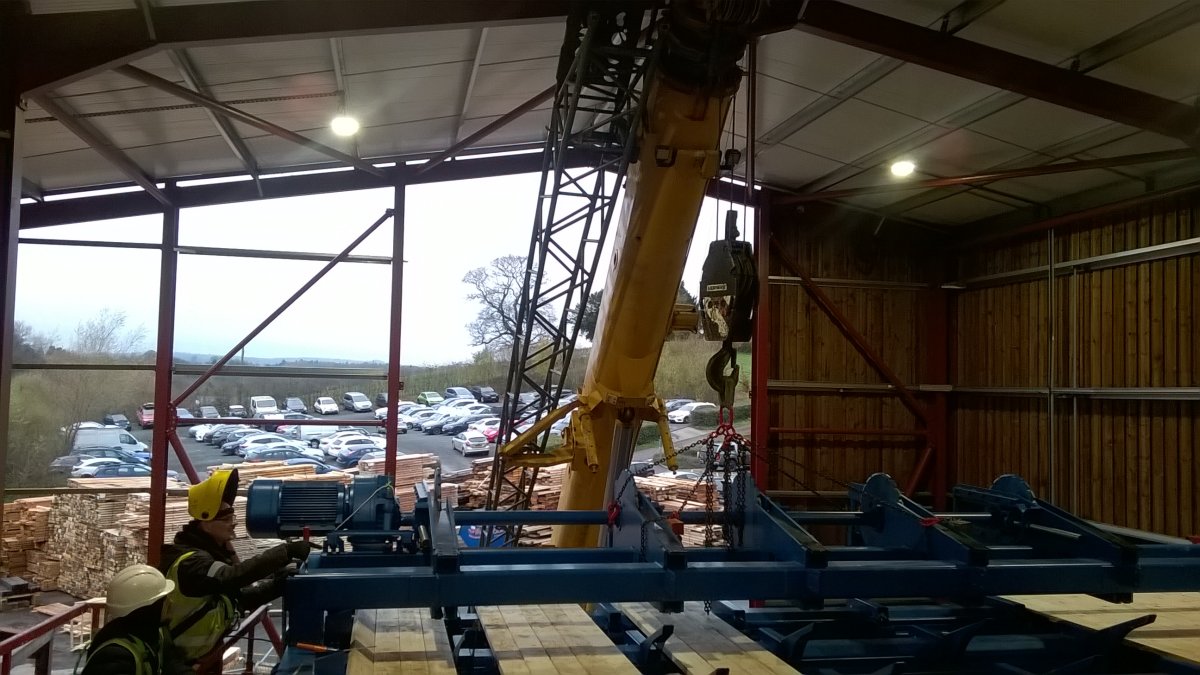

managed to have a day out with Russ on the 20th (well 5hrs anyway :rolleyes:) down at Pontrilas doing a few tricky lifts, installing a drive system onto a log sorting rack - tight was not the word - bunch of Geordie lads and a couple of Poles .. a good craic was had
WP_20241120_13_49_09_Pro.jpg WP_20241120_09_34_37_Pro.jpg WP_20241120_09_33_16_Pro.jpg
they then assembled the rest of the sorting racks and we returned yesterday to place the other end onto the rack system ... Russ'd already got a hot tub booked in Zooport first thing so was a relatively civilised start for me ..
rang me at 10.00 when he was leaving there and met him down at Pontrilas at 11.00 -- rolled in together, as he passed me at Llangiwa whilst waiting to get out onto the main road - perfect timing :giggle:
WP_20241129_13_37_06_Pro.jpg WP_20241129_13_36_01_Pro.jpg WP_20241129_13_36_28_Pro.jpg WP_20241129_13_36_23_Pro.jpg WP_20241129_13_37_34_Pro.jpg
both lumps, each end took some crafty slinging to get the damned things level for the lifts and this end took some swinging in through the doorway, as it was sat outside - no where to put it inside, this time, to get a hold of it, 'fore we went in
big old shed .... 'til you try and do anything inside it
think there's a few more bits to go in there yet :rolleyes:
was home eating me lunch by three o'clock:giggle::cool:
