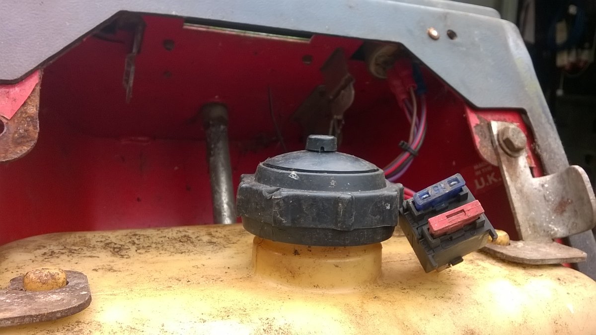

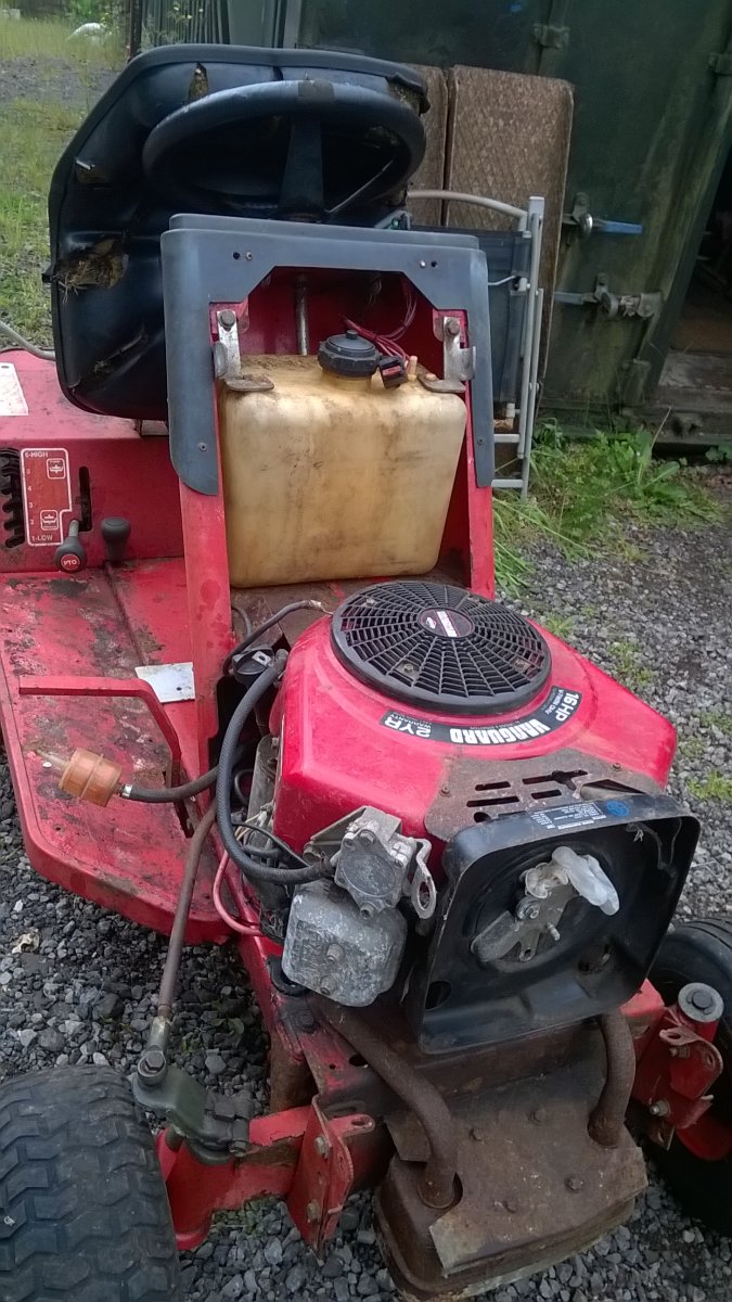

created a new loom and re-wired it this morning...
the mystery terminal Gavin, was as I thought, - a kill line -- had the fan cowl off this morning and it's connected to the twin coils to earth 'em out.
Ignition switch took a bit of sussing .. interesting set up ... has a set of kill terminals, permanently connected when off, open circuit in run position.
So set them up to ground that kill terminal - float chamber solenoid's on the run circuit, starter solenoid on the crank position .. works fine have had it firing on carb cleaner (y)
Poor old spark though .. gonna have to have the coils off and clean their faces off - got the flywheel 90% better than found, but guessing the coil's faces're rusty too and 'screwing up' the air gap.:(
View attachment 61010 View attachment 61011 View attachment 61009 amazing how much gear you need out for a piddly little job like a re-wire :rolleyes:

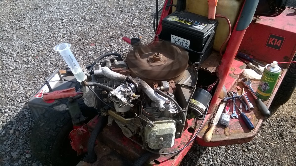

after yet more cleaning of the magnet's face and asking Serge for the air gap on the coils (he worked on this sort of gear in a.n.other life [when we were both a LOT younger]:giggle:) set 'em at 12 thou and jury rigged some fuel ... and it was away
after reassembling it all it got a spin round the patch .... top is pretty 'kin quick - for a mower ... it's 5 sp and reverse - K14 model Angus @modelman093 and yes the kill wire is purple :giggle: .. not hydrostatic as far as I can tell - needs the brake/clutch pedal to engage/change

Both plugs wet and sparking but not firing is a bit odd but from a distance it’s a bit difficult to know what to suggest - when did it last run ?
As far as not cranking goes it’s possibly a safety switch issue - just try a jumper from bat+ to the solenoid activating terminal.if that wakes it up it is then a hunt for why it’s not getting the wake up from the key switch.
does it have a fuel cut off solenoid under the main jet like this Vanguard Angus? .... enough fuel in the manifold to moisten the plugs but not drawing anything through the main jet to get it running? ... the Dane has a similar solenoid set up in the float chamber - can hear it click when ign is turned on ... presumably it'd need a live feed in the crank position?
is the loom from an identical part-er @Big Jordy ? any sign of life at that solenoid (if it's the same/similar set up)?
the single cylinder Hodna on the Countax mower has a fuel tap at the carb.
Yea the loom is identical and it’s got a brand new solenoid on it. Also it ran twice after the loom change then just lay down will turn over but not start honestly I’m baffled.. all the safety switches on original loom and funnily enough new one have all the safety switches doctored.. just to say it’s never started on the key so I replaced the ignition switch/barrel and it made absolutely no difference. Only reason I kinda want to fix it is it cuts bloody fantastic, 48 inch deck and I got to admit I love the west wood grass collector..
Diagnosis at a distance is always an issue. Just to be sure to be sure you have got sparks and after cranking it are the plugs wet and are you disconnecting the purple wire when cranking just to make sure that nothing strange is going on with the ignition. So as to avoid misunderstandings - switching off the ignition kills the spark (s) via the purple wire. The solenoid valve on the carb is to prevent “ after fire” . That’s when the ignition has been killed but the overrun of the engine draws in fuel which has nothing to ignite it until it’s ejected into a hot muffler with, perhaps rough glowing red bits inside and goes off like a rifle shot. The solenoid valve is to stop fuel being sucked in via the main jet . If you have a spark and fuel getting to firing plugs the issue is something weird such as valves or timing - might be worth checking the flywheel key. With electronic ignition a partially sheared key will still produce sparks but at the wrong time - whereas a sheared key with points ignition produces nothing,
I literally have no clue as to the colour of the wiring I literally detached the doner loom from parts mower as a whole and connected it to the one I’m trying to sort. I have a wiring diagram for it and the loOm
Is complete and connected as it should be but the buggar won’t start on the key or even now by bridging the starter.. followed this to the letter.
And yes definitely getting fuel and it is sparking and yea the plugs are wet after trying to start.
Thanks
HOW GOOD is your spark ... I had a very poor spark, but no start -- 'til I regapped the coils' air gap with the flywheel . .. then ran sweet
are we talking Vanguard twin

Loosing track of who’s tractor we are discussing but this is the procedure for getting the best spark - same for both single and twins. Remove each coil and clean the top of the pillars that support them, clean the matching patch on each coil armature. Clean armatures where they face the flywheel. Clean the flywheel circumference that faces the coils.
Setting the air gaps. In turn move the flywheel magnets away from each coil, pull them away from the flywheel and pinch up their bolts . One at a time move the flywheel magnets in line with the armature and insert a business card (10 thou“) between the armatures and the flywheel, slacken the armature bolts and let the magnet pull it onto the cards. Tighten up the bolts.
mine's up and running Angus (y):giggle:
I’ll get a look and try this and I’ll report how I get on.. much appreciated all the advice.
