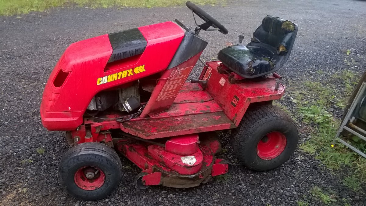

been a very busy day today ..... got given this and it needed removing from this enormous bramble patch, bout 10ft high , with this in the middle of it .... took a bit of getting at - glad I took the Husqy hedge cutter
's never gonna mow again, but might make a replacement for the old Mountfield for tushing trailers about here ... got it out and hauled into a trailer (sorry no pix - bit busy)

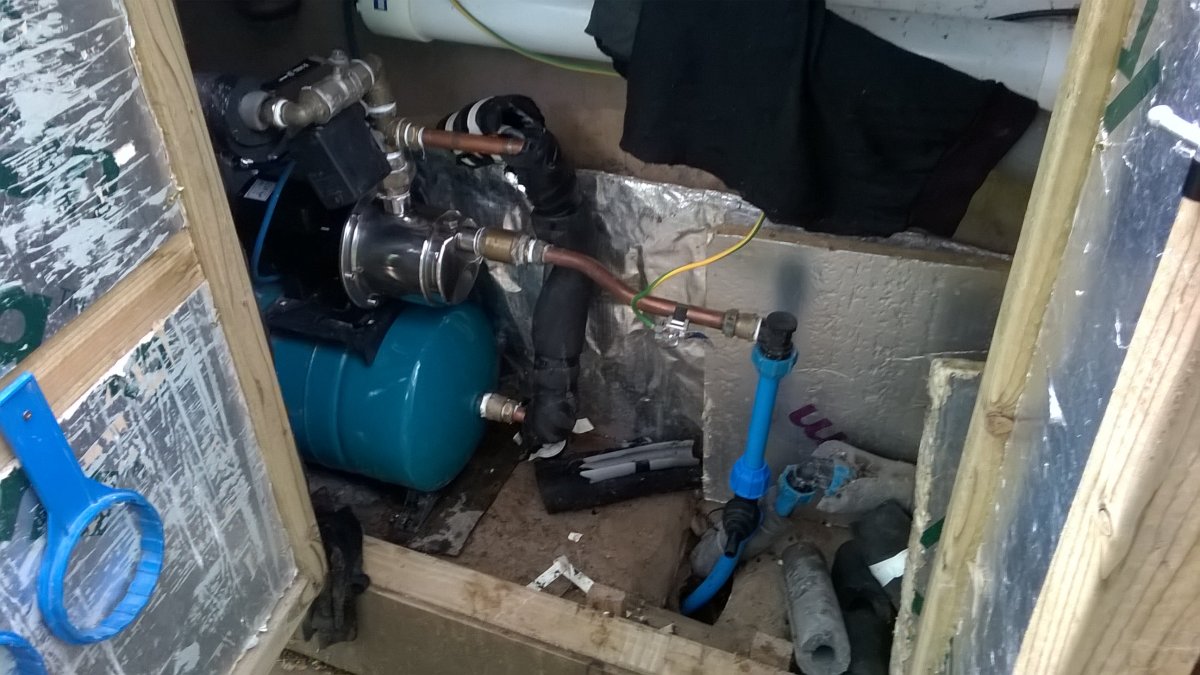

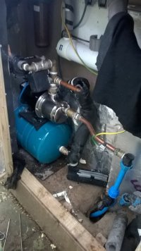

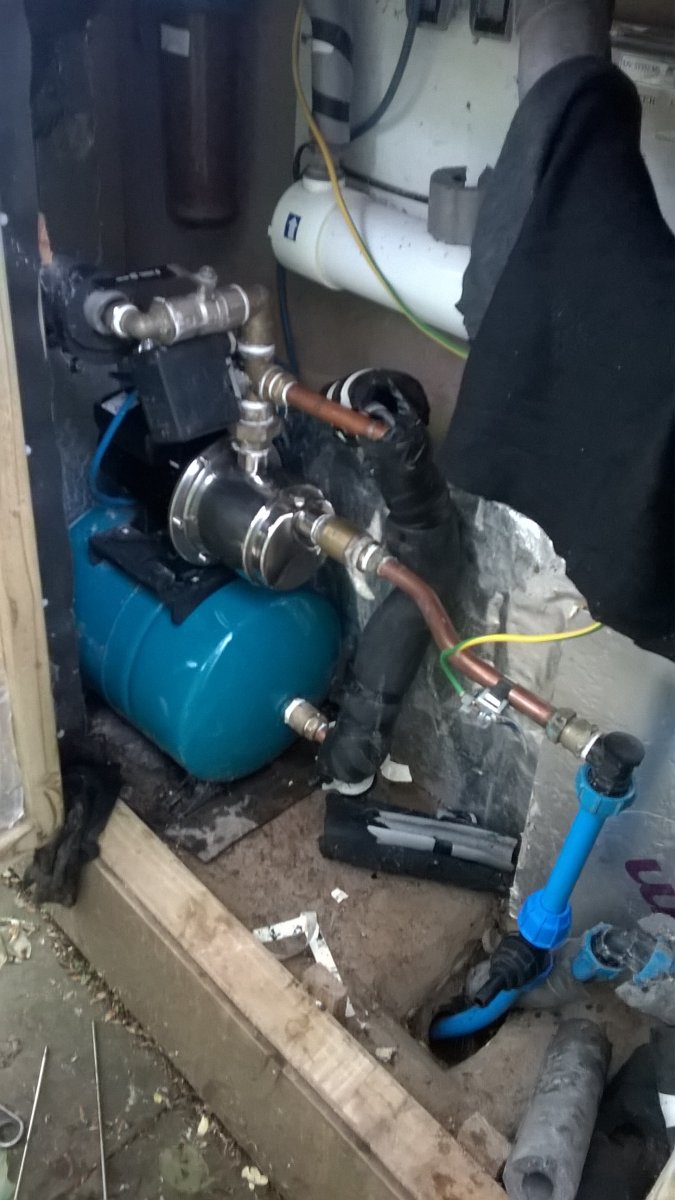

get back into a service area after dragging said Countax out o' the brambles and get a text from our 'nice' neighbours .. would I have time to have a look at their water system again ... it'd stopped pumping/pressurising :unsure::unsure::(

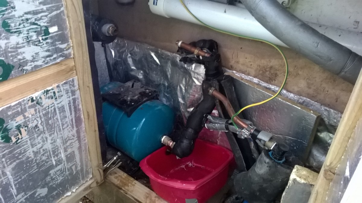

so after pulling the ropes off, bungee-ing a bag over the above and gathering some tools together, went and had a shufty at that ... 's a right pigs guts of a set up
didn't come from there 'til gone eight and gonna have to go back to it .. either got a blocked inlet line or his underground line to the house has decided to leak - just not building pressure - swapped his new pump for a known good spare and still the same :( ... said it stopped flowing mid use, yesterday evening? o_O:unsure: not being able to pressurise the line doesn't bode well :(
love the earth bond - onto an MDPE riser o_O:oops::unsure::unsure:

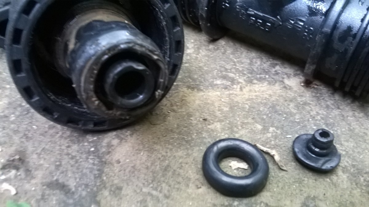

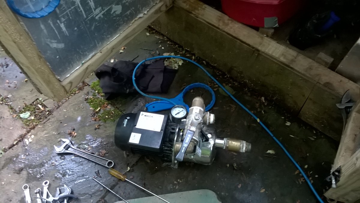

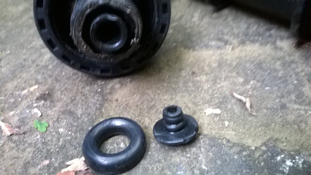

So ... James and Rorie (the 'nice' neighbours), who have two teenage girls had no water this morning and Pam reminded me we have visitors tomorrow :oops: so was gonna have to get down there today. Took Clara to school, grabbed some extra tools and headed down to their place.

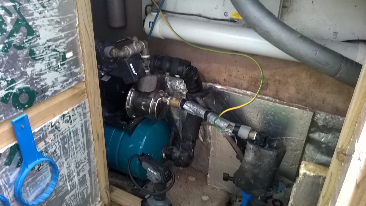

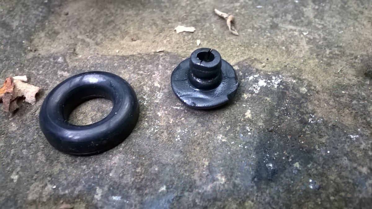

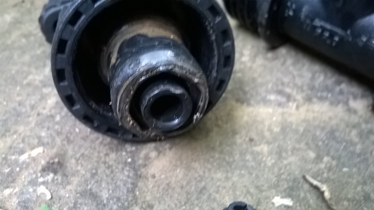

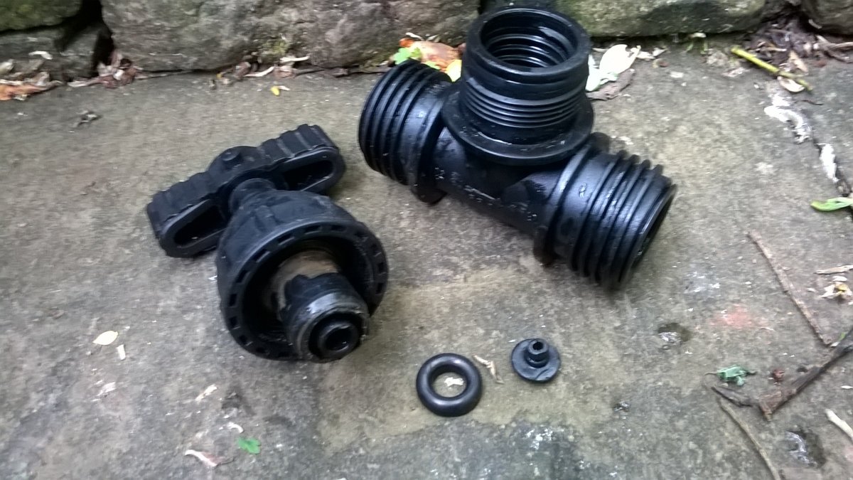

Ripped it all back out, refitted their shiny new pump (circa 4 weeks old, after calling in 'the professionals' back then ) and re-assembled everything, newly sealed/PTFE-ed, etc. back as far as the MDPE inlet line, which was the only bit I'd not had apart, but was now weeping due to all the pulling about. Took a new piece of 'blue' and a few inserts to remake that ... got it apart and put a digit down into the stopcock and felt ----- summat floating about in there :oops: .. stone perhaps?? :unsure:
small needle nose pliers in the hole and out came ... a plastic 'stud' .. 'nother fiddle about with the digit ... more detritus floating about ... repeat process and out came ...... o_O:(
so offed the stopcock from the line (nother gate valve at the tank 30 ft away) so line stayed dry in the pump cab. :giggle: ...
trimmed the incoming, to lose a very ropey looking insert and fitted a new one ..
pulled the stop cock to bits and as far as I could see, confirmed my suspicions that the two extraneous bits were the seat and seal ...
spindle looked very second hand on the end of it and no way was this one going back together properly/functionally - and one of the few things I don't carry spares of ...
so reassembled it, minus its guts and wound it full open, then re-assembled it all with a nice new length of 'blue'
went and turned the gate valve on at the tank and opened up all the various ball valves in the cab ... sounded promising - 2400l head of tanks at same level as this assembly, near as (y) ... house about 5m higher and upstairs bathroom another 4m ... little annex behind the pump cab. so went and bled that through after opening the bleed on top of the pump (supposedly self priming, but wanted to be certain :rolleyes:) ... outside tap at the house is on the pressure line, but too high for the tanks to gravity feed it. So turned the pump on .. outside tap bled up with plenty of air escaping 'til I got some serious flow.:cool:
Rorie'd had to go out and James had left hours earlier. Pam turned up with Harper in the pushchair to see how I was getting on (in the hope me being finished SOON - she's a two man job ATM :ROFLMAO:) ....
perfect timing for me .. house was locked, but Pam knew where the 'spare/emergency' key was and I was in, to purge the whole cold and hot system :)(y)
great flow and pressure everywhere after losing all the air at every tap and cistern.

carted the spare pump and all me tools up to the car ('s a long walk around the drives down to theirs - specially if you have much to carry) and as I'm about to jump in the car I thought I'd just check the outside tap one last time - NADA - not even a dribble :oops:o_O:cry::unsure::unsure: ..
went down to the cab. and opened it up ...
I'd only turned one of the ball valves off to get the lagging on and forgotten to re-open it ..:mad:🤬
Had to open up again and re-purge the bloody lot 😭😭
