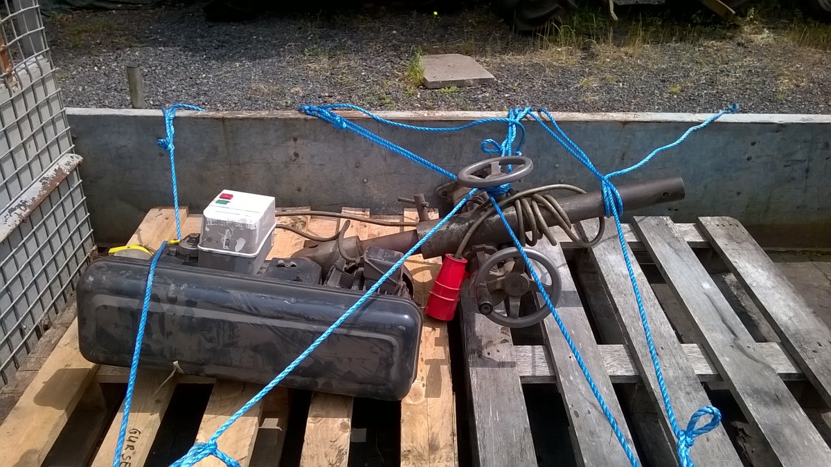

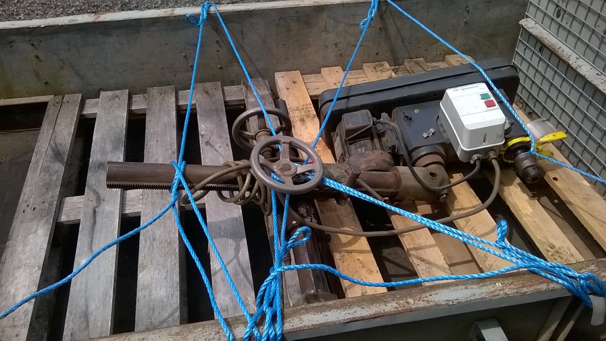

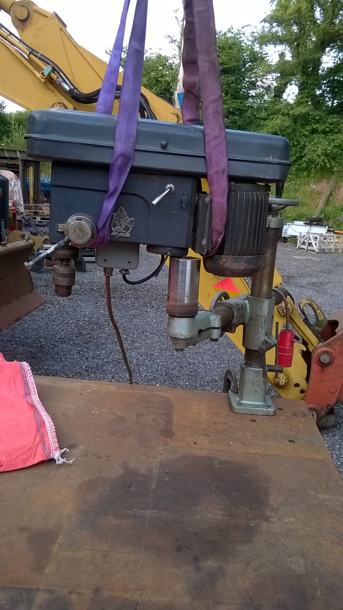

little trip to Monkswood this morning to finally meet Kevin .. got a biz servicing FLTs on site and buys/sells a few too.... nice guy ..... came home with ............this.. didn't trust the floor in Ollie's old Ifor after putting a hole in it and not had time to sort it yet
let's see you ratsh1t that one down ... didn't move an inch ;)

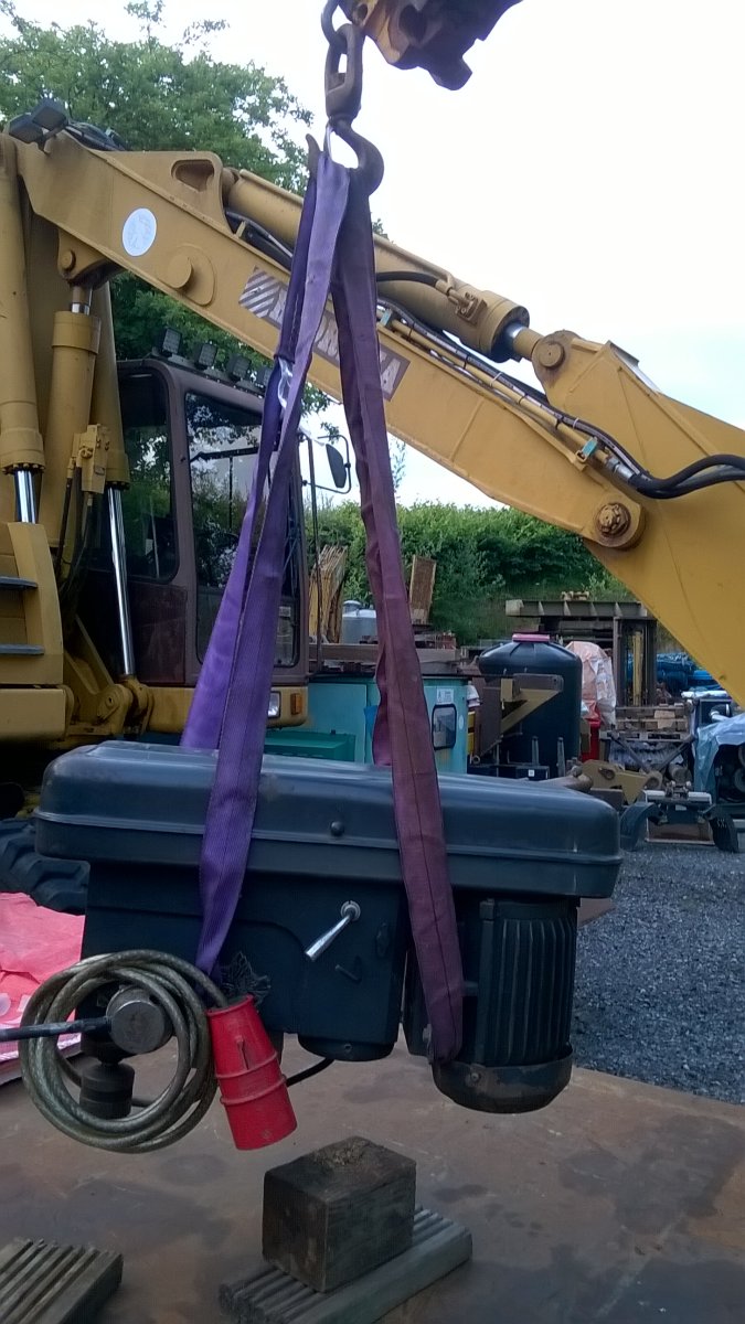

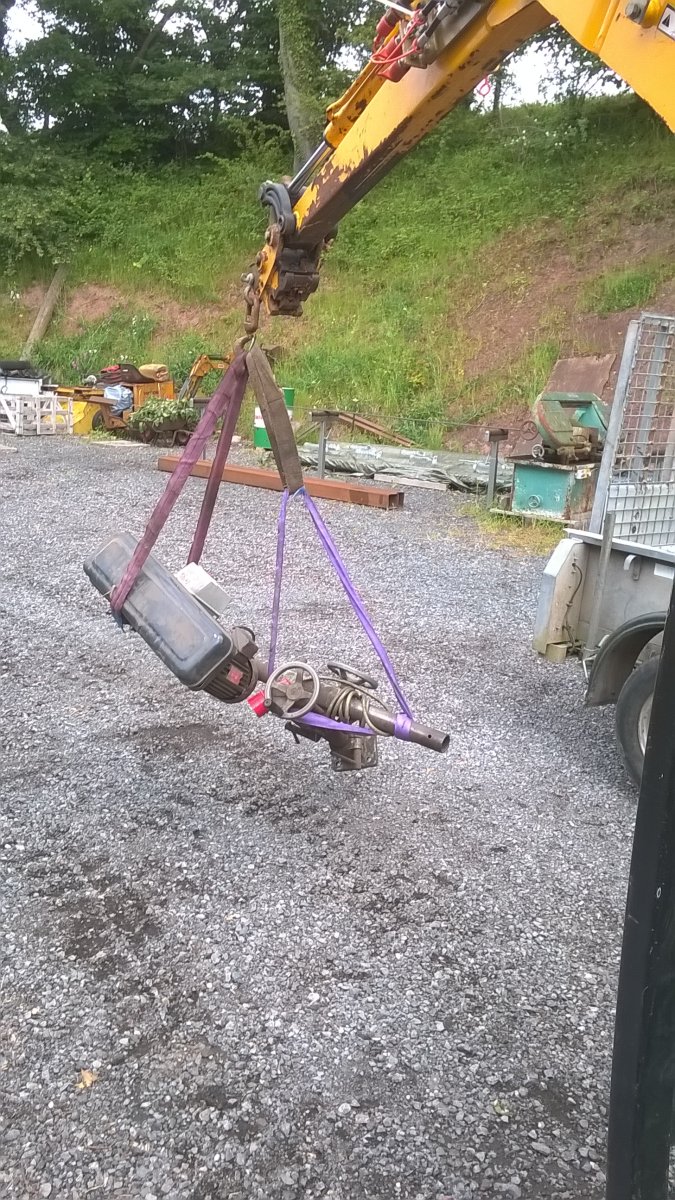

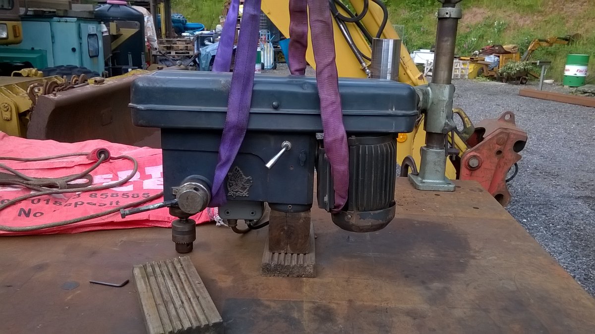

Lil' Jake obliged with the unload ....

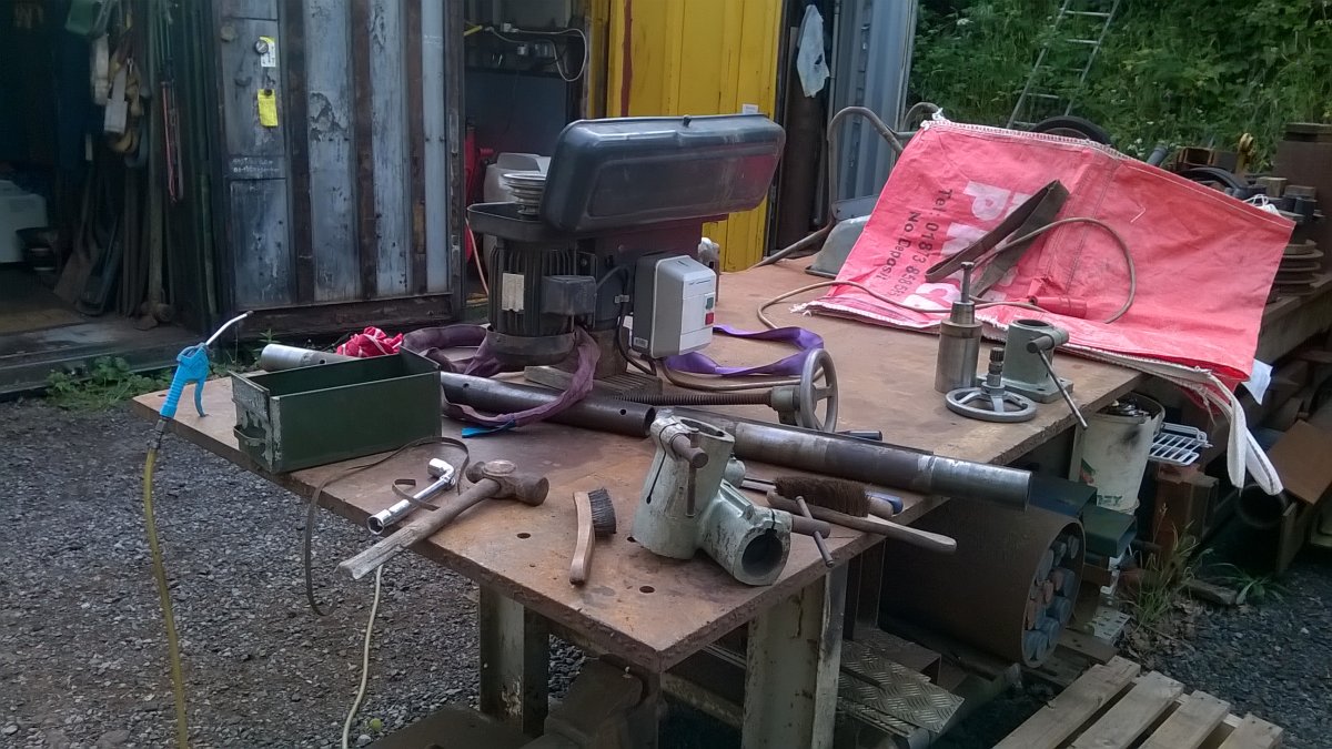

and planting it on the bench ...
for a strip and clean

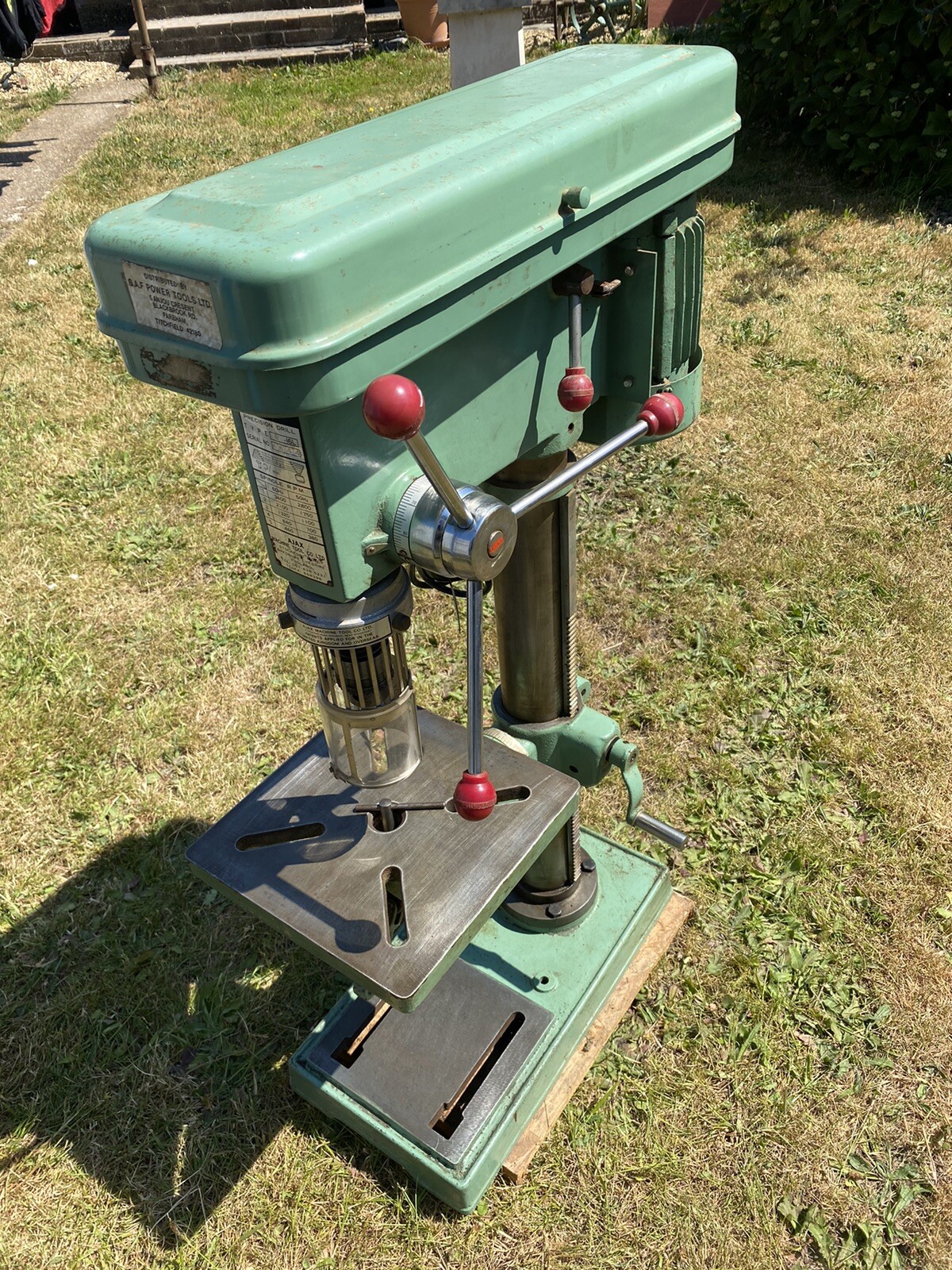

not sure that this is an Ajax OE job .... have a feeling I have seen one of these arms before somewhere, but damned if I can think where .. nicely made though and more than man enough to cope with the Ajax head .. has obviously been used in a wood shop at sometime .. covered in dust and oil mix .. stripped it down to clean it
came up nicely
stashed it all in a box after tea as it's forecast to pee down here tomorrow, 'til Thursday, on and off

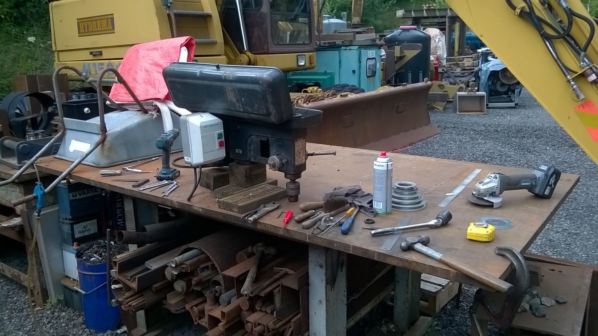

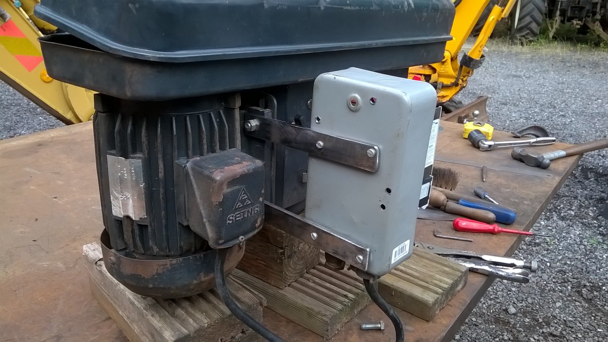

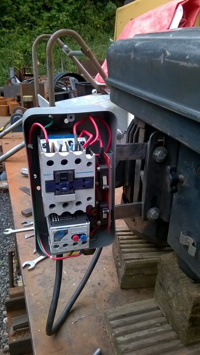

had a quick shufty at te motor wiring, 'fore I paid for it this morning and looks like it'll have to be 3ph only ... or convert it to a 1ph motor ... VFD ain't gonna run it BTLs

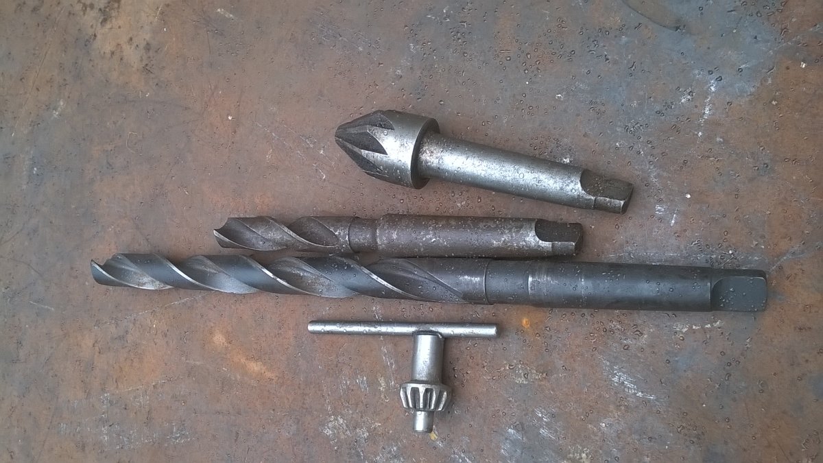

guy also gave me these as he had now't they'll fit/run in ...
the long series must be 40 quids-worth and that's a nice countersink ... chuck key doesn't fit the 5/8" chuck that's in the #2MT spindle, but I'm sure to have a suitable candidate here :giggle:
the brand new push button wants re-locating to a plate beside the motor -- PITA where it is. the rise and fall on the column is nice and smooth, as is the rack on the horizontal arm ... all in all a nice buy at 140 quid

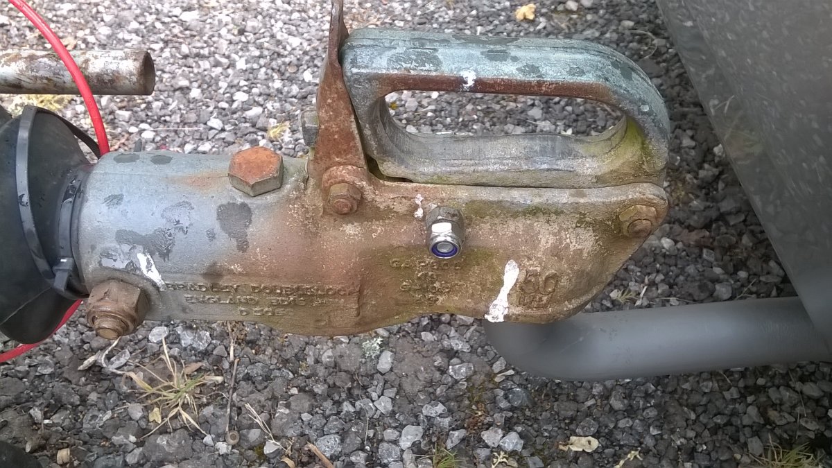

with all the recent trailer losses off vehicles of late I fitted the bolt again .. although a Bradley double lock is nigh on impossible to lose if coupled correctly .... 's a triple lock, with the lock hole filled

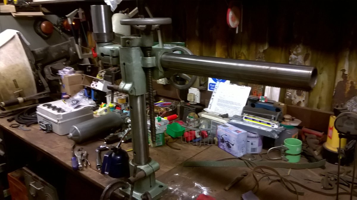

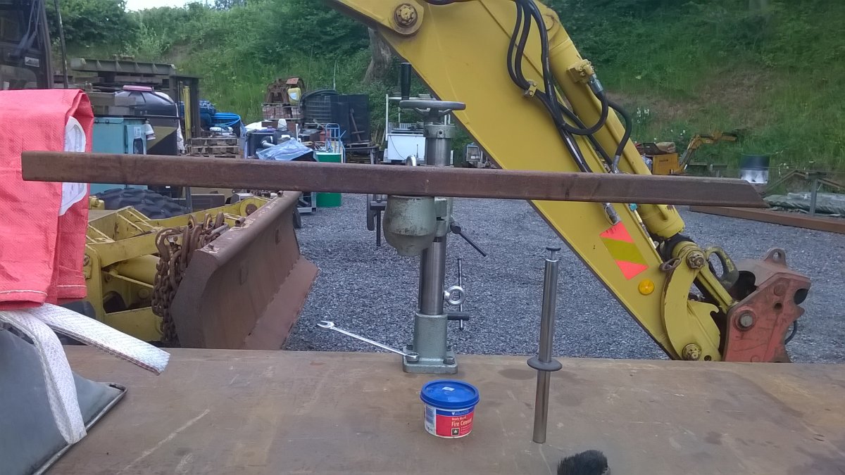

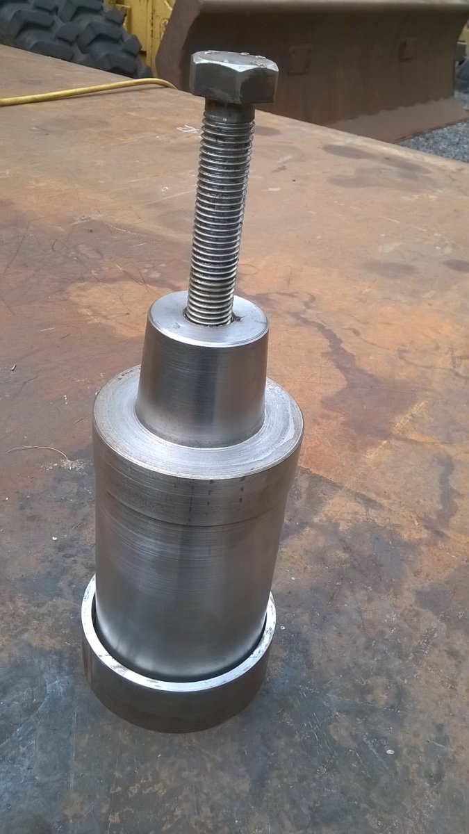

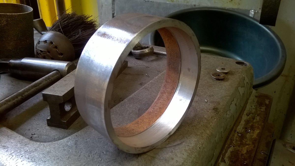

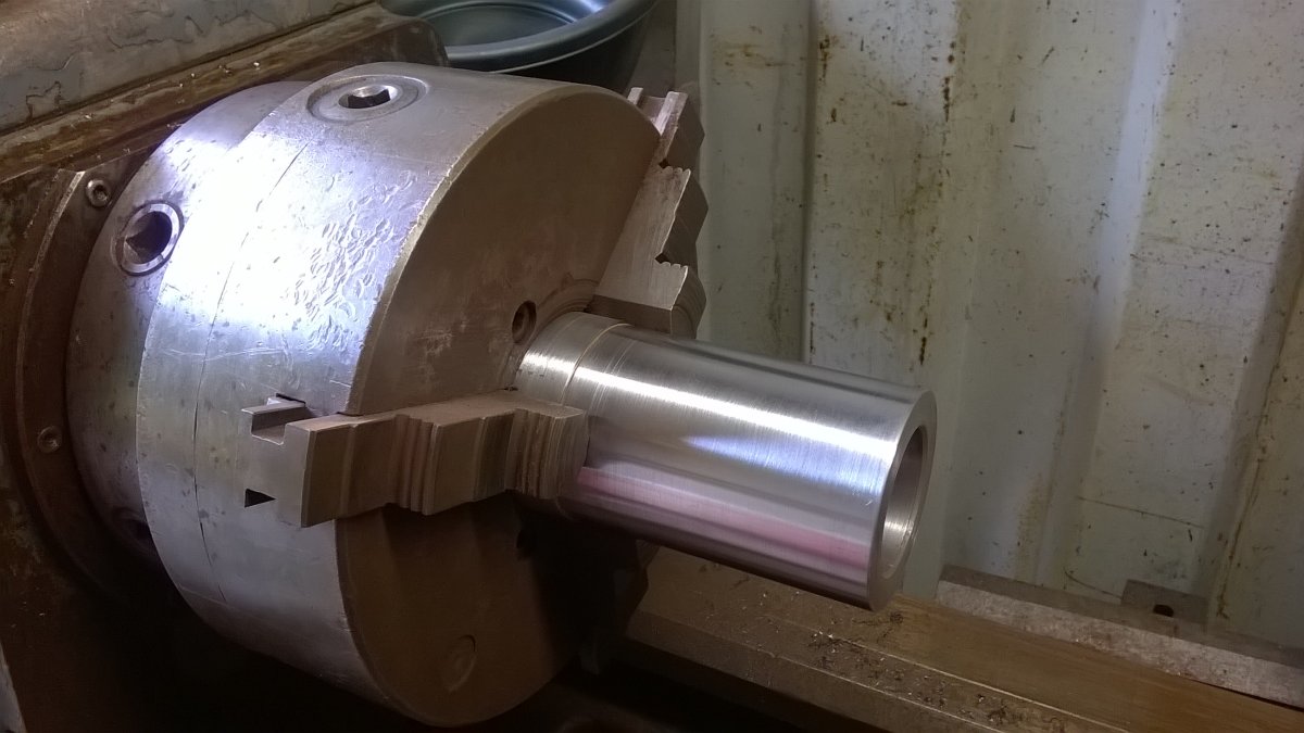

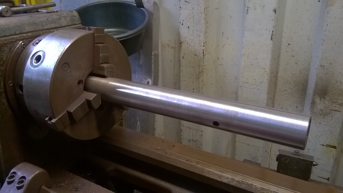

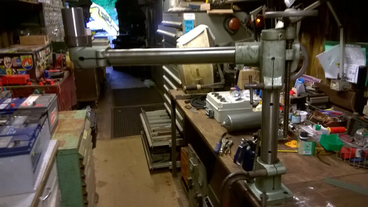

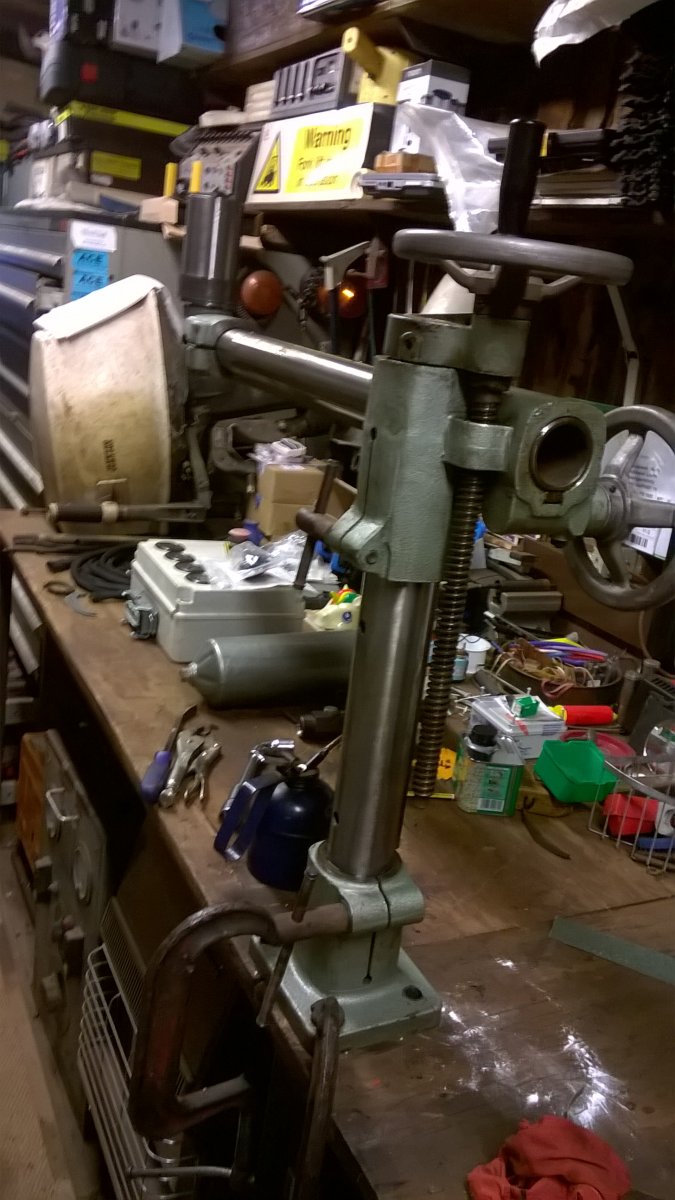

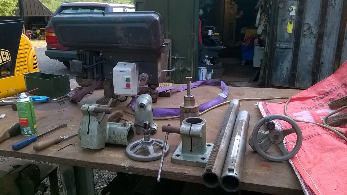

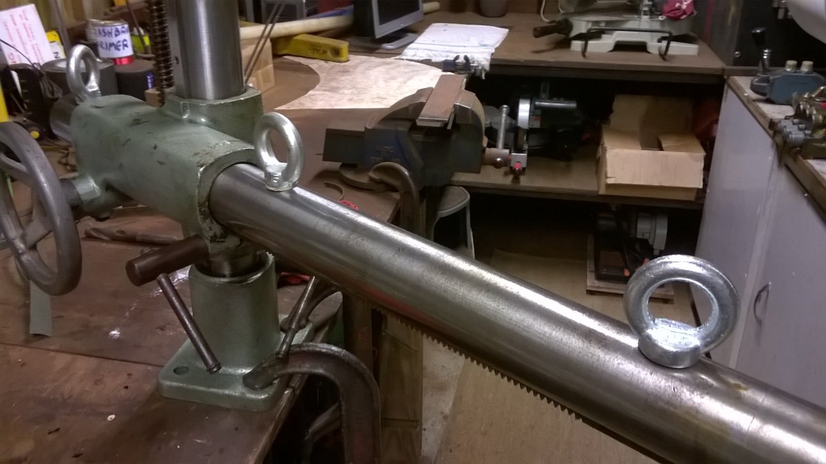

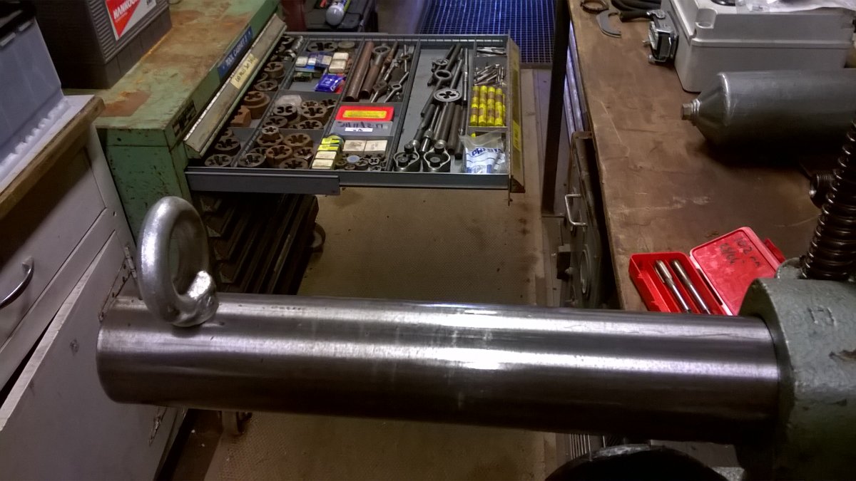

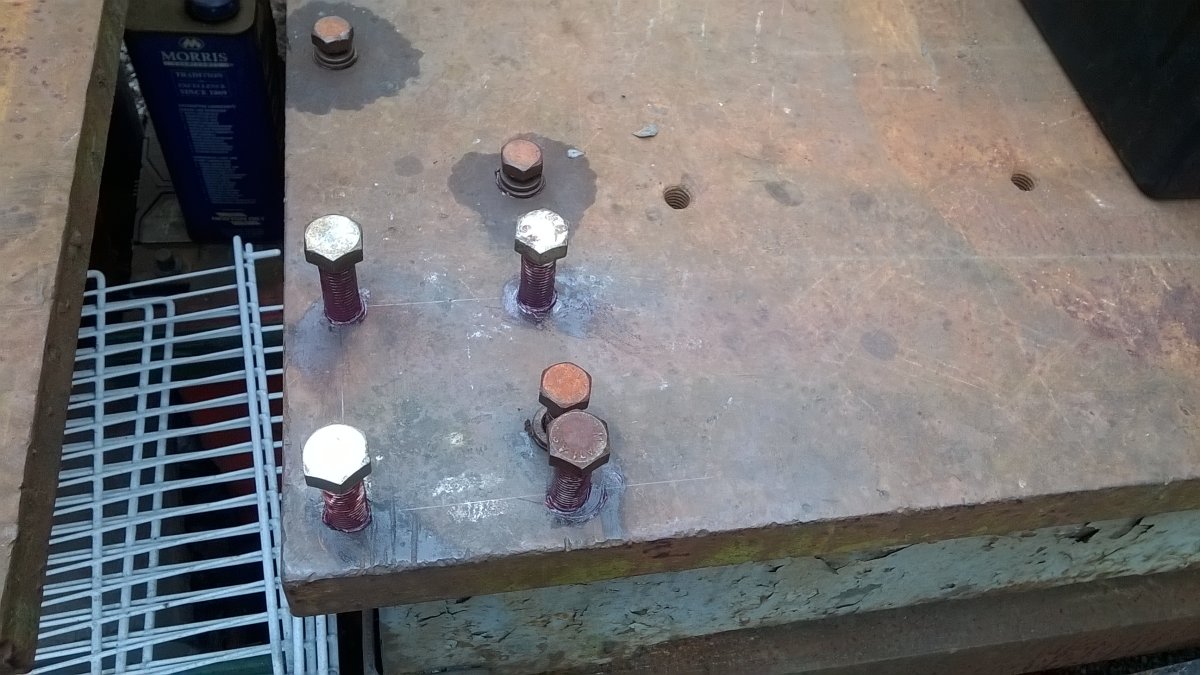

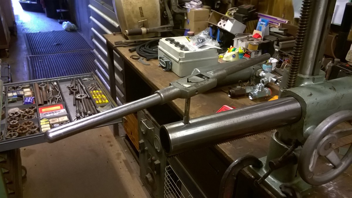

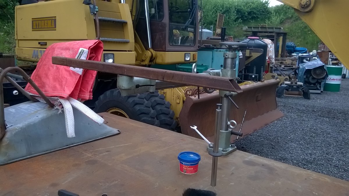

and knocked this up with a bit of 88.9 x 5 CHS ... just right dimensions for the job

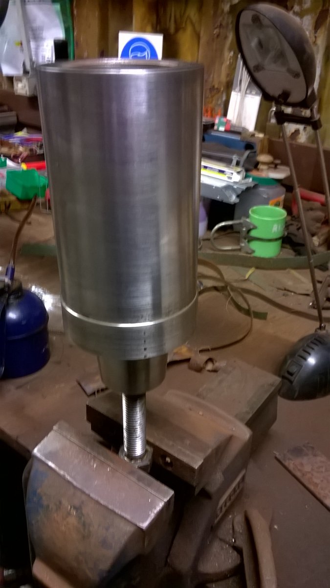

then polished up the drill head's spigot ...
the collar slips over the larger dia. step

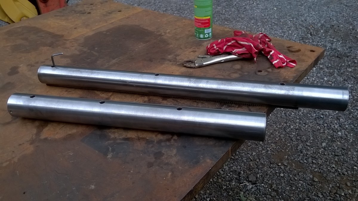

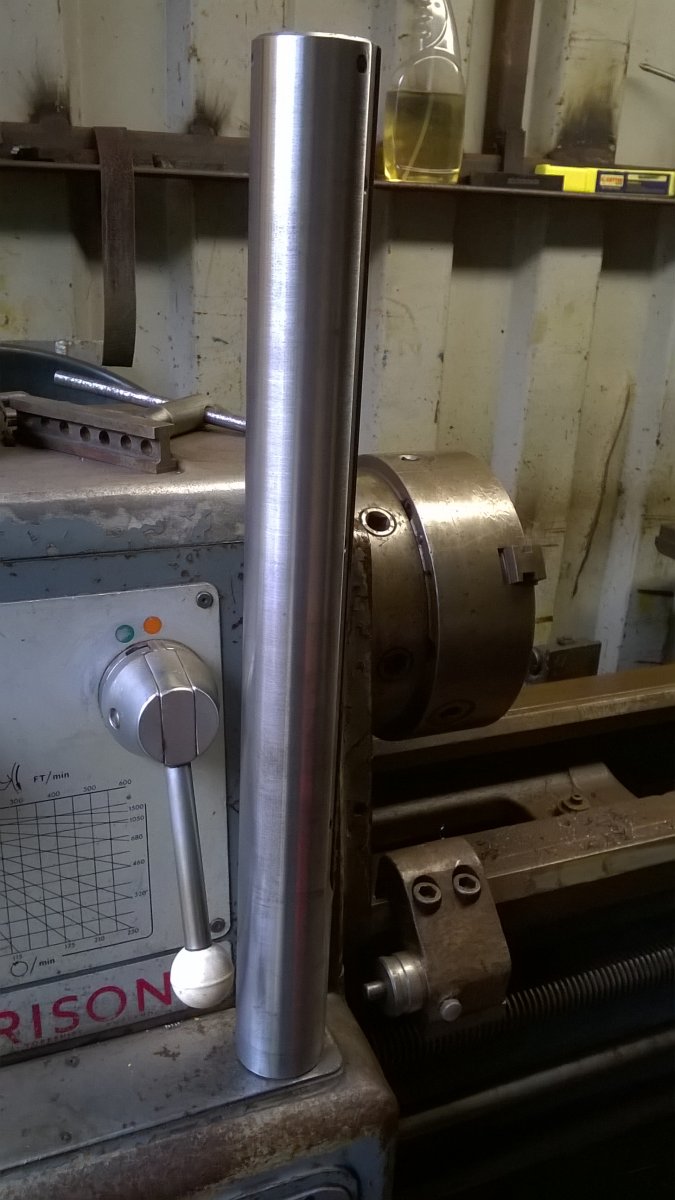

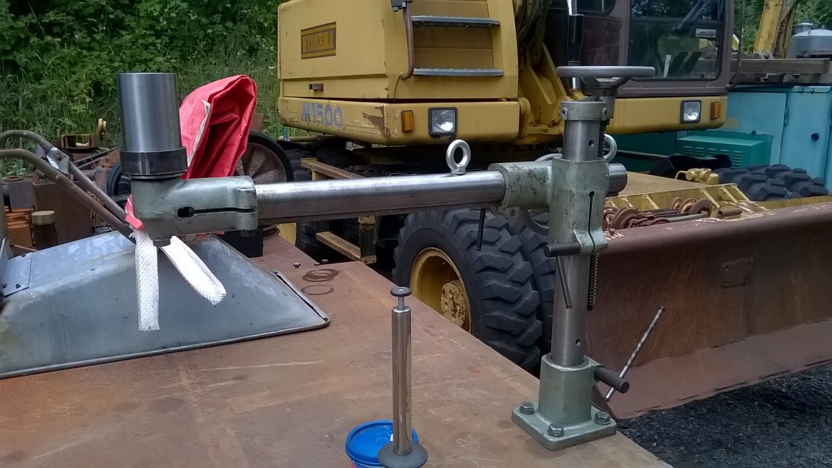

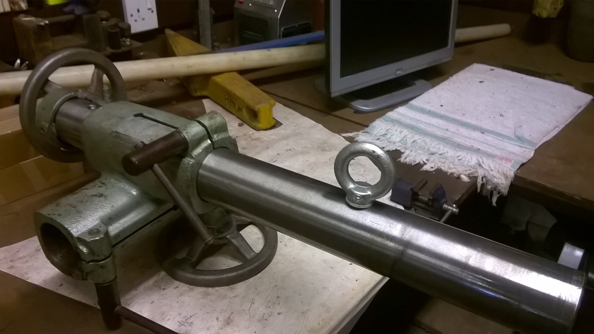

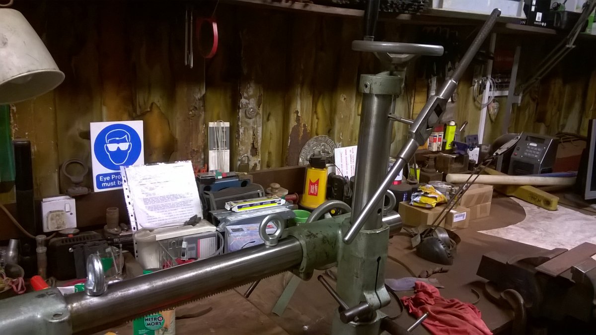

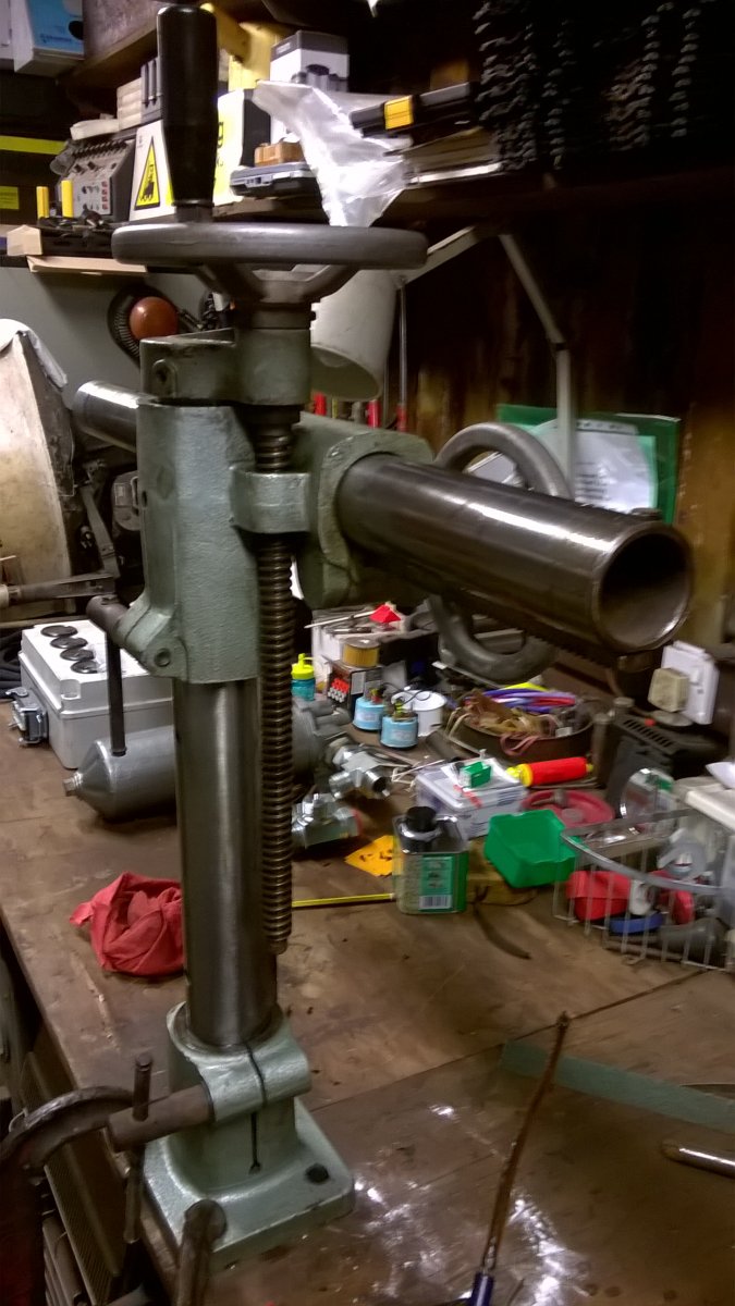

whipped the slider guide off the upright and introduced that to the Harrison and some emery
followed by the horizontal arm after I'd whipped the rack off it
both cleaned up well (y):giggle: and bolted the slider guide and rack back into their respective positions
at this point, the threatened rain decided to materialise - in spades ....... I had just gotten the last of my gear back into a box as the heavens opened :oops:o_O and it had another one of those biblical down pours for 45 minutes
so re-assembly took place indoors
clamped up, this is way more rigid than I'd imagined it would be ... should make for a very versatile weapon :):cool: it's certainly very nicely made .. still not convinced it's an OE set up though and can't find anything like it on Ajax's site or the machine tool archive :unsure:

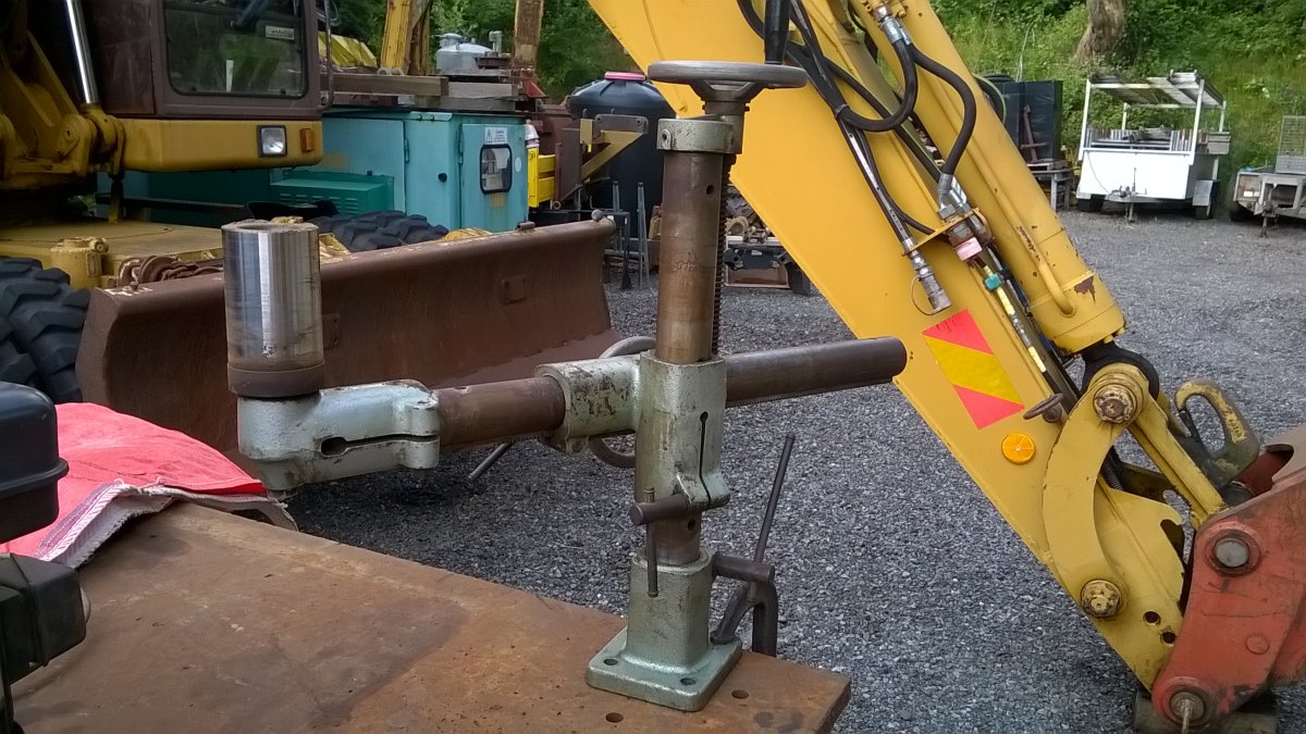

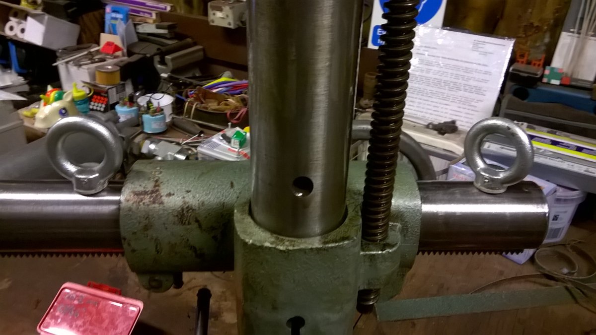

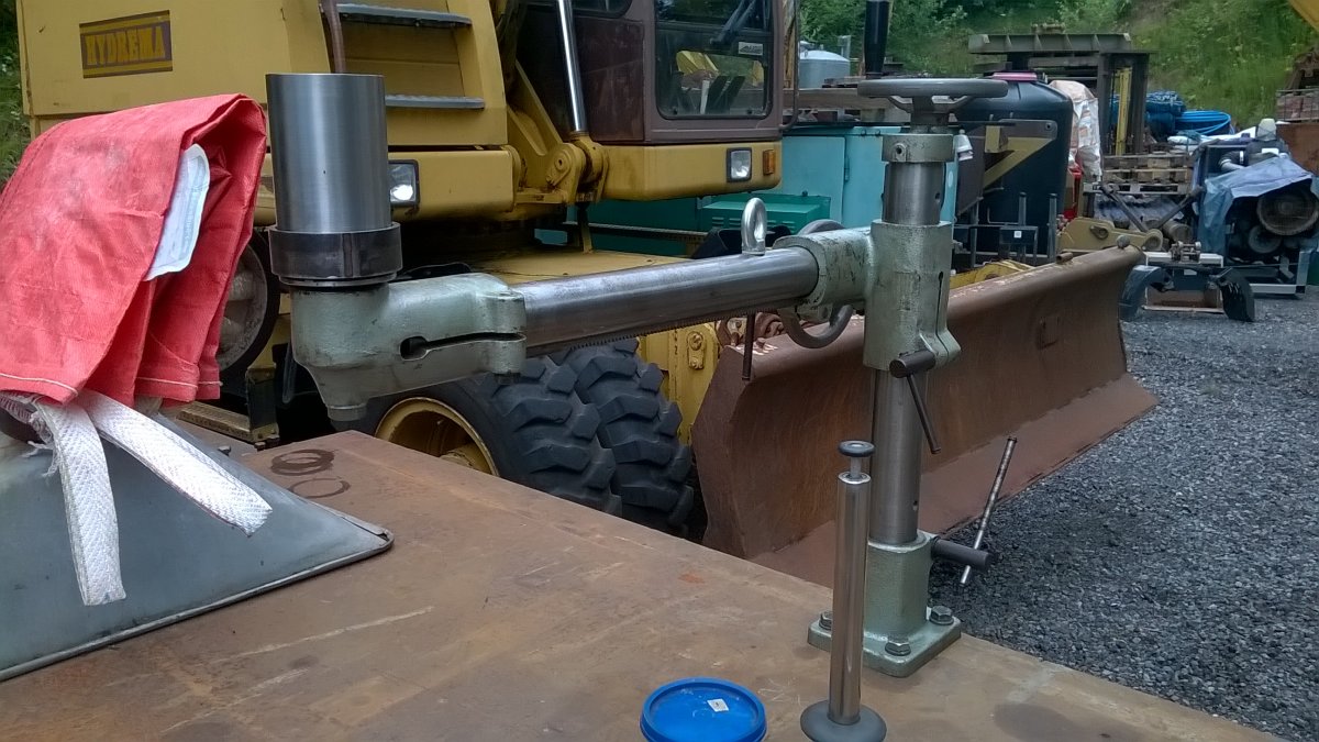

View attachment 48677 followed by the horizontal arm after I'd whipped the rack off it View attachment 48676
View attachment 48674View attachment 48673 View attachment 48684View attachment 48683
View attachment 48682View attachment 48681

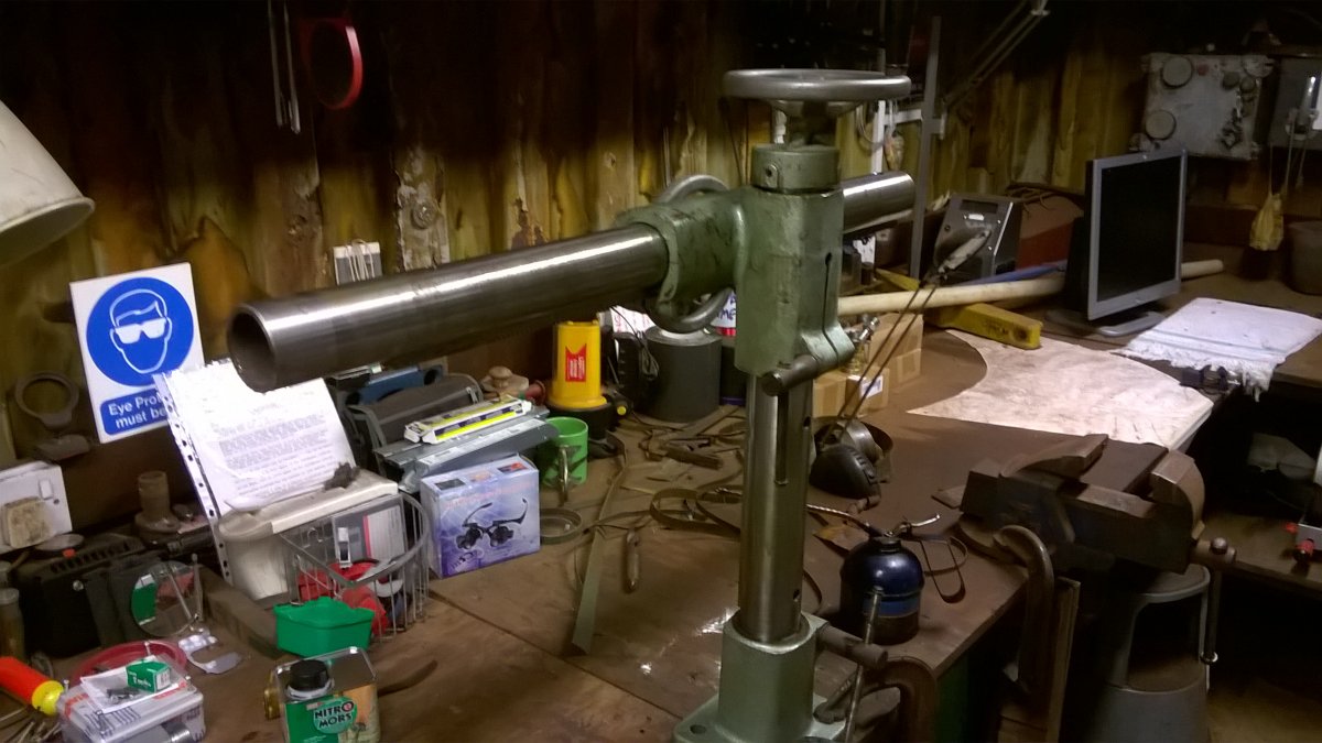

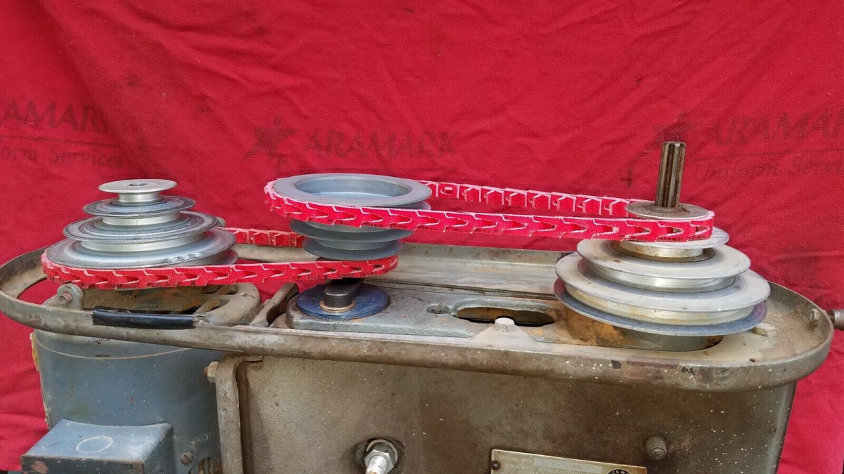

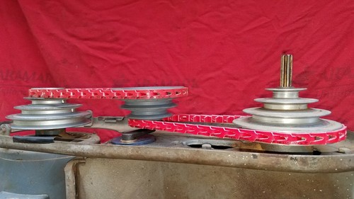

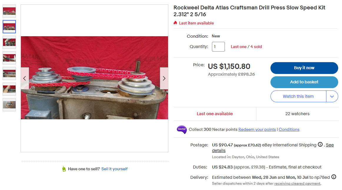

tripped over this on Ebay last night ... what a clever idea for increasing speed ranges on a drill head
bloody expensive kit though :oops::oops:
only issue I can see is you have to be able to invert the pulley on either the motor or quill/spindle, which isn't always possible as a lot of stepped pullies are 'hollow' . :(

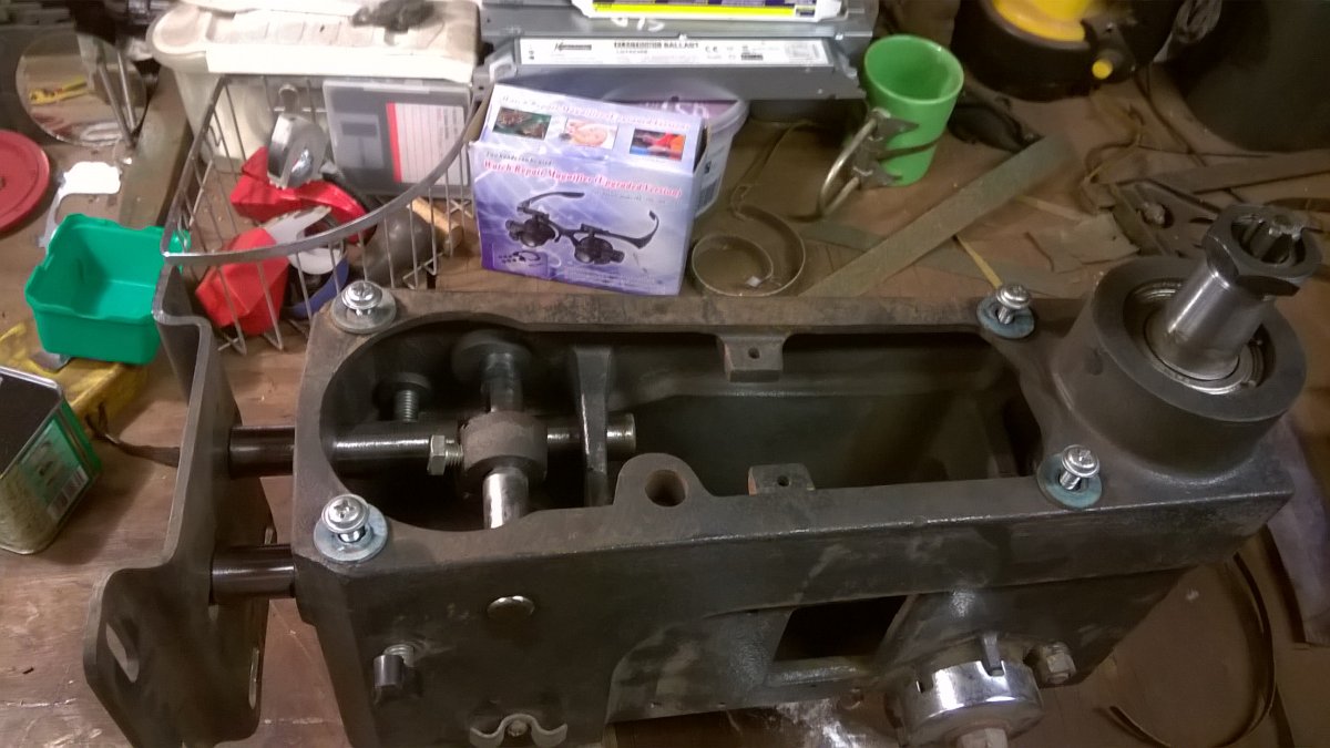

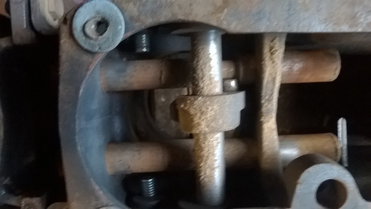

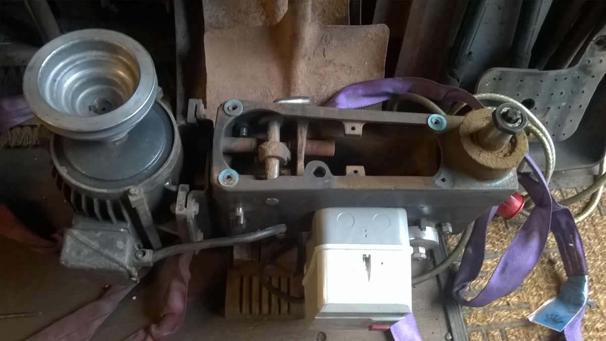

had the top off the Ajax this evening (a) for a shufty as to the feasibility of doing summat like the above and (b) was looking to see if it was possible to fit a lift eye to it somehow and damn me there's a boss in the body casting, that I'd assume would be to take a jockey carrier for a set up similar to the ad. above?
however ......

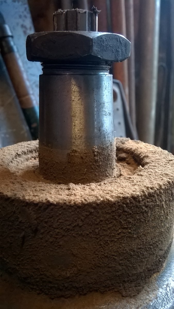

neither pulley looks to be reversible -- the quill is fitted via a taper fit (very unusual) and the motor's pulley is VERY hollow :( .... the boss however could be utilised for a lift eye, although this head isn't more than 25kgs max. - just awkward with the belt cover in place ....
taper quill drive with LH nut holding it in place .......... and a lot of dust
motor / belt tensioner set up - novel design with a sort of cam arrangement - quite nifty
note the boss cast into the body
one very hollow motor pulley and the entire set up ..... the boss is a machined bore
as mentioned before ... everything's covered in wood dust... bit late to run the compressor tonight - kids tomorrow, so a Wed.s job to get it cleaned out ... the motor carrier plate has two positions and the spindle has another inch below the pulley bottom so might 'adjust' the set up a bit, to get the bottom of the motor up a bit, as looking at it tonight, now I've gotten inside it, the lift collar I made is not going to achieve what I wanted to, as the column casting isn't the usual solid item, but two separate rings, so the column length is critical :(
AND that push button box needs to be elsewhere ... nothing insurmountable though

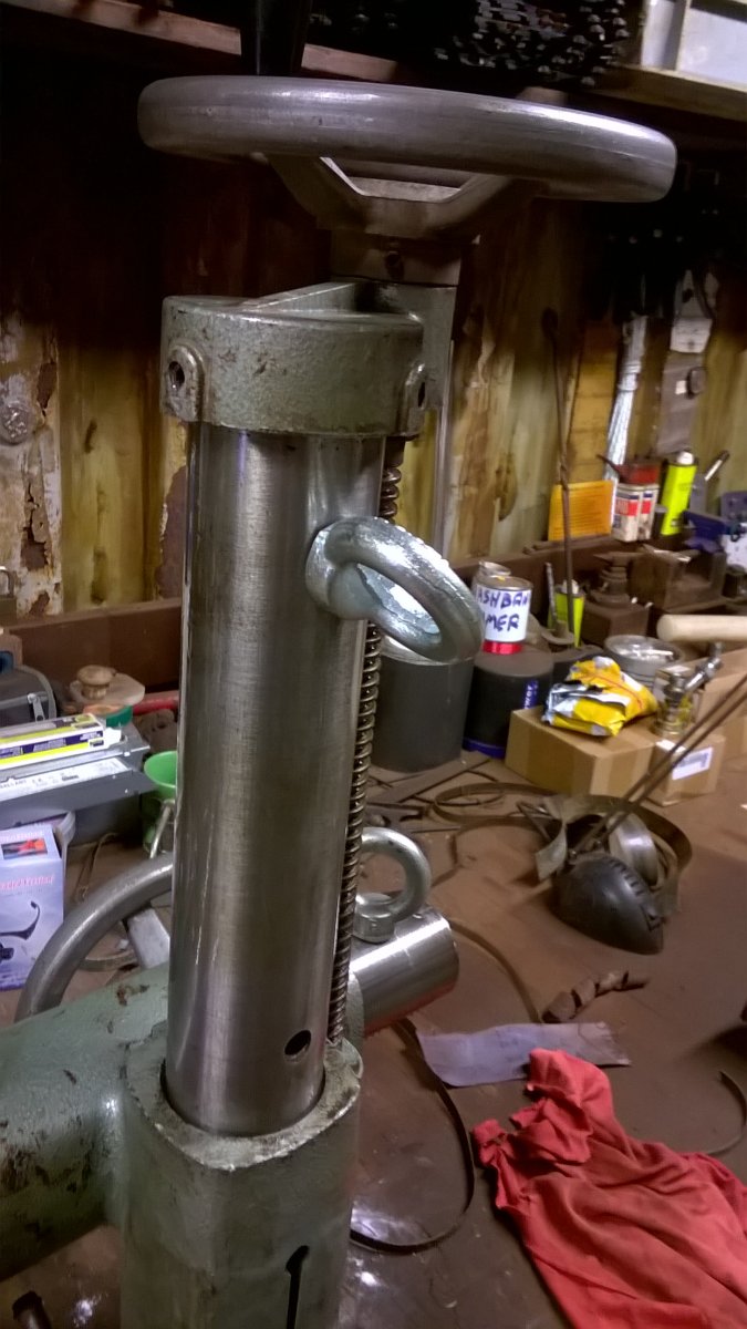

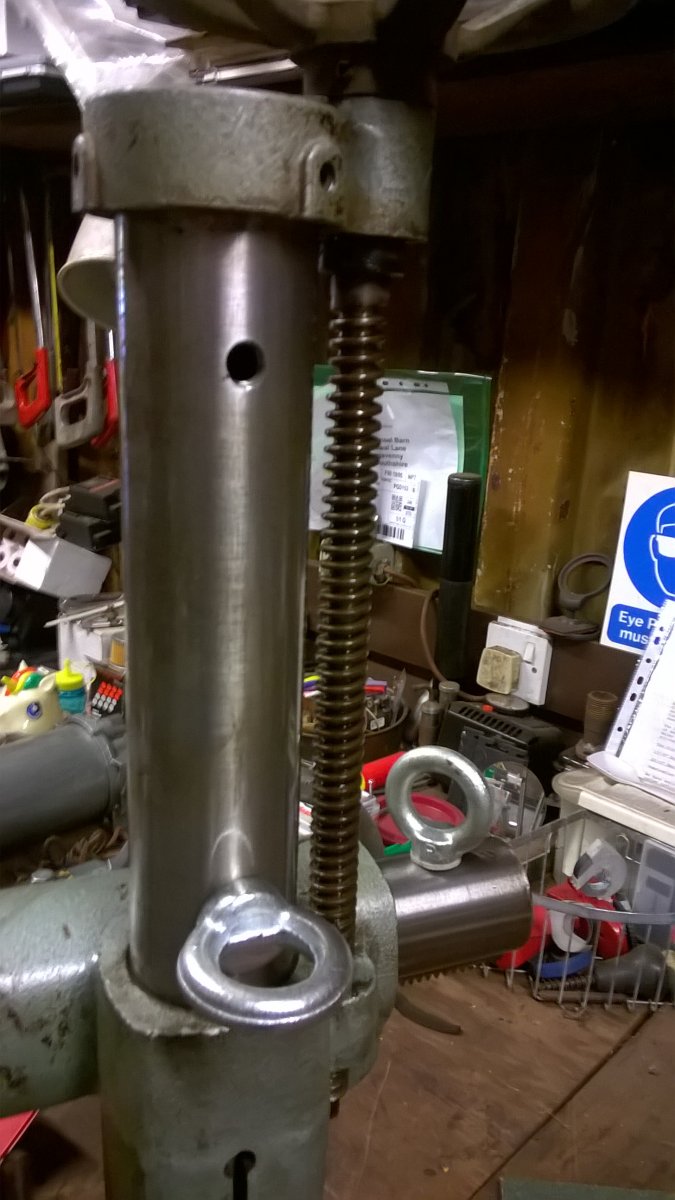

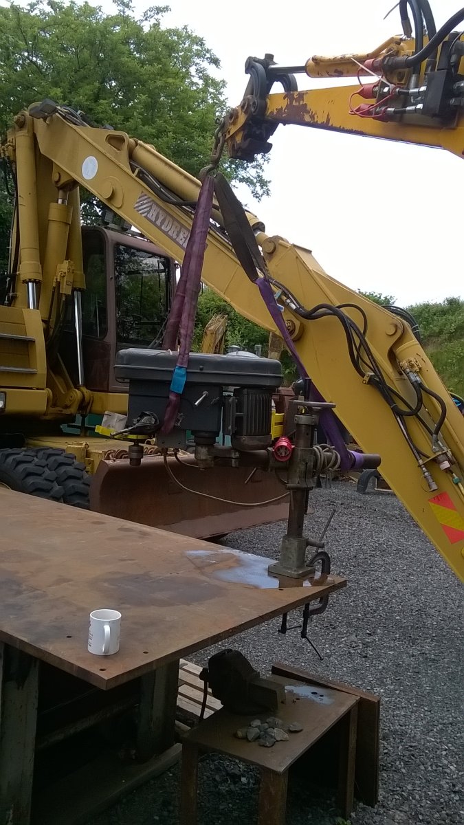

earlier in the day I'd utilised the access holes for the SHCS,s that hold the rack and guide bar in position and which just happened to be a perfect 10.3mm hole ... for an M12 tap .. tapped them all whilst access was easy and for 'ron ;) .. in case
can never have enough lift points for summat chunky/awkward

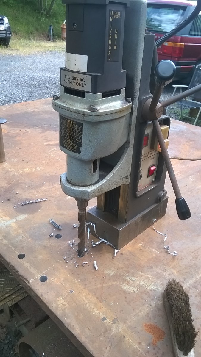

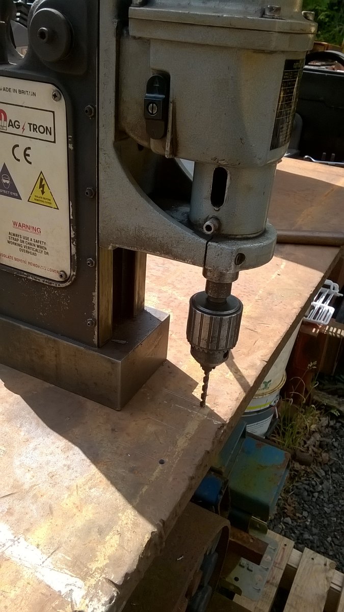

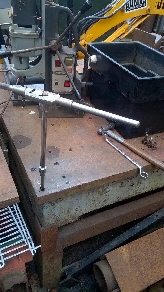

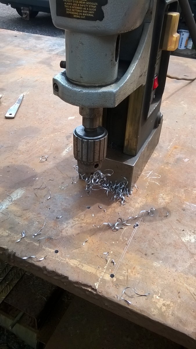

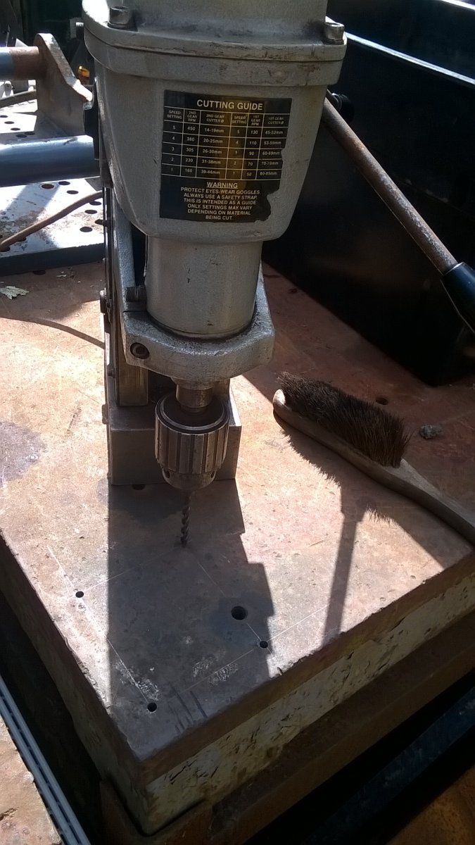

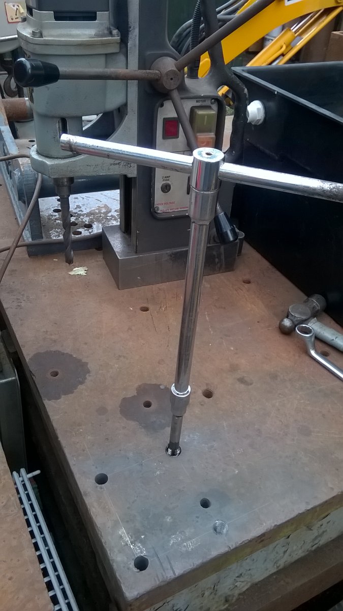

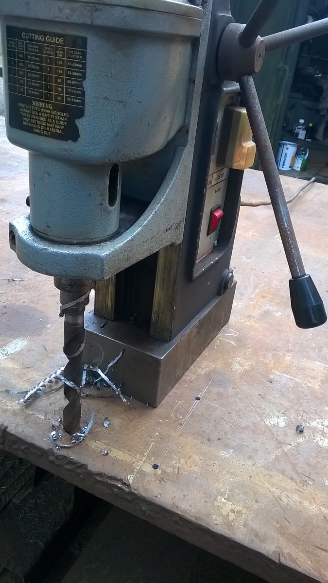

then it was mag drill time .....
and I'm out of pix......
and i just accidentally deleted this post ... so here it is again :mad: ...... when the files load :(
I'd set this out one evening and as it was nice and sunny, had some time getting it drilled
and gave the base a trial fit .. (y)
then turned my attention to the other bench ...
that one hole drifted slightly and was hard as hell .. discovered after that it'd been repaired with 299,s BTLs .. hence being so bloody hard :mad:
this un' had to be tapped
the tee bar was hard work so a bit of 12mm off cut and could use the tap wrench

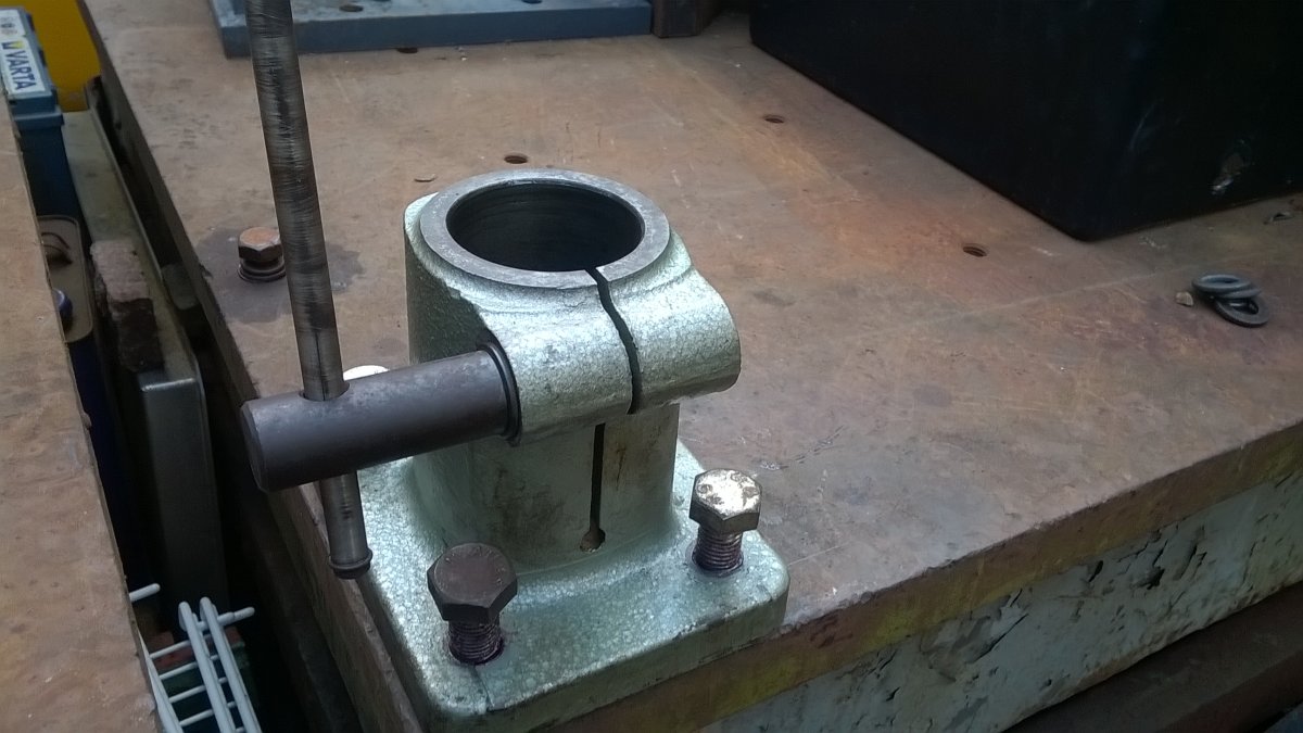

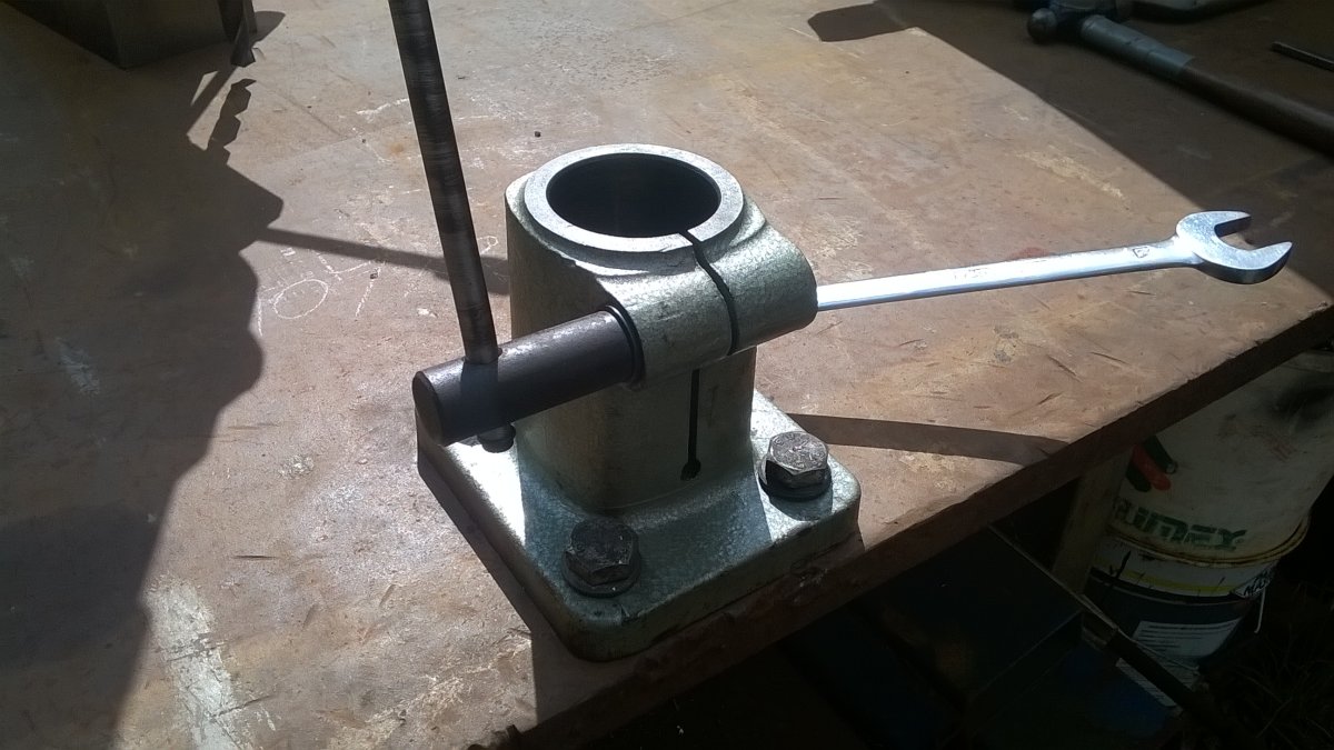

with the base secured I assembled the various bits and set up the spigot holder for upright ... parallel to the bench = upright :)
and fitted the spigot
this is quite handle-able in component parts and 'knocks down' fairly easily .. but the eyes are there if I ever want to lump it about built up ;)
having stripped it i gave the base a try on t'other bench .. looked fine
that one drifter was a PITA so opened up the base's holes a mil and that sorted the issue (y)

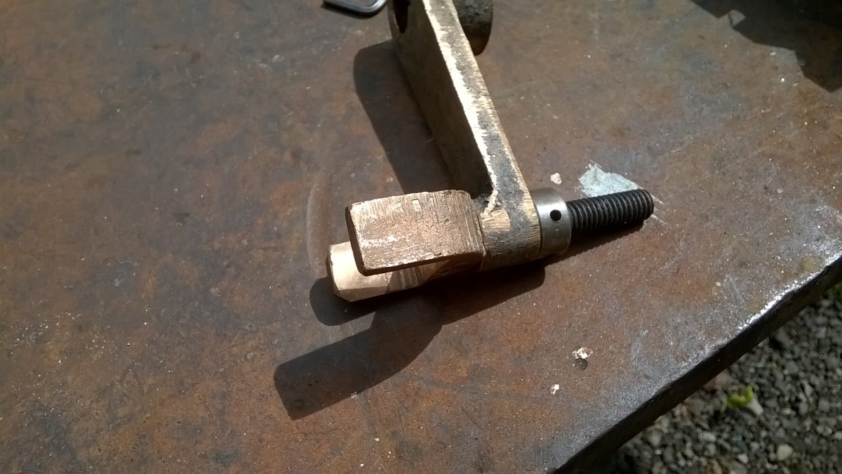

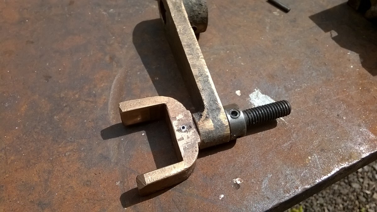

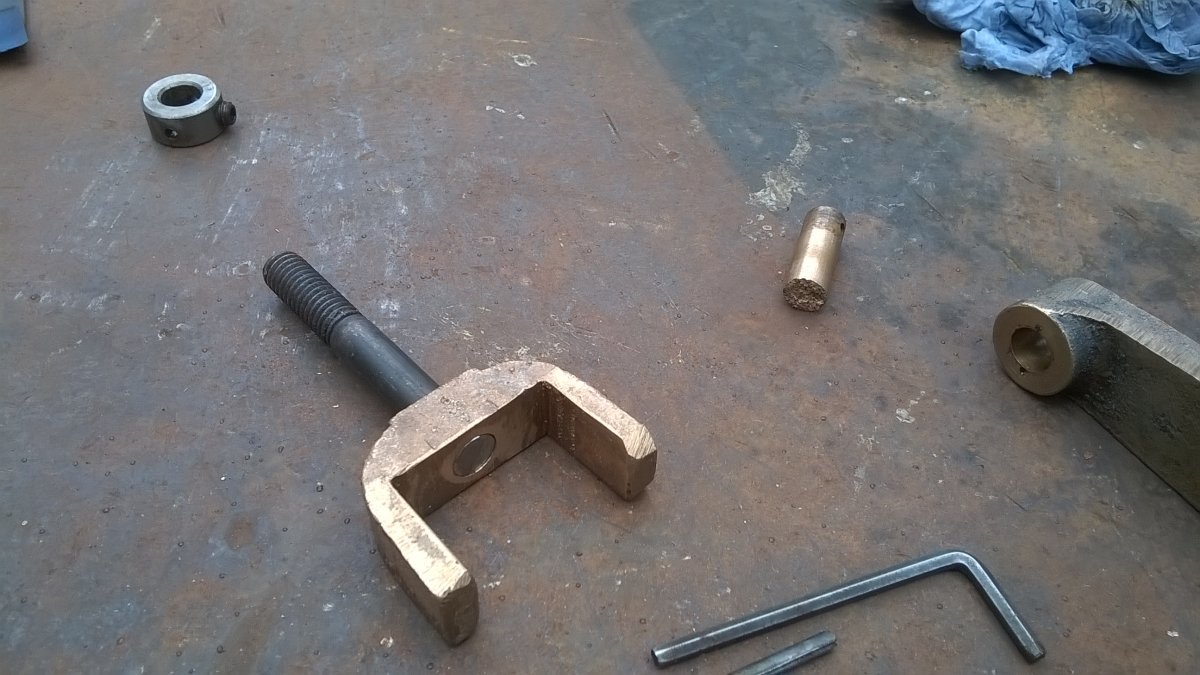

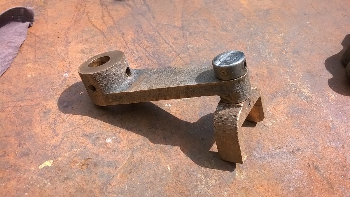

Simon on the dog an' bone first thing this morning .... HELP .. some ham fisted tw*t'd knackered the gear selector on a crucial machine yesterday afternoon - he'd got it out .. could he come over
nice little Phosphour bronze cast fork ... missing its spigot pin .. any ideas :rolleyes: .. 3/8" pin ... luckily I had some 3/8" UNC bolts, with the right amount of shank on 'em :giggle:
cleaned the remnants of the spigot off so I could see where to centre pop the hole and got out my best set of drills - the boxed fraction set - and put a 3/8" hole in the yoke .. bolt was a lovely fit and put a roll pin in to hold it in place
original collar back on t'other end and drilled that for its roll pin
'fore trimming the bolt off to length
miracles performed while you wait .... the impossible takes a little longer .. .... one happy camper :giggle: and he was away to put the box back together and wrestle it back into the machine :LOL:

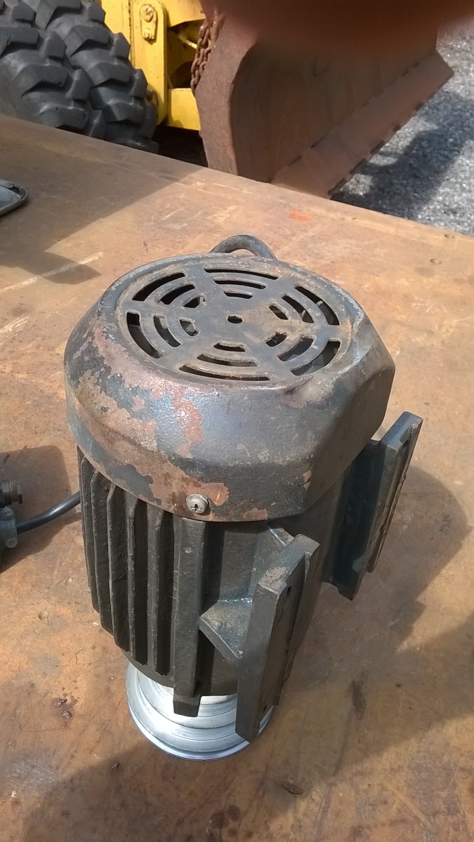

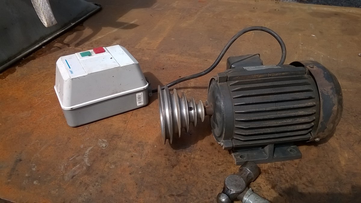

motor on the bench ... for a spot of pulley removal ... which was some task ... slight burr on the spindle and it was gripping in some order ....
fan cover off for a reshape and clean out
... couple of the dents'd have to stay ... just wasn't worth the extended grief to get them out. ... then reassemble .. didn't take a lot of pix today, but you'll get the jist ... screws look a bit odd below, as had to avoid the rail mount in the box for the switch gear's contactor and I can assure you that although it doesn't look it there .. it's all square and true
had to keep it out a bit to be able to get at the motor mount's tensioner bolt lock .. but it's up and out the way there .. was going to put a surface mounted inlet plug on the back of the box, to simply connect a flying socket to .. no trailing leads then .. 'til I realised I'd only got 32Amp versions, so'll have to wait 'til I pick up a 16A one ... see if I can get one in town tomorrow .. very few on Ebay .. all expensive and Chinese, with three weeks delivery :oops::oops:
all back together tonight ... need to make a cover plate for the original switch gear aperture, on the side of the body and fit that chassis plug .. and it's .. job did.
nice little Phosphour bronze cast fork ... missing its spigot pin .. any ideas :rolleyes: .. 3/8" pin ... luckily I had some 3/8" UNC bolts, with the right amount of shank on 'em :giggle:View attachment 48833

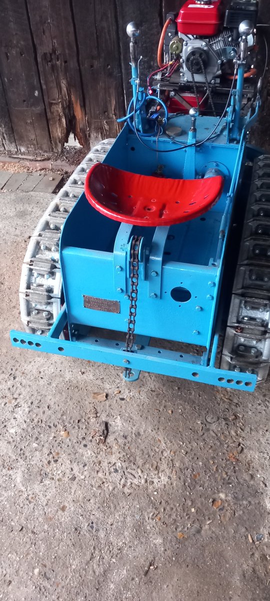

Well it must have been a sign, ended up bringing this home today (combined with a work trip this morning it's been a 600 mile, 16hour day 🥱)
Been converted by a retired guy- proper tinkerer with home made sun following solar panels, wind turbines, battery banks and one of the most skillfully modified, -to make it arthritis friendly!!- series one land rovers I have ever seen, and his recently deceased father in law. Currently running 2 Chineseium 6.5hps, you can run either or both and came with the original engine which is apparently all good apart from the carb which has been repaired now, so could just be put back together. Starts, steers runs etc, I can either keep it as it is, put the original engine back in, or I quite fancy putting a honda gx390 in it.
The modifications are very small, basically a few extra holes.
It's one of the loudest, most frightening things I've ever driven at 2mph 😆
After about 30 seconds though I had a handle on it, turns very nicely. I love how solidly and simply built it all is.
I paid a grand total of £700 for it, I was feeling slightly guilty about knocking him nearly in half on the price, but he told me several times he was genuinely pleased it had been bought by someone who was enthusiastic about it. Great guy with some interesting stories and toys, was there over an hour!
Sorry for the thread hijack but thought the machine might be of interest to some who follow it! Cheers.
Class🤩 what's the LPG hose with QRs on for?
