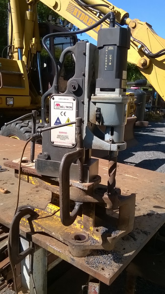

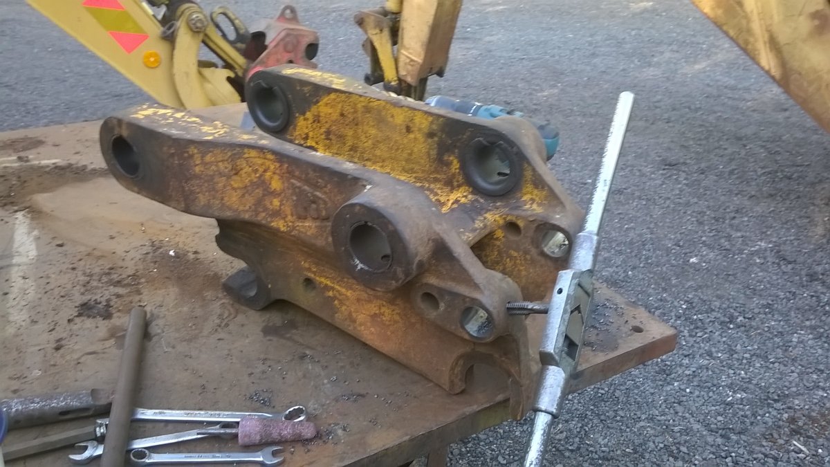

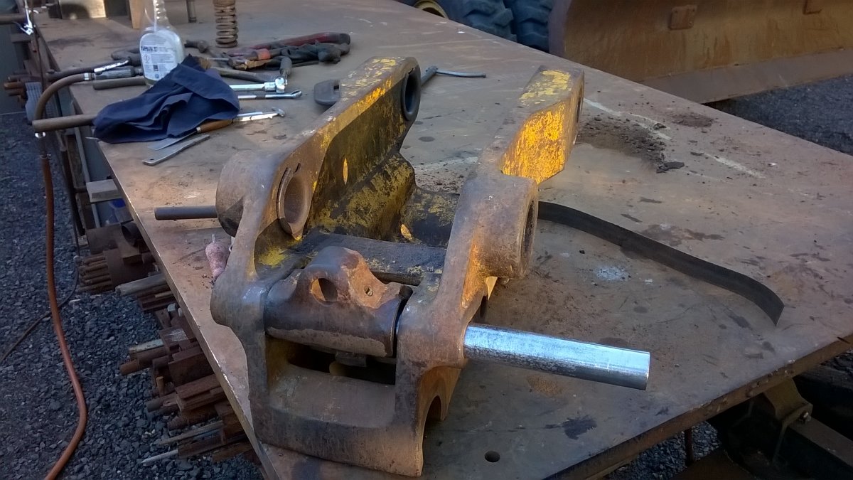

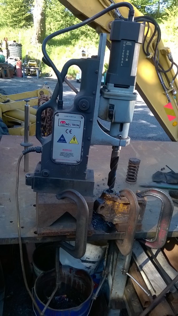

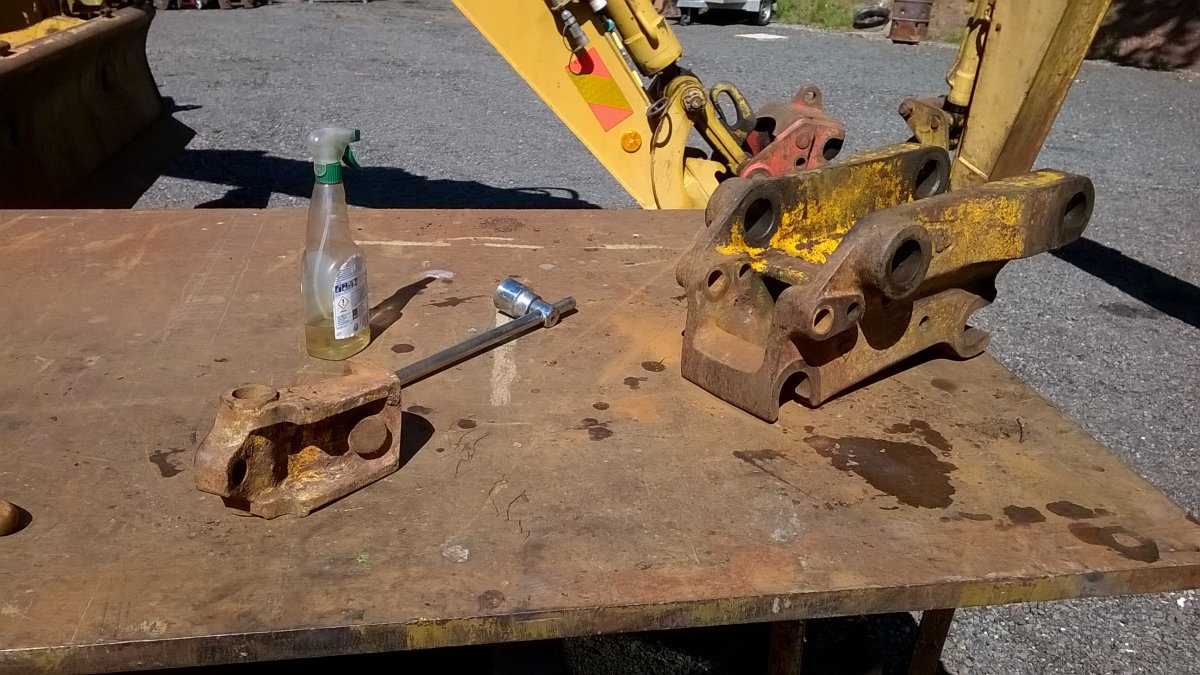

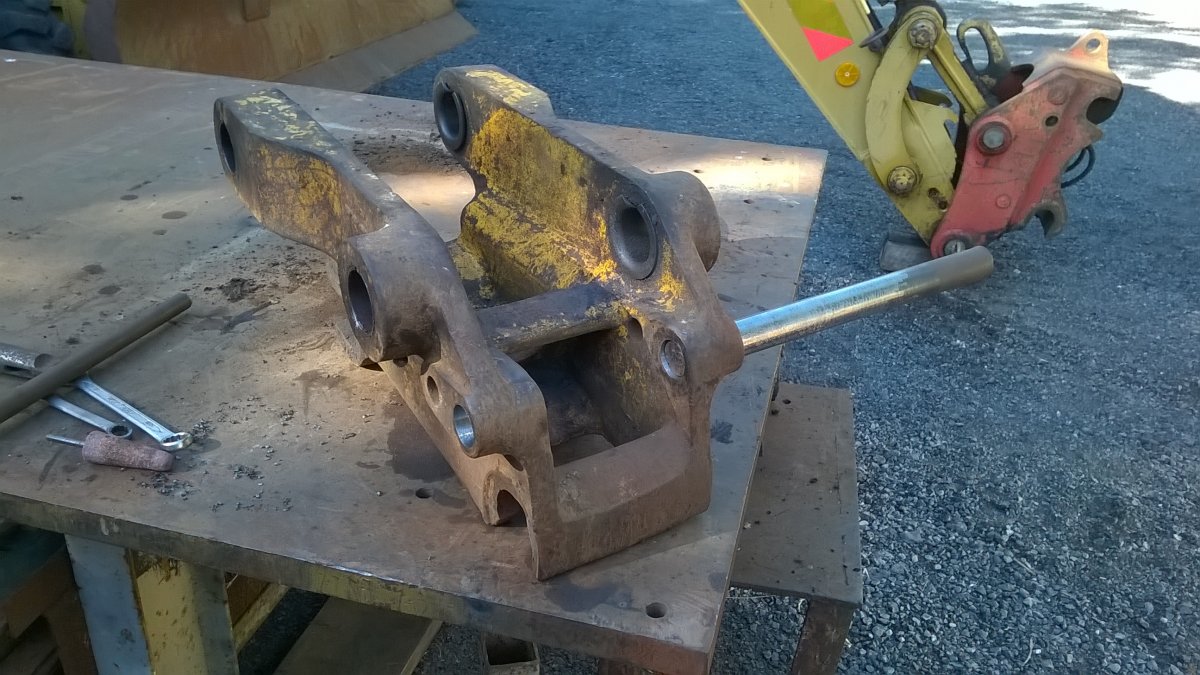

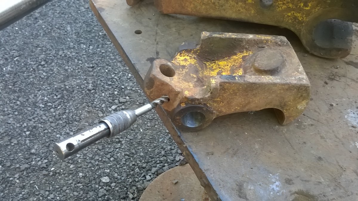

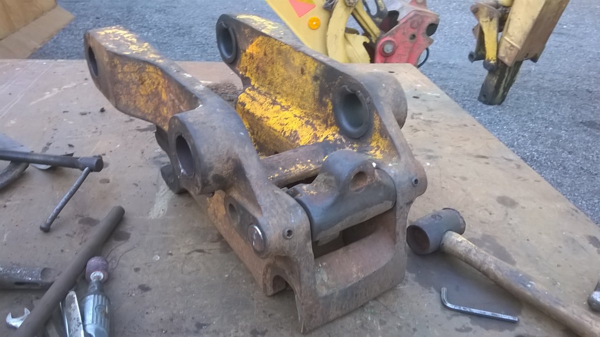

Hitch got dropped on the bench Monday ....
jaw pivot like a d*ck in a barrel ... bolt took some undoing ..... should've done it whilst it was still on the dipper :(
7/8" taen out to 30mm to lose all the issues ....
followed by the jaw clamp ...
went together nicely ....

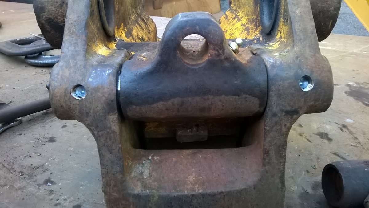

retapped the original nipple bore
and put some keepers into the body
with the pin suitably drilled for some 1/2" gripper tipped grub screws

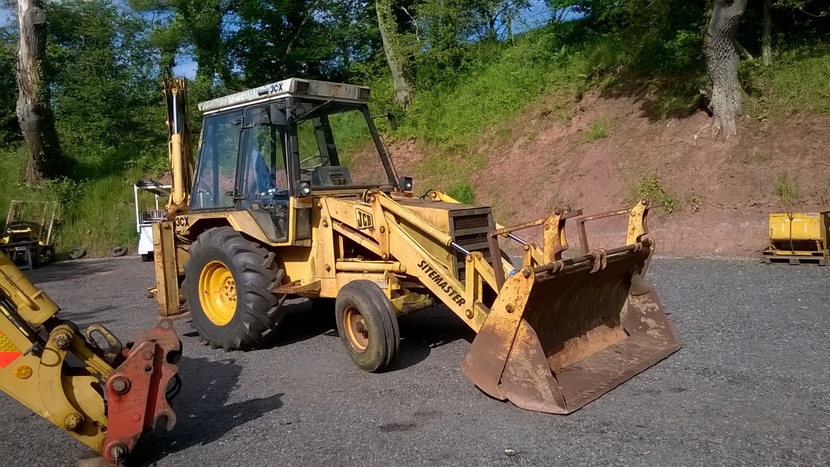

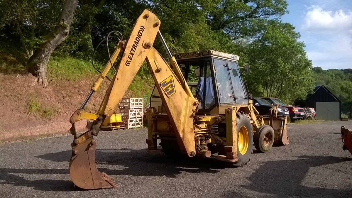

job did - stuck it back on this morning
could do with some new pins and dipper end/link bushes, but holds yon bucket a lot tighter than it did, especially with a 10mm shim in the spring to keep it hard shut

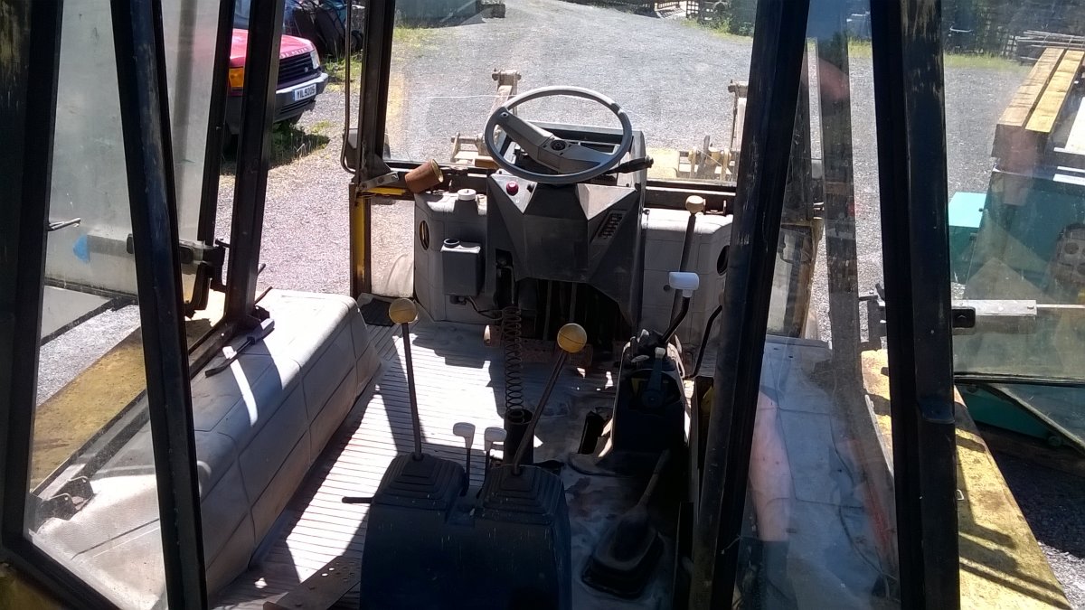

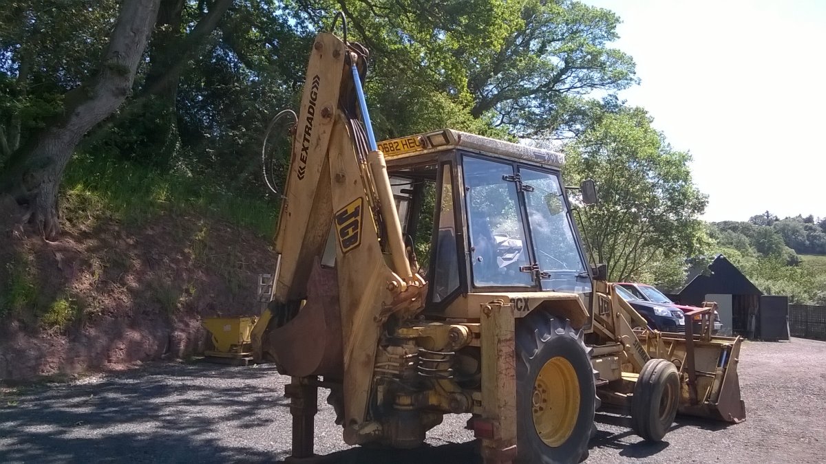

cab got 'mucked out' a couple of days ago ...
everything greased up and hinges WD-ed all round, but the stainless pins make a big difference to their ease of use, even after standing so long

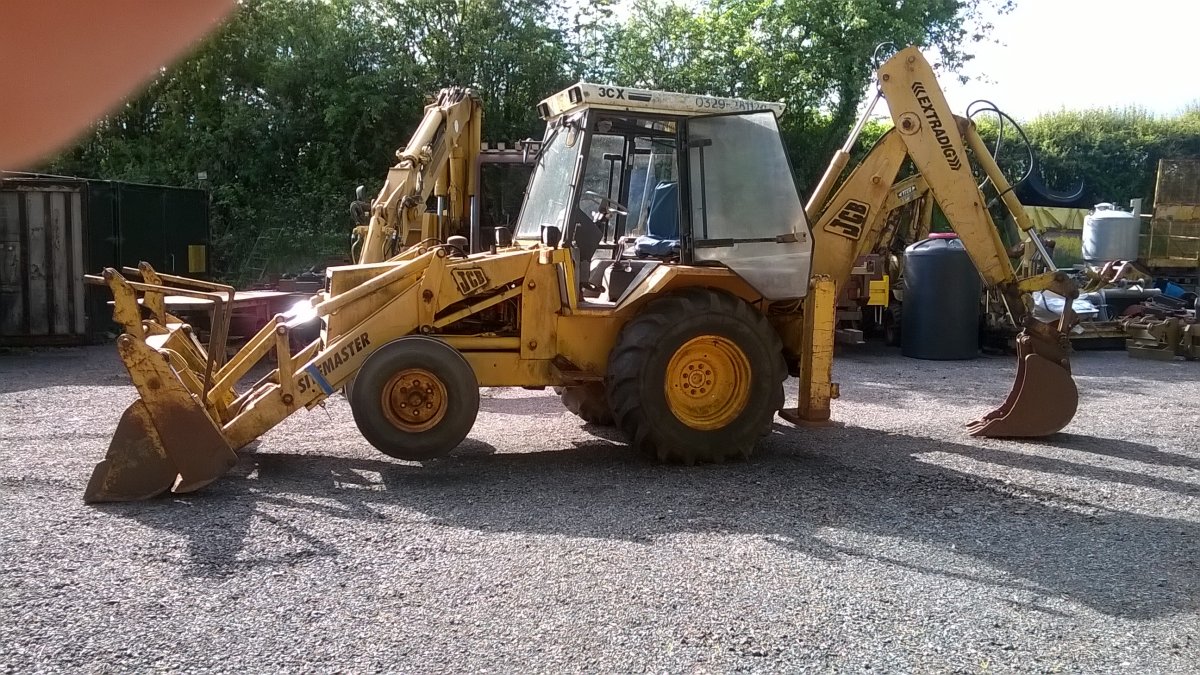

time for a wash ...

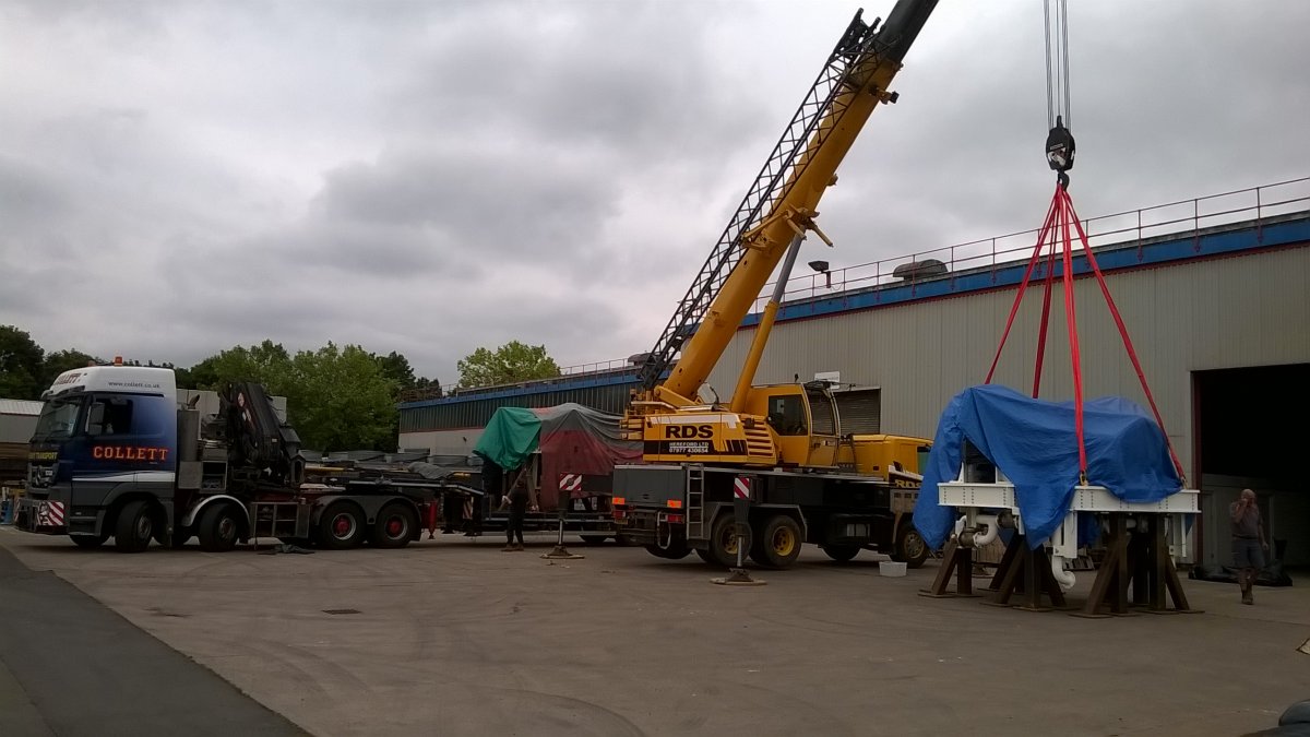

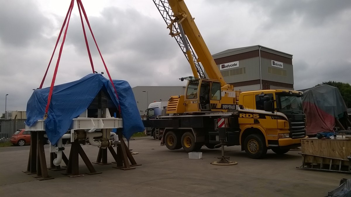

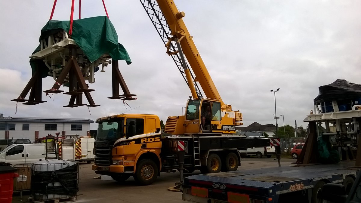

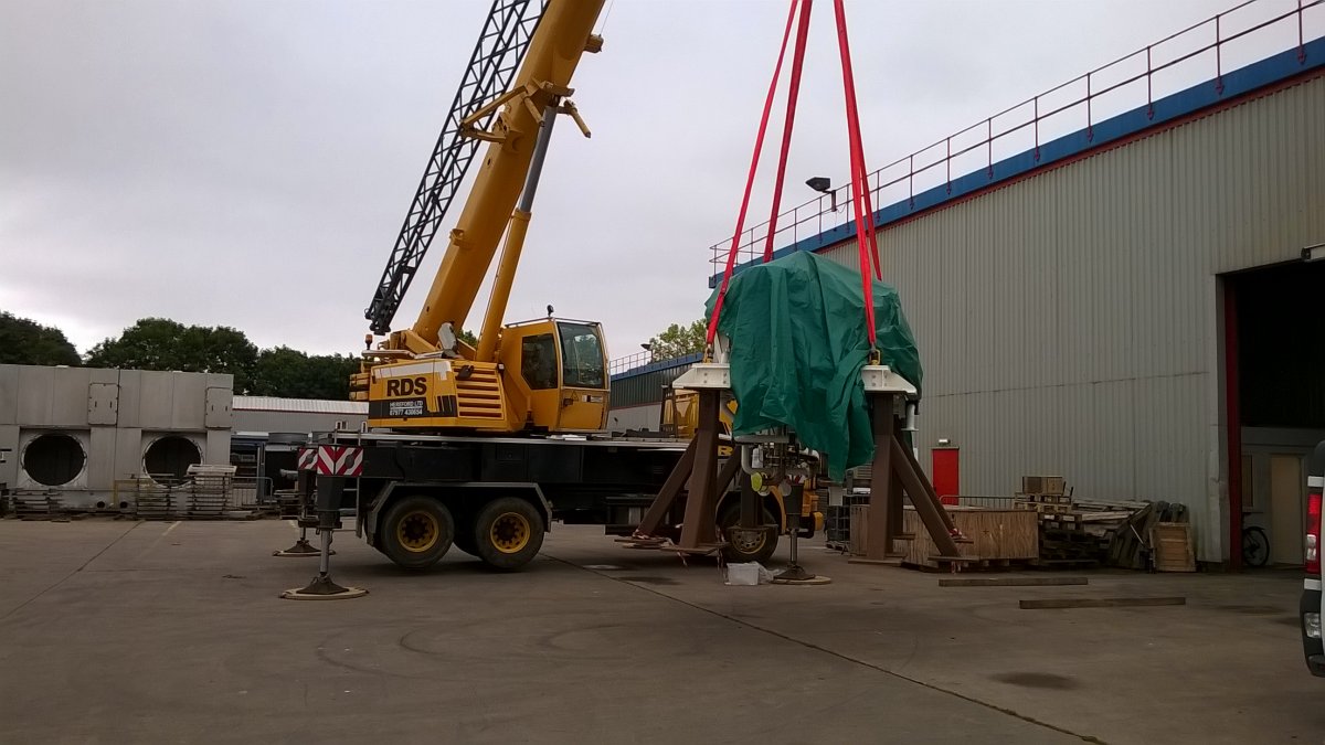

On the road at 7 this morning .... Hereford's half an hour from here ..... hit the traffic queue at Belmont, outskirts of 'the 'Ford at 7.25 ...... rang Russ at 7.55, having travelled about 300 yds, to say i was gonna be late :mad:
first mile into the city is usually bad but unbelievable this morning .... and after three sets of lights it magically cleared and i rolled into Wiggins yard about 8.10, just in time to help Russ drop 7 falls onto the Lieb.
Guys there had got the first lift half out the door and by the time we'd rigged, it was ready for a 'flight'.
swung it round t'other side of the crane to wait for the tranny, booked to arrive at 9.30 .... and just for a change, he was bang on time ...

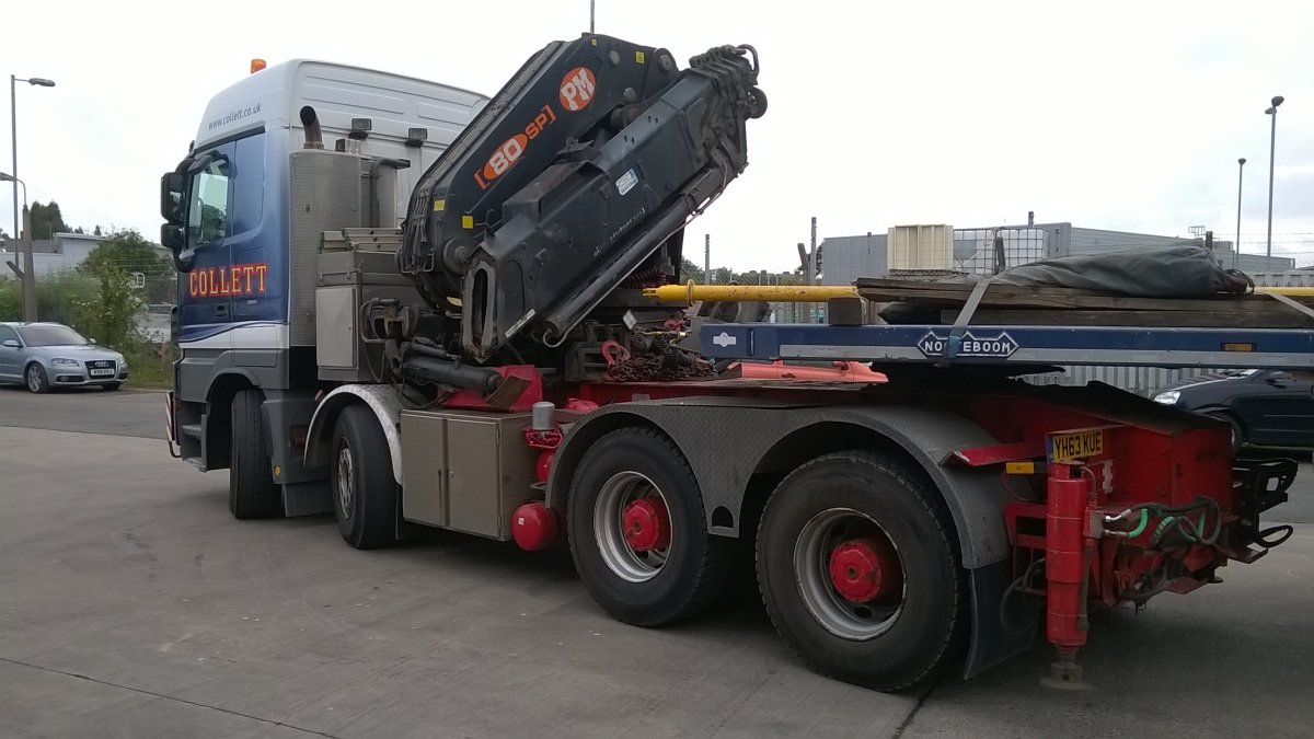

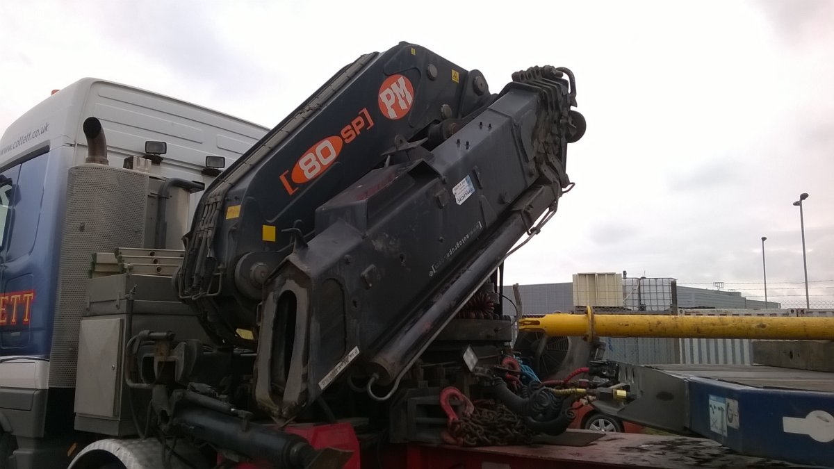

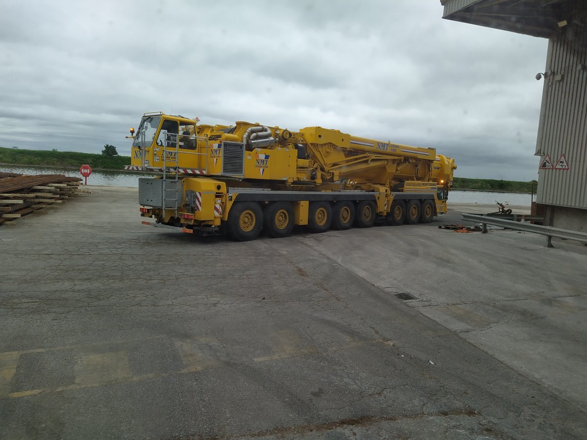

bit of loadercrane porn for @Mogman
80t/m beast ... 25t of prime mover

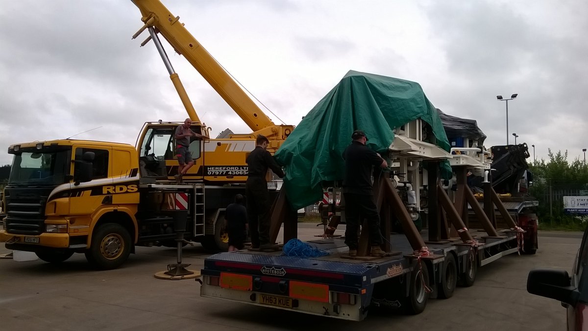

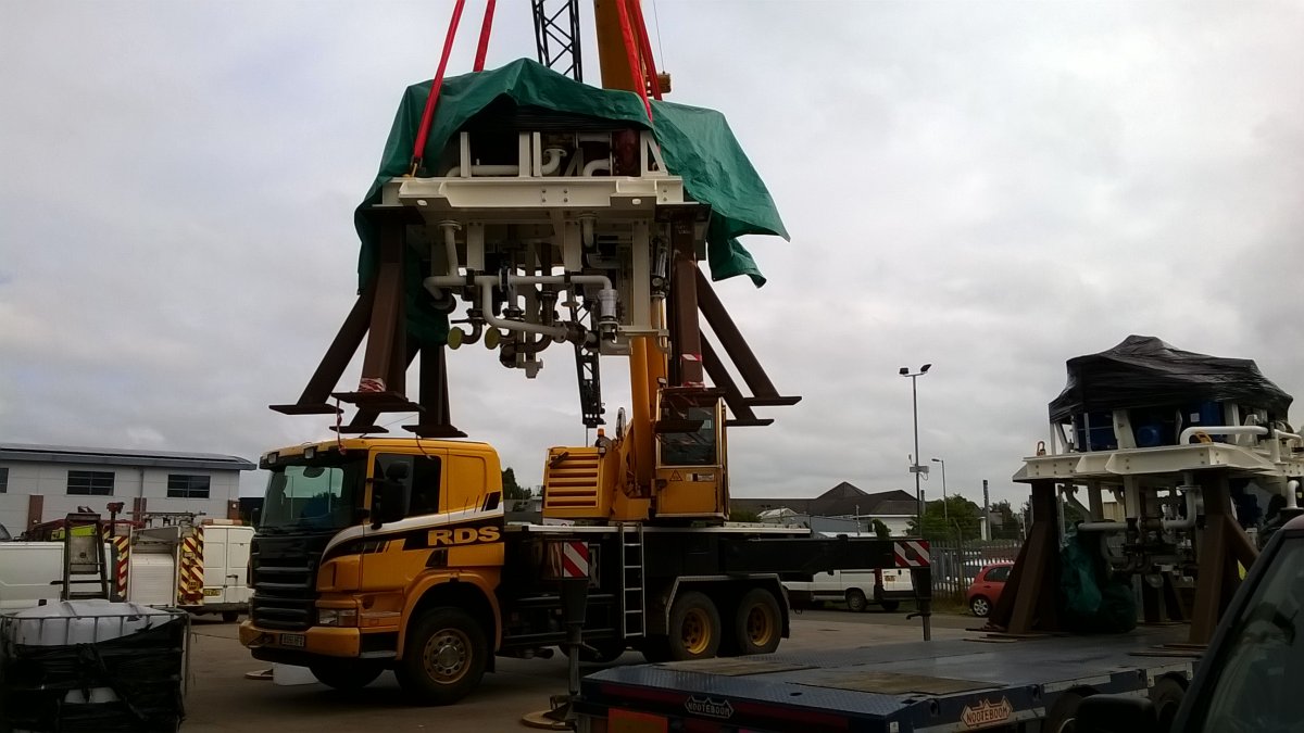

first one on, second one coming round ..... 6.5t each
guys there were pretty keen on keeping the 'giblets' covered
then hooked the tarps over the tops for the driver, whilst the third one came out the door so we could get a hold of it
this un was 14t
on and chained down, 'fore hooking the tarps over the top on the hook, ready for roping down ....... and ........
ready to roll just about. Plod escort booked for 12.30 ...... 12 and 13ft wide respectively:rolleyes:
we were away by 11.30 ..... out into yet more nightmare traffic ..... I got home just before 1.00 :(
seawater heat exchanger/oil cooler units for some big transmission gearboxes on HMS Glasgee . ... off for running up and proving shoreside, 'fore getting installed onboard ship ... the bill for the pipe clamps alone per unit was £52k ..... this sort of thing, but for up to 2", 4", 6" and bigger pipes
monsters :oops:....
would not want to be buying the Phospor bronze valves either :rolleyes: ..... or any of the other very 'spensive looking components:unsure:

Do they not have to wear hats and hivis etc? Seems nicely relaxed 👍
Jimoz
Also how were they bringing them out the door of factory? Gantry crane?
Keeps you busy!
aye ..... belly full of tea last night and I was goooooone :giggle: .... was a busy couple of hours and an early start for me after a very poor night's sleep ... zonked yesterday evening :)
own site and do as they want .... none of the usual bollox ... I was 'togged' in me 'Jaffa' overalls, hi viz vest and bonce protector (for my own good - load was just the right height to crack yer head on) ...
they kept out the way once they'd skated the lifts out to us and I stayed 'visible' for Russ, not as he's any risk to my health ... does exactly as he's asked and i'm in charge on the floor
If they had the big hiab there (I assume for unloading at the destination) then why did they need another crane Graham?
Just about to write this
transport only booked ... just happened to send yon 8 wheeler ... 60t gantries at other end .... Russ has done quite a few of these and wanted me there, to speed things up yesterday ... had other things to do after lunch, rather than having a leisurely day, using their blokes to load with ... they devoted their energies to getting 'em out to us, whilst we 'charged on' getting 'em air borne and onto trailers :giggle:
Skates Jim .... gantry couldn't handle them as a lump ... lift a side at a time onto skates and bowl them out with a 4.5t Nissan FLT ... no real dramas ... everyone mucked in, once we'd got the first one airborne and were waiting on the trucks .... first one on about 9.30 and all on by 10.30 ...
smooth operation ;):giggle: .... Russ likes to have 'knowledgeable help' with him .... speeds everything up, if he has other things to do after

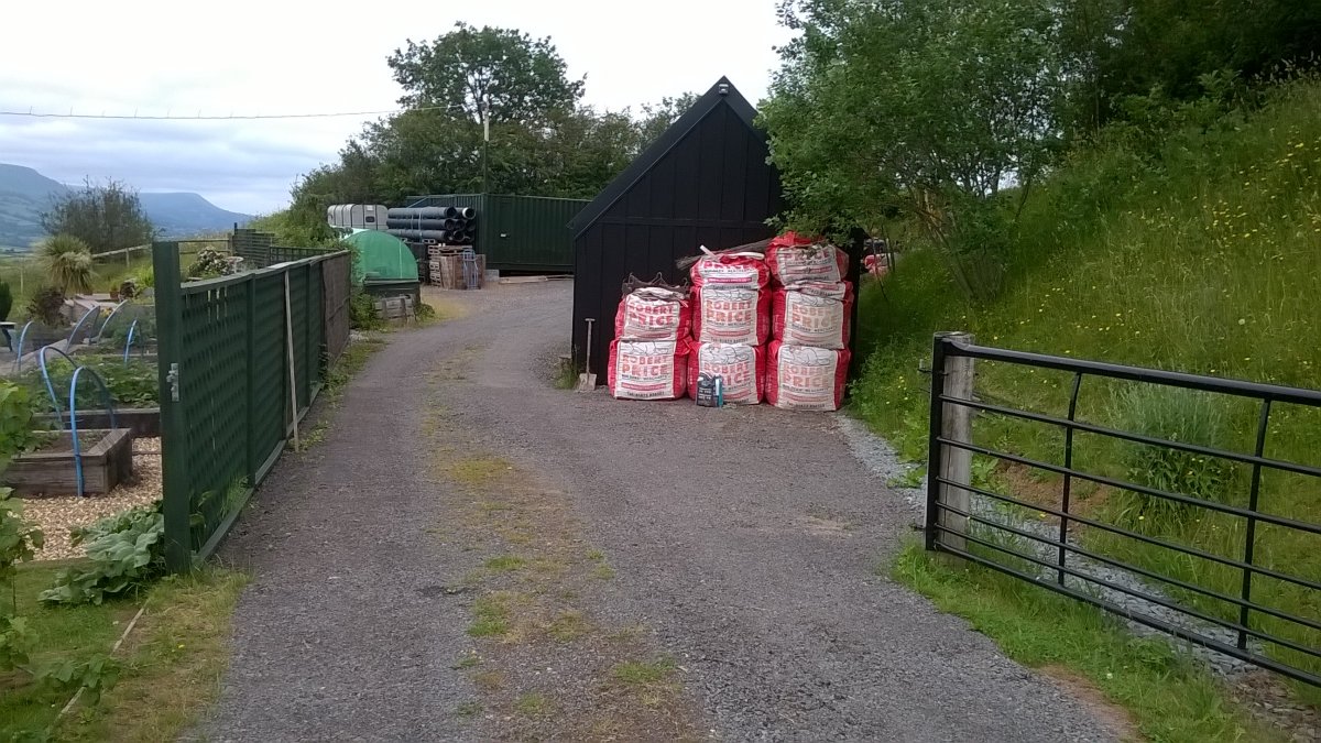

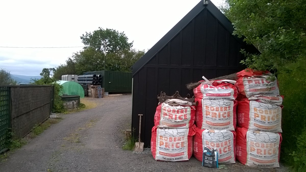

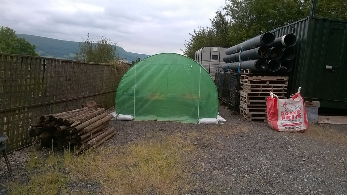

busy day, for 'the boss', yesterday ...... re-bagged the left over stone from the nadgered bags and stacked that lot on top of me bags of clean 40mm...
driven mostly by the fact I (well Pam actually) wanted my solid pallets, from under the busted bags ..... for a 'project' ....

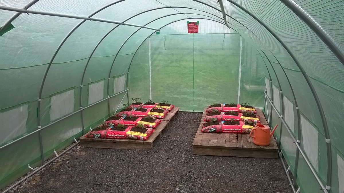

got the cover out for the poly-tunnel and patched the couple of holes its flight into the field had caused, last year, then got that back on the frame ...
refilled the new sandbags (hopefully these'll last a bit longer than t'others did) and got them in place, then installed me solid pallets as bases for ......
Pam's tommy grow bags, I'd picked up on me way home from Russel's job on Thursday - one short - only had seven, so cleaned 'em out .. she wanted to get her plants in and under cover from the forecast rain last night ... and didn't it ever come down :oops::oops:.
