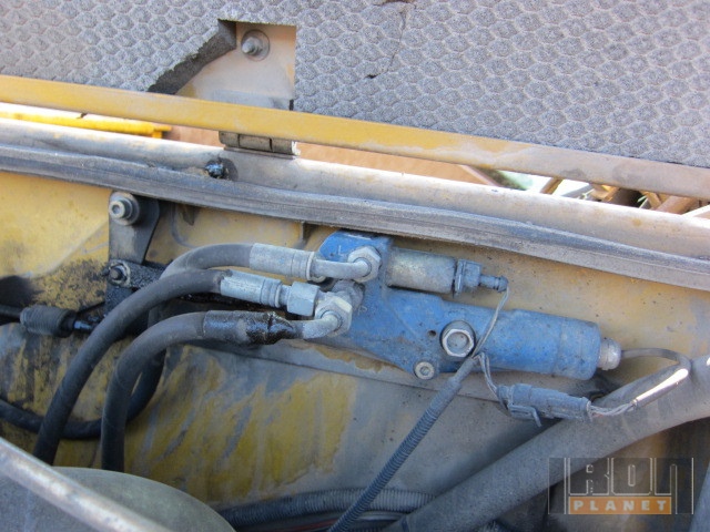

right gentlemen ...... I am in need of your collective knowledge/experience .... maybe best guesses.:giggle:
tripped over this pic today ...... ;)
this is the valve that controls the 'Drema's throttle .. this ain't mine but is identical off another Hydrema.:)
I have five levels of 'volume ' ..... Idle 1000rpm, standby 1400 rpm, low 1800 rpm, medium 2000 rpm and high 2300 rpm, all button controlled. :rolleyes:
she auto idles after 10 seconds inactivity and I pre-select what 'volume ' I need on start up (y) (or at any time I like after that) ;)
if you can't make it out on the pic:( ..top pipe is labelled L and the port below it is labelled P
I'm guessing the 'goldy' coloured bit next to L is a solenoid and there're 4 wires going into the other bit from the multi plug ... as far as I recall and can see here :rolleyes:
Anyone ever seen one of these before, or got any ideas how it works ????:confused:.... it basically varies the stroke of what must be a cylinder which pushes the throttle cable and opens the injector pump up to give it the beans :giggle:
I surmise that P bleeds pressure as required, from the LS line, when it senses a demand for 'action'
(I'll have to see if I can see WTF it comes from on mine), which is in no where near as convenient a position, to examine (tucked down/under/beside the Deutz's sump), as this one is - hence grabbing the pic .... ;)
but quite how much travel to give the throttle must be determined by those wires, which presumably are the four separate switches on the dash - SB, L, M & H
also guessing the 'goldy' coloured item is responsible for dumping said pressure for auto idle to occur ??
Some kind of proportional stepper solenoid perhaps?:confused::confused:
If this ever goes wrong it's gonna get a cable - end of, but would be nice to know HTF it works and whether anyone has any idea WTF this 'valve' is called ??? :unsure:
plus of course how it functions :unsure::unsure:
Game on fellas ....... :giggle::giggle:

Dont really have a clue but would it not make more sense if pressurised is idle taking a supply off the return to tank or pump to block otherwise each line would need to have a pressure sensor
Also some machines of that age rev up when the engine starts and quickly die off i presume as pressure is reached in the auto idle circuit
Just my thoughts though
she doesn't rev on start up Smiffy ? :unsure: .... can see where you're coming from though .....
I'll have to trace the pipework and see what comes from where ....
'sposed to be drier tomorrow, so'll get the bonnet up and have a shufty ....
only really thought about this today, after finding yon pic, but'd be nice to know how it does work ... another piece in the jigsaw, that is 'Drema ownership :giggle::giggle:
need to know this sh1t, with no fall back, when things get squiffy :rolleyes::giggle:
also be nice to know just WTF that valve is called ?? :confused::confused:

The 4 wires come from what must be a large potentiometer,haven't a clue what one would be called.
had a very similar response from another guy on the P&C forum Scoff ;) .....
"My guess is four magnetic reed switches embedded in it connected to the four way connector. Each spaced down the travel. A dash switch determines which reed switch is active and the solenoid valve advances the piston until that particular switch is activated. "
Both make a lot of sense (y)
