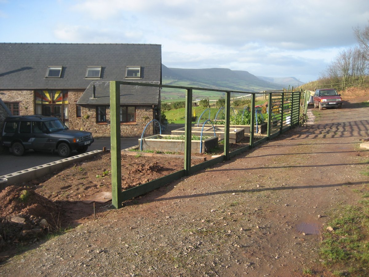

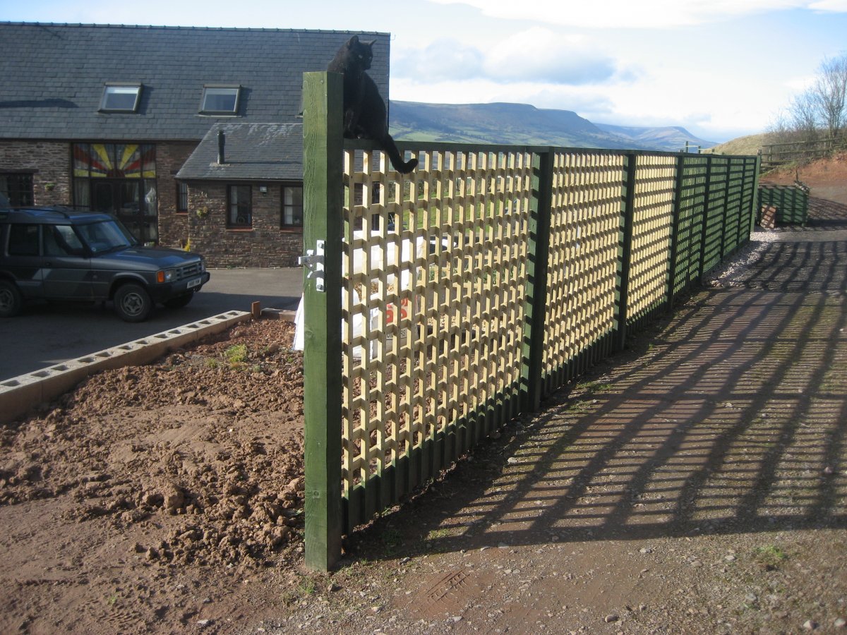

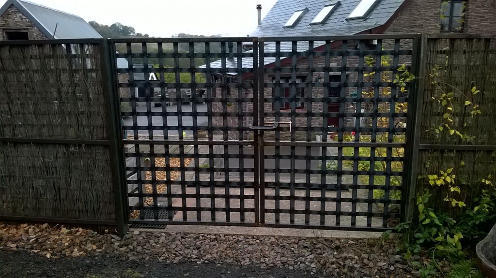

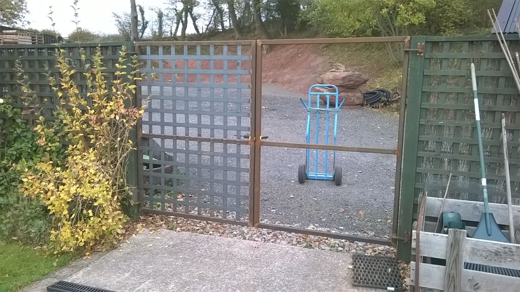

Would she want them on both sides? You could just drill a hole and tack a coach screw in it? Or cut them first, then plug weld them from the other side?
T'other side will get brushwood screening attached, as per rest of the trellis fence James ..... eventually.....when I suss a method, so it won't be seen.:rolleyes:
I have already devised a method of producing some suitable dummy heads .... not much up for drilling and barrel welding 'em all on though .... may well be a Devcon, Belzona or even JB Weld jobby ......they'd only be decorative and that stuff sticks things, like sh1t to a blanket ;):giggle:

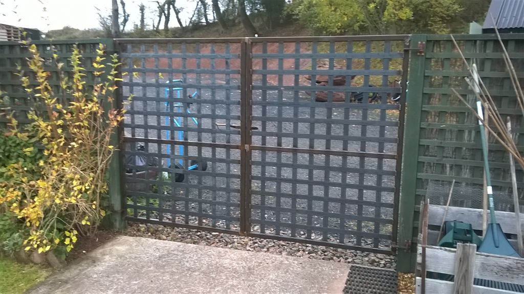

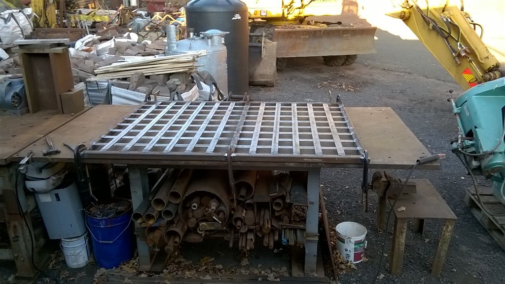

well as I assumed, said 'gate' needed 'the treatment' when the clamps came off this morning, as expected TBH :rolleyes: .... can't put that amount of heat into summat and not have it 'go' :(
Been a Clara day today, so time for me has been a bit patchy to sort it, but I did eventually get it back into the flat shape I started with and as to be expected :rolleyes: Pam wanted 'to see what it looked like' ...... :unsure:
..... alright, IMHDO :giggle: ...... but I've been viewing it, in my head, for weeks ;):giggle:
undecided on whether to blend the welds in or leave them ..... may well lose them, I think :unsure: .... but they won't be so pronounced once painted :rolleyes: :confused:
As I said to James earlier ..... it will eventually have the same brush screening, on the back of it, to screen me patch, as the rest of the trellis has installed ;)
...... when I've figured out just how to secure it :confused:..... I have a few ideas :)
don't think of it so much as a gate, but as a movable screen ;) (y) ...... to match the rest of the trellis fence line, :rolleyes: ... and you should see the cats go up that!!! :LOL:
now to get no. 2 done and sort out some latching .... I also have ideas for that too ..... it's going to be different o_O ..... they're going to catch some serious South Westerlies sat there, as it howls up between our 'barn' and next doors barn :oops: :(

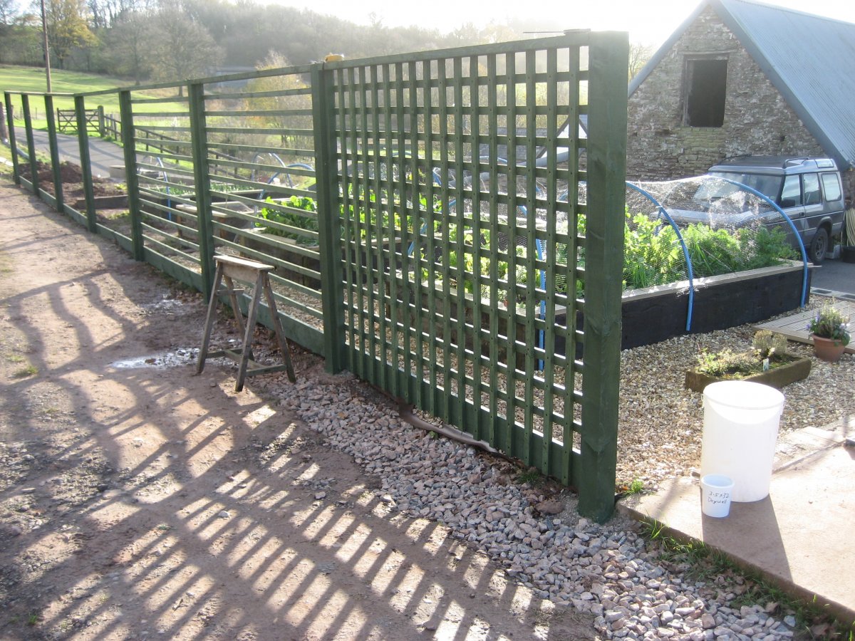

the winds we get here are the main reason the fence is a trellis .... a solid one'd have been down years ago ..... couldn't find anything man enough to buy so had to build it .... IIRC there's three hundred and sixty summat (seven I think), screws in each of those 2.4m panels ..... a lot of fence paint and quite a bit of head scratching to start with :giggle:
Squeak learnt early on how to climb the trellis :giggle: ...... the eagle eyed will have spotted I DID NOT like the sloping top rail .... so it got 'modified' ;)
we tried to coat all the bits before erecting it .... but Pam couldn't keep up :rolleyes::LOL:

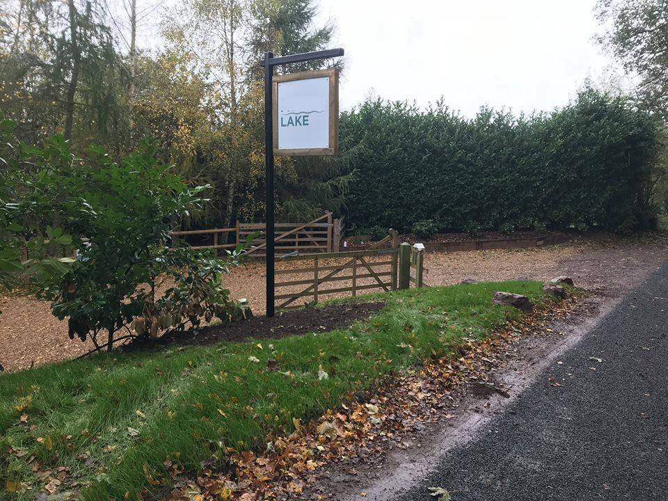

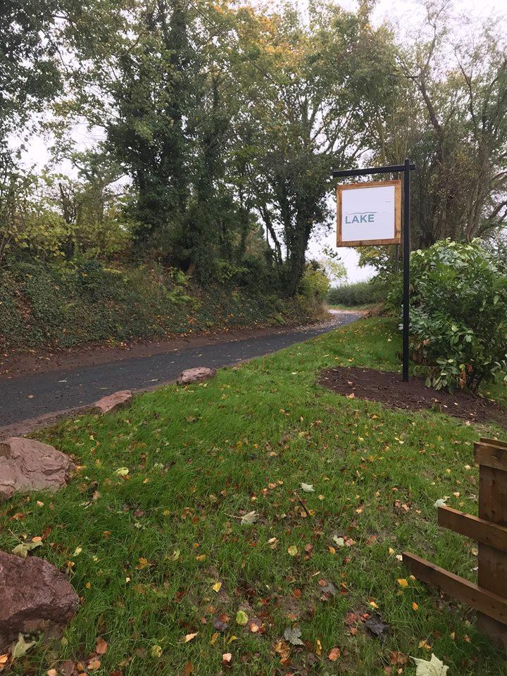

couple of pix of the sign gibbet sent to me today .... looks alright ;):)

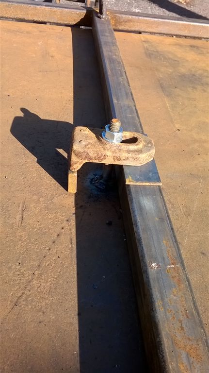

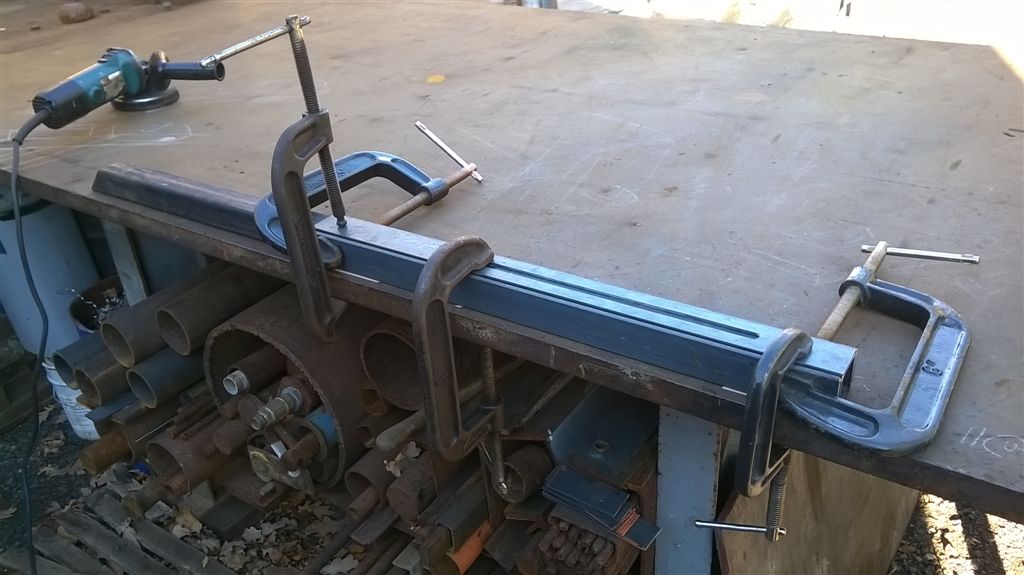

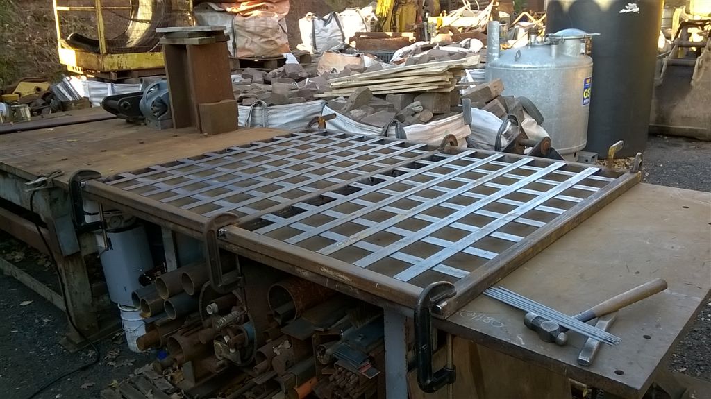

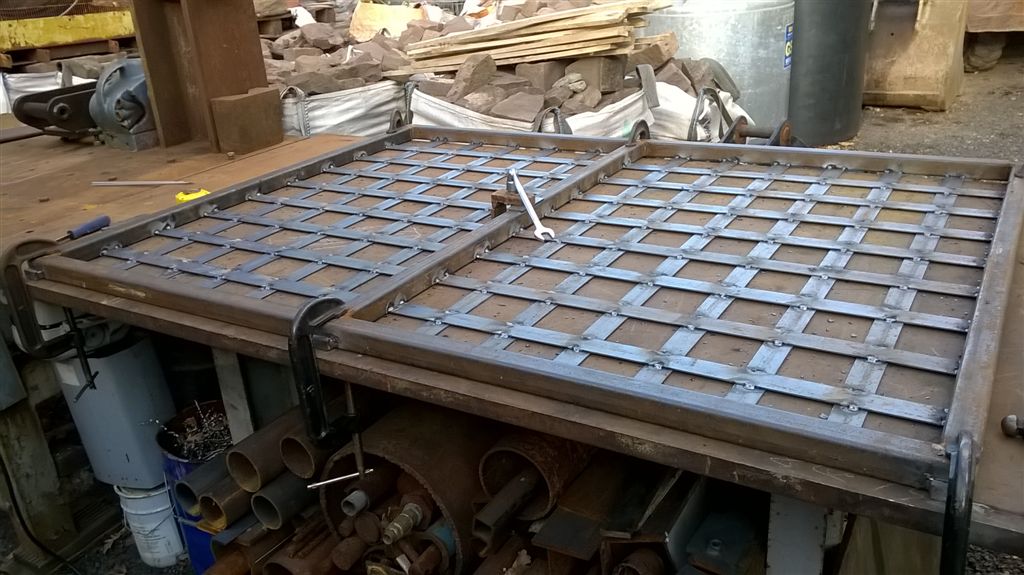

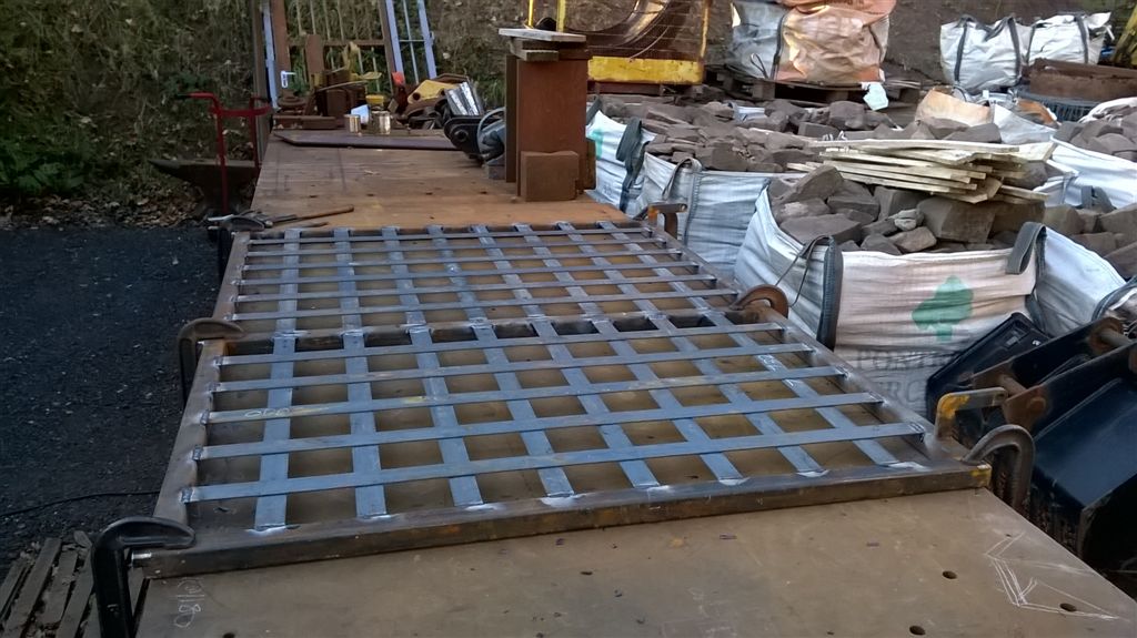

so .... sun shining, but bloody cold this morning :( ..... second gate had to have it :rolleyes:
had to have an extra hold down on this one ... TBH could've done with it on the first one, but packed to suit instead .... :rolleyes:

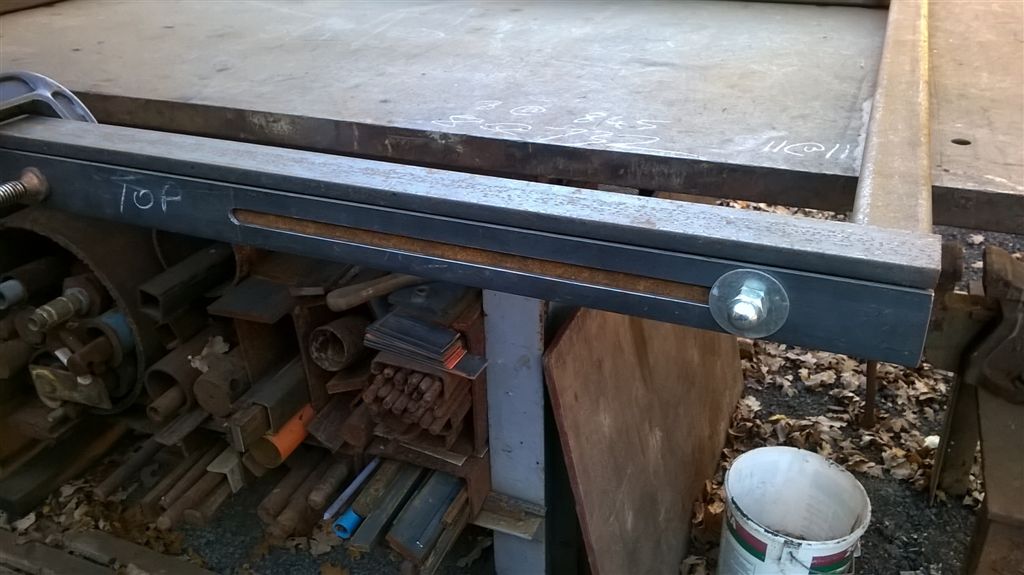

I cut all the infill at the weekend, (y)
so was just a case of getting it all set out and welded in ... :)
all the backs stitched in and cooling off, ready to flip it over ...... ;)
..... and get it fully consolidated :cool:

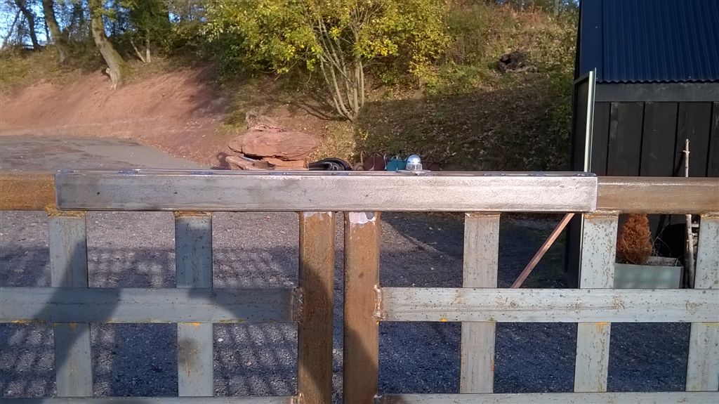

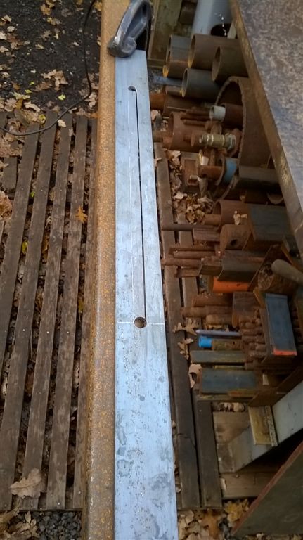

also managed to get the latch partially made up ..... ;)
with some judicious 1mm disc-ing :giggle::sneaky:
and the retainer in position .... (y)

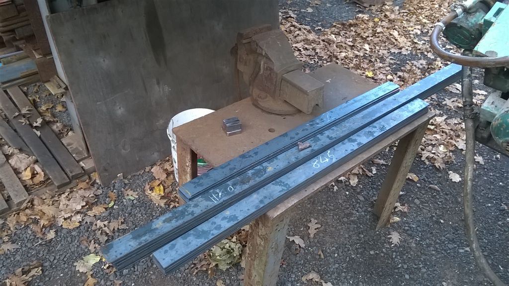

so I came home with some 40 x 6mm flat for me gate latch ... for tomorrow's lil' job :) ....as said though, today's been a Clara day ... and some !!! :oops::oops:

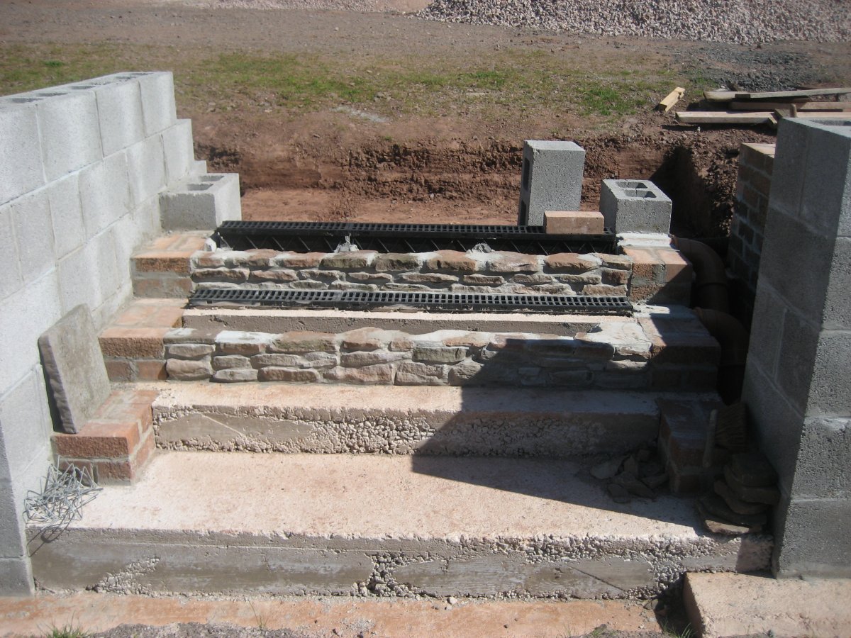

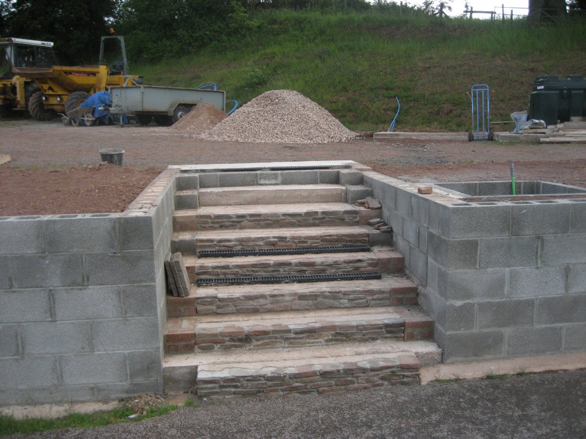

You need to get some slabs onto those steps 😶
How the hell do you know what I think, virtually every time I go up or down them steps Mike :LOL: :rolleyes: ...... if only to protect the currently raised drainage channels :rolleyes:
would love to get it done ;) .... got two more steps to stone face and back-fill, plus all the wall facing to get in place first, even if it's only in the step area !! :unsure::(
Also got 80+M sq of retaining wall to face :rolleyes: .... Me stone man still hasn't put in an appearance :mad: and I'm pissed off with chasing the bugger. :mad::mad:
The way it's going I can see me ending up having a.n.other crack at it :(..... Did about a square metre plus a while ago when SWMBO wanted it looking like dry stone, so real tight joints :oops:.. changed her mind now and she wants mortared joints :(.... I'm told it's an easier proposition, but anything as abstract as stone work is not an easy proposition, to my straight and level, engineers eye .... really struggle to get my head around it :(:(
several really good stone masons round here ... my BIL being the top one ..... but all are busy as **** and can never pin one down to a year, let alone which one :rolleyes::(
can well see me having to learn another new skill ..... and soon !! :rolleyes:;) ..... I'd never laid a 9" hollow in me life, 'til I did the retaining wall.
but at least that was all straight-ish lines and level :)
slow going as I weren't in the greatest of shape in 2011/12 :( ..... but kept me sane ;) ... my mind occupied and off the health issues at the time (y)
steps in progress .....
seems like a lifetime ago :unsure::rolleyes:

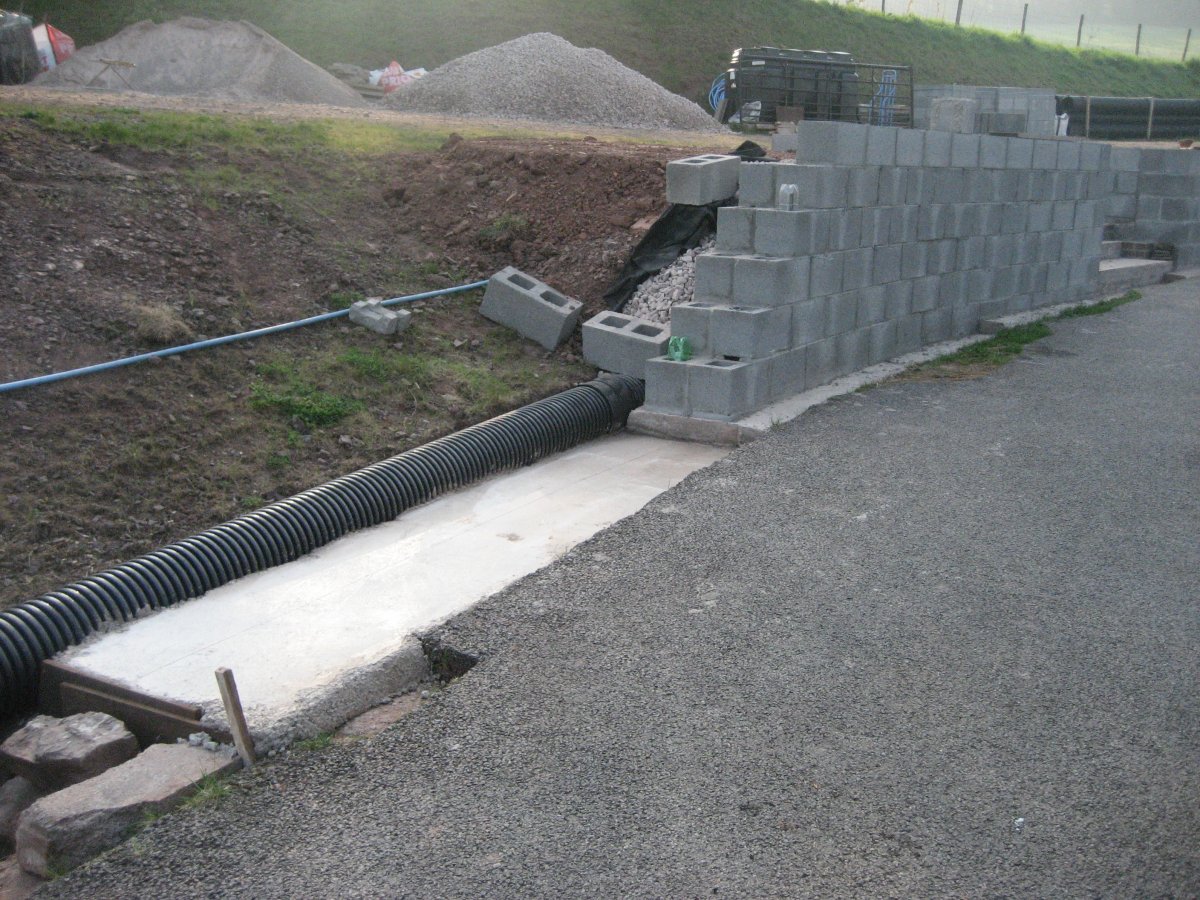

mart1602

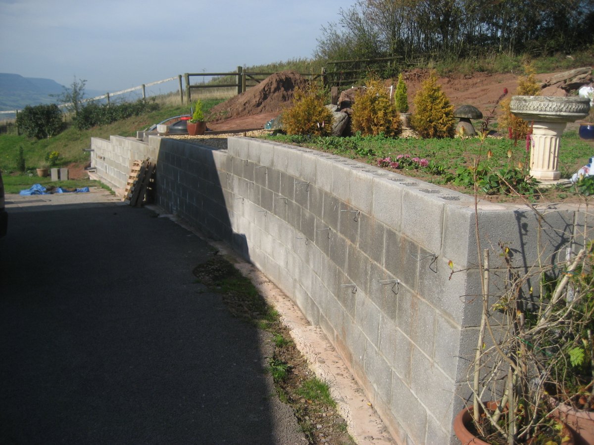

you done a good job on those hollows gra they not easy for a brickie to lay tidy,i always hated the bloody things,if you get to the point where you need advice on stonework be more than happy to give you a few tips the guys that tought me were in there late 60s 30 yrs ago!! they started before conc blocks were even around
Cheers Martyn .... they took a bit of sussing:confused: ..... and so did the mix ... get it like butter, lay it out tidy and get 'em on right first time ... they'm like bloody sponges :rolleyes:
I could never earn a living laying 'em, for sure :giggle:
the stone work just does my swede .... toooooooo random .... but dare say with some practice, I might get it :rolleyes: ... again, the mix is all important ..... reckon it wants to be a fairly dry consistency, for support ?
Can well see me getting to a point where it'll be a case of "ah well, let's have another go at it " ..... yon stone guy's not been in touch and the whining noise gets ever louder :mad: ....... we'll see :unsure:
mart1602
dry mix like screed and never allow 2 stones to touch or once the weight is on it will all come tumbling down
cheers Mart (y) ... can well see the logic in that ;):sneaky:
