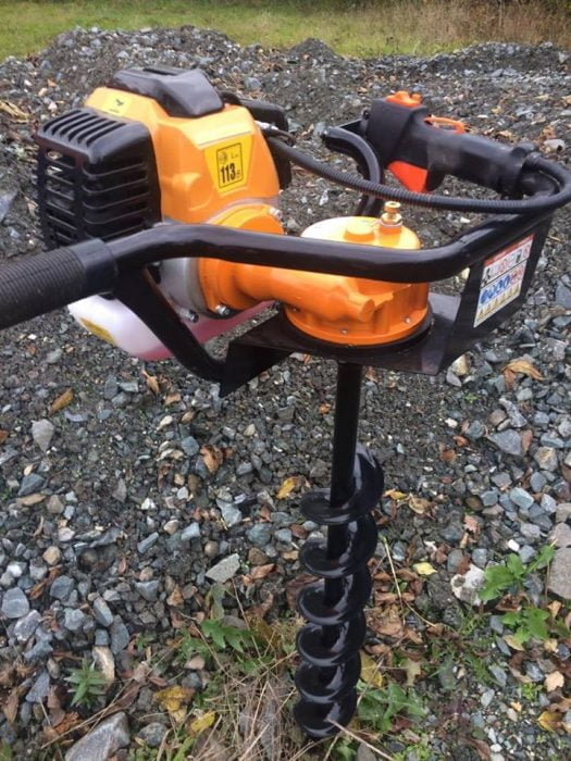

so ..... gentlemen ..... do I order a Lumag ? ..... our beloved leader @Regy53 seems to rate them .... and they do have stock at least :rolleyes:
YES..but look after it 😉🫣

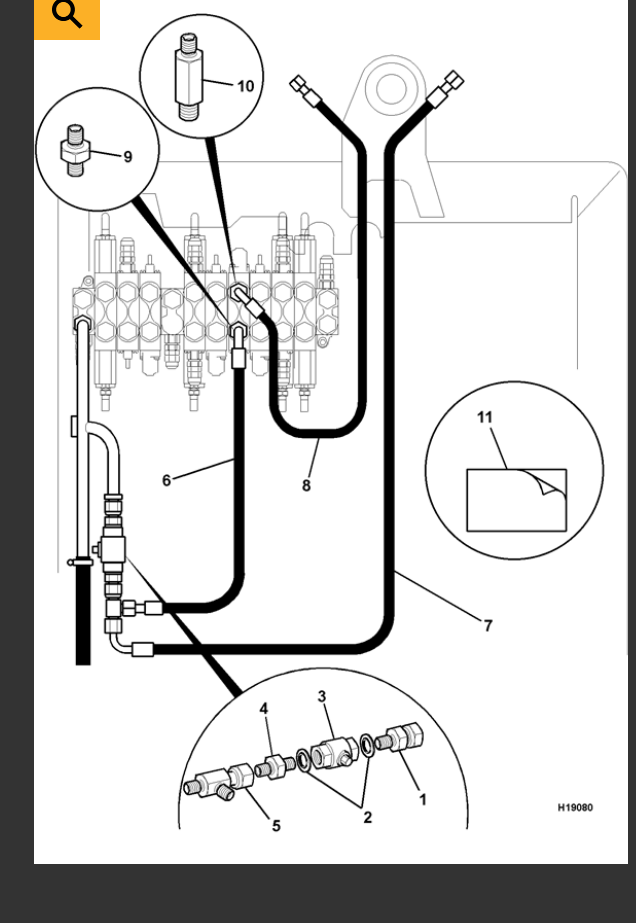

This picture might help you in your quest to fit double acting auxillary.
thank you ... makes a lot of sense ..#3, I presume, is an on/off valve to close the second side of the service off from/to tank and in single acting mode it just dumps to tank ? .. know what I'm looking for now (y) :cool:
When I did mine I thought of doing this to save on a long pipe run but decided against it. The reason being having three lines down the arm with one being direct to tank gives the facility to use hydraulic motor with a case drain if required.
can see your reasoning in the additional line too Rob ... gives a direct to tank drain for motors if the m/c is not originally set up as double acting and the block is plugged as you said :cool: ... seems odd that the block should be an M20 fitting though?

Yeah the tap closes the route to tank off basically creating a double acting line.
