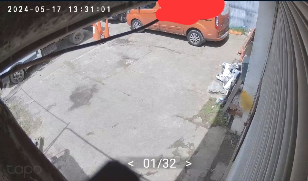

I've got Tapo ones and can't fault them tbf. SD card or £100 a year for cloud backup for up to 10 cameras. Ones I have are rechargeable weren't fully charged when installed at beginning of January and still on 36%.

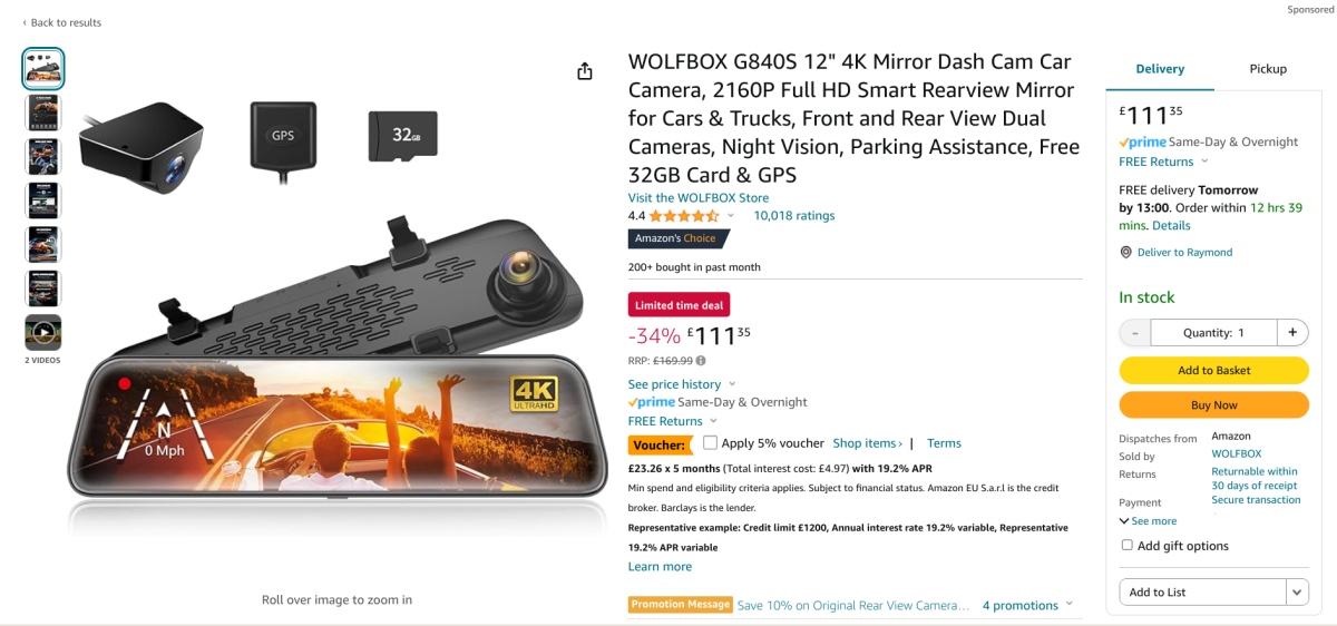

I have a 12 " er and cant recommend it enough.
Got older model in car and im going to upgrade it soon as there are some 4k ones out now with loads of features.
Waay better than the halfords one i had before.The rear view is so wide i can see cars that are not in the wing mirrors.
It monitors all night too and locks any recording thats suspicious .
There are loads of em all over amazon at all prices.
Couple of yrs ago mine caught a transit van back into a car and drive off. Other people saw it but the camera was sharp enough to read no plate.
This helped the womans claim along nicely..
