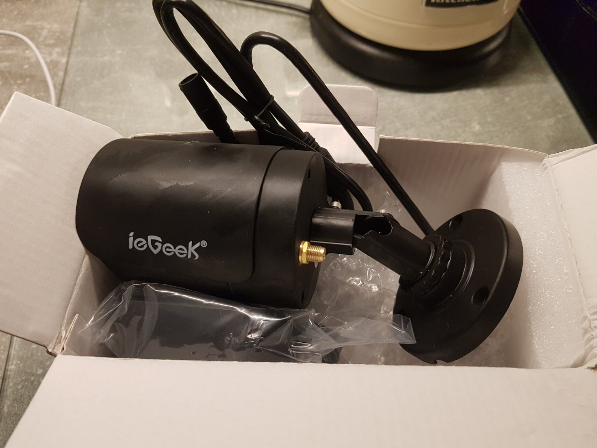

Amazon doesn't mess about when you live in the ghetto. Feels well made tbf. Bit of weight to it and metal body not plasticy like I was expecting. Not bad for 32 squid 20201220_183357.jpg

co-ax interface though isn't it .... didn't someone say above that ethernet is the way to go

Above my pay grade @V8Druid. I think it has an Ethernet cable output Tbf but I'm using wifi anyway. The antenna is in the box

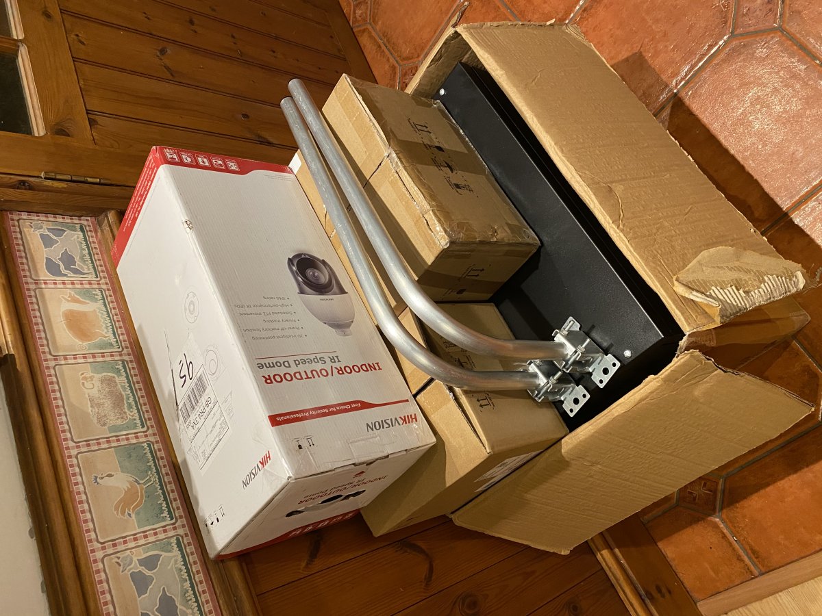

Just received my latest camera order to be installed on a local farm got a couple to do in the near future. I believe there’s a grant for it at the moment? Bit of a sideline for me as I’m an Agri mechanic full time. But this job keeps my experience in the IT sector current just in case I fancy a career change....
I’ve been keeping an eye on this thread and the recommendations are about right. Hikvision and Dahua are good value professional cameras. Rule of thumb is to stick to IP cameras as the flexibility on setup and power source gives you some major advantages.
Swann and the likes of the consumer items ain’t great by comparison, so unless after a cheap domestic setup then avoid them really.
Camera location is important to maximise the usability of the footage as evidence. Just think how many recordings you’ve seen on crime watch or Facebook where you can barely identify the person. This is why many cases get dropped. Unless the footage is good enough to spot someone you don’t know with pinpoint accuracy then it’s not really worth having. Therefore camera specification and location need to be matched.
I’m also fitting long range wireless links to some locations as cable runs would be tedious and costly. The prices for the equipment required to achieve this is fast dropping in price and a wireless link can cost as little as £160.
Any advice you need just ask...
