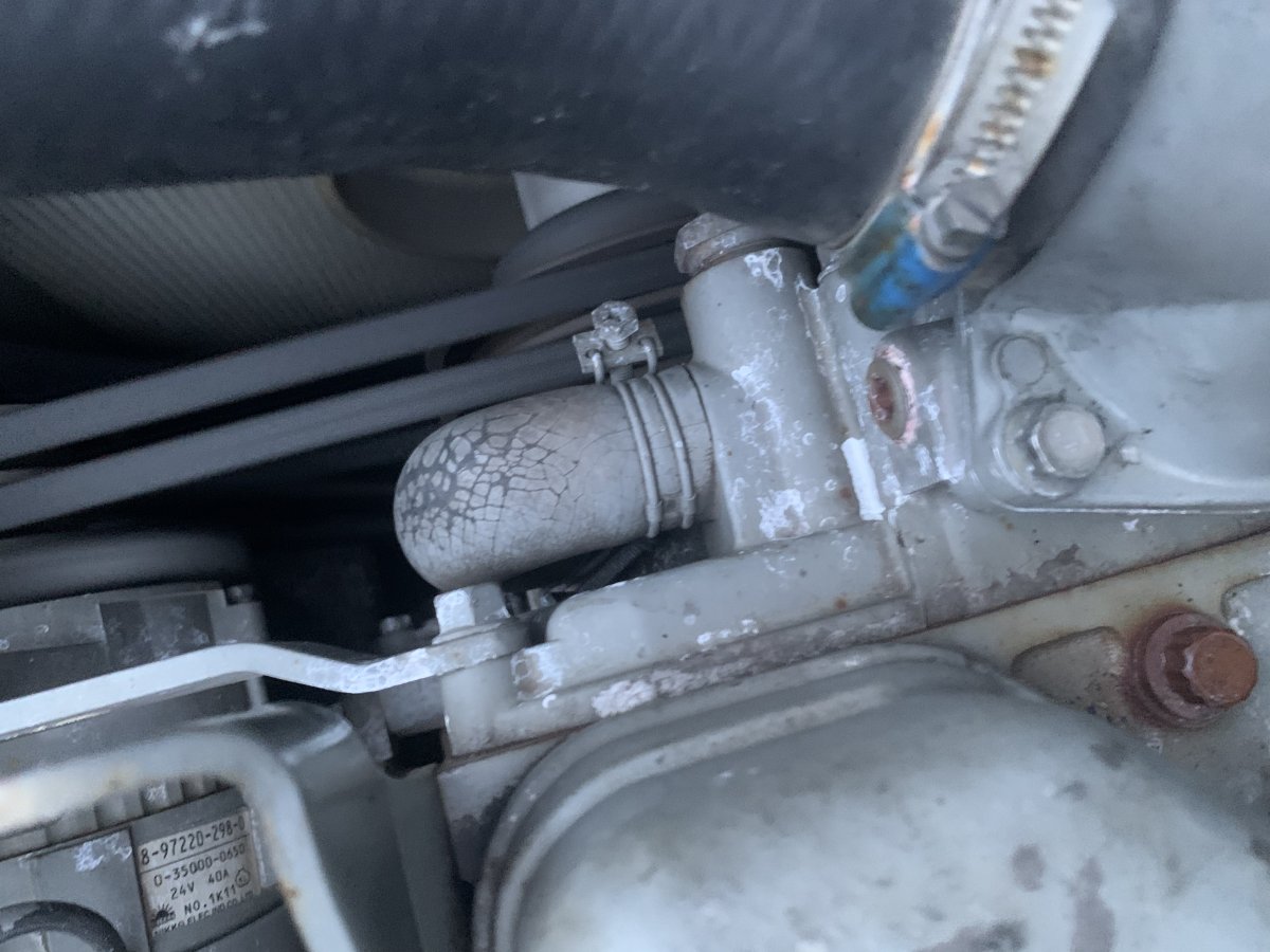

Actually there is a manufactured hose on the side of the stat that is a horrible 90degree angle and it doesn’t feel good when I squeeze it 🤔

Actually there is a manufactured hose on the side of the stat that is a horrible 90degree angle and it doesn’t feel good when I squeeze it 🤔View attachment 22346
them's lil' bar stewards to work on .... return to block for sure and'd guess that boss is totally isolated from what it's cast into ..... just forming an elbow to feed that little sod of a rubber elbow and get the plumbing over the fan belts without issue

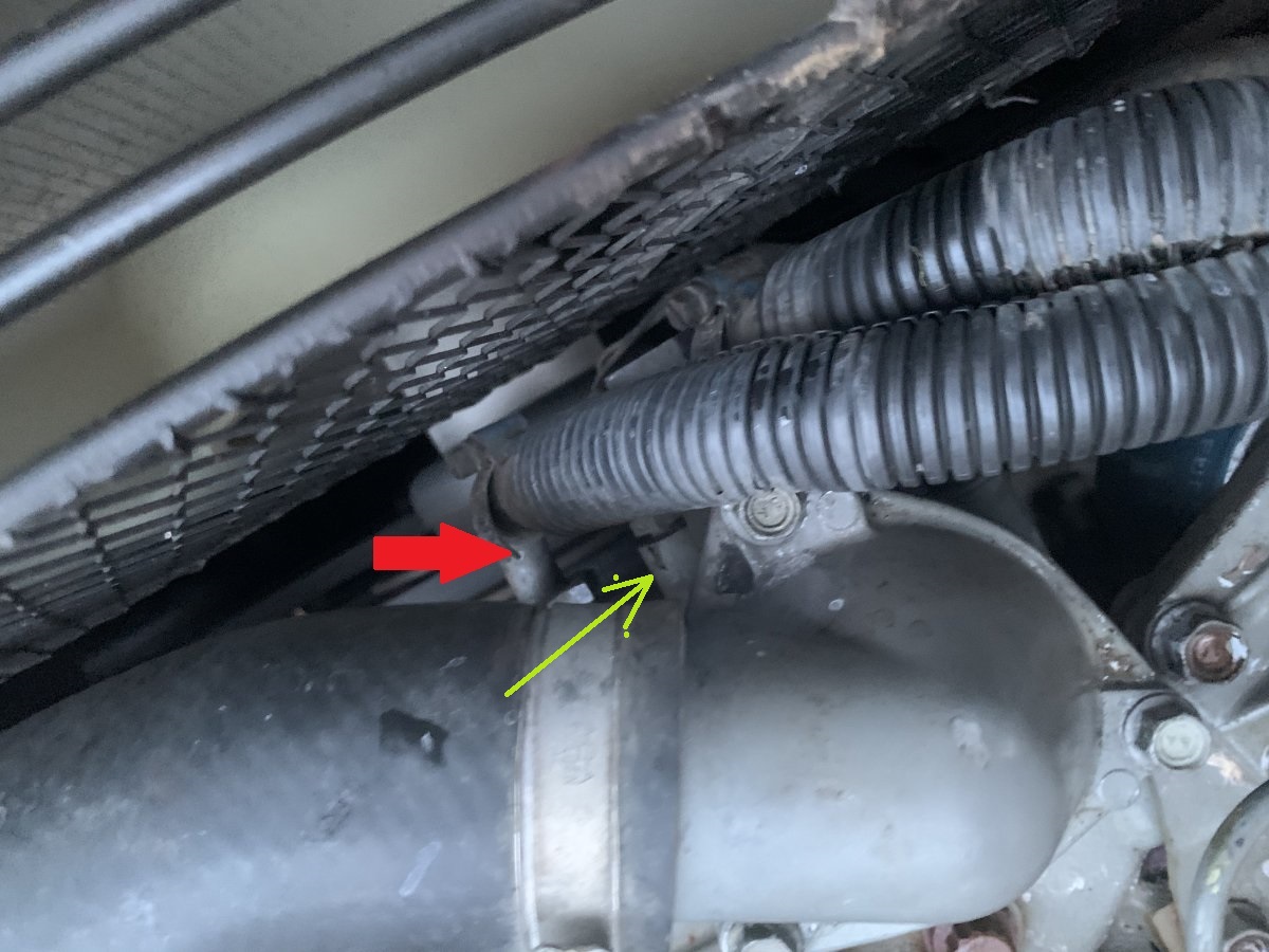

looks to me to be going into the block below and to the side of the thermo housing vin red arrow
t'other is going into a boss in the housing green arrow
Yes that makes sense . That’s where I wi
that little elbow could also have a build up of scale/crap/gunge reducing its flow capability or even have delaminated and a flap of rubber blocking the flow :unsure:
I think I will just replace that wee pipe . It didn’t feel good anyway .
won't hurt for sure ..... good luck with that .. prbably pick summat like it up at a motor factors or go BLUE heat resisting silicone .... available in all sorts of shapes/sizes/bores/etc.
