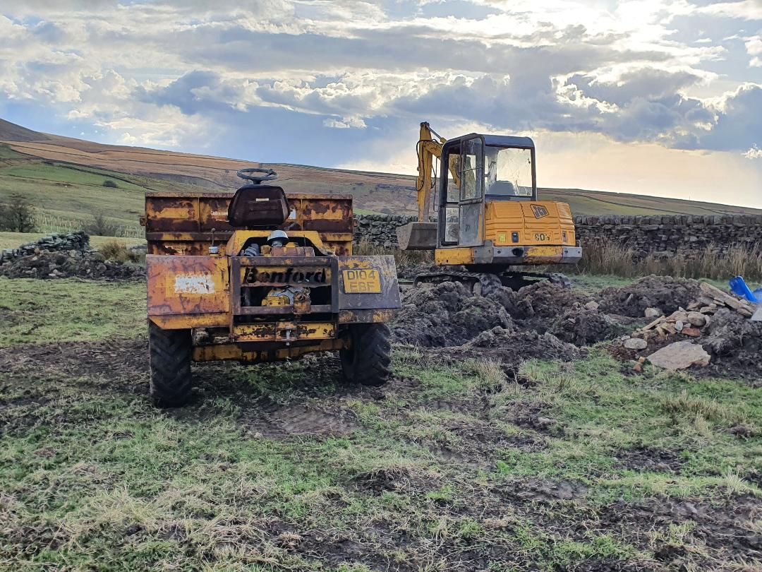

I didn't think the 803 had the strength or grip to pull it out, but to be fair to it it didn't struggle at all. I took the O/H down with me, but I don't think she even found reverse on the dumper before i'd dragged it back and out of the mire.
Man and machines in perfect harmony, 3 antiques working together.

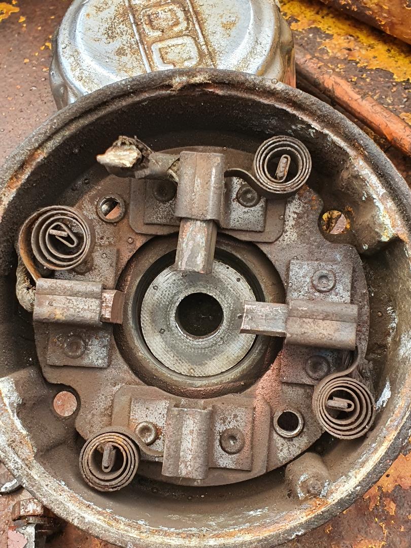

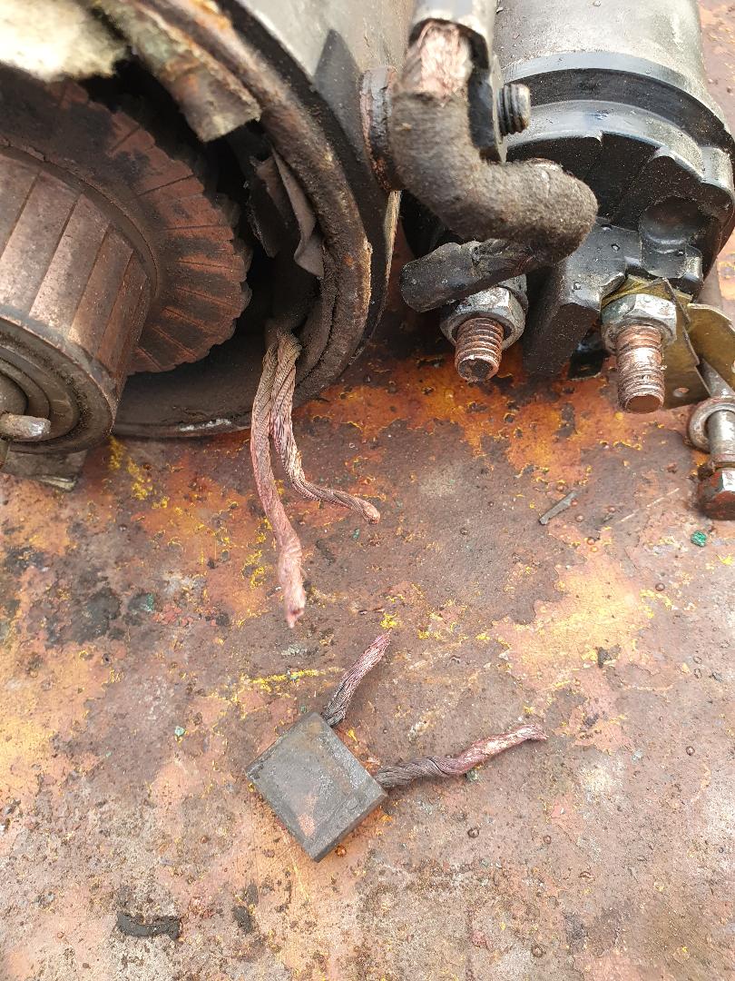

Took the starter off today, it's not in good condition so is the cause of the starting issues. It fell to bits as I was taking it apart, wires broken, soldered joints falling off and broken springs etc.

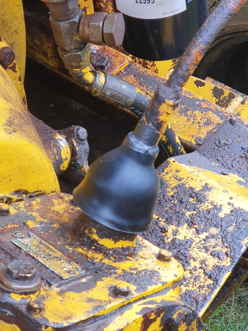

Looking at some of your earlier pics I did think that the dumper had been semi submerged in water, you need to check the oil in those axles and drop box!
Gearbox top probably has no rubber gator over the top of the box around the base of the lever!
it'd split I think Mick
I'm pretty sure rain water has run down the gearlever, under the gaiter, into the gearbox and mixed with the oil. Mmmm, lovely.
What has happened is the rubbery plastic plastic gaiter shroud cover thingy has gone hard over the years, some rust has formed under it and pushed it away from the gearstick which passes through it. Water has then been able to run down, pass through and into the 'box. I put some gasket sealant around the collar of the gaiter to stop this from happening again for now.
I had to refill and flush it several times, the old hydraulic oil was good for this. What made it harder was stupidly the drain plug is not right at the bottom.

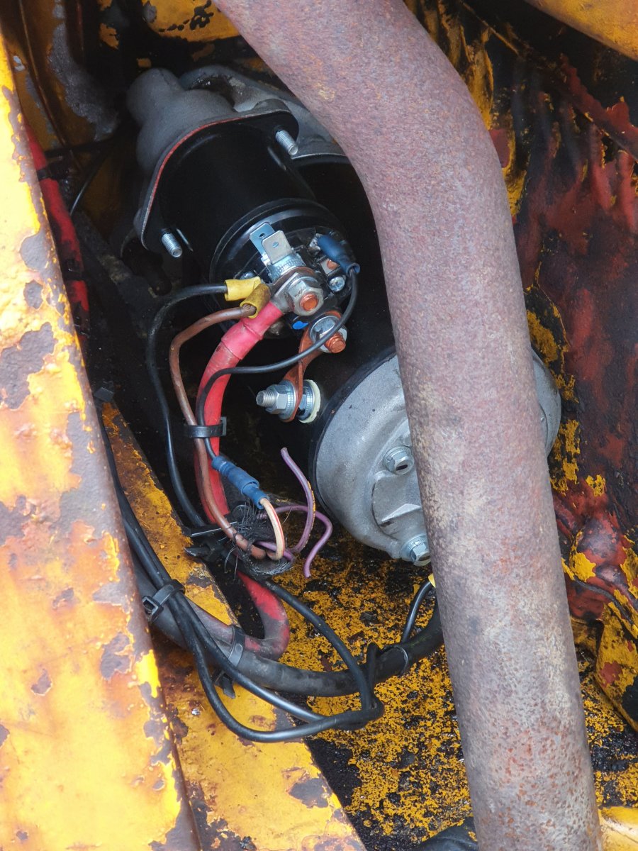

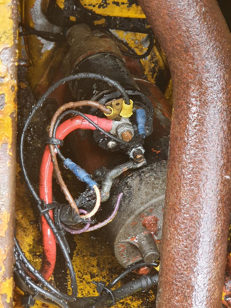

The starter motor was past its best. I could have tried to repair it, but I don't think it would have been reliable or worth it. Me and electrics don't go well together either, time for a new one.
The starter for these is a Lucas 54 24 25 14, but that number doesn't bring up many possibilities. I did however find a cross reference to a LRS 155, this is the number you want, it opens up a whole load of choices. £125 inc next day delivery, that'll do.
When you're designing a dumper it's a good idea to run the downpipe right where the starter needs to come out. Don't put it to the left or the right to make it easy, straight down the middle is best.
Then use steel bolts which will rust in solid
Don't put a shield over it, let it get the maximum amount of rain so it corrodes down to the thickness of a piece of foil.
So when someone eases it to one side to get the starter out it just tears.
I'm really looking forward to building a new exhaust, but that aside it now turns over and fires up much quicker than my van which is about 30yrs it's junior.

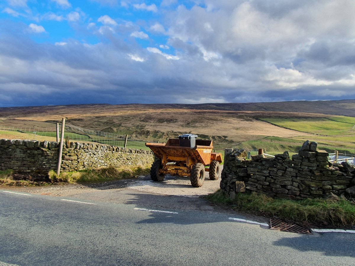

We celebrated being mobile again by putting the bin out:
When you're designing a dumper it's a good idea to run the downpipe right where the starter needs to come out. Don't put it to the left or the right, straight down the middle is best.

I'd suggest putting the main live eye onto the post first, followed by the lighter eye terminals, spring washer and nut ..... you really want the best surface area contact between that live cable and the nut under it, as possible ... don't really want the current flowing, either through those thin, flimsy eyes, or the spring washer ;)

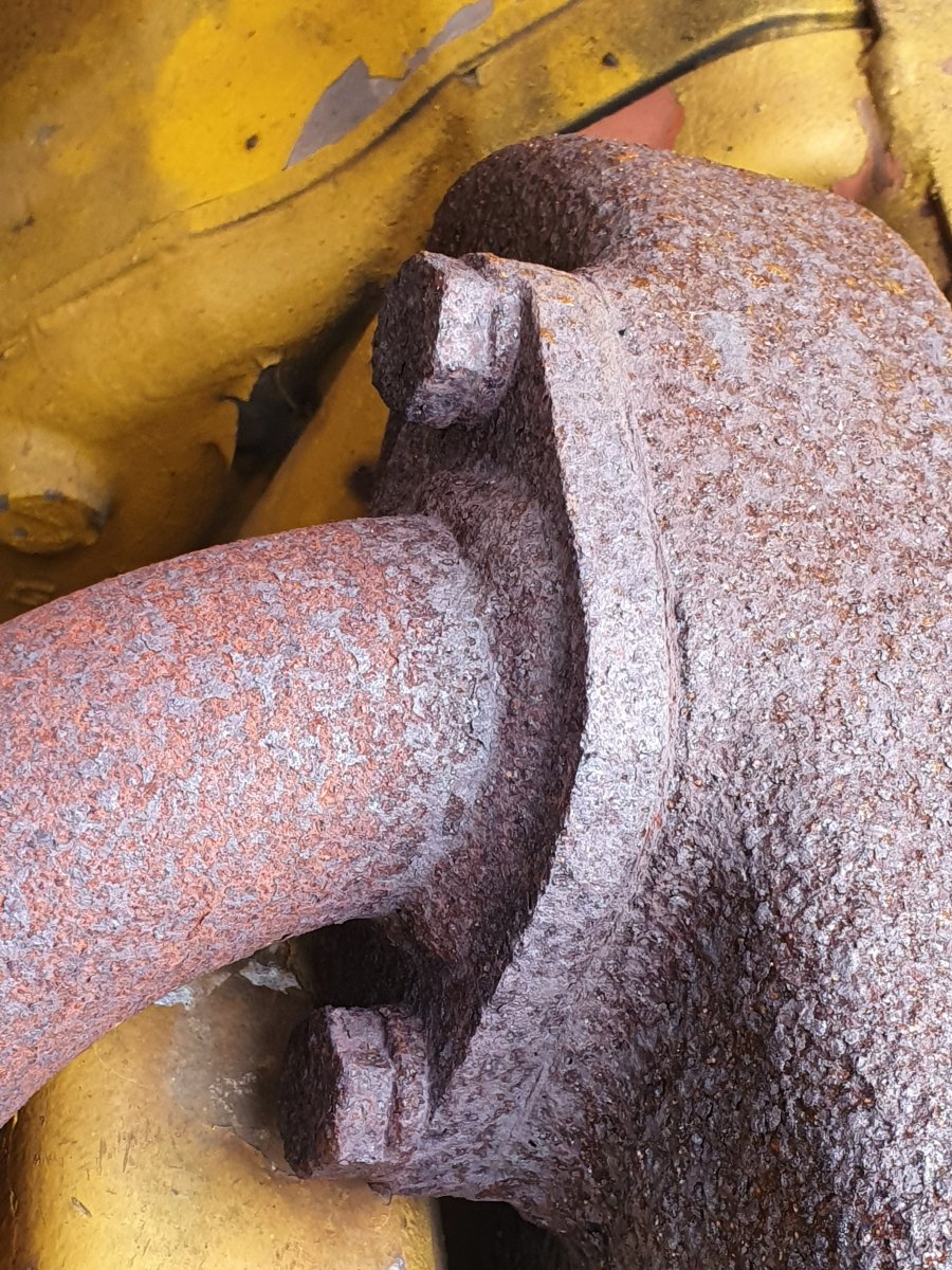

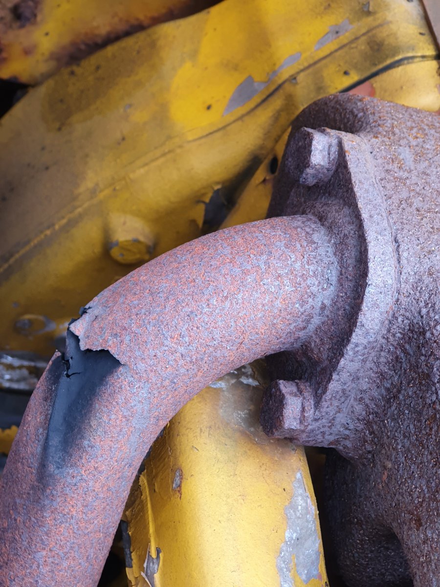

on the exhaust manifold bolt front .... get it all hot, get a nice drift and give the heads a good couple of firm, accurate, clouts ... drive a nice tight socket onto the heads and give them a gently try off/on/off a little at a time .... you might be pleasantly surprised, but don't try it without shocking the beejeezus out of the threads first, with a few well delivered hammer blows ....... and don't get over-enthused and bust the manifold ;)
Oh and I'd also slide a good thick piece of rubber hose over that live cable, while you have it off again, to insulate it from that chassis edge, which'll wear through the plastic insulation on it PDQ :oops:

It does keep the starter nice and warm though, good old British engineering😊

The manifold will get some kind of repair wrap around it for now, it's more annoying than stopping the machine from working properly or safely. Will wait until I see a replacement for reasonable money, or just bite the bullet one day and make one.
I think trapping those flimsy eye things under the stronger one was a good move, one of them is too big anyhow. It's a stronger way of doing it (the nut and washer will tear them) and once it's all tightened up together becomes one mass with the current going through the whole thing.

Agree on that cable going over the chassis member though, accident waiting to happen so will sort it.
