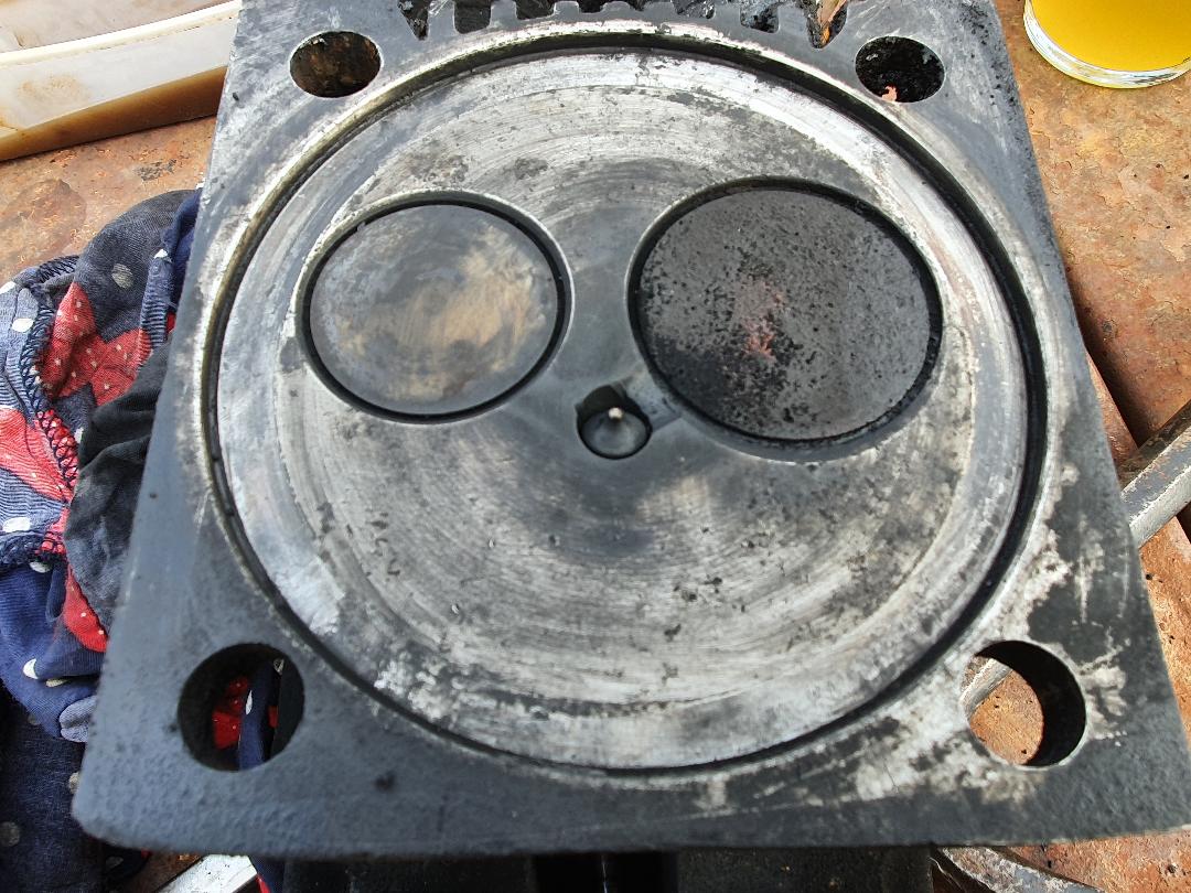

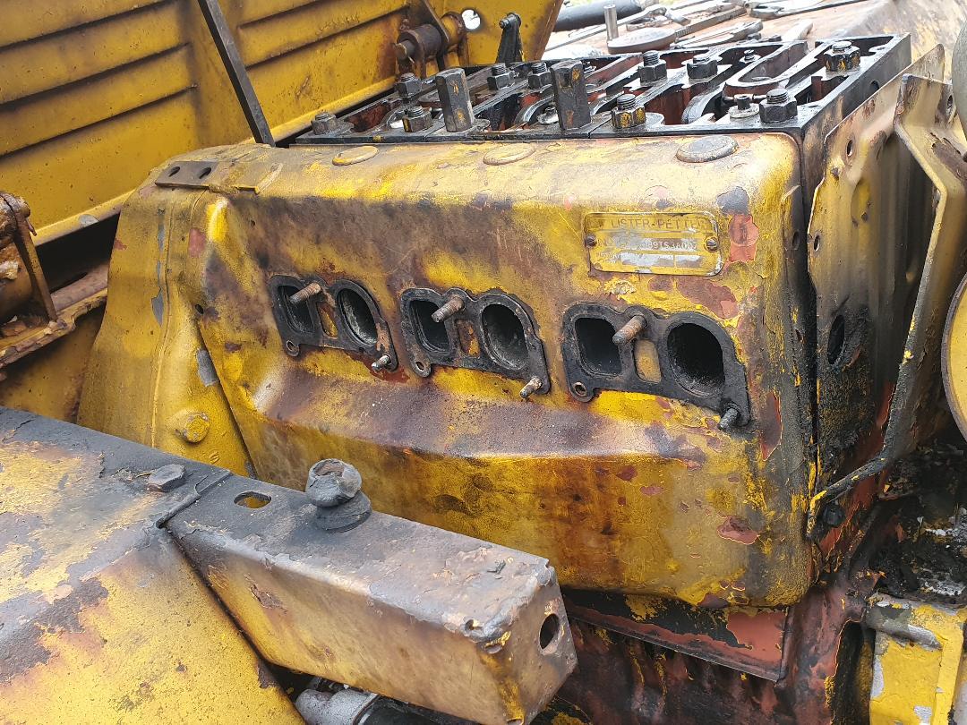

I wasn't looking forward to doing the head 'gaskets' outside here as it's a fair sized job. I could see many studs and bolts waiting to be snapped off, the weather could turn nasty half way through (it is Easter afterall), as it was a 4 day holiday something would be needed that I couldn't get until Tuesday.
I also knew as an engine guy I would want to pull the whole thing apart and overhaul it, but that wouldn't be possible.
However a pessimist is never disappointed and it went ok in the end. I've worked on some devilishly complicated engines in the past, but this is fairly basic.
A couple of days earlier i'd noticed one other cylinder was blowing too and once you're in there you might aswell do all 3 anyhow so I did.

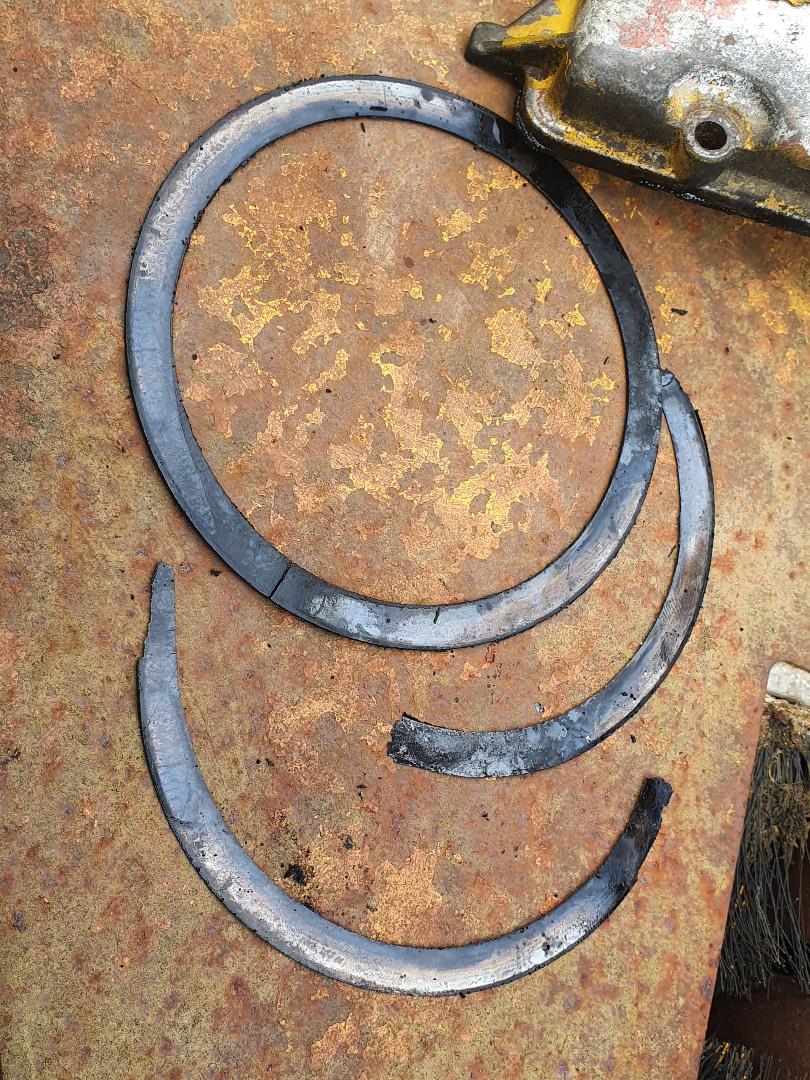

As you can see the gasket shims were shot hence it blowing. You get provided a bag of various thicknesses and fit them to suit the squish clearance of your particular engine.

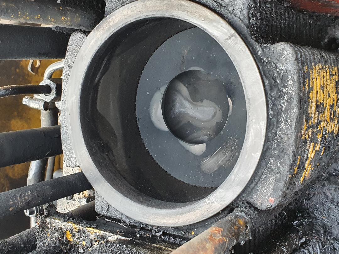

Because this air duct gets sandwiched between the manifolds 6 gaskets are needed, but the supplied set only had 3 so I was forced to re-use the old ones, luckily i'd peeled them off carefully.

The shim gaskets are a bugger to get right and I think whoever did the job last had had at least one set on off centre and squished an edge. Maybe that's what had caused its demise, I don't know. If you put them in the head with some grease they fall off as you're lowering the head down. gasket sealer can not be used. I placed them on top of the barrel instead, centred them and dropped the head on. The problem is they sit in that recess so you've no idea whether they're on correctly or not. If the engine was out and on a stand you would turn it upside down and go up from underneath for a perfect job.
Why someone had been in there before me we'll never know, they didn't read a workshop manual I know that and you don't know what they did wrong, right, why or why it it had failed.

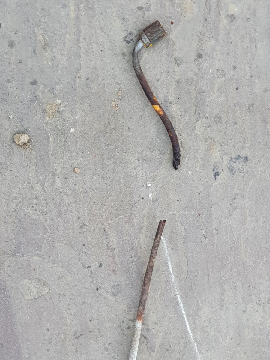

So I got it fitted, filled with oil, brake bleeder on and it blew oil out of a chassis member 🙈
Turns out one of the brake pipes had rotted straight through out of sight in a box section and was solid with rust and crap too.
Was it normal 5/16ths car brake pipe I had a reel of? No of course not, it's 6mm so I ordered some of that.
Got it all fitted today and woohoo, we have proper working brakes! 😙😙😙

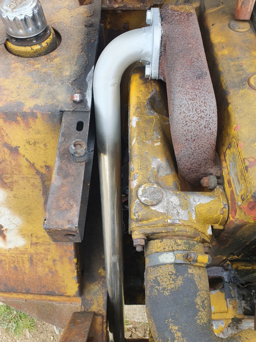

I'd ordered a piece of stainless tube and a bend so cut and welded it together. I was pissed off to find my SS Migwire off a broken reel in a mess. Tried untangling it, but no way was it working so I used mild steel wire and painted it instead.
It's really close, but does miss the chassis and the engine is bolted solidly to the chassis so it doesn't move.
Does it sound any quieter? Not at all, It still sounds like a 1910 biplane taxiing across a field.

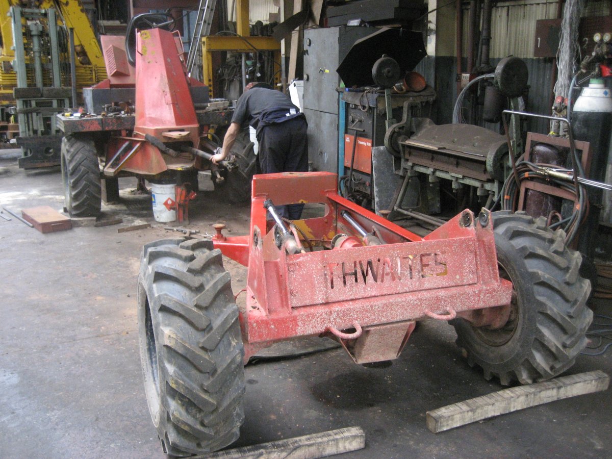

Thwaites have the same problem with brake pipes in the mud!
They must have put them in there as they're building up the chassis and welded them in too. I tried threading a piece through it and it didn't work.
I wouldn't want brake failure on one of these going down hill with 3T in the front 😲

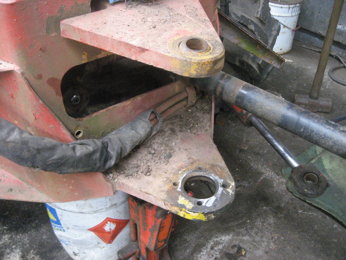

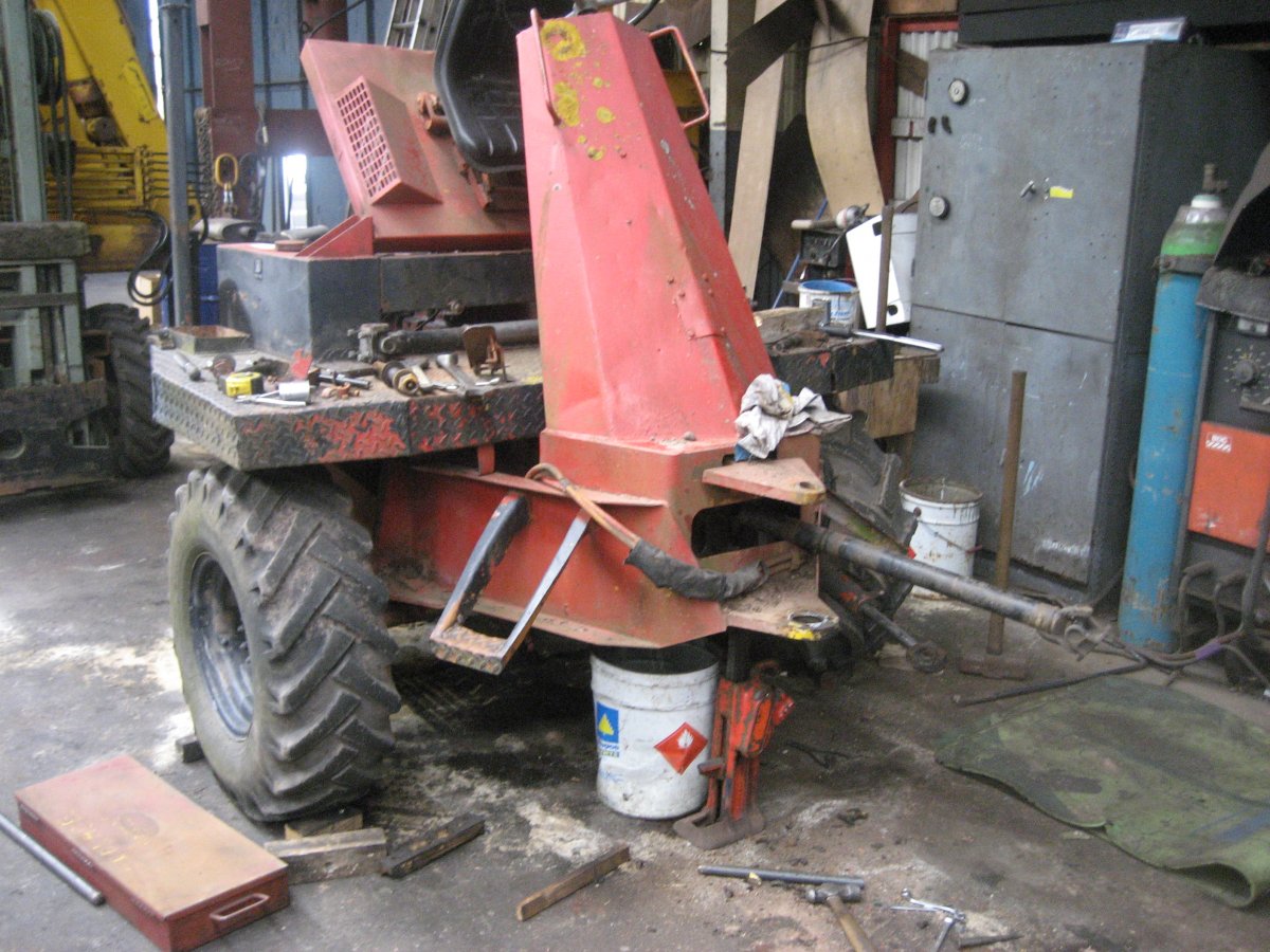

Have you ever done the bearings on the centre pivot on one of these? There is a lot of play in this, it clunks a bit now the brakes are working.
I was wondering if it could be done somehow without pulling the two halves completely apart as that'll make it quite a big operation.

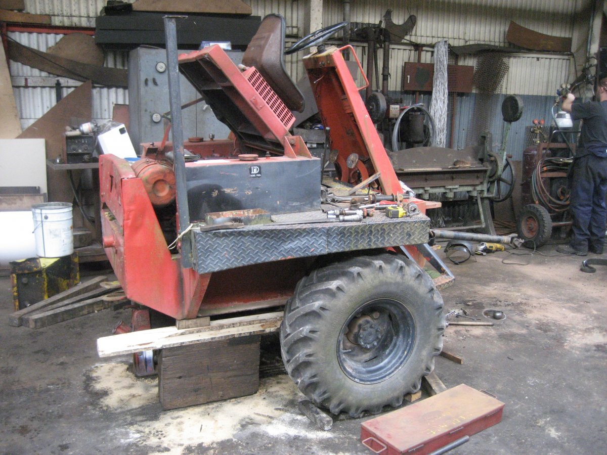

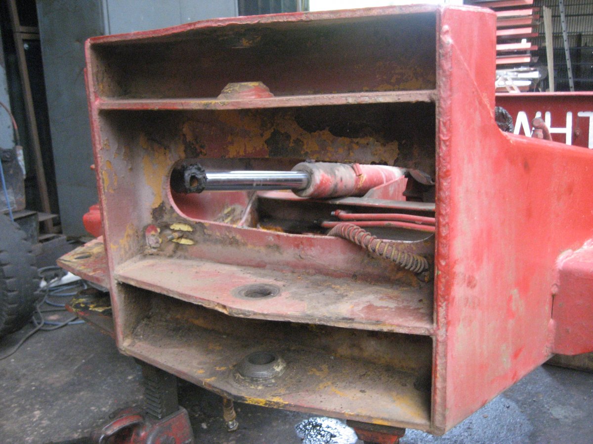

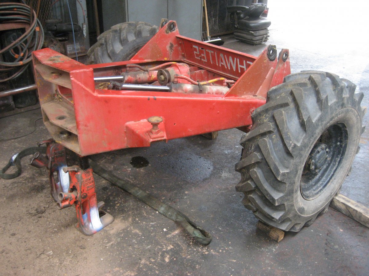

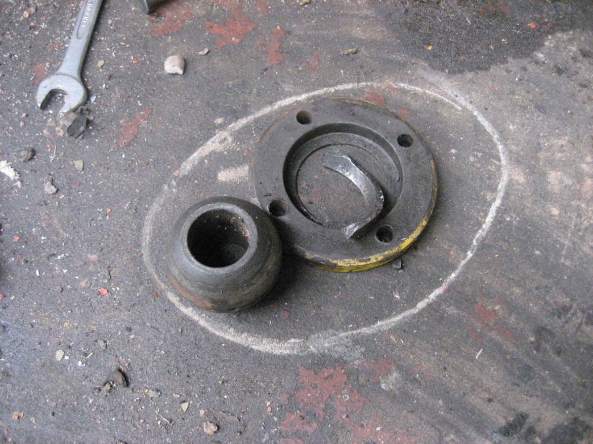

little bar stewards to separate/extract too ... even with full w/shop facilities ... way easier with the skip off too (y)
had to 'jack' / press the pins out.
failed find a new lower bearing for this un, so machined new seats, hardened 'em with an 'old black oil' quench, from cherry and stuck it back together - only an occasional use m/c ... customer happy to have it functional :)

was going to have to machine two new housings for their suggestion ... cut the originals out and replace with new housings/bearings - angular contact thrust spherical plain bearings - to be exact, from Timken, as quoted for ..... customer was much happier with my alternative idea of making some new seats for the existing ball, which was well serviceable and worked out a hell of a lot cheaper ....... last time I saw him ('bout 2 years ago), was still performing fine - as and when he occasionally used it :giggle::giggle:
bearing in question's spec is in the other PDF .... and a rough sketch of what I was after / trying to replace from Antifriction (amongst others)
