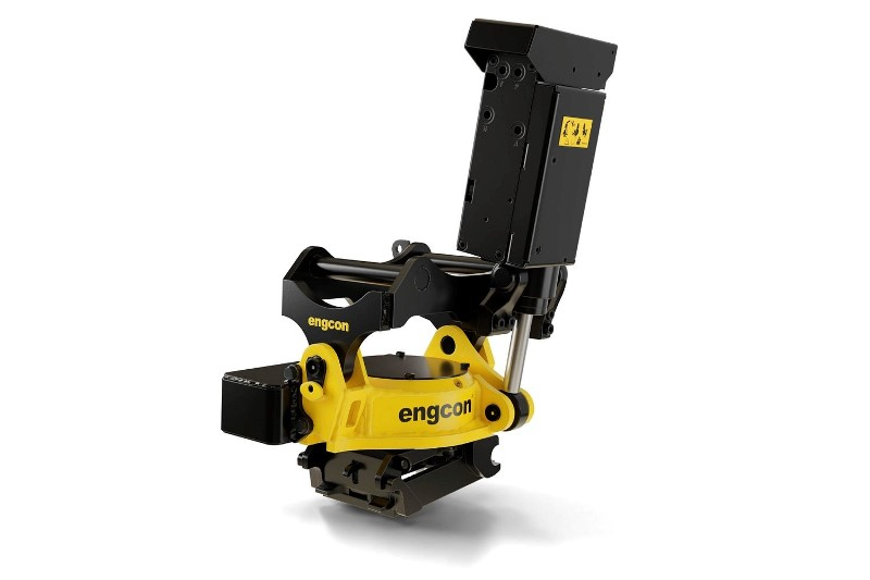

" The new Engcon EC02 Basic product offers tilt and rotate functionality for attachments on mini-excavators.
Competing products include the Rototilt RC1, designed for mini excavators and small machines weighing between 1.5 tonnes and 3.5 tonnes. ....... The EC02 Basic tiltrotator weighs 78kg and is 435 mm long with a build height from 245 mm. "
only 40 degs of tilt though -- and Lil' jake'd know it was on there for sure

What do they normally tilt at? I didn't think it was much more than 40degs anyway? Wonder what they cost.
78kg doesn't sound too bad I don't think especially if fitting it direct with out a top hitch🤔

Bigger models might tilt to 45 degrees- not much in it.
This looks like a stripped down version of an ec02. Manual hitch and no through ports or control system. They’ve saved around 15kg- not really enough to worry about. However, I think this is just what the market needs- if the price is right!
Half the price apparently. Half the price of what, who knows?

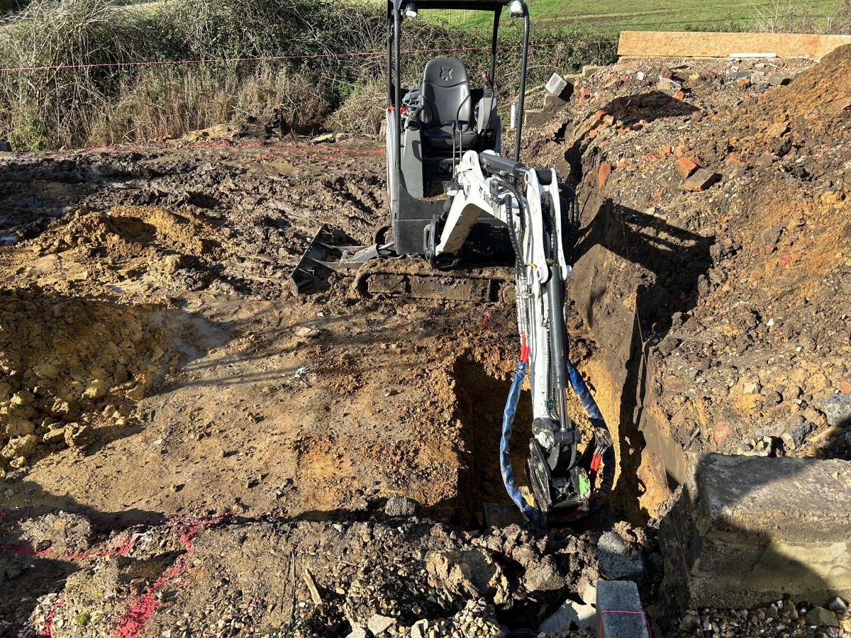

I have my ec02 on an e19, with a top hitch too. It’s not quite ‘you don’t know it’s on there’ but it all feels balanced and plays nicely.

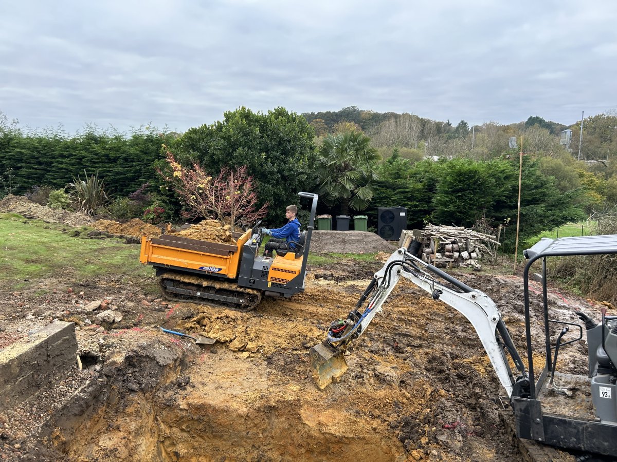

Pic of Druids 801 against Doobins far superior (as he constantly reminds us) E19
The 801 hasn't depreciated in the last 15 years - the E19 is still working its way down there 🤑
