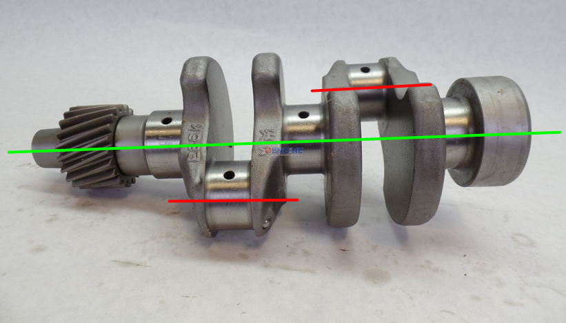

The air/oil mist up the pushrod tubes was very pronounced. I needed to find a pic of the crankshaft to see if this is normal:

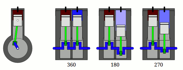

Back to basics:
A 4st engine fires each cylinder every two revolutions. This is easy to imagine for a cylinder, but with a twin, you have options.
There are various crank angles the second cylinder can be added. Commonly 180, 270 and 360 degrees are used.
Yours looks like this, so it's 180deg separation.
With one piston going up and one going down, there should be no net change to the crankcase volume and therefore you should no be seeing any significant pumping. All that mist suggests you are getting significant blowby past the piston rings (or worse).
Back to basics:

What engine runs a 270 deg crank on a 2 cylinder? unless it’s inclined block of course.
A surprising number of bikes run a 270° crank - from Triumph to Rotax powered BMW's and most of the Japanese brands.
There are some other 'non-traditional' cranks around too like the Husqvarna Nuda 900 which runs a 45° (or 315°) and KTM do a 75° crank'
There are a number of reasons a 'non-traditional' may be used - the first is engine balance. Basically a 360° crank is just two singles stuck together and has the same vibration problems (but twice as often).
180° twins balance better, but tend to be "buzzy", particularly at certain revs.
Last, but not least, they have a distinctive note!
Back to basics:
ok i think i get what your saying. So worn rings may be letting the combustion escape. What could be the "or worse"?
