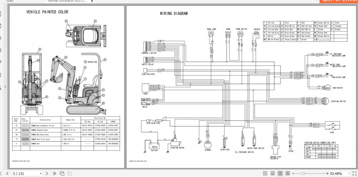

been sent this diagram that shows a couple relays that could affect starting... how would i test a relay to know if its doing its job?
it also shows the slow-blow fuse on this diagram that i mentioned previously.. unfortunately it does not show the actual locations in regards to where it is on the machine. My manual seemed to give me the wrong location for the slow-blow fuse strangely, but it lists it as a cause for non-starting in the troubleshooting section. need to find that effing thing!

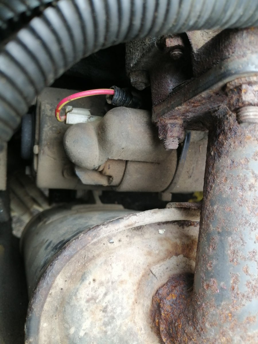

unfortunately they put this thing together i don't think i can get to the starter to remove it.I think as you said the engine was running poorly, maybe starter isn't the issue. But if you do decide it's worth a look it's not to difficult to remove, strip down and clean. Check to see if brushes have worn. This video is helpful. Sorry it's in Dutch!

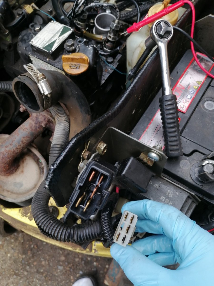

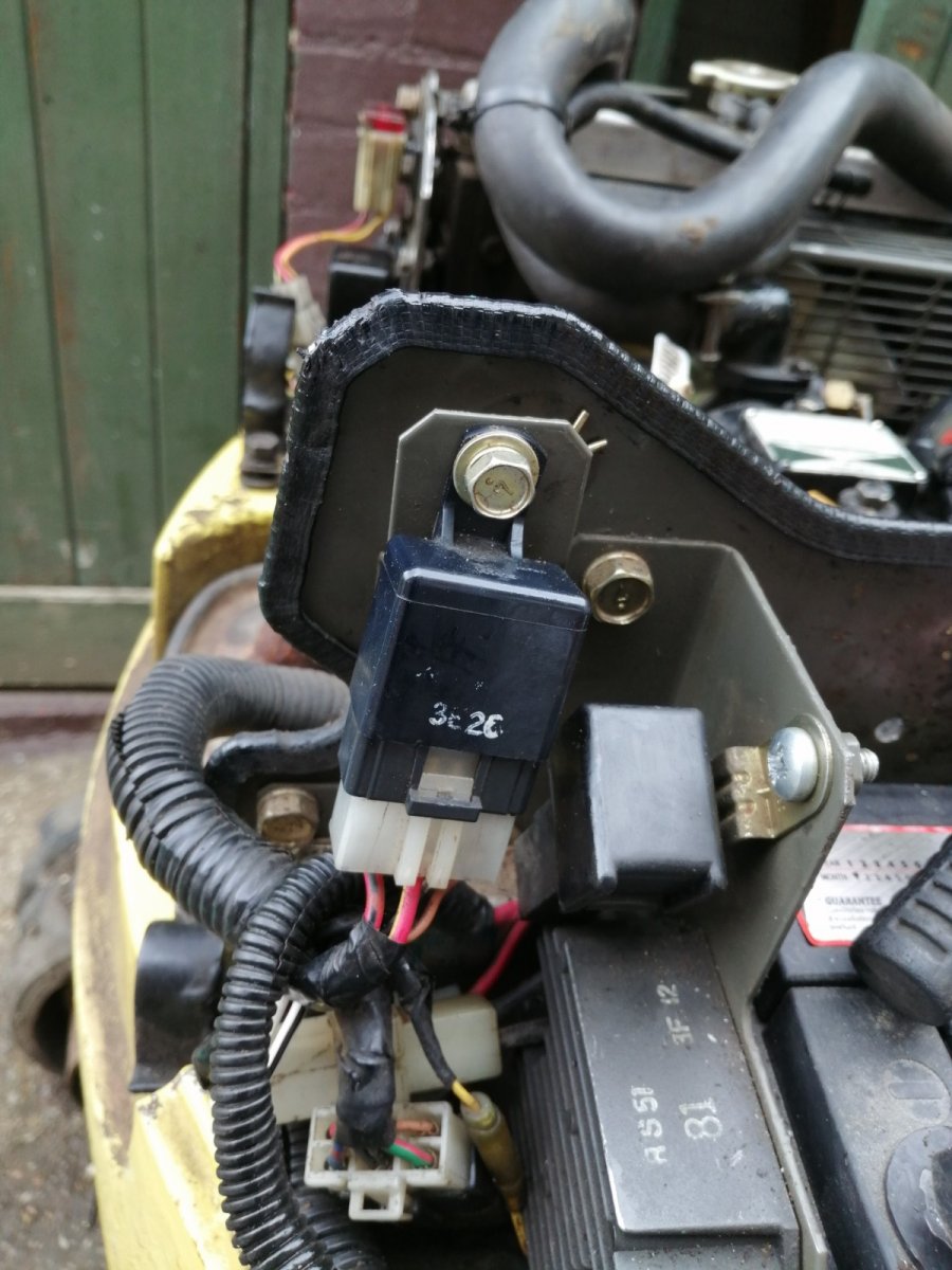

Nogoing back to the relays... if one of these were thought to be faulty, would this simulate the "heavy breathing"?

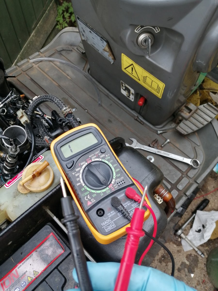

was having a look at these just now and i'm not sure how to test these. Example of one of them below and the meter i have:

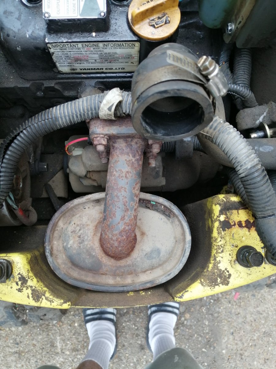

bitch indeed. Taken off all the panels that are removeable. But that back yellow part of the machine is part of the chassis. Awfully inconvenient.No
exhaust /starter looks a bitch![]()
