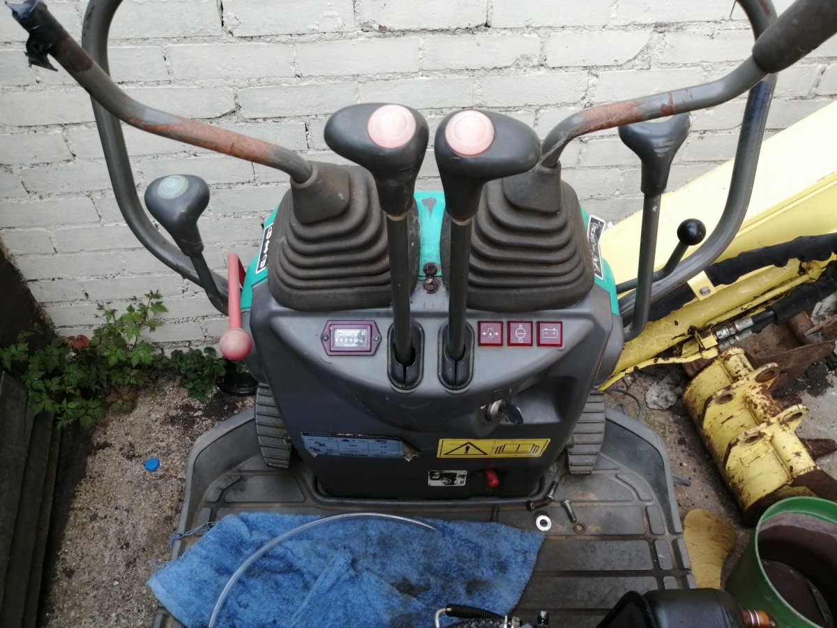

ade033
I have seen many of these little machines over the years and I can tell you without a shadow of a doubt it will be the breaker pedal on the floor plate that is stuck in the slighting ‘on’ position. It catches everyone out with starting issues. It puts a load on the hydraulic pump when cranking and gives the problem you describe. Other people have mentioned it before on this thread but nothing has really been said about it. Check it and double check it, I’m sure you will find this to be your problem if the machine was working ok before this fault.
