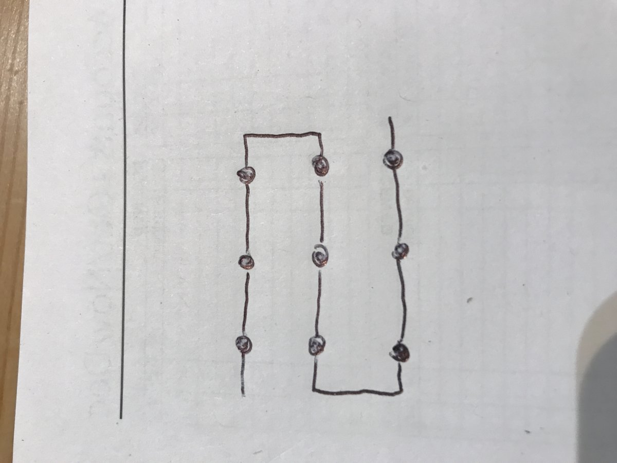

Tried with the duck........ no use can’t get a sharp bend where I need it also got to repeat it several times
Then welded a piece of channel to a 3m plate of steel and tried to press it with my blade (no use) grading beam(not tight enough)
This is the shape I want to achieve
I have 20 sheets of mesh 2.4x4.8 so want to use what I have👍 plus I do like a challenge 🤔🤣🤣

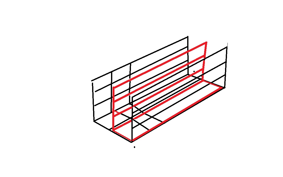

:oops::oops: you'd need some pretty special tooling to achieve that in a press brake .....
usual rule of thumb is you struggle to bend deeper than it is wide in the U if you follow me .....
could be done with swan neck tooling, but'd be sooome offset on the neck .....
who the hell came up with that shape Mog?????......
could bend two Ls and a Z and wire it together ... it's buried in conc anyway:rolleyes:
I came up with it😳🤔 as I need 9 bars running around the perimeter of the slab🤔 and thought this would keep all the bars spaced evenly and make them ridgid so easier to place and fix, might be a bit tricky to form though😳🤣🤣

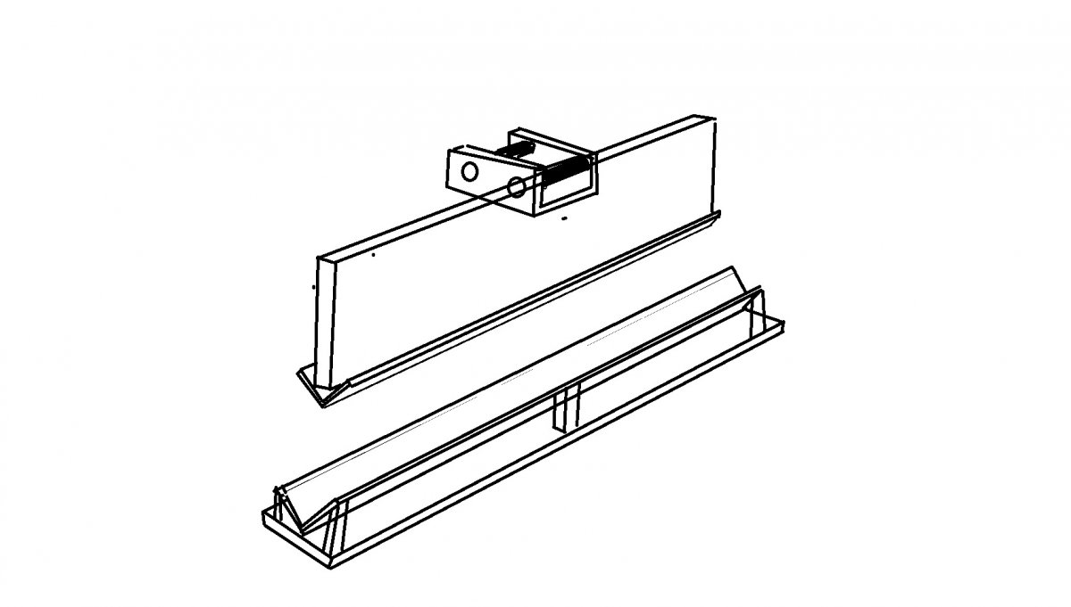

A single u shape is possible form a 90 with blade/beam and bucket combo and then ig you have a beam or similar the height you want the two layers apart just fold it down over it. I guess if you needed to hold the beam you could weld a couple of lengths of box to it to sit the blade on from far enough back. Then just make another to lay on top. It's probably doable to fold back on itself if you could space everything apart etc but probs cost more in time than the mesh saving.

bend a U and an L Mog .... wire the L in the U

yes but remember .... doing it deeper than it is wide is a swan neck job .... my U is equal width/height and the L is the same height as the U ... job done and will have finished it by the time you've pee-ed about and got a quarter of it done in one piece :p:giggle:

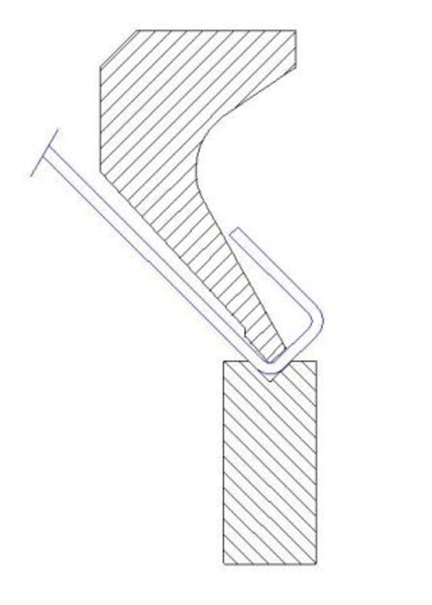

there yer go @Mogman ... i'm sure your 'stock yard' will have summat suitable kicking about :giggle:

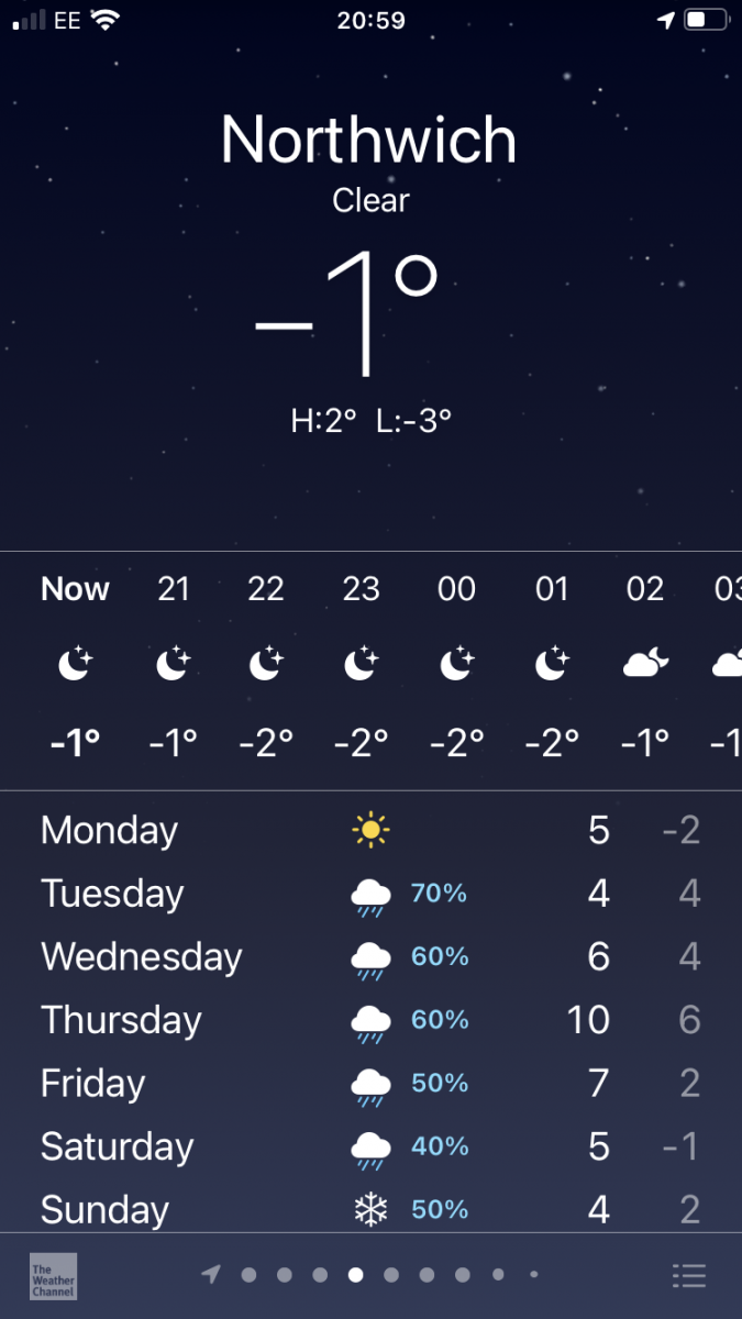

I’ve already got everything I need to build something 👍 even got it cut😉 just need a dry day to weld it up as the MIG in the scrapyard is not working so will have to use mine which means outside welding as need to bend the mesh to put in the floor to sit my shed on🤔😪
Sunny tomorrow - crack on!!!
