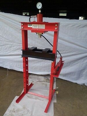

This looks a good spec for the money:
Everyone says 20t is a minimum really so surprised you recommend a 10t? 20t are around £500 but it's a purchase for life so the oen above doesn't seem too bad value especialyl as you can offset the ram which I would have thought is a must have?

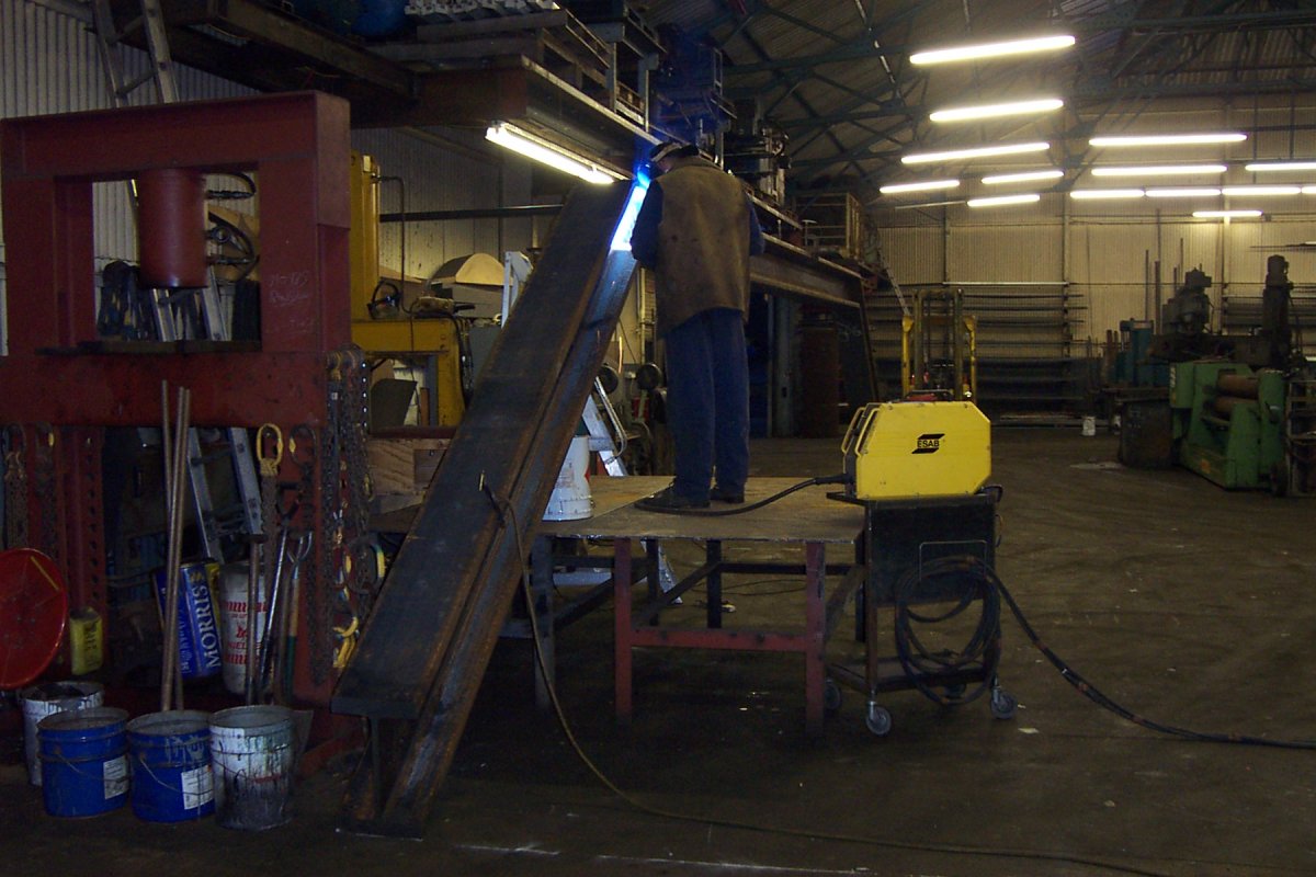

still looking for a couple of good pix of mine ... but can see 'em in the background here
I do have a couple of decent pix of 'em ...................... somewhere??
looks decent enough that
Just got one of these and tbf it's ok for what we need. For that money you couldn't hardly make one.

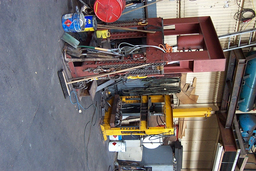

Yep looks good for the price. We have a 50T Churchill press with two speed hand pump, very handy. We also have a 150T frame press with big pump motor and lever operation, she's a bit tricky to control and hardly gets used. I'd go as far as say not been used in last 3years.
got it
you can't see the power pack between them but a big pack .... trick to controlling 'em smoothly is a decent length to the levers ... too short and they're very hard to inch ... had my levers, which were 12" long, just above the knee so's you can rest yer hand on yer leg and inch 'em with a finger ... could get miniscule movement with them.

yes Mog ...... used to make a a few too, for other people ... sold 'em to a local customer, who's a mate, so can always get at 'em :giggle: .... binned a couple of really nice power packs in my clear out ......... which as usual, have regretted since :(
