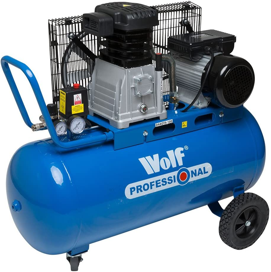

bought one of these a while ago .... but mine is red .... makes a big difference in performance ;):giggle:
was just over 200 quid when I pressed the trigger ......
has been very good for all my air requirements ...
tyres, die grinder, blaster, etc. 90 ltr tank and very often plug my air bottle in too, if i want a bigger reservoir (30+ ltr ex-propane bottle) and also have 47kg bottle I use for air too, if that's not enough .. again just plug it in and tandem them up
That seems to be a good compressor, made in OZ apparently.
The original post talked about choosing a direct drive. DD are light and portable but extremely noisy and the CFM is marginal, good for nail guns or pump up tyres.
Belt driven are slower and use bigger pumps.
One thing I observed is that compressor suppliers, quote the free to air performance of a compressor with some free poetic license.
The table that list the CFM requirements of a tool don't help either.
The free to air volume quoted by manufacturers, is taken from the volume of the pump and the revs it spins. Rather deceiving since the resistance of the compression is not taken into account. From experience, if you need 10 CFM for a tool, make sure your compressor can deliver at least 50% more. Worse tools for air consumption are grinders and spray paint guns. Tyres can be pumped up with just about any hobby compressor if you have time to wait ... don't advocate to pump up your tractor rear tyre with a 4wd 12v compressor, but it is theoretically possible.
Good quality compressor manufacturers, have a hard time competing with the chinese onslaught, exception perhaps the Italians. Chinese compressor pumps are everywhere and their quality is variable to put it mildly. Italian pumps are better.
With compressors that are not intended to be portable, bigger is better, and watch the power supply. Compressor motors don't do well with power restrictions. a supply cable that is 4 mm2 for single phase 240V would be ideal.
As for the popular wisdom that says don't use an extension ... well ... yes, if you buy your extension at Kmart.
An extension is just more cable. The workshop or house cabling can be very long depending how it is built. So, if you have a short extension with properly rated cable, plugged in the powerpoint your electrician built in the main switch board, is not the same than having a 30 meter long extension with 1mm2 cable plugged in your bedroom powerpoint.
I run a 280 amp MIG welder off a 20 meter extension with no problems at all. I built the extension with industrial 32A plugs and 6 mm2 rubber insulated cable. The mig itself has a 10 meter 6 mm2 lead. ;)

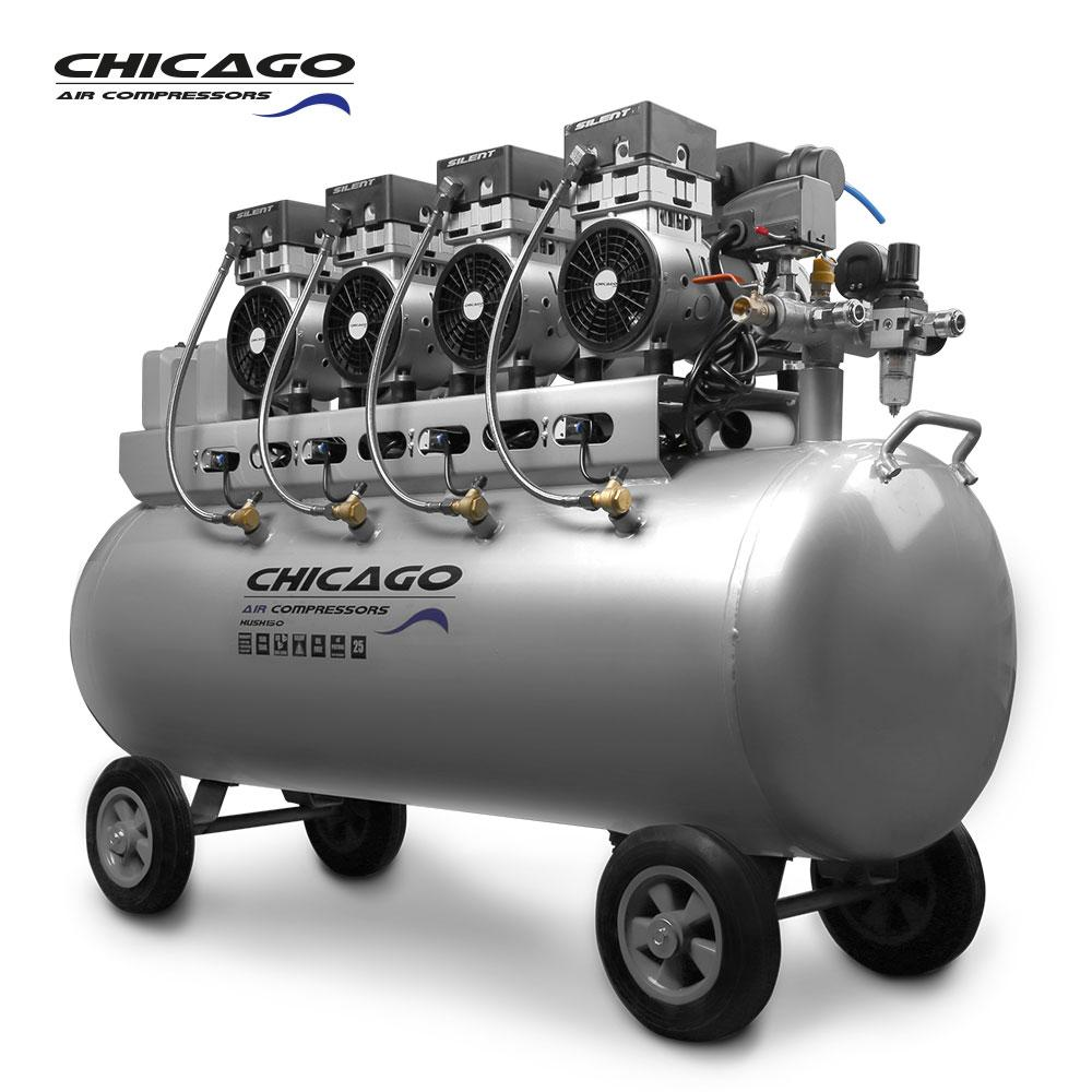

I got bored online one day and bought a compressor from euros . Random Chinese brand not recognised no belts too :) has 3 motors on top 150 litres. Works a treat 😂 lucky though as I really bought blind and it was £350. It’s dead silent
T
Tacitus
A silent compressor with multiple pumps. It's the new thing. I alway wondered how they perform.Something like this?:

Just an oil less little piston compressor, with a 4 pole motor. Screw compressor are still very expensive
T
Tacitus
You can make any compressor silent by building a box for it and suppress the ruckus, or you can make one that does not make noise.
This little things started their life in dentist surgeries and used to be very expensive. Lately they are everywhere and at very competitive prices. They achieve little noise by using light component with reduced friction and reed valves. What I don’t know is how long can they keep up their act.
Gecko
Gecko
has 3 motors on top
Having seen these in action, I formed the opinion that if you bought a different style, you'd need a pretty convincing reason (upto about 12Hp at least).
After using direct-drive piston type, I was blown away by how quiet they are. Any one know what type of pump they are? I'm assuming they are a scroll pump, but don't have anything to base that on.
bigger version of what runs the air suspension on the P38 then

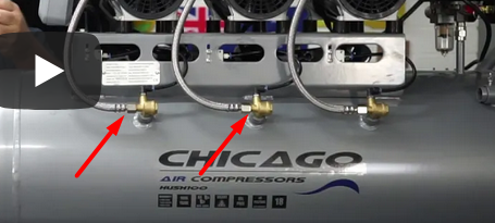

Here is one with 3 pair of pumps in action. Not silent but way better than a traditional compressor. I dare to say that side by side, an ordinary compressor will most likely outlive this oil less silent one by a factor of 5 to one or more. Too many moving parts with no lubrication to go wrong. Only a guess.
However, anyone with a home workshop knows the problem of compressor noise.
This is a quick solution.
Building a soundproof enclosure for the compressor is probably cheaper if you can do it yourself, and likely to outlast this little marvels.

I've got one of those silent compressors and it works brilliantly if a little slowly, I've killed cheap compressors and 2 Makita ones but this one seems to be holding up well it doesn't make noises like it's trying to explode like the cheap ones do. the only thing I wished is that the pumps started one after the other a lighting tower didn't like the startup of 2 motors at the same time so I added a switch to one😉
