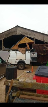

Popped the roof tent up and stuck the fan inside it for a bit of an airing, great weather for it for February ๐Ÿ‘Œ

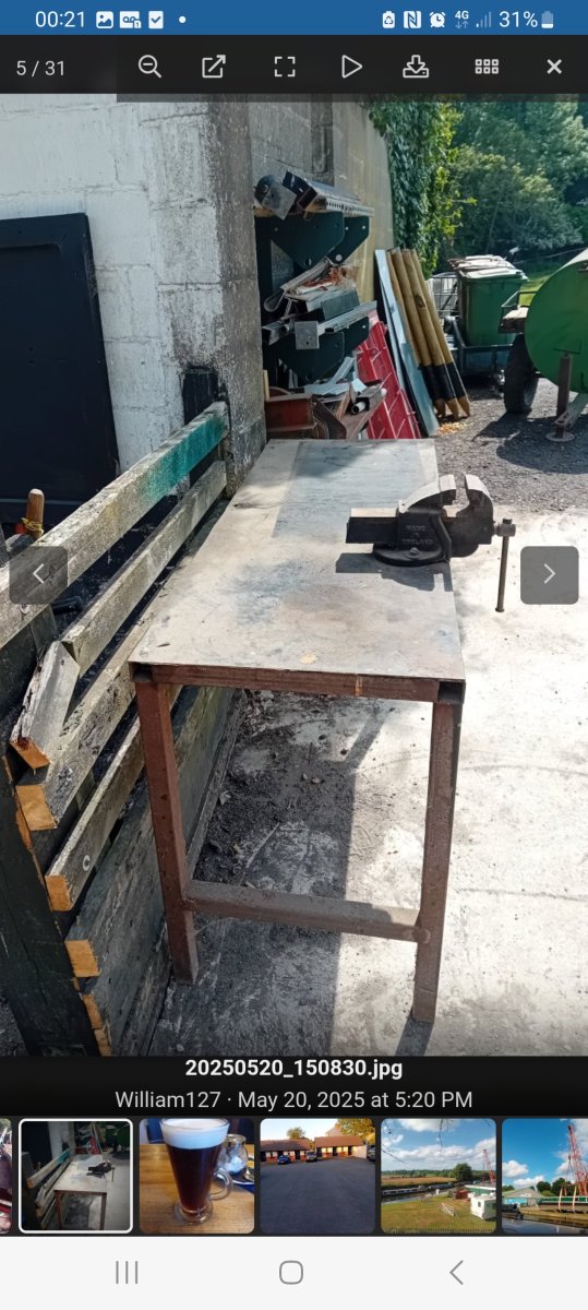

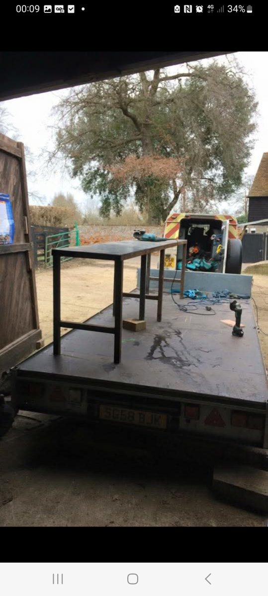

According to Facebook it was 9 years ago i picked up this ebay bargain ๐Ÿ˜€
Bench was something like 11ft long, won it for about 21 quid, including the vice๐Ÿ‘Œ Think the size of it put people off, hard to collect, heavy to handle etc. I just pulled alongside it and rolled it on, then cut it in half on the trailer.
Had them both in various places but after a few years they became glorified shelves. Moved the one with the vice outside and its had way more use. Sold the other one for 30 quid ๐Ÿ˜†๐Ÿ‘๐Ÿ‘

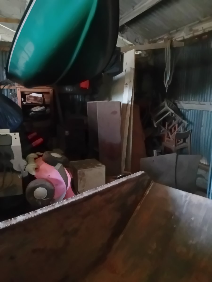

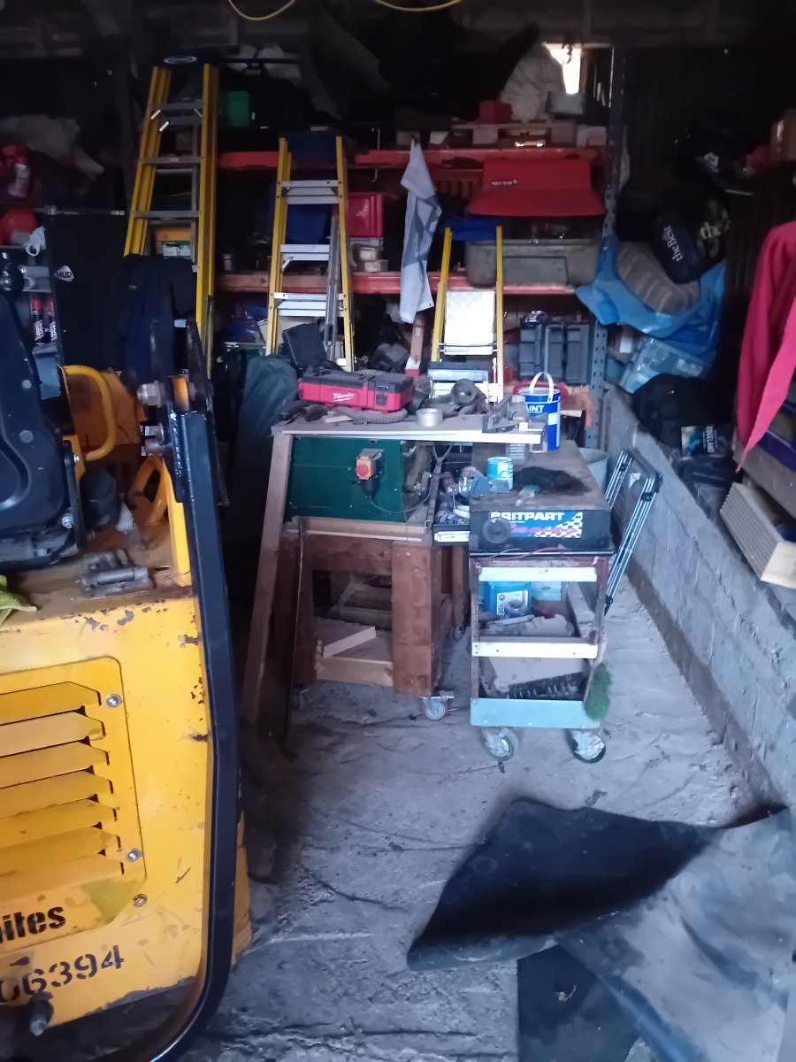

Decided to have a bit of a change round in this corner of the shed. Basically halving the space taken up by the owners sons utter junk- the old chairs and bits of furniture etc ๐Ÿ˜† Been in there 15+ years, it's never going to have anything done with it but obviously it's not mine to throw away ๐Ÿ˜’
Now it's moved I can concrete another couple of meters and push a couple of things further out, giving me far more usable space than I'm actually concreting ๐Ÿ‘Œ
Between that, and emptying the blue wheeled rack thing of wood as it was taking up far more space than it deserved, so I've pulled it out to get rid, I've made an absolute massive mess! Be worth it when it's done though ๐Ÿ˜†

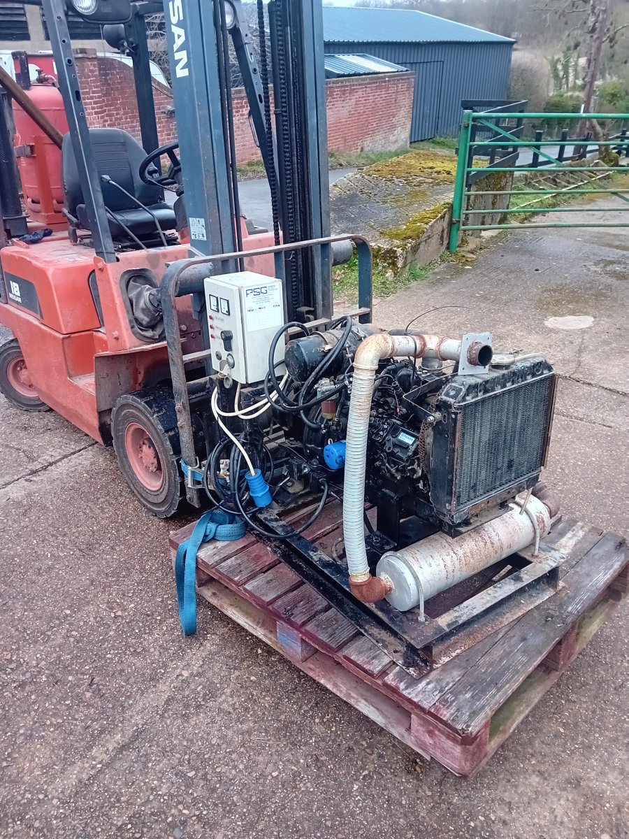

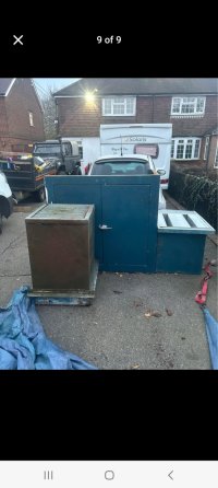

Had my eye on this for months- 6kva perkins engined genny. Came with an enclosure that I'm pretty sure would have been made by the guy I put enclosures in for, but at least 30 years ago so a bit before my time!
Been up for a while at a grand, dropped to 600 this week so I offered him 4, we met in the middle ๐Ÿ‘
Bit smaller than I want but I can't justify thousands just so I don't have to run an extension lead over the road every so often๐Ÿคฃ
Only 40 minutes away, took a winch and chains but had it on a couple of dollies and we pushed it straight up.
Got it home and had it running out of a can in about 20 minutes. Came with an oil filter so we did an oil change. There's no hours meter on it but if it's done more than 100 I'd be amazed ๐Ÿ‘Œ Old filter was like new and a genuine perkins. Air and fuel filters were spotless.
Seems to be all working, makes power, gauges work, glow plugs work, warning light works, charge alternator works.
Wrapped up the leads and fuel lines and started modifying the canopy. Originally fitted in a corner so it's just 2 sides and a roof, I rummaged through the scrap pile and found a couple of suitable panels ๐Ÿ‘
Did 90% of the end panel, but ran out of cutting discs, and it was getting a bit late on a Sunday so called it a day ๐Ÿ‘

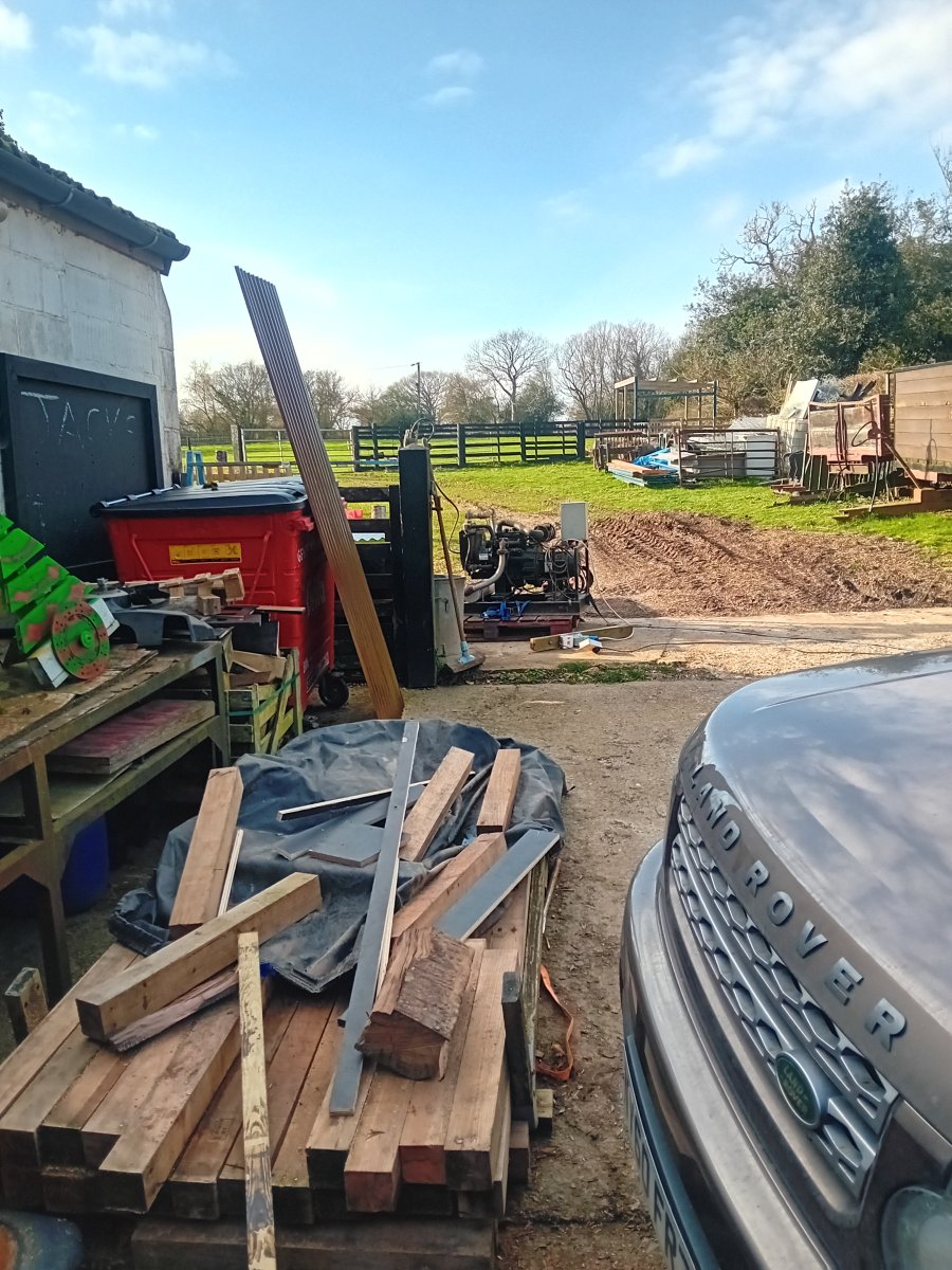

Bit of progress on the canopy today. Side panel virtually done, just needs a couple of plates and double up on some rivets ๐Ÿ‘
Generator working well, staring first turn despite the heath Robinson fuel supply. ๐Ÿ˜ฌ

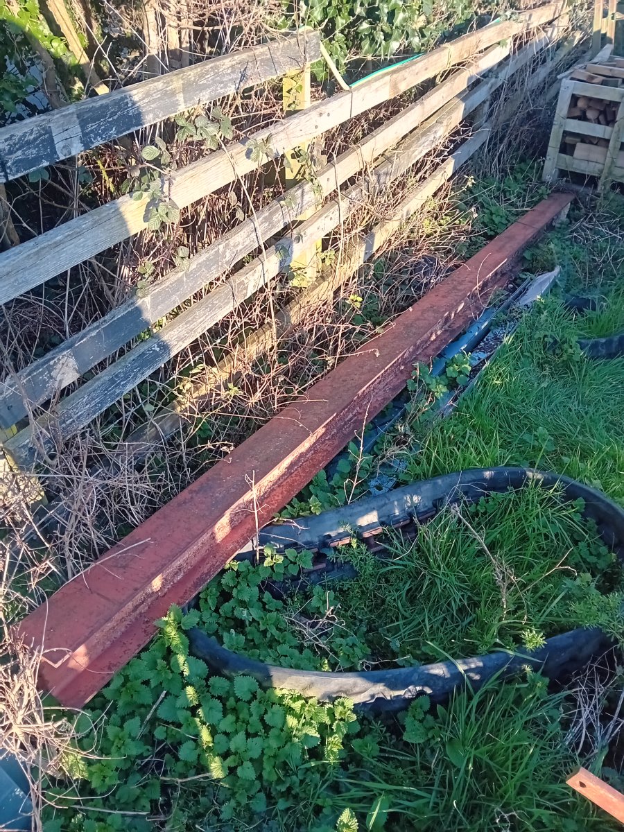

The last of my stock of RSJs is the perfect length to make a base frame but it's a bit overkill, might see if my mate has something a bit smaller he'll swap for it- he's collecting bits to build a mezzanine.๐Ÿ˜‰

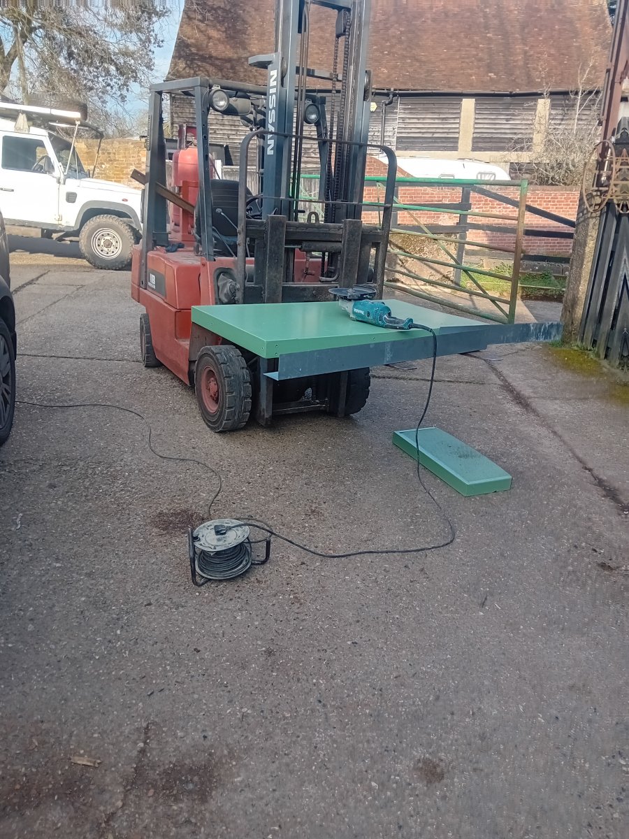

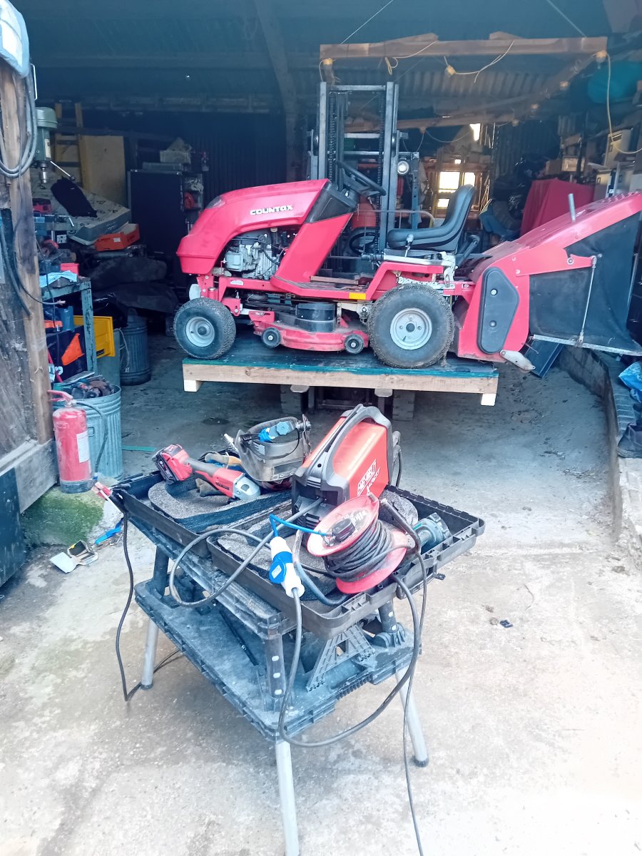

Forklift makes a great mobile work bench, but sometimes a pallet isn't big enough- like working on this ride on, became properly wedged. Knocked this up from bits lying around, works nicely. Needs a coat of paint but no time as I needed to work on the mower ๐Ÿ˜…
One made out of steel with ramp ends would be lovely, but I haven't got any channel/box laying around unfortunately. Would also take more than half an hour ๐Ÿ˜†

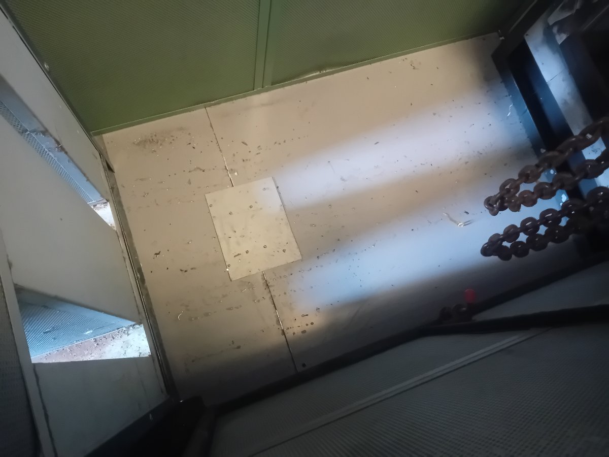

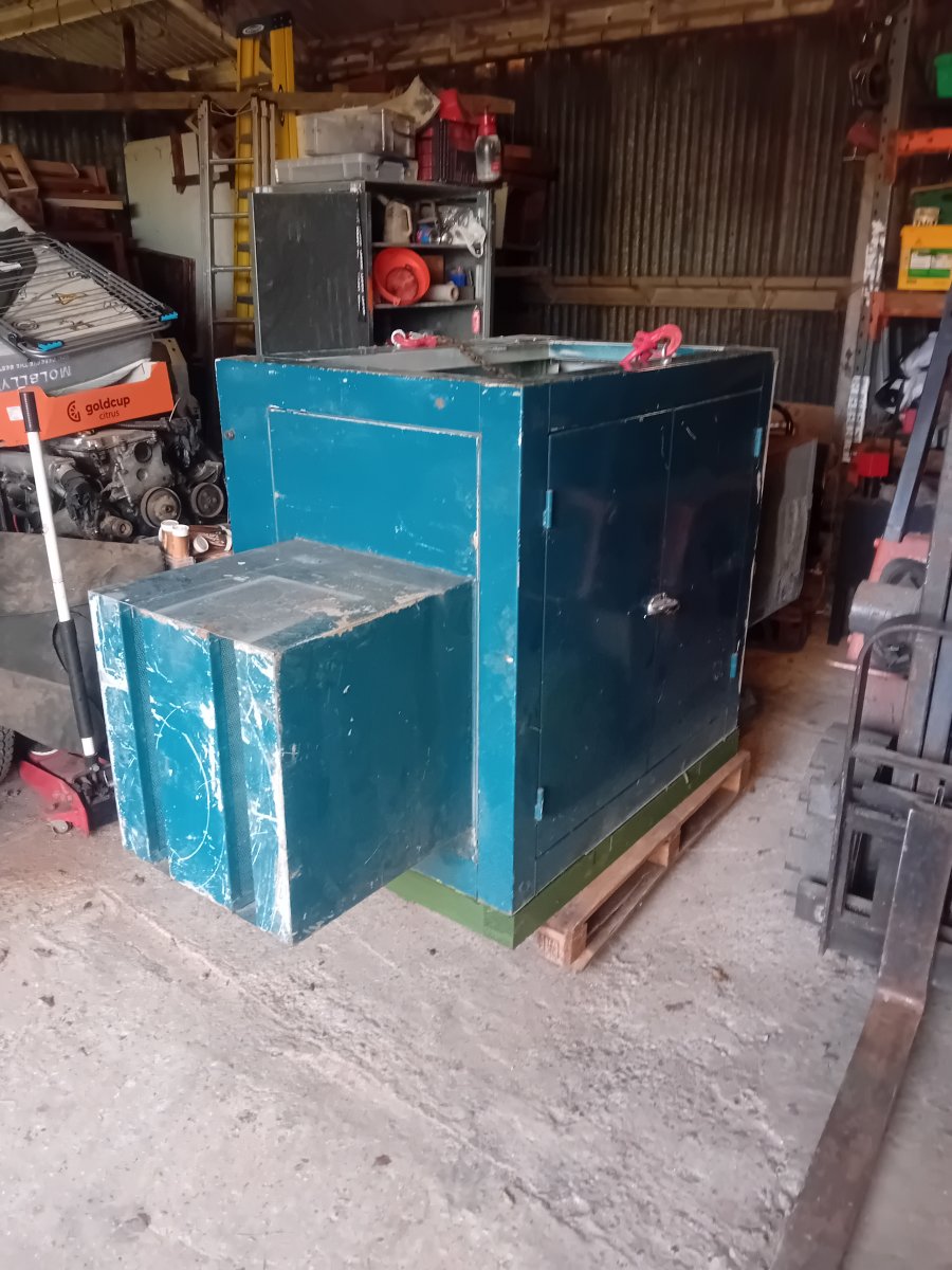

Plodding on with the generator enclosure.

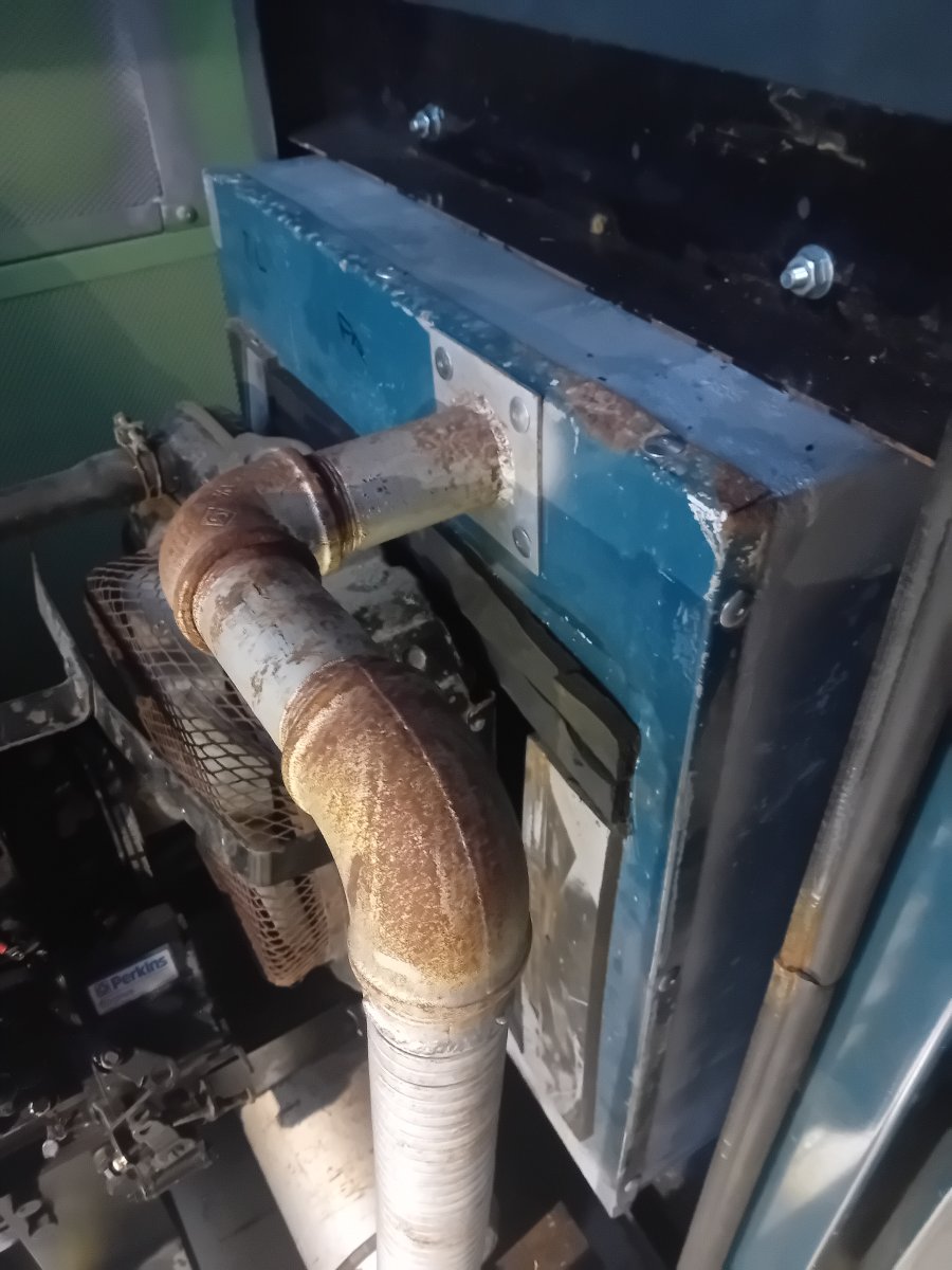

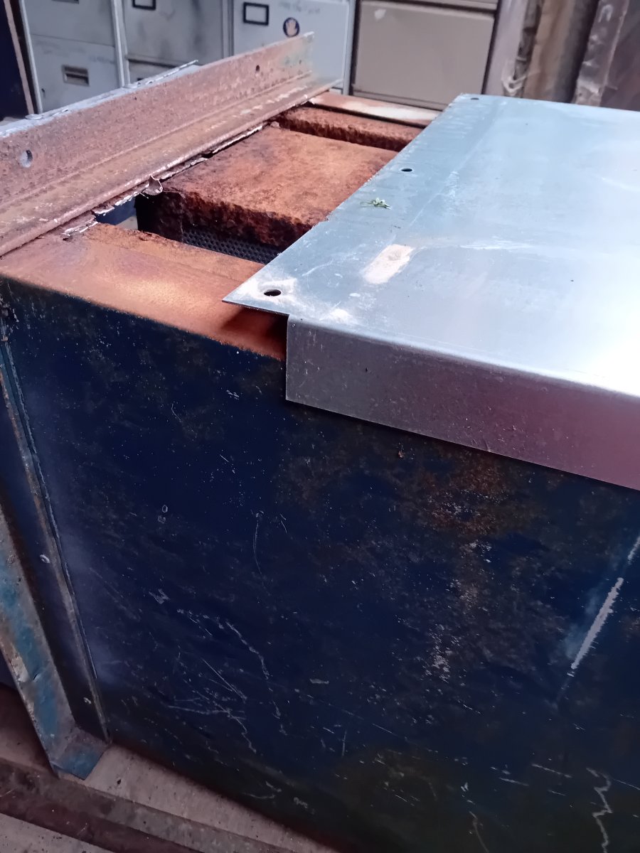

Chopped out some rust and plated over holes in the outlet attenuator, skinned over the bottom with a folded tray from the scrap pile- was just the right width, give or take a mil ๐Ÿ˜ฎ๐Ÿ‘Œ
Ran out of light, I need a source of electricity I reckon ๐Ÿ˜†

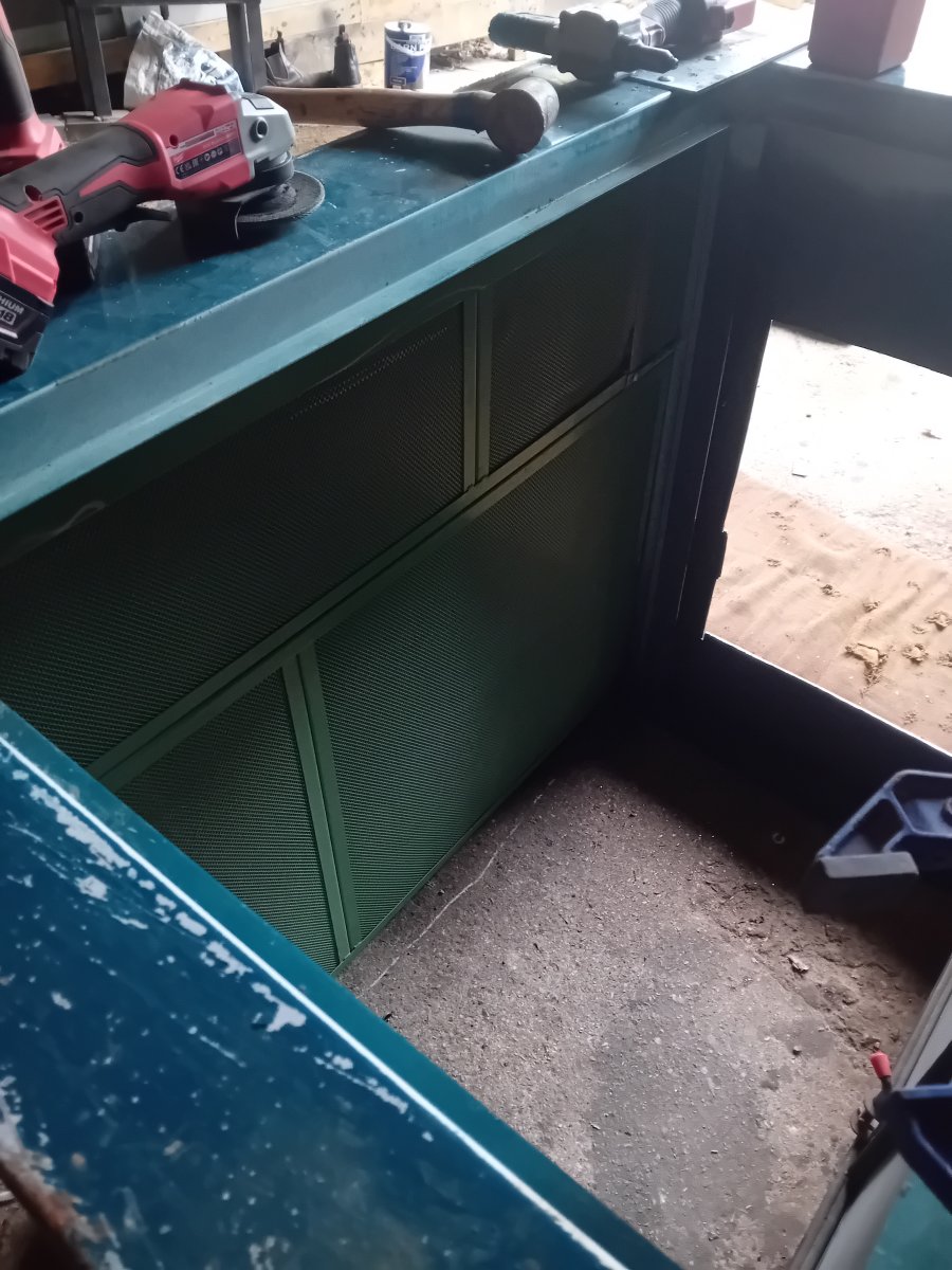

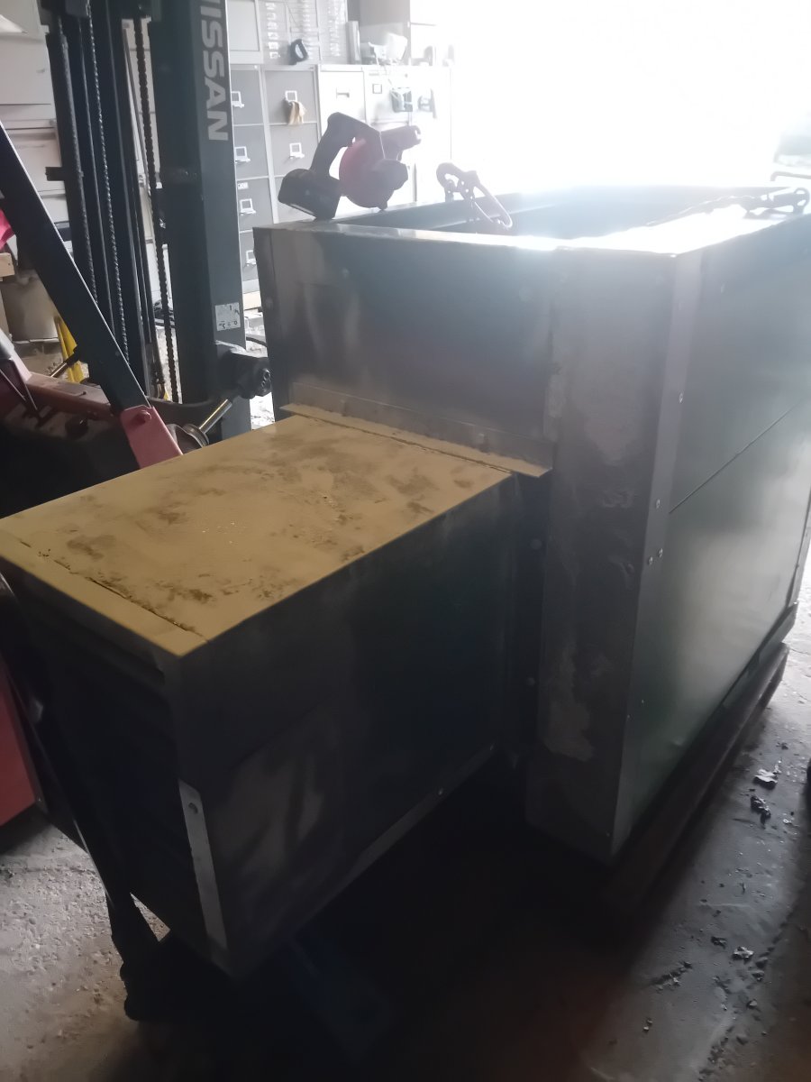

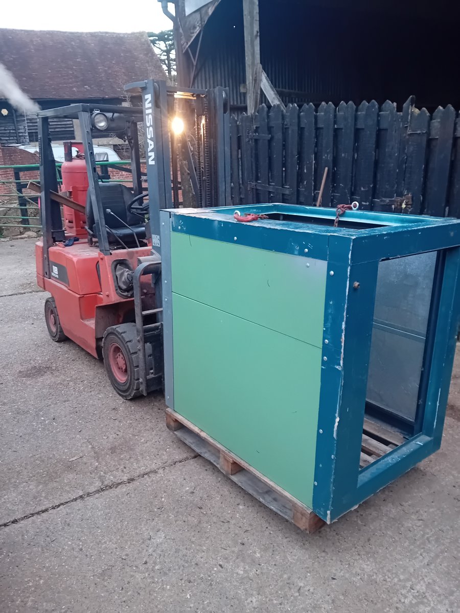

Bit more done to the generator canopy. Floor fitted, base frame made, outlet attenuator bolted on. Apart from a couple of little plates and masticing all round its ready for the generator to go in. Needs a coat of paint really, just to make it all one colour but I'm not sure it'll stick very well to the powder coat without a fair bit of rubbing down.

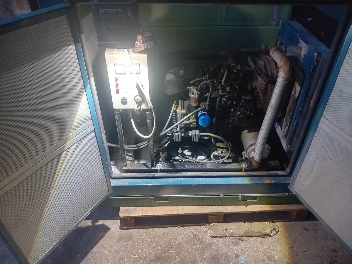

Generator in the canopy and screwed down, exhaust pipe riveted back in place so I must got the big hole in the end right ๐Ÿ˜ฌ
Just need to decide how to mount the fuel tank and battery now, run the cable through a gland, mastic it up and give it a coat of paint, then it can go outside in position ๐Ÿ‘Œ
