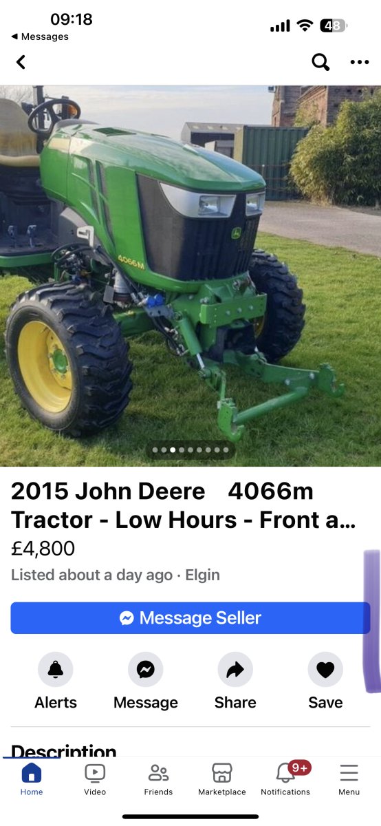

@doobin or Anyone who knows about them . Are these any good for my needs ?
What would it off been doing for the bonnet to be like that ?
It's been up for months. Possibly there's something wrong with it, but equally likely it's just that Iseki don't sell well secondhand despite being every bit as good as Kubota.
I'd offer him 2.5k cash, and at this stage I reckon he'd sell at around £2800.
