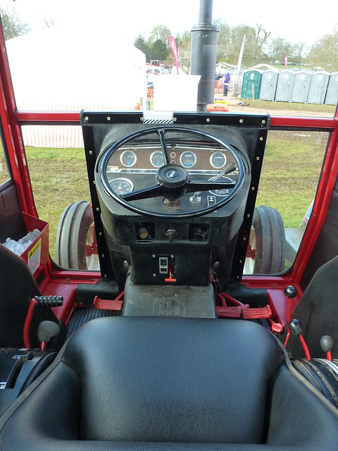

A 574 is the same size class as a MF165 etc, 354, 444, 454 would be more 135 size. Never got a shuttle box in an IH until the 85/95 series.
Small lever on left is 1,2,3,4. Big lever on left is High Forward, Low Forward and Reverse. So a total of 8 forward and 4 reverse.
