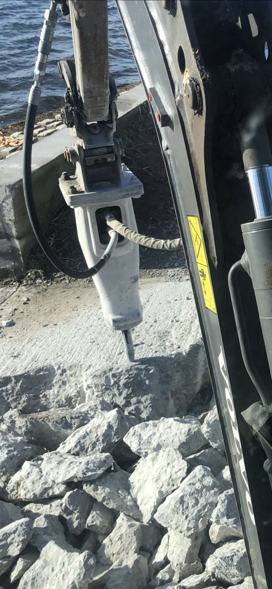

That’s my breaker , it says cat on it but I’m assuming it’s made by someone else . Any idea what it is ?
that'll be a tough one to side mount :unsure:
First thoughts looking at the photo, a plate sandwiched between the top mount and breaker turning 90 degrees down, with a low mount on, then a saddle against the breaker body at the bottom and a clamp around it.
The "silenced" breakers are already heavier thanks to the cast jacket they are in. Tbh if you want one with a breaker cup on imho you'd be better off starting with a steel framed hammer to begin with.
did wonder why they were in such a substantial cast jacket .... know sweet FA 'bout 'em
Does make a big difference to noise levels especially on smaller breakers although it also spoils smaller breakers for small spaces like trenches.
Does mine have a cast jacket ?
looks like it ... all organic looking smooth lines wrapped round the guts ...... but I know sod all about these things other than they go dat dat dat dat when they'm working ok :ROFLMAO::ROFLMAO:
