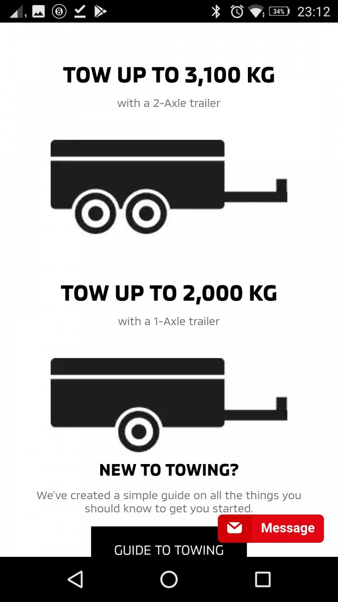

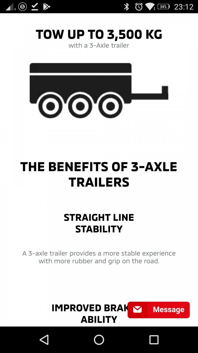

Also can’t figure the new L200 twin/tri axle towing differences. Surely there will only be one set of figures on the chassis plate!?
nah ..... just doesn't make sense :unsure::unsure:
Directly off their website plus they also say they have the best in class combined payload but that crown goes to the ssangyong musso

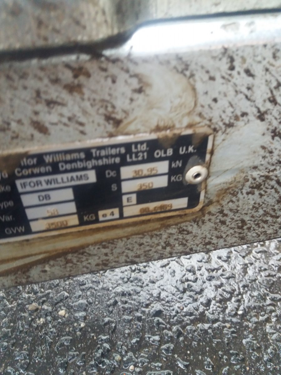

Ifor plant trailer 350kg nose weight
Jordan

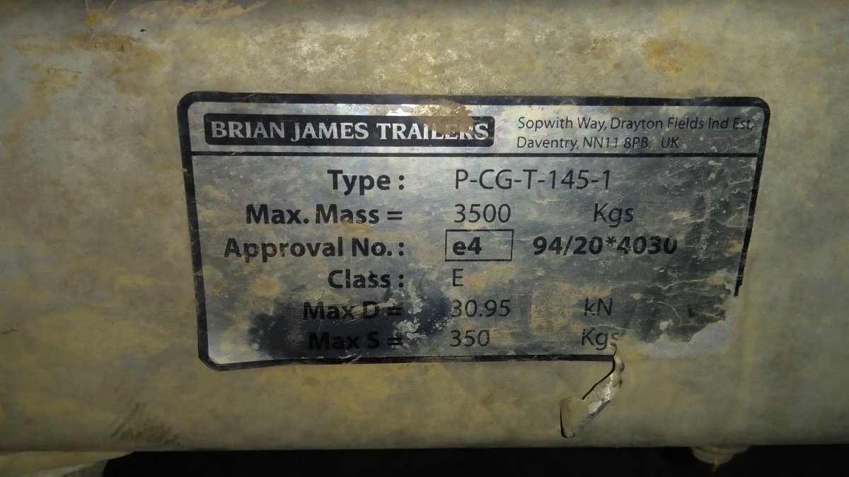

Just had a look at 3 Ifors here - the 2 new ones both have a nose weight of 10% of their gross (270kg and 350kg). The old 3.5 tonne tipper has an S figure of 150/350 - I don’t know why 2 numbers?
Jordan
that's the A frame/trailer plate - says the A frame is good for that ...... what's the actual coupling's plate saying??
The last one is the coupling (150/350), I didn’t look on the others but will later.
