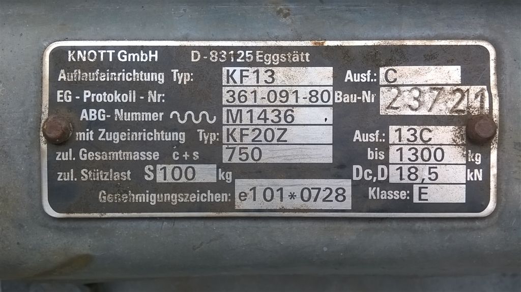

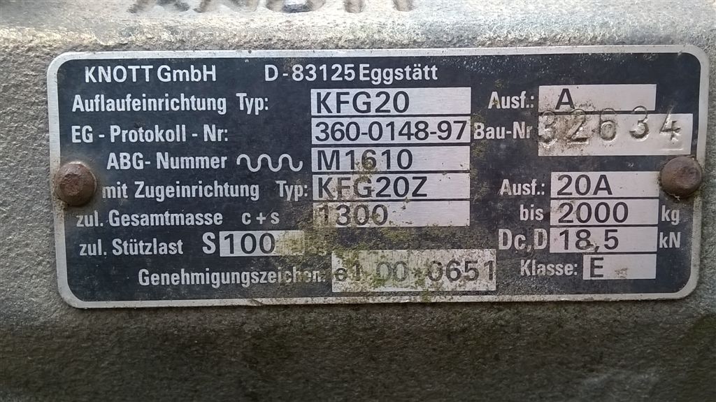

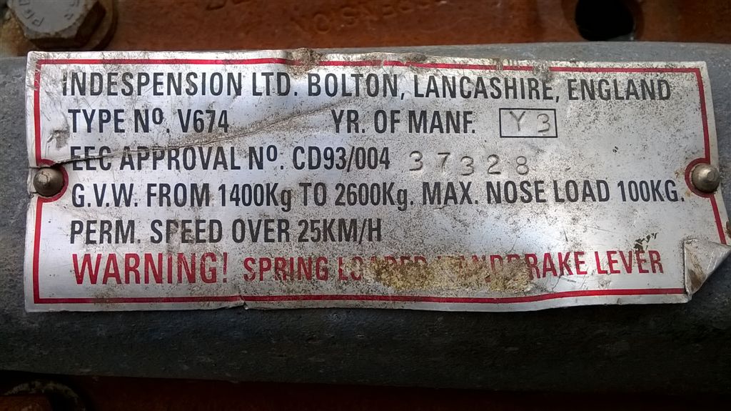

looked at the three I've got sat today for yers and all are plated "Max. nose weight 100KGs"
WP_20180913_17_29_28_Pro.jpg WP_20180913_17_30_02_Pro.jpg WP_20180913_17_30_37_Pro.jpg
the perceived wisdom / advice used to be ..... if you can't pick it off by hand ... (circa 50kgs) it's TOO heavy :( ...... and is still a very good rule of thumb ;)
As for plod policing this sort of stuff ... a traffic officer will always go for a dead cert. result and will still pull you for a tail/brake light out,etc. ... they don't wait for the DVSA to do it :rolleyes:
View attachment 1403 View attachment 1404 View attachment 1405
