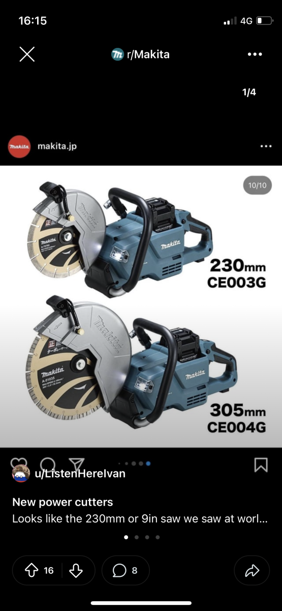

Saw these today not sure when they are coming. The 305mm will do 121mm cut which i thought was pretty decent. The 230mm will do 88mm

I wish milwaukee would double up on batteries instead of using the stupidly expensive ones for the larger gear

Impressive cut depth for a 300mm blade, makes the 350mm 80v version seem a bit pointless as it's only 127mm depth cut.
I actually bought the 230mm twin 18v version last week, been good so far.

I imagine the 80v is more aimed at power in harder applications rather than focusing on squeezing out cutting depth. Not sure id want one though they are big lumps.

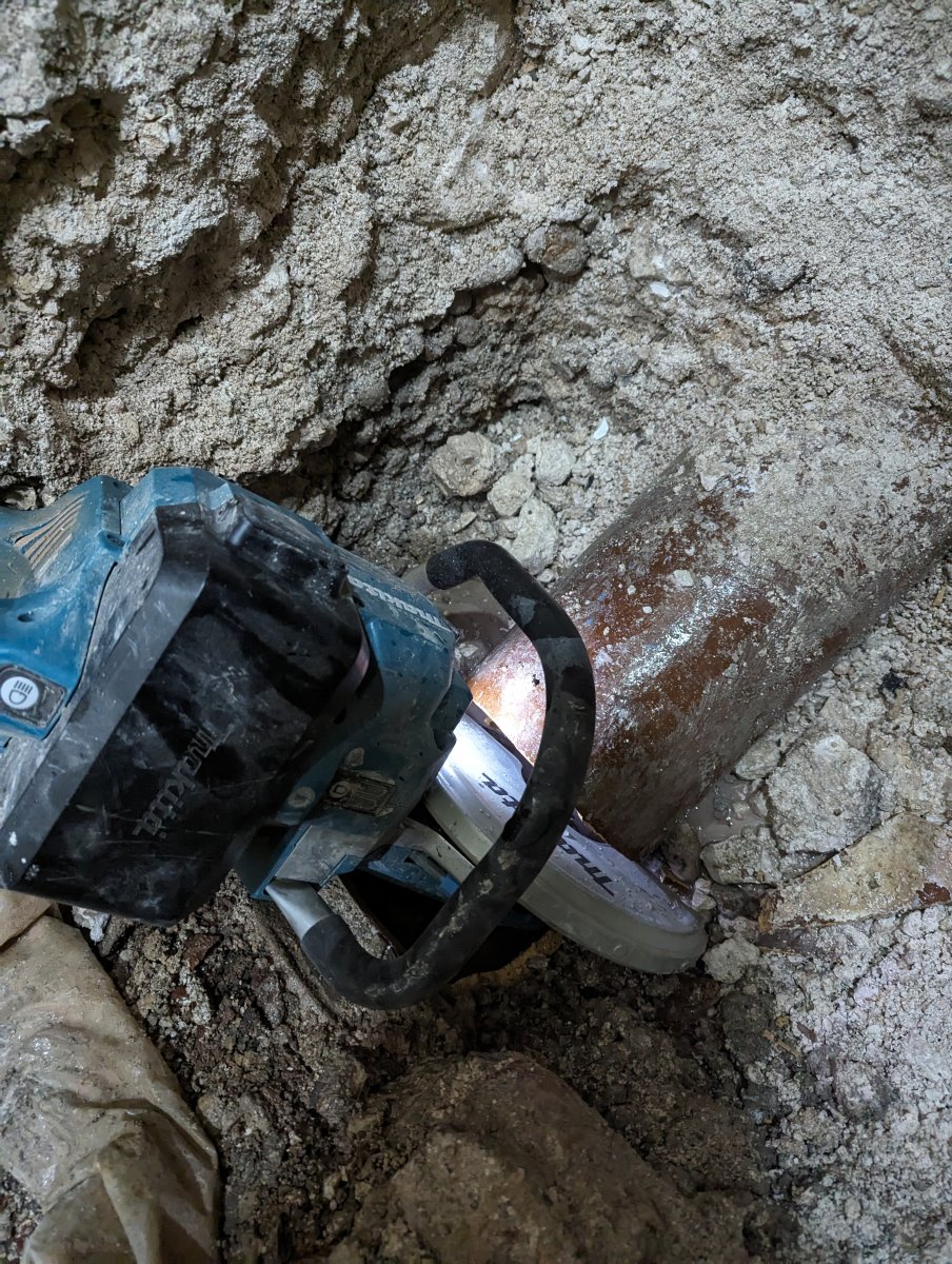

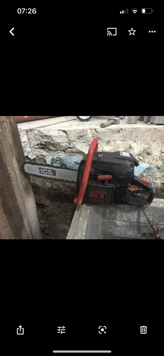

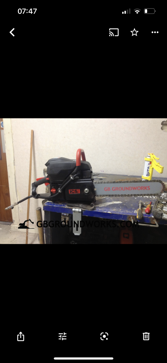

I have an Ics concrete chainsaw 18” bar can plunge cut big pip from above, mine 2 strike but they do a hydraulic one. Can get a blade for ducting metal as well for ductile pipe etc

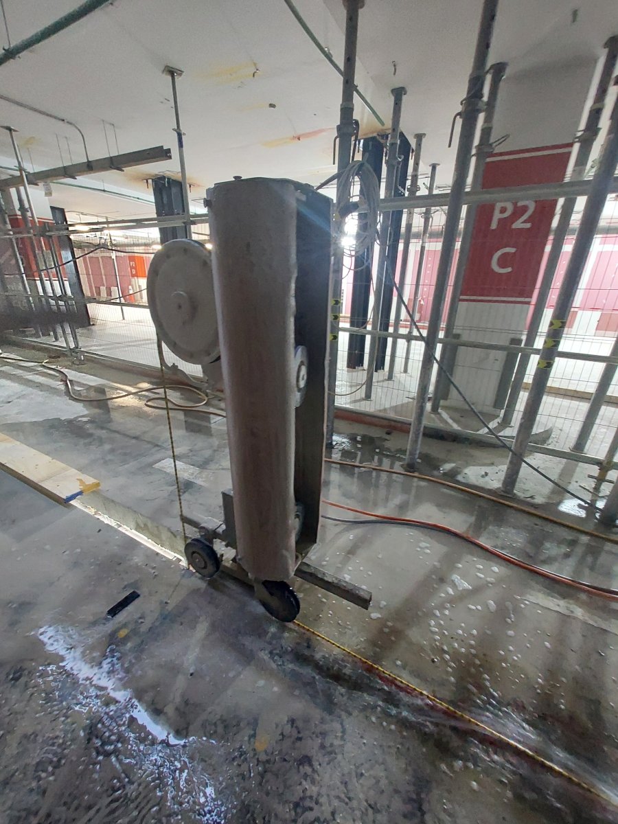

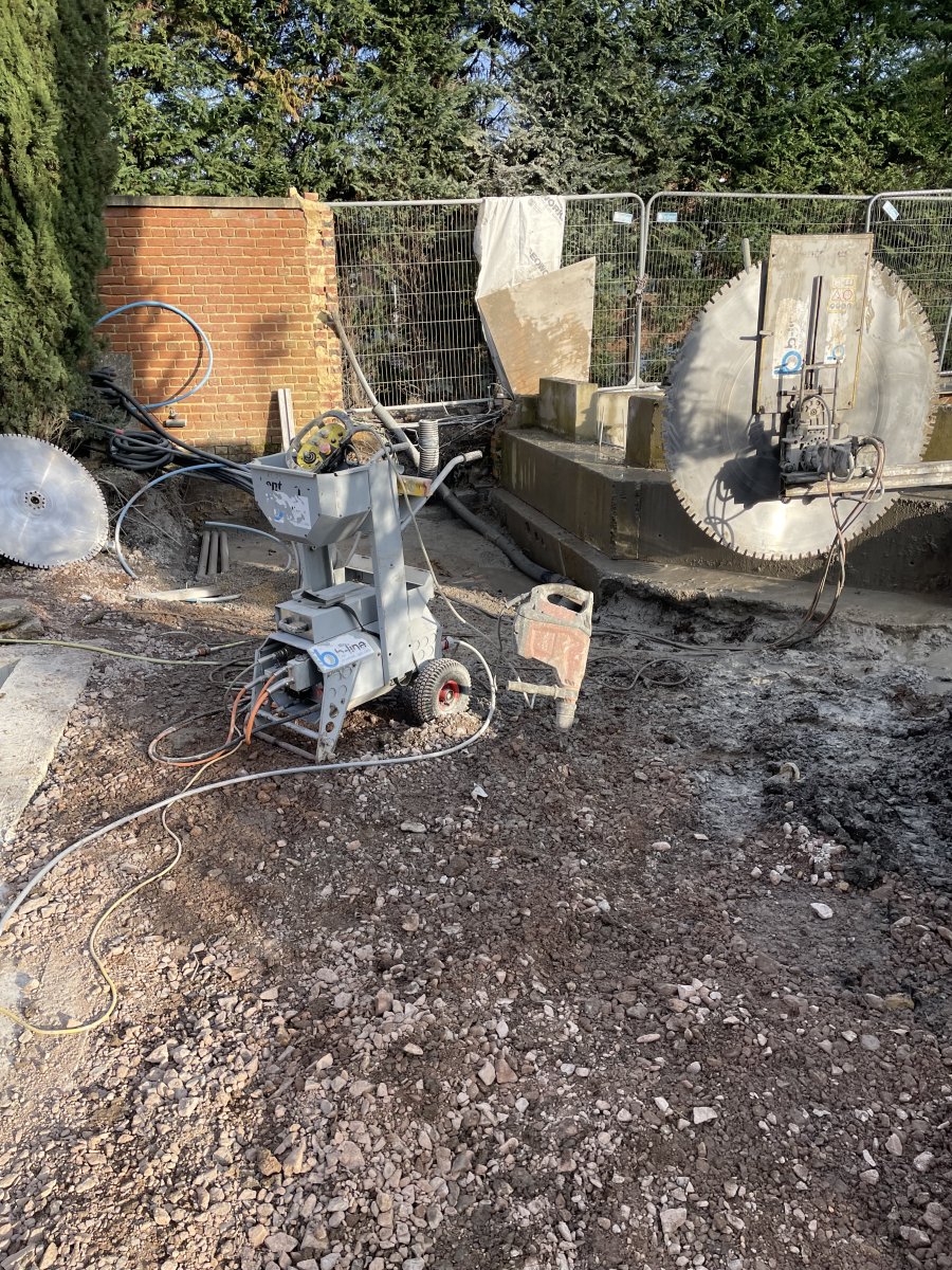

700mm too deep for a wall saw. Wire saw would be my suggestion. Drop a 20mm core in the corners and pull the wire, but not cheap. Chainsaws ok for small works but hard work if anything big
I mentioned this to them too, don't think they have a quote on it yet though.

I may well push them towards wire saw for the thickest walls and see if I can do the thinner ones myself.

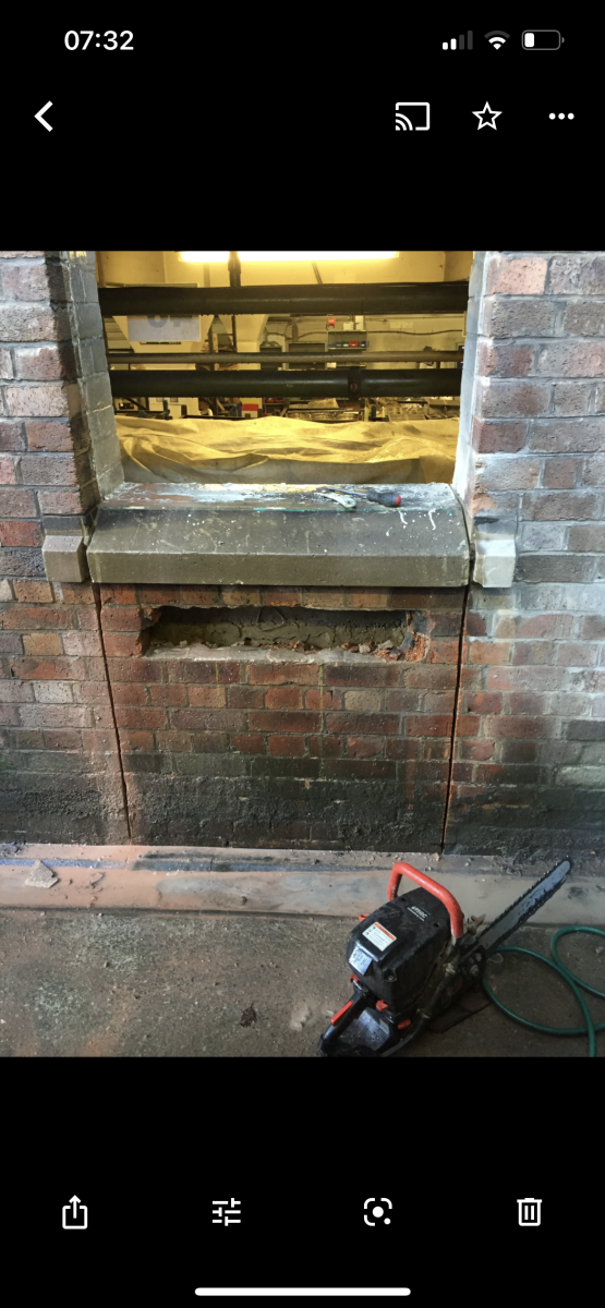

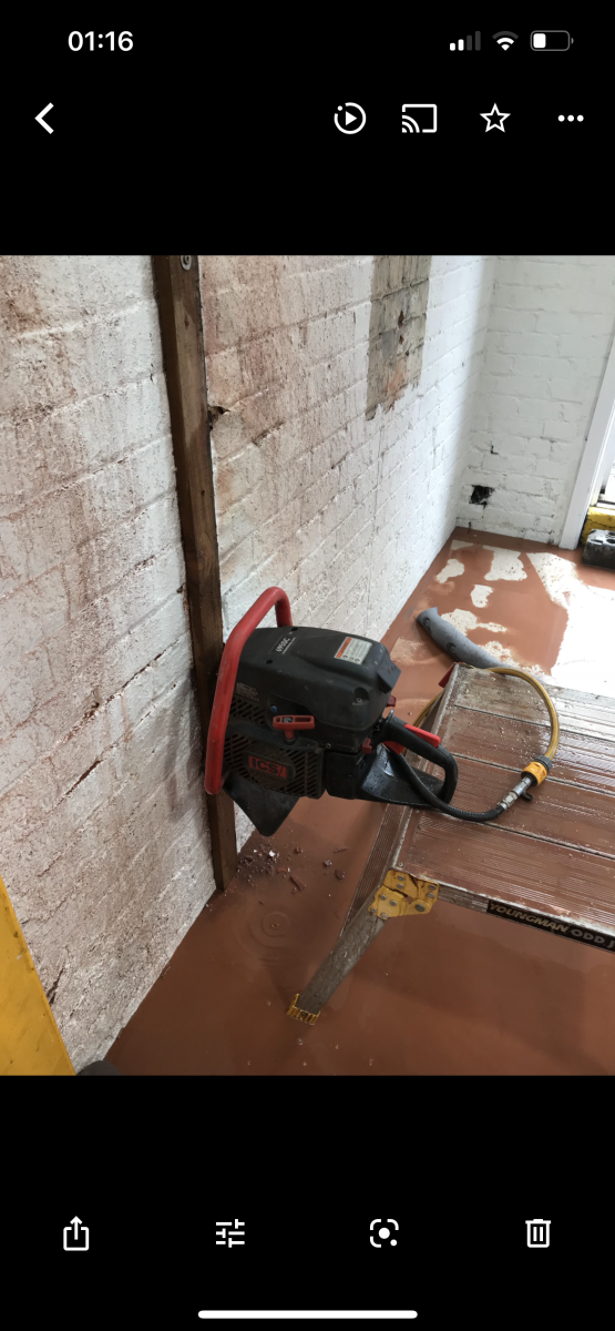

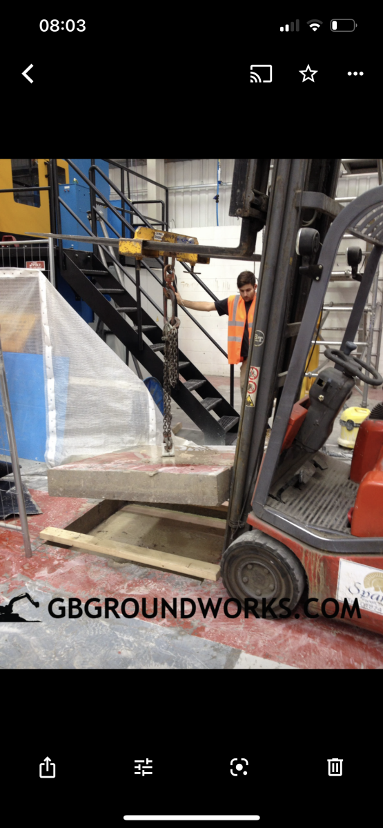

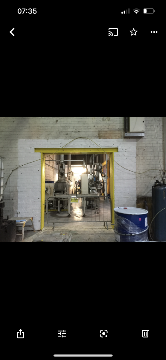

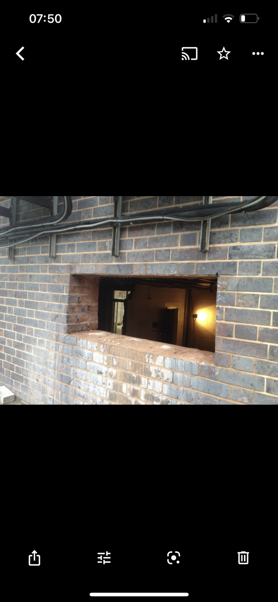

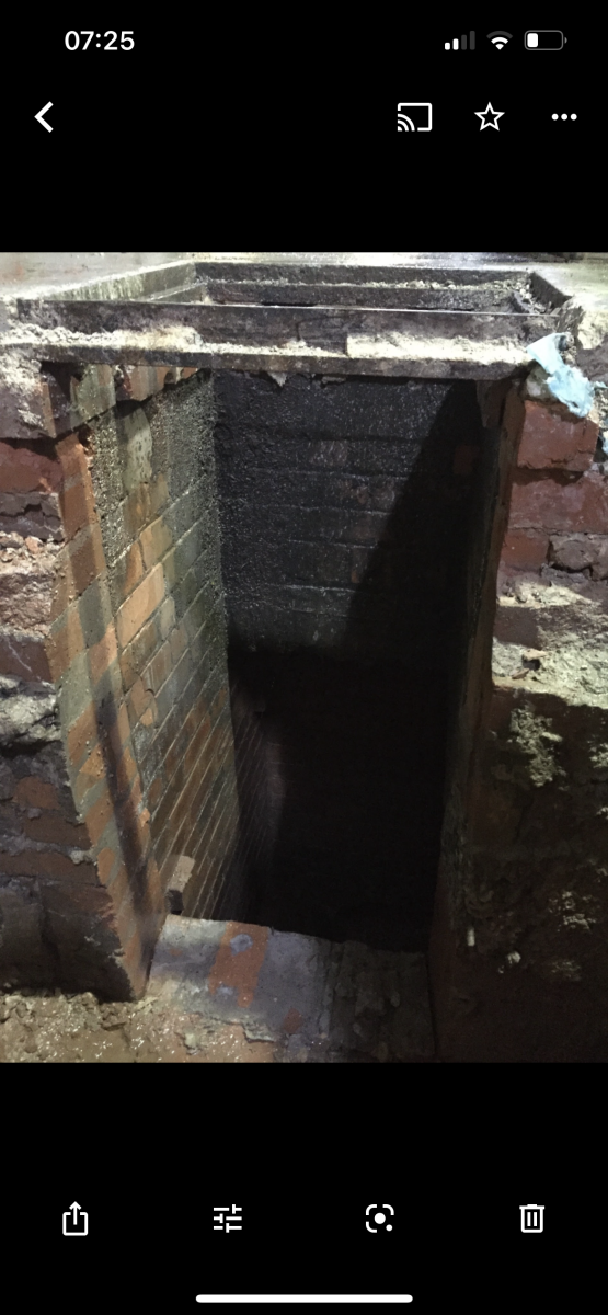

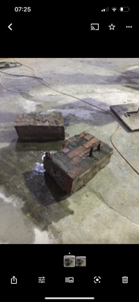

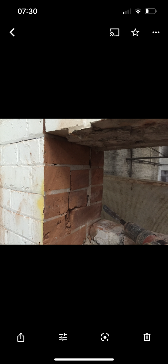

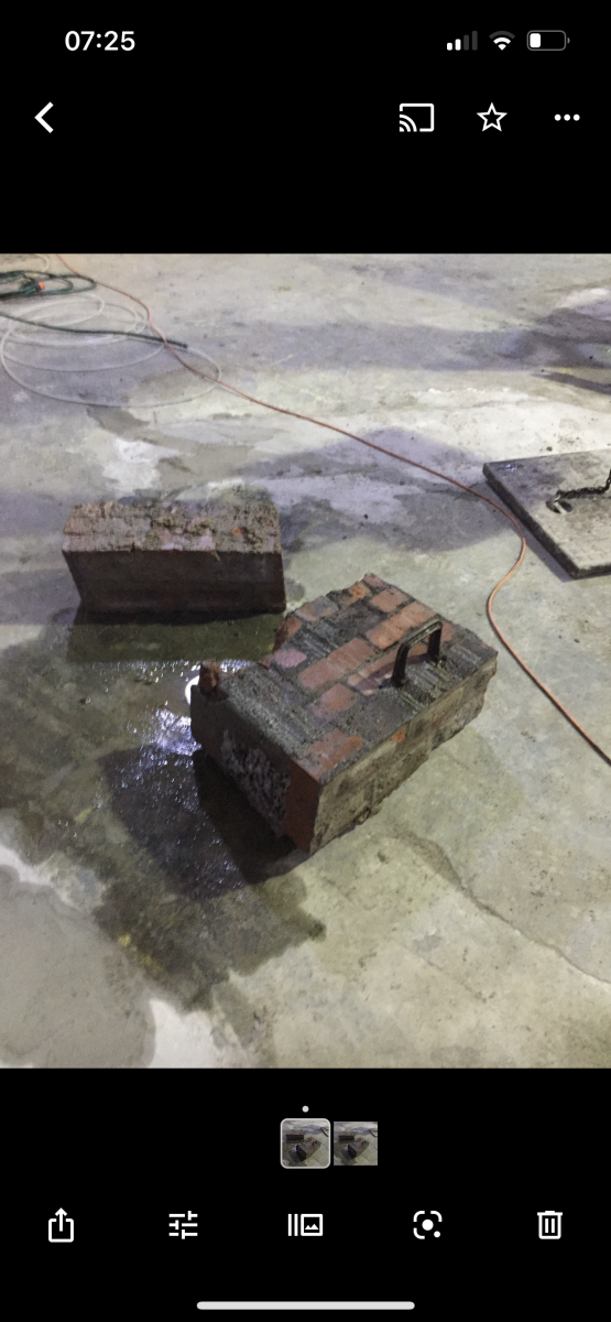

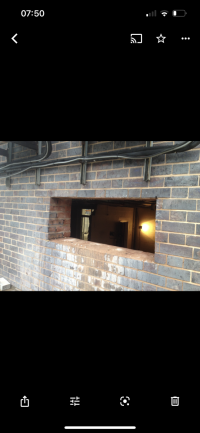

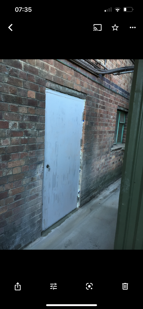

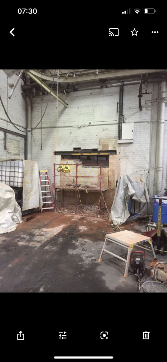

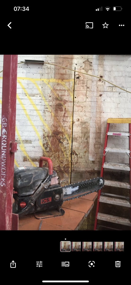

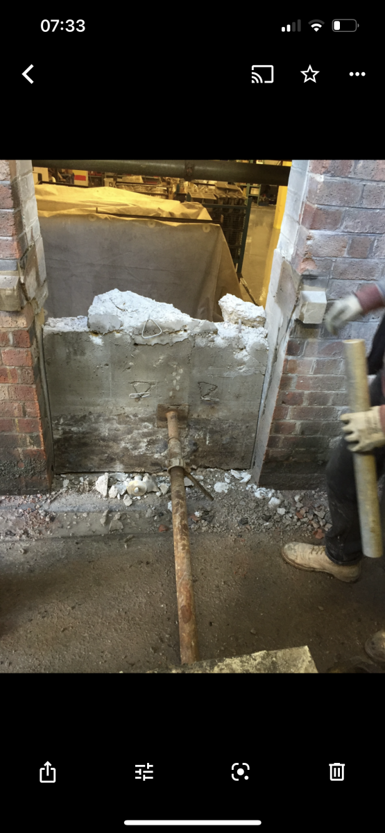

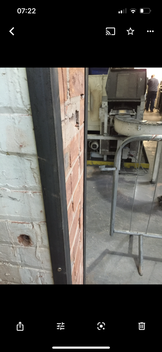

I’ve done 450.mm brick work but damn it’s hard graft on hands and messy these where big forklift doors in factory’s will post pics up when I find them, its a process special wide stihl saw blade to start then keeping it straight is a task but Ics do do a wall mount rail to hold it

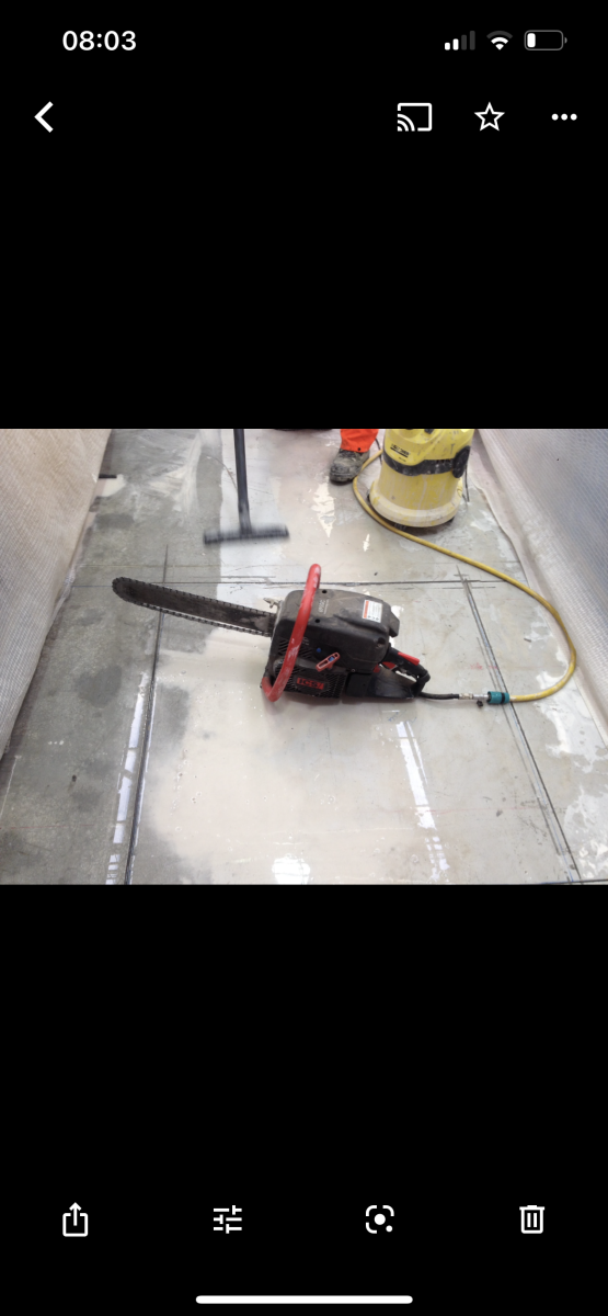

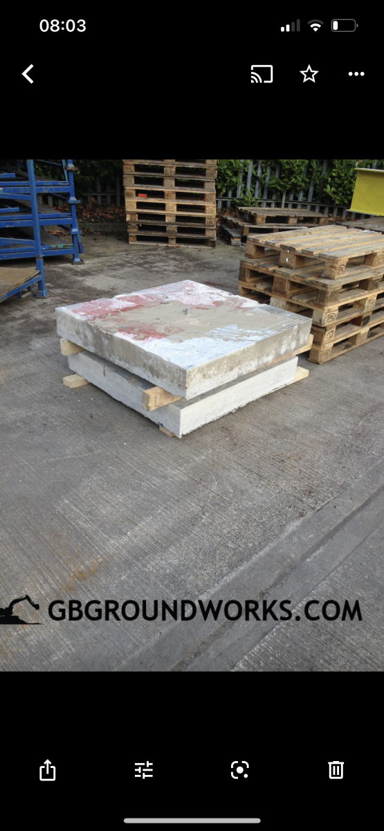

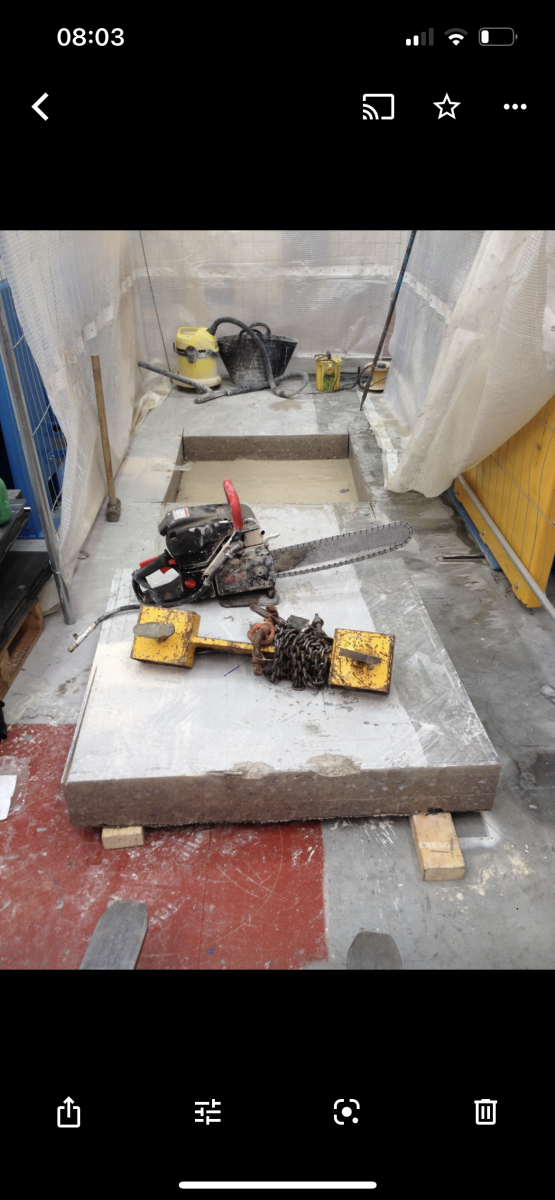

I’ve the husky cut n break, works well, think it does 460mm, but I’m left handed, grown up holding Stihl saw backwards fine, the husky is a real pain for me, I look over the wrong side of it to keep it square.. does the job but deffo want it covered up before anyone passes comment 😂
Been handy over the years not used it for 5 years or more as we’ve been on trust work haven’t needed it
The petrol one is 50:1 not 25:1 like most so it’s a bit fuely and not fun in confined spaces
Hydraulic or electric be better, need 1-2 bar water pressure to lubricate chains, chains and bars wear quick and stretch
I worked on 1 bar and chain a big doorway so like 500 in bits

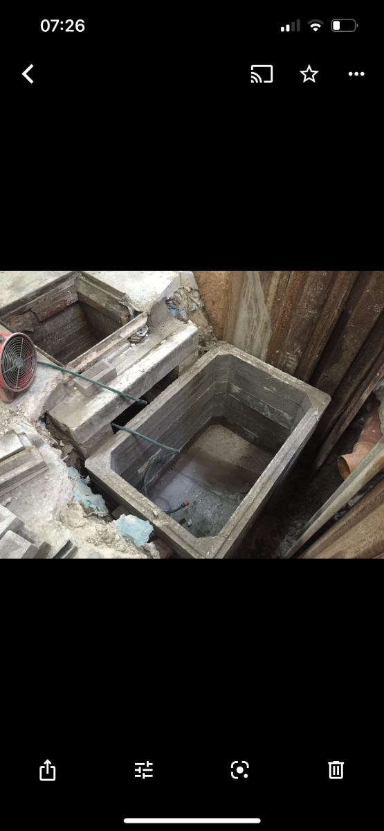

500 quid per opening 🤯 going to be an expensive job then, sounds like hard going too.
I definitely would prefer to not use 2 stroke, most of the second hand ones seem to be 2 stroke though. Hydraulic looks expensive as I'd need power pack too. Not sure if the leccy ones are man enough on standard 110v?
Thanks a lot for the pics, really helpful.

That’s in brick as well, concrete and rebar wears them quicker as well

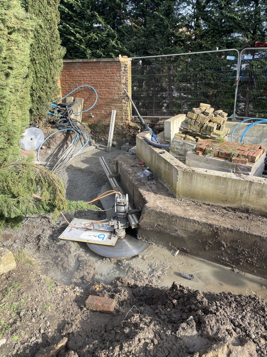

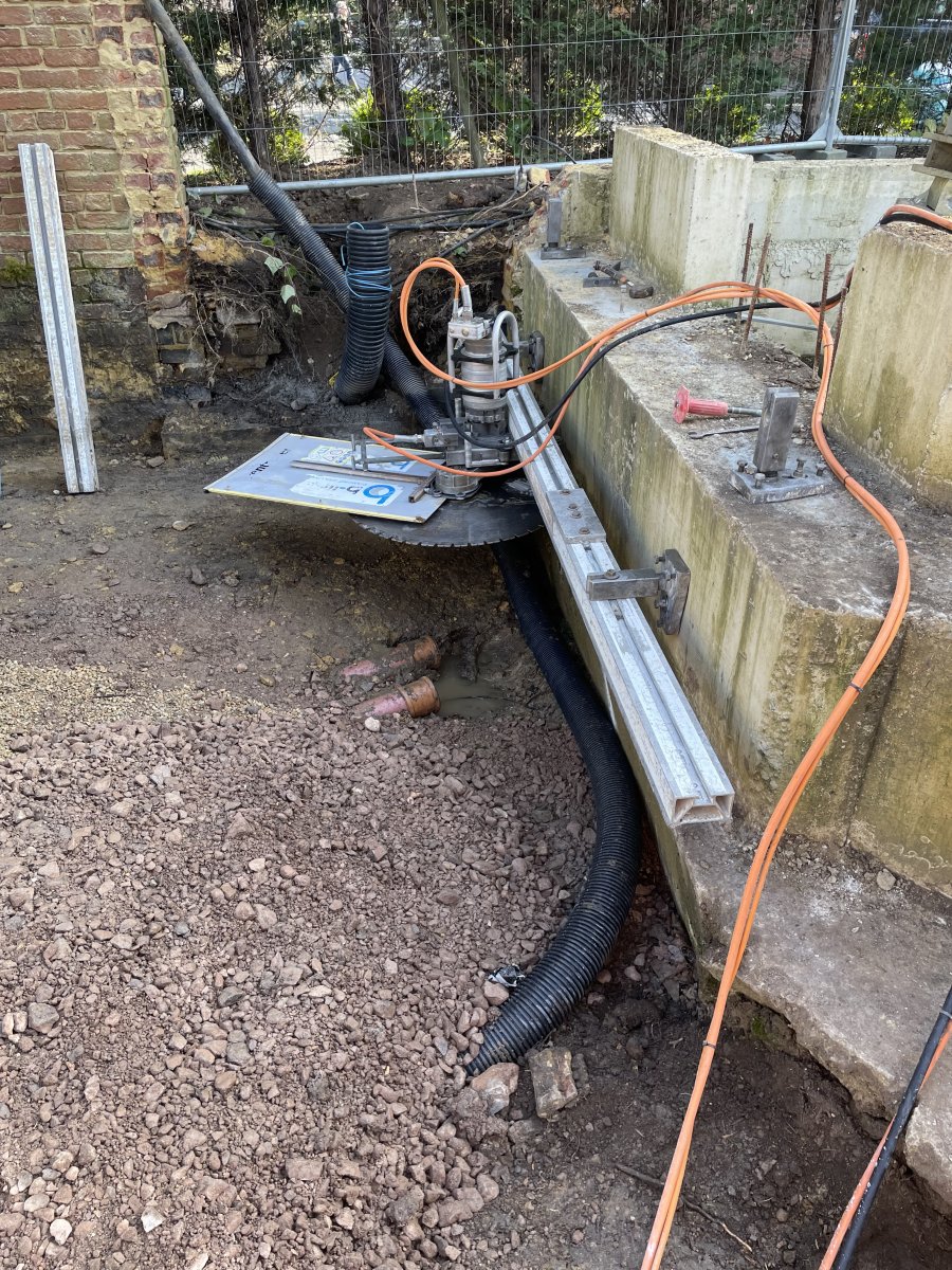

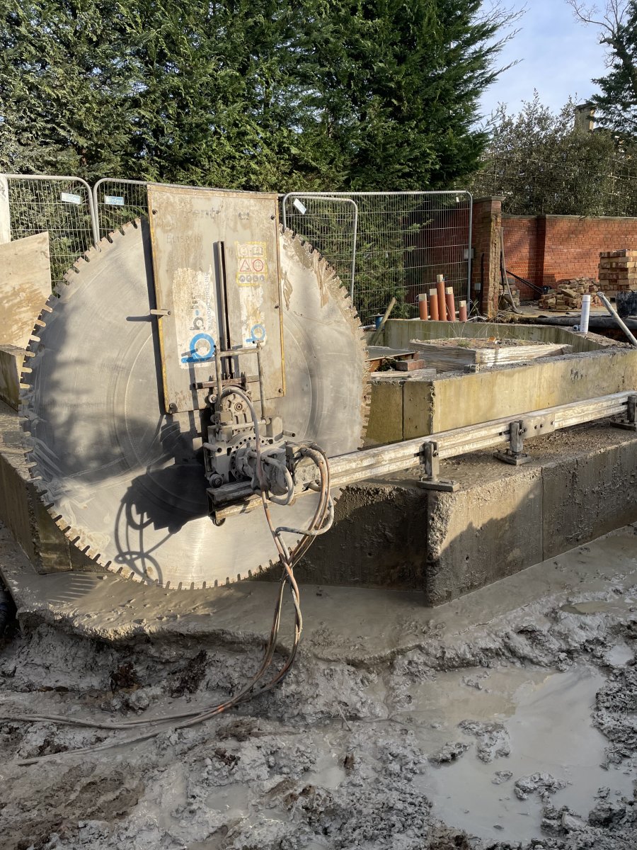

Used to be £500 a day for the concrete cutting guy he had everything in his van and would do clean cuts cut and break saw, ring saw, etc
The big rail saws are the mutts though I looked into buying a second hand one when we were doing lots of knock throughs was a hilt one for about 6k 600mm blade max and 3m rail with controller, pump etc
But then the knock throughs we started doing between steels so we’re easier just needle them knock brick out then weld a steel in must have done 10 with factory changes

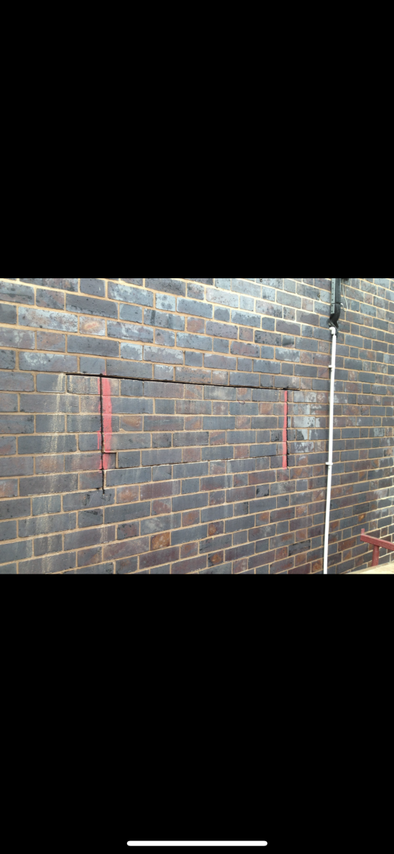

I used 1 in a school years ago very messey had wet vacuum as we were cutting.
You'll have to make good the Reveals as you'll struggle to keep it square etc.
Last rail saw I had a quote for in civic centre about 8 years ago I think was 6500 ish we ended up stitch drilling it
