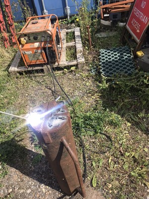

Welding setup
And Armageddon proof 😎 or more that your not at the whim of shitty overhead supply's like us👌
Somat nice about the purr of a 3ph Genny🥰

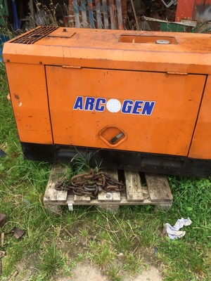

330A Arc gen will give off grid power at 110V, step up tranny to 240V if you need it. Splash a bit more cash will get you a Arc Gen or similar with 240v or even 3 phase and they are good bulletproof units! Mine cost £900 and now has over 10k hrs on it.
Maxus
I think I'm sold on the Arc Gen units. Look pretty robust, plenty of power doubles up as a generator. Any idea what the output is as a generator? £900 is cheap by the looks of prices on eBay.
I'm going to need a bigger lockup at this rate 🤔
Mine will run most grinders fine. Has a iffy relationship with Hitachi 9" grinders as they trip on the thermal cut outs easier in generator power than mains for some reason..... Everything else is fine..... Might be my welding set as opposed to the grinder but it causes me no grief.
