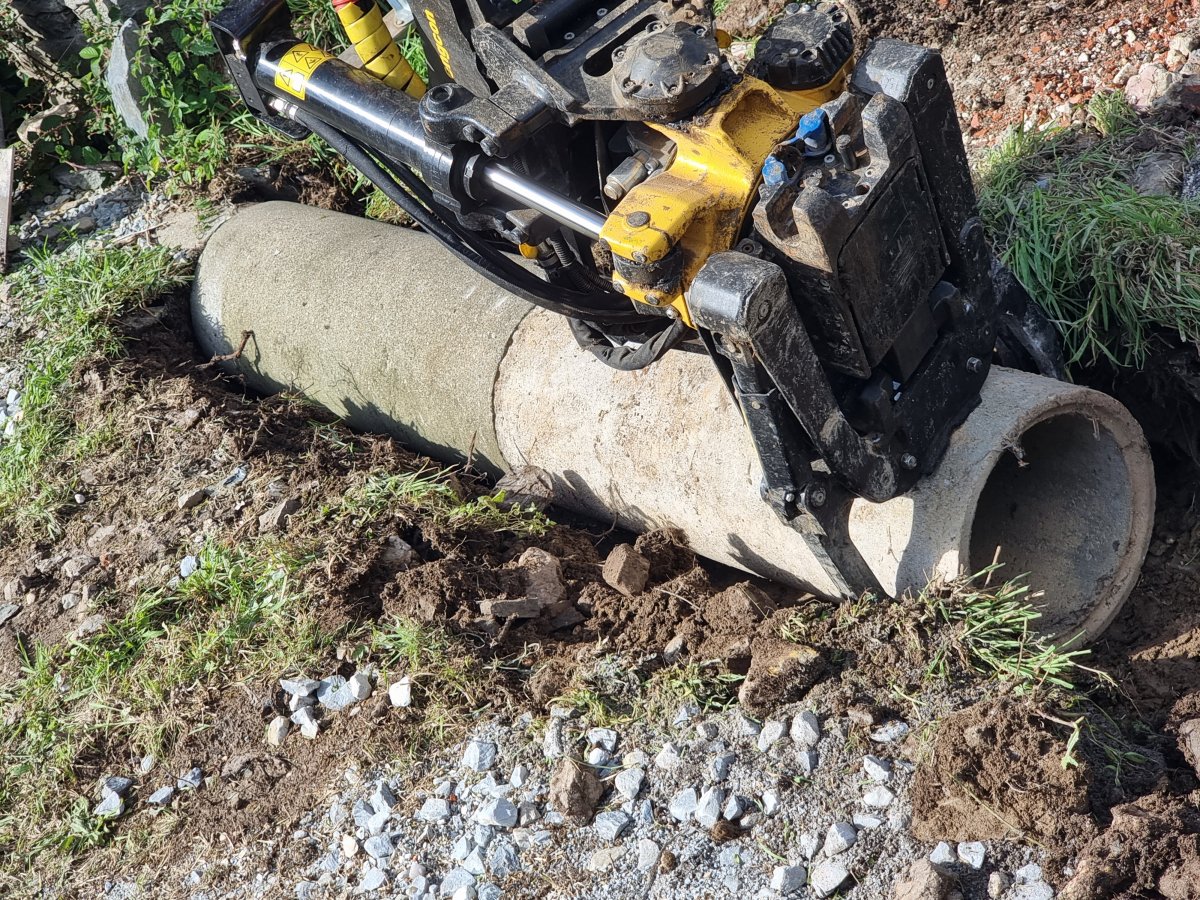

Really enjoyed the job just completed and it has turned a 5 day job into a 4 day and easier much job, been doing similar work for a couple of decades so have a fair handle on timescales. :)
And when the client asks for a couple of little pipes putting in at the end of a friday hes normally met with a frown but it took 5 mins and never got off the seat :)

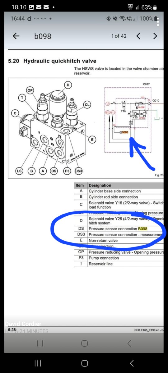

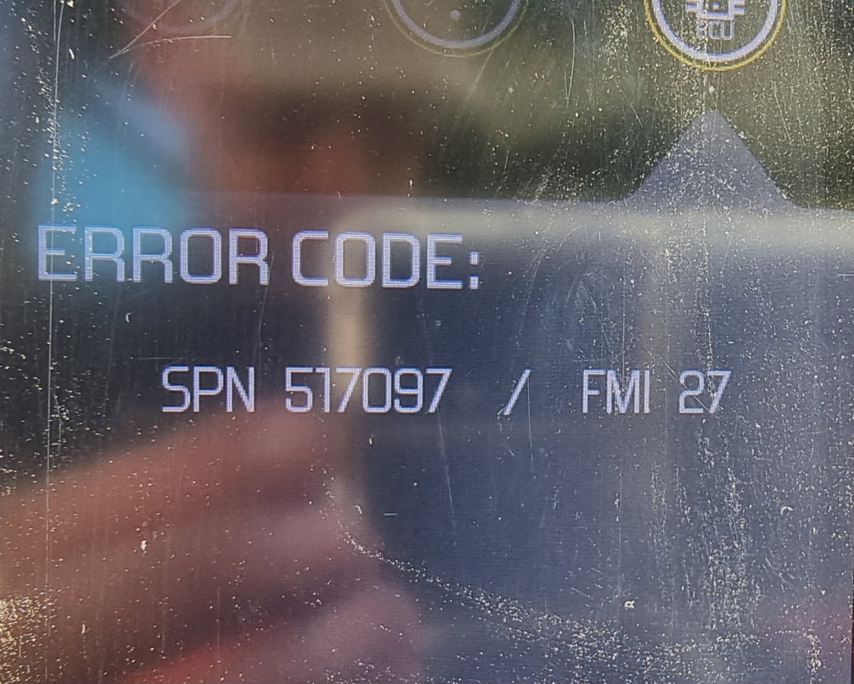

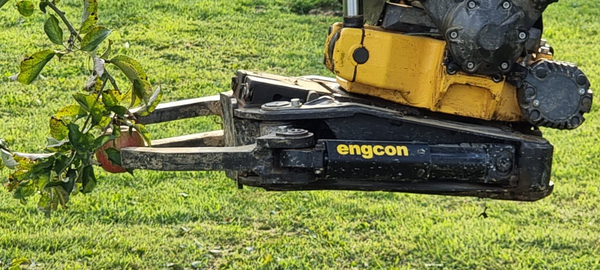

Wacker thrown this code today ...didnt stop progress, after a bit of digging and it seems to relate to quick hitch valve pressure sensor.
The connection visually checks out ok, so is it likely the sensor,the connection or a pressure problem ?
Thanks

Probably a pressure sensor gone south had one on my first engcon setup under the cab that controlled the aux
Find the quick hitch valve and have a look at the plug on the sensor, see if its making a good connection etc.
It most likely is the sensor itself. Is the hitch operating as normal?
Have tried the connector, will have another look.
We dont need the tilty off for the foreseeable so im not sure I want to risk trying the top hitch ...maybe could end up without the tilty back on 🤔
