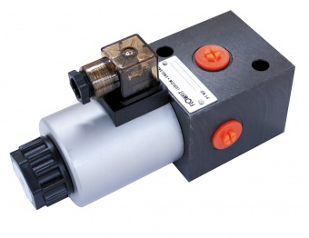

6 x 2 diverter ... wanna be a big un .. Aiden? @CPS

I think you need to divert the oil from the hammer line before it goes to the tilty. I’ve thought/intended to do the same, just not had the need yet….
But adding a diverter to the hammer line before the tilty (I’ve always intended to do it on the back of the boom) will give you a switchable high flow line, retaining the use of the tilty where necessary and giving the full flow to your shear etc. you just won’t be able to spin the attachment all the way round due to the extra hoses.

Button on the stick, or a foot operated switch if you’ve run out of buttons. Either way a 6 port diverter valve on the hammer line will give you the high flow option without going through the tilty and also retain full use of the tilty for positioning the attachment. It will be just the same as the auxiliary on the tilty, you will press a button, loose tilt (usually), and gain an aux for a grab etc. You would just be doing that same process before the tilty, basically ending up with 3 auxiliaries on the base machine.
That’s the way I see it anyway.
You could use taps, you’d need 3 port hydraulic lever valves, but you’d have to get out of the machine to gain back your tilty function or high flow function, seems like a ball ache to me! Might as well just unplug the tilty that’s in the high flow and plug the shear straight in.
To make it useful and keep the ability to use the tilty to position the attachments it needs to be switchable from the cab imo
only real issue/PITA with a 6 x 2 diverter is having to cross one or the other of the pipes from one side of the boom to t'other.... 2no. 3 x 1 diverters - one either side might, be a better proposition, run in tandem from the same switch
